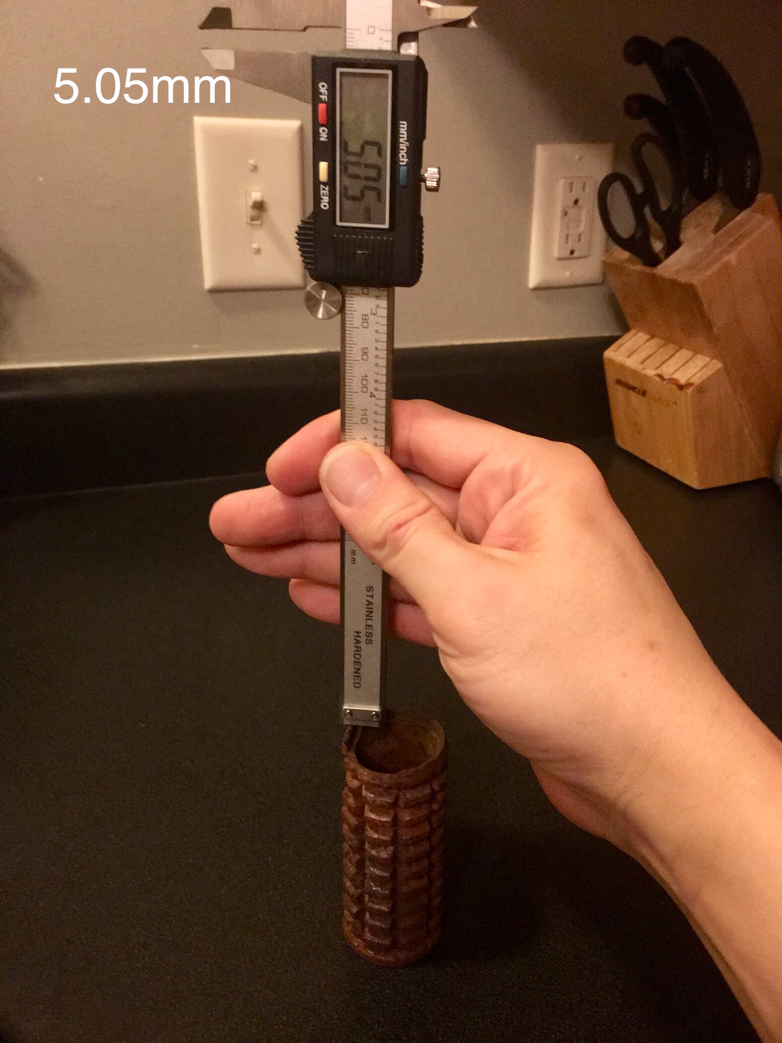

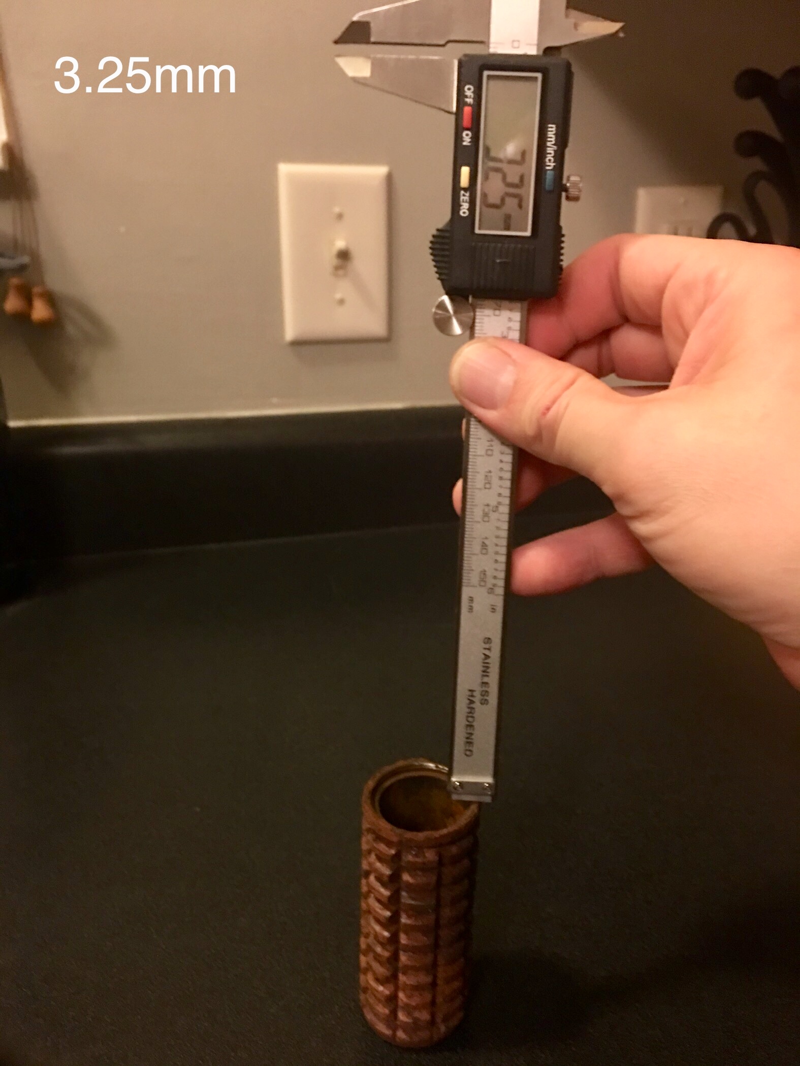

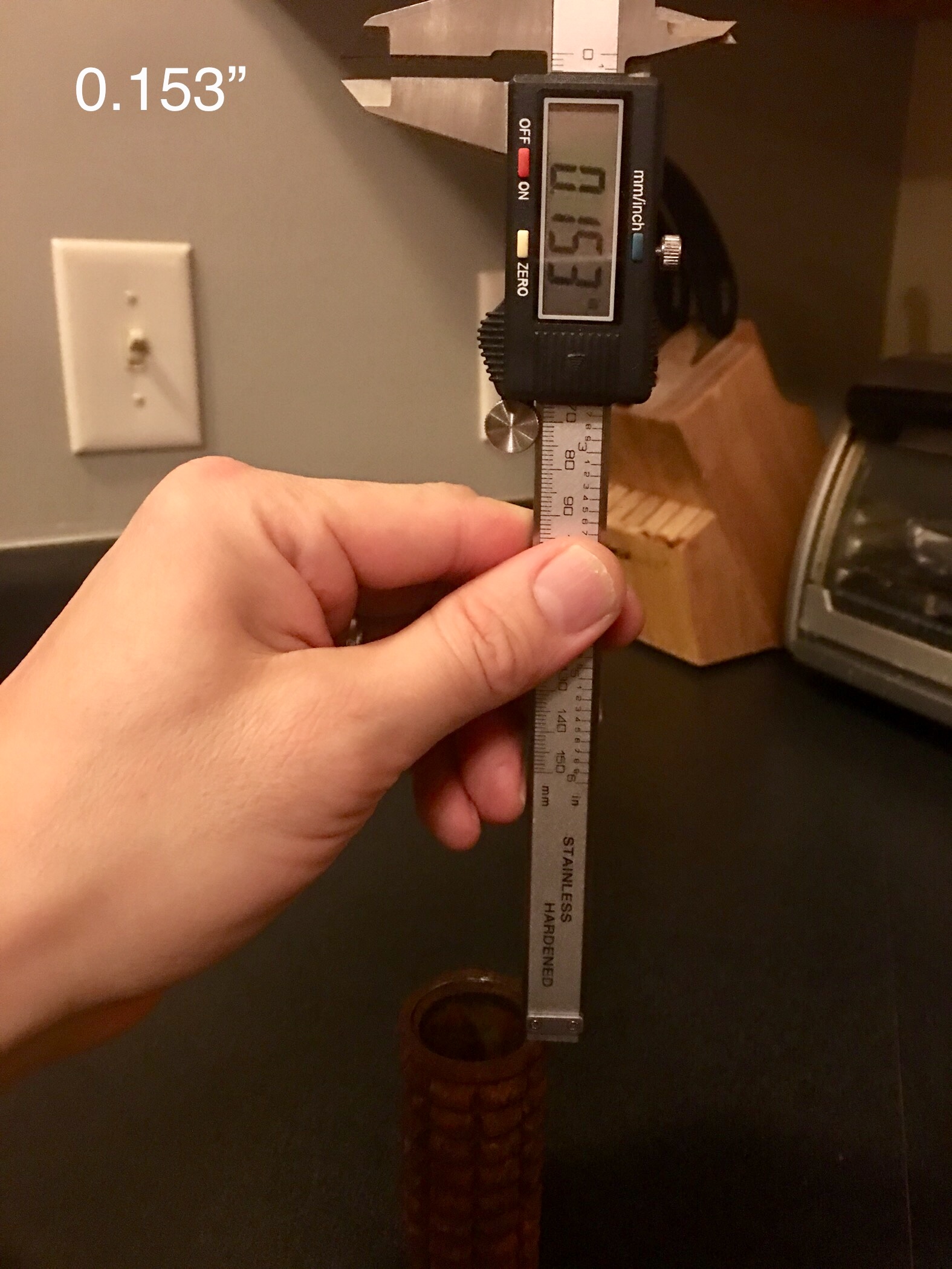

Yea no problem. You can also use the back side at the jaw end to measure off a lip. It’s more reliable when you have enough space because you can be sure you’re measuring perpendicular to an edge. The back part is best for holes.Hey Sabs ! I've had a set of digital calipers for a few years now, and I was trying to figure out what you were doing in the first photo in post #40, when all of a sudden I had an "AH-HA!" moment. I've always thought the thin metal strip that pokes out of the bottom of the calipers was a track guide or that it had something to do with how the electronics measure lengths inside the caliper head. Seeing it used again in the second photo it all made sense and I was a bit gob-smacked that I hadn't guessed at the actual use of that metal strip.
You learn something every day, thank you for that, I'll see if I can repay the favor. It might take a day or four, this has been a rough week for me, but I'll see if I can get you a couple of measurements.

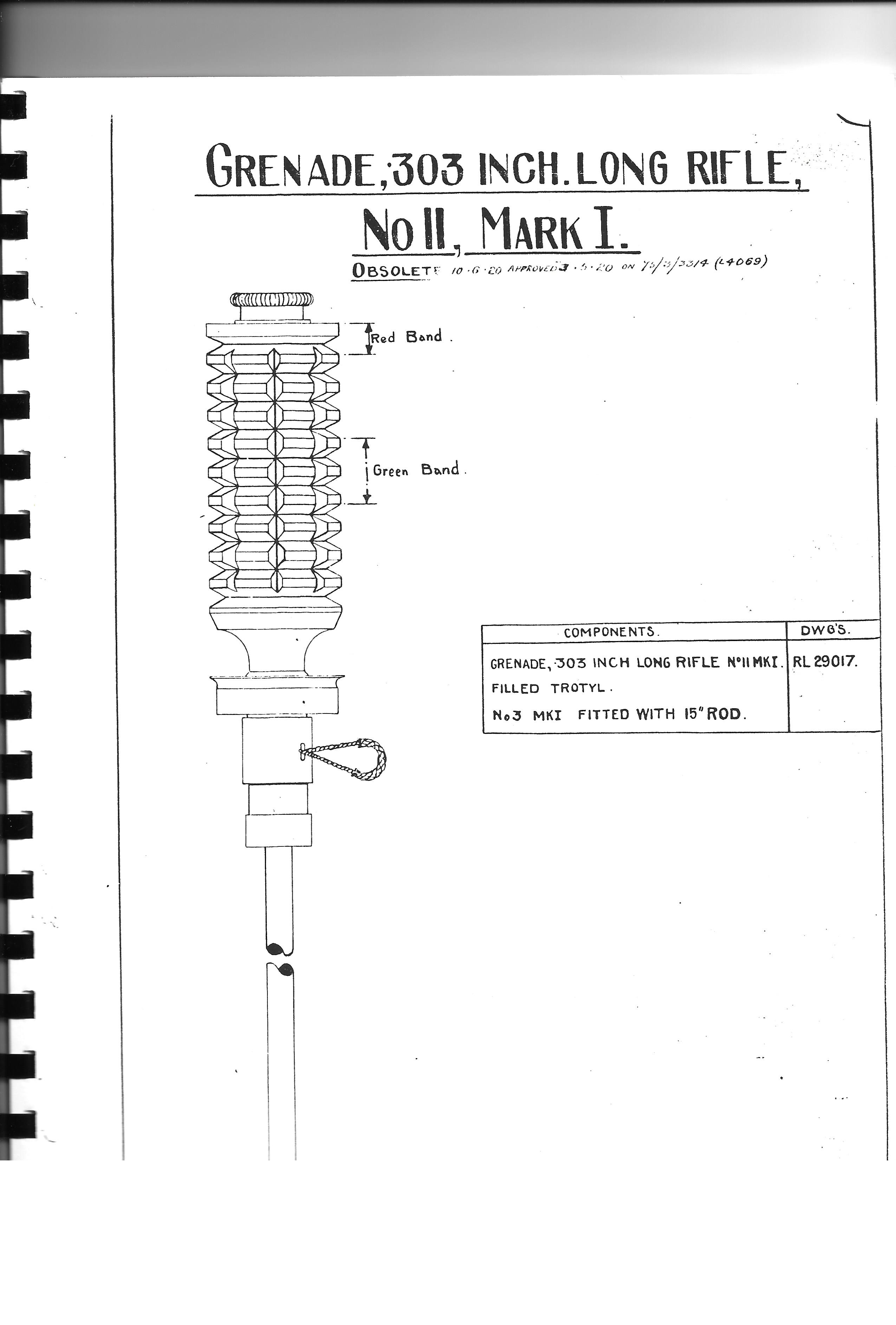

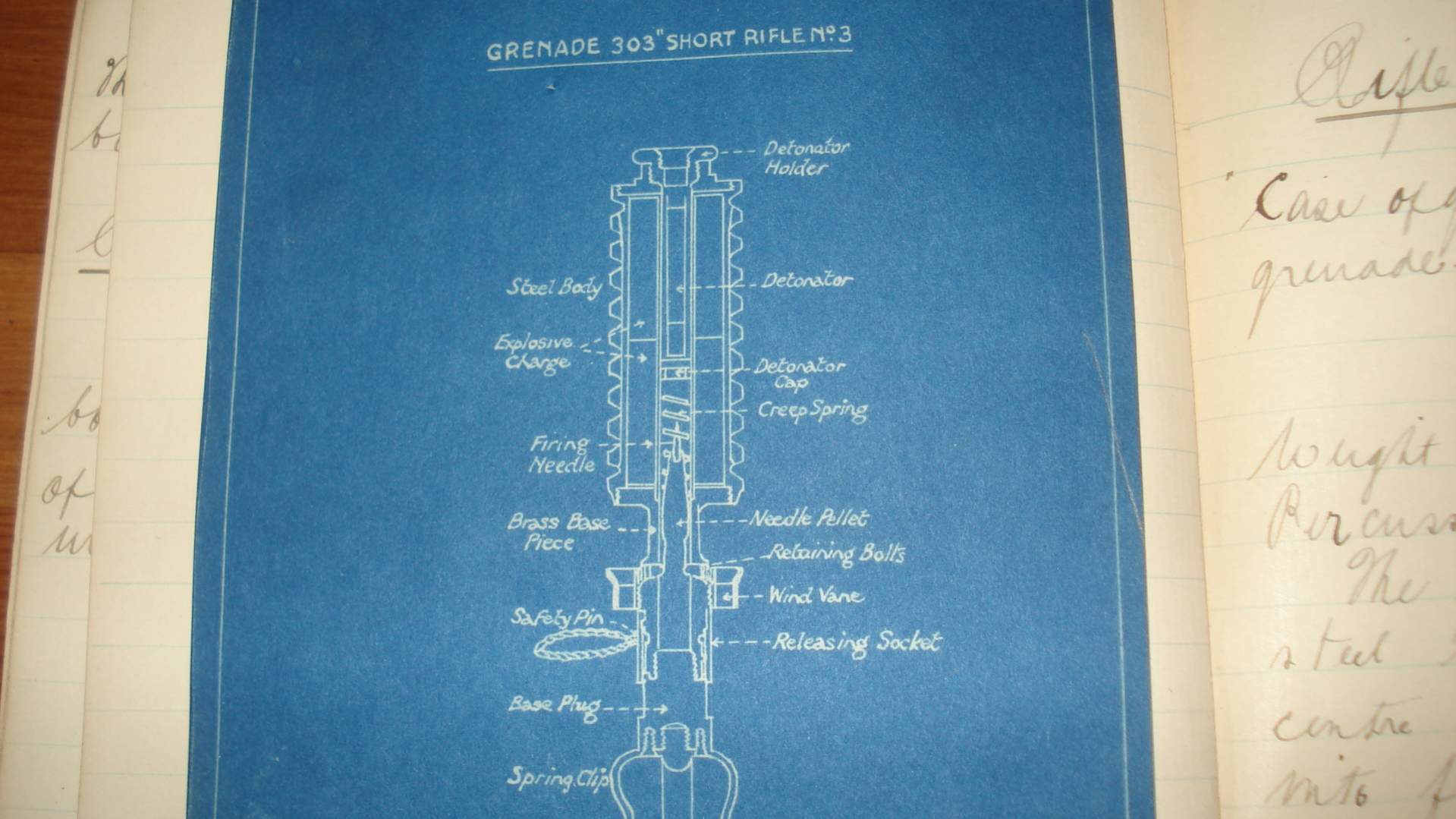

Look what I found!!

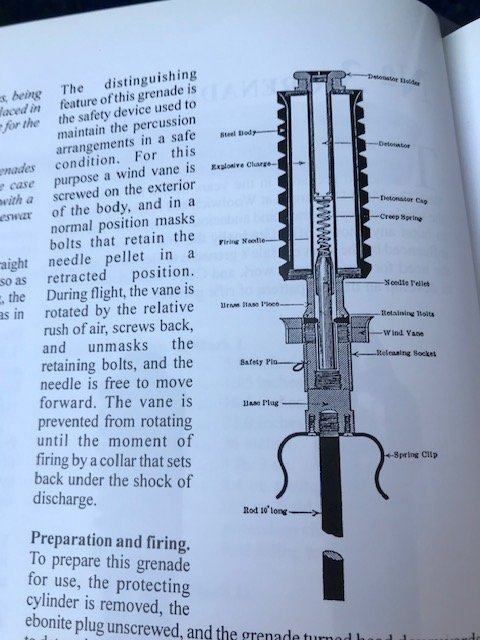

I know it’s the wrong grenade, but I’m pretty sure the measurements are the same for the body part. Now to find technical drawings of the actual grenade. Most likely will have to track down the author of the book I found this in, or take a trip to the imperial war museum in England. Has anyone been there?
Yes I know, the no20 grenade was also described in detail in the book. This is the inside cover of a book called “grenade” by Rick Landers (edited). It’s really expensive but some large libraries have it. The no3 mk1 is described in the book with some photos and how it was modified and how it worked, etc. But this was the only blue print. The back inside cover also had a blueprint but it was of a completely different round grenade.where did you find this? the other grenade is not there?

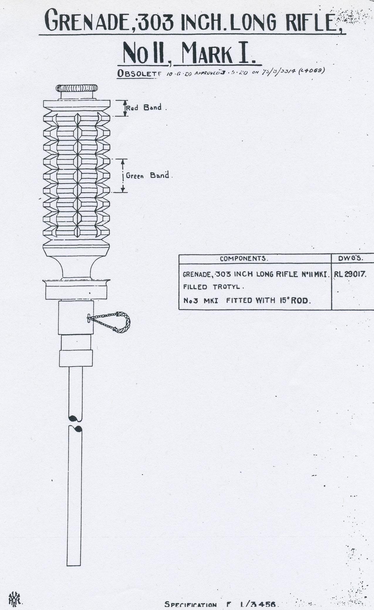

Btw, this is the grenade on that blueprint:
Well actually some of those are the same grenade just with parts removed or when a different manufacturer started making them. I encourage you to see if a library near you has the book. It was really informative.Hey Sabs ! Life's been nutty on my end this past month, and I haven't had time to get to those measuerments, but I thought this might tide you over a bit... I think I posted these in the The Ultimate Ben Obi-Wan Kenobi Real Vintage Parts Lightsaber Group thread, or somewhere in another Obi-Wan's Lightsaber related thread...

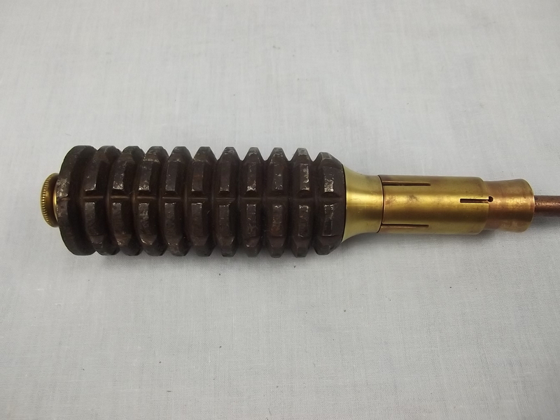

That No20 blueprint you found is AWESOME! I'd always figured it was one large cutting wheel used to grind out the 'V-Grooves' and that it was simply dropped into it a bit like bringing down a power mitre saw part way. teecrooz or ... I can't remember who, posted up an image of a double-wheeled cutter which may have explained the asymetrical cut grenades' V-grooves ways back in another thread. But it looks like the cuts were made by a much smaller wheel than I'd imagined and it was run into, then down the length of the fragmentation body, then backed out at the other end.
I've been thinking to experiment with a little Super Sculpey by smashing it down into the grooves of my Hale's Grenade, and then baking it to get a reverse image of the groove to see how it may have been made. I might have to give this a go tomorrow if I can find the time! If it looks like that 1.575" Radius lines up with what's in mine, that'd be really fun to see!

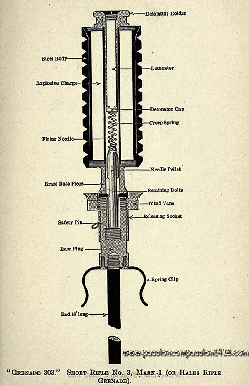

The No20 was very similar to the No11(or No3 MkII depending on the site you're looking at), but lacked the windvane of the No3 MkI/MkII and No11. I think the main difference between the No3 MkII and the No11 is the end cap and the rifle rod clip, or lack thereof.
With the wide variety of No3 MkI's we've seen here on The RPF alone, a blueprint of it will only tell us what it was supposed to look like, rather than exactly how the grenades turned out. I'd still like to see that blueprint though to base my personal "ideal" Obi-Wan Grenade section off of!
