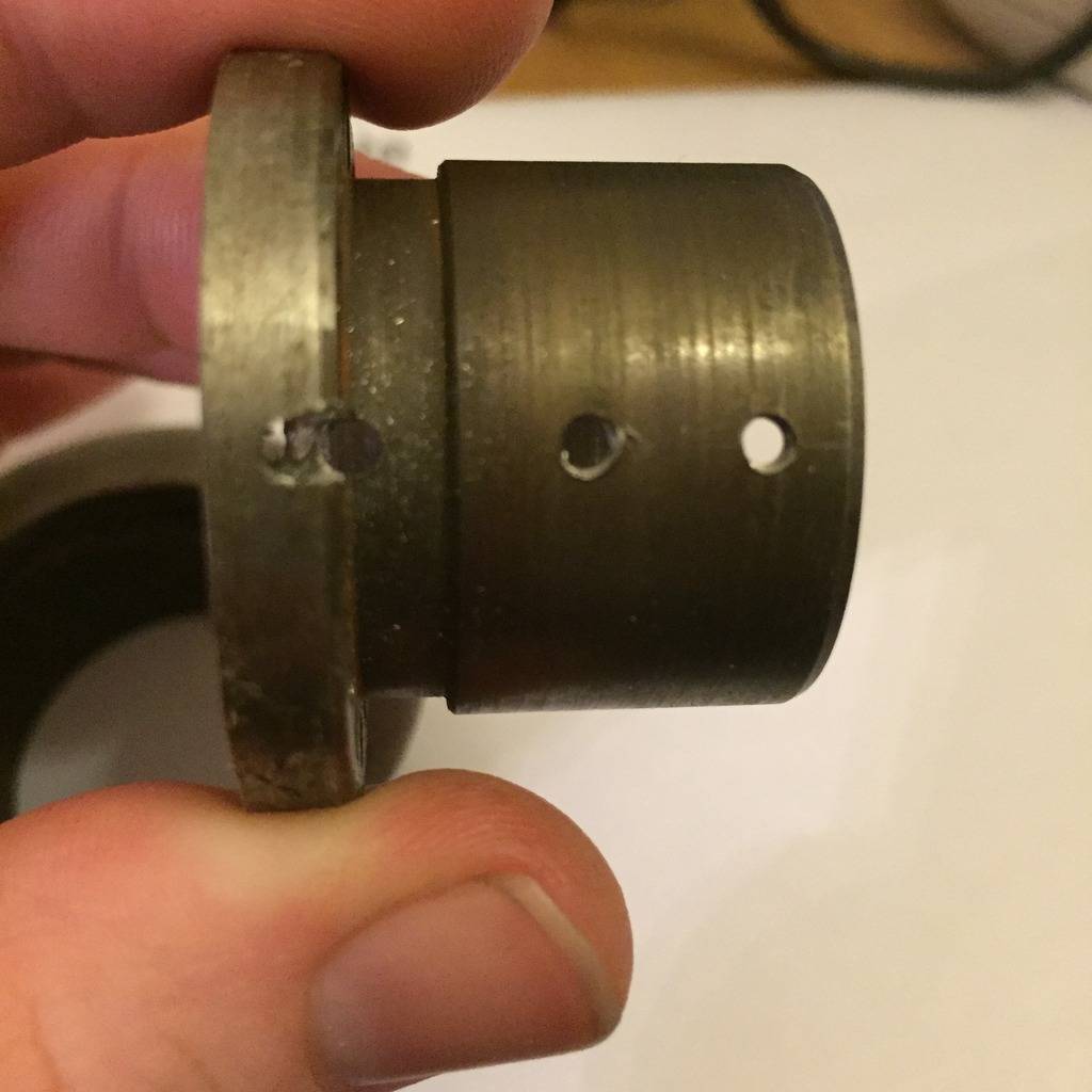

I also found this image (I'm sorry I don't know where I can seem to find the source even through Google images) that seems to be the interior of the balance pipe, but drilled to hell, and I can't find any other images that seem to support that there is a large trench in it, so maybe someone can tell me what this is.
There is a trench, but no holes in the side. The version of the balance pipe prior to this one did have side holes. Picture of the older version below.
I've got no idea but possibly something to do what ever connects to this, to help the housing/joining of.
