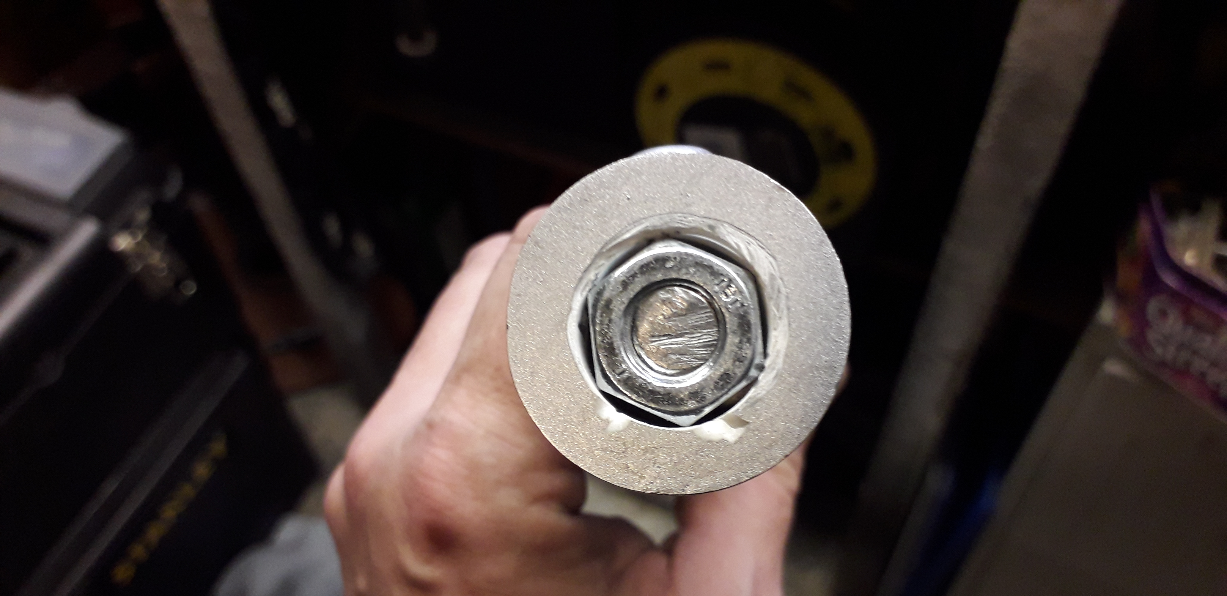

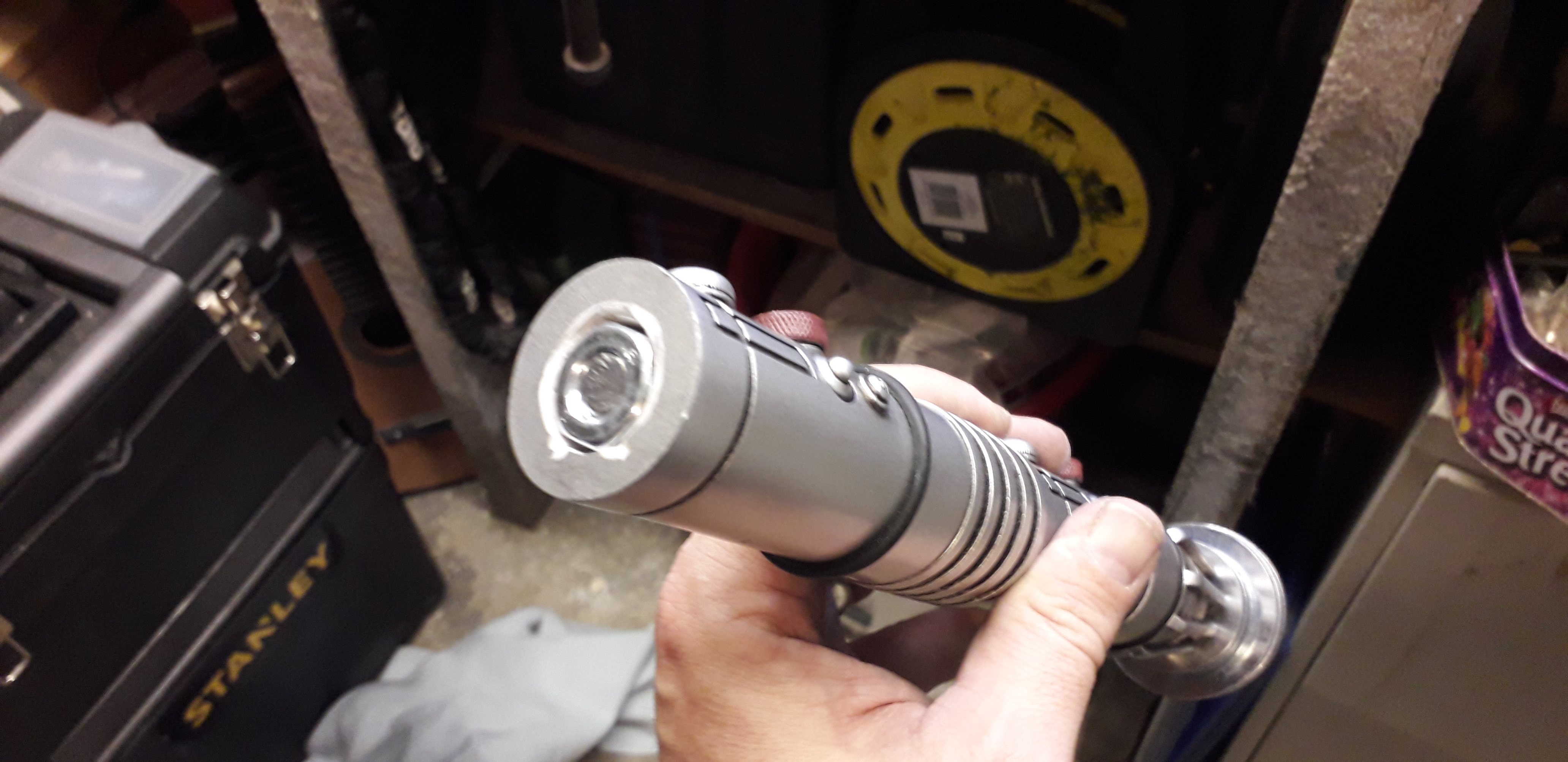

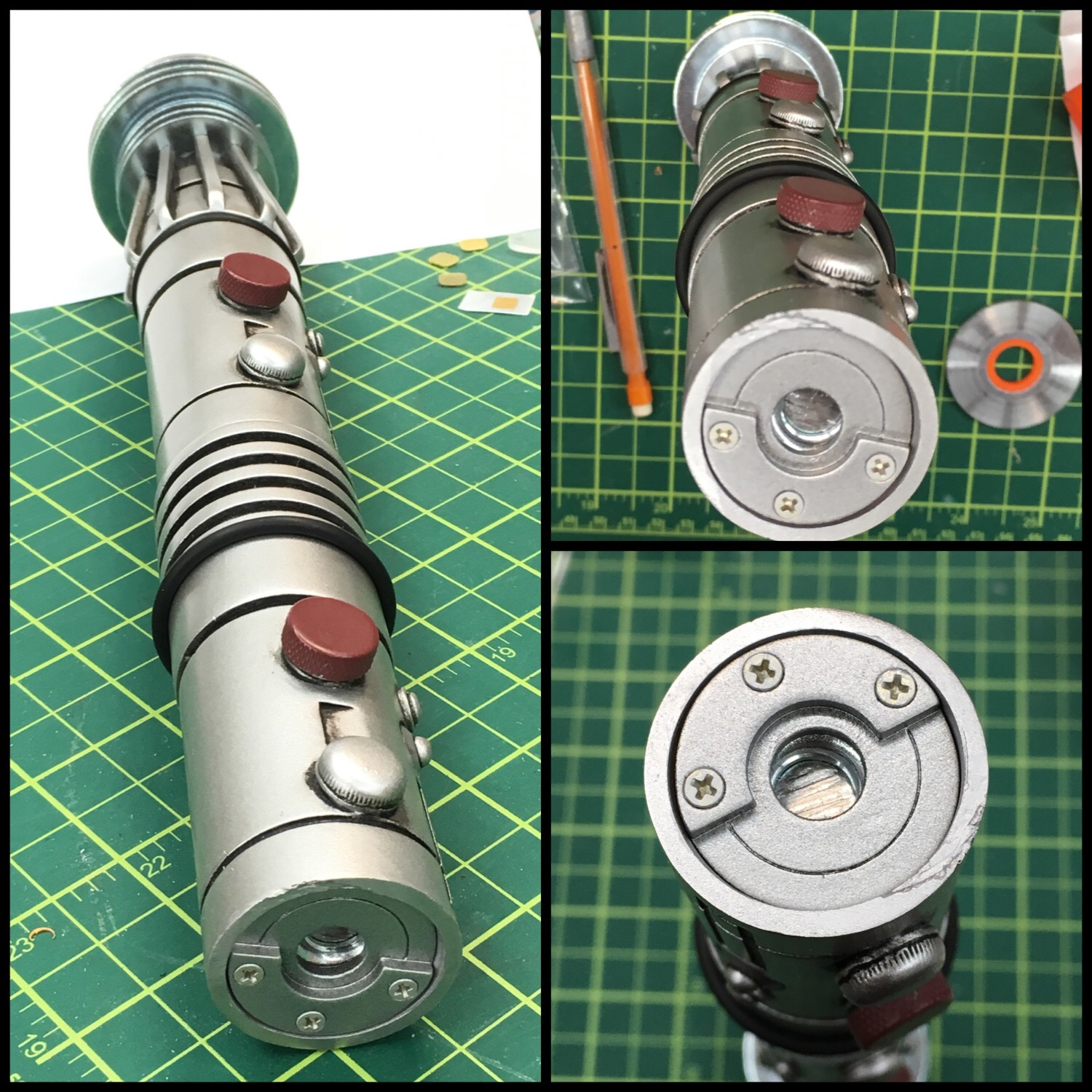

So I've built my full saber and am halfway through my BD version. I used a drill to bore out the end a little so I could fit a nut to hold the rod in. This works a treat. Just insert the nut into the hole and then glue it. You need to make sure it's perfectly flat across the top or even recess it a little. I'll be making the end cap this weekend.
Still can't believe these sabers. They are amazing.

good idea!
make sure your Orings are placed properly, I can see on your half saber that they are not, don't know what you did with the full saber ;)
Thanks bud.
Im seeing so many different o-ring set ups. Which one is accurate??
Thanks bud.
correct position is against the grooved area, not close to the buttons. Should be just like E Williams just posted. I never seen a version of the saber in the movie with another position than that. If you have one, please post a picture :)

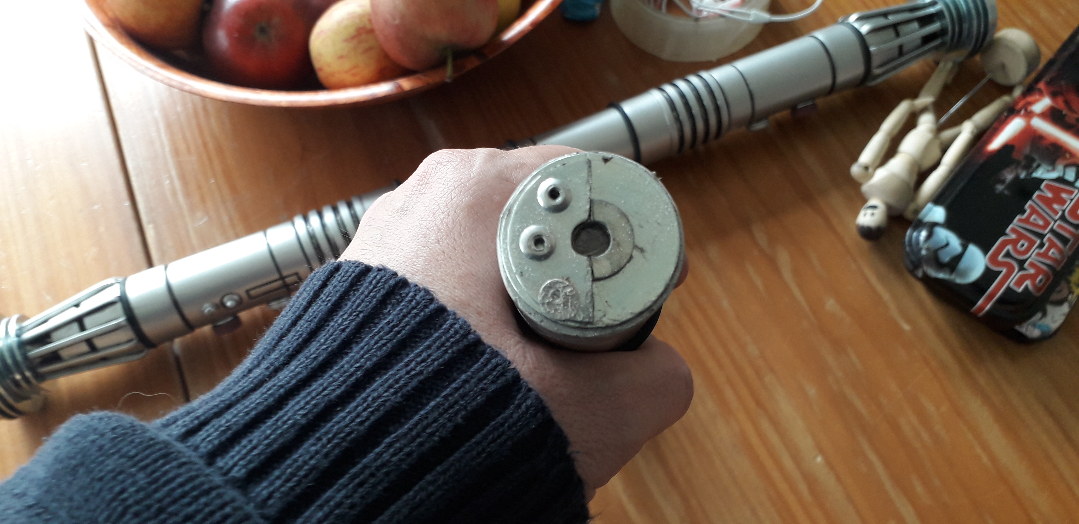

Made the battle damaged end today. Not 100% accurate by my means but enough for me.

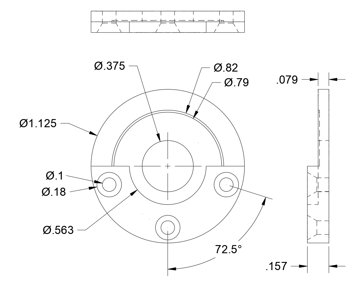

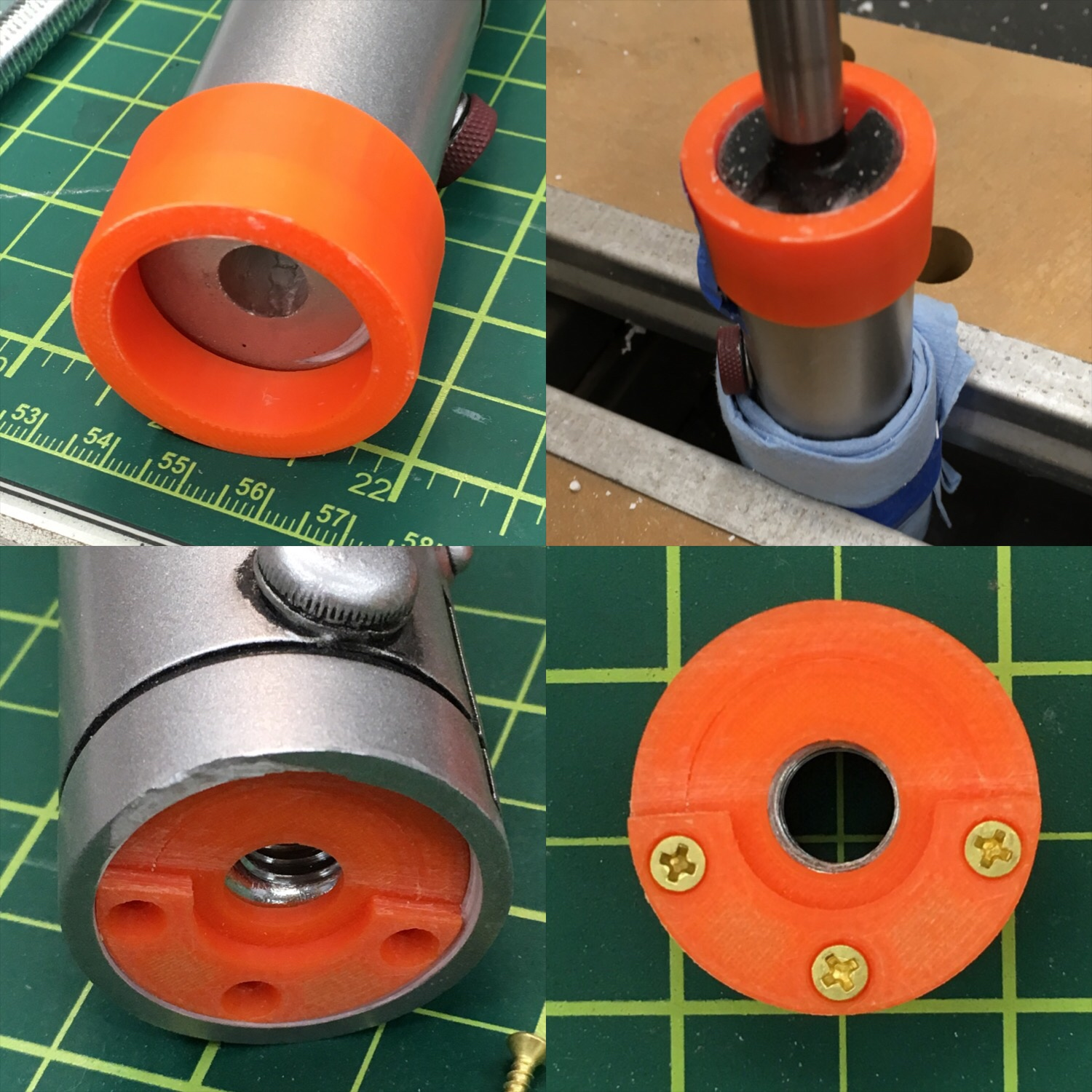

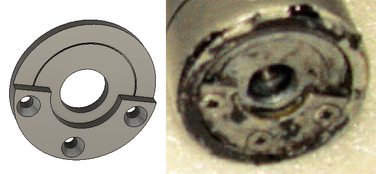

Ok, the cut end file and drilling guide (needs a 1.125" Forstner bit) are posted here:
Here's a drawing of the measurements I used when modeling the cut end detail. You'll need #2 flat Phillips screws, too :)
Yeah, I think #2 screws are the way to go. I dropped the original image into Illustrator and checked the proportions based on an overall diameter of 1.125" -- my model did need a couple of tweaks and I think it's in a better place now. Thoughts?
The drill centering collar worked pretty well but I wasn't holding securely enough at first and the bit jumped and took a little out of the edge (battle damage??). The resin is tough, hard stuff! Just have to go slowly and carefully. Maybe there's a better way to do this?

Did you use a paddle bit to bore out the hilt?
I used a 1 1/8" Forstner bit which is the kind that looks like this:
1020827
And this is the specific one I used, $12.45 on amazon (I already had the small Harbor Freight Forstner bit set but it only went up to 1" and the saber needs 1.125)
The smooth round sides let it run inside of the drilling guide versus a paddle/spade bit which I think would jump out of or around in the thing and maybe do more damage than good. The drill guide makes sure the Forstner bit starts out concentric with the saber end.

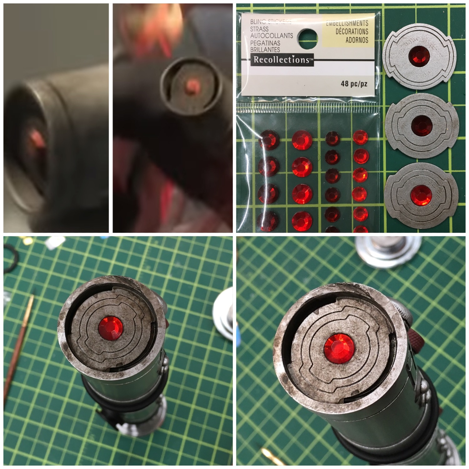

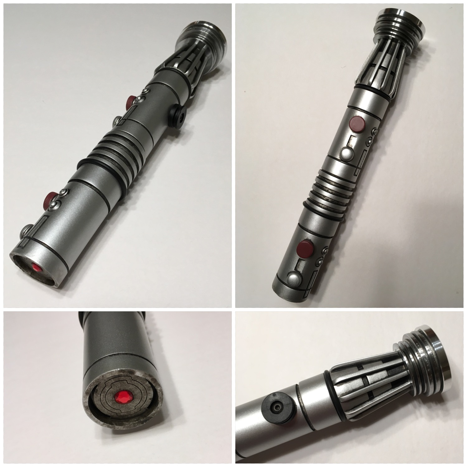

Weathered and covertec-ed my cut Maul:

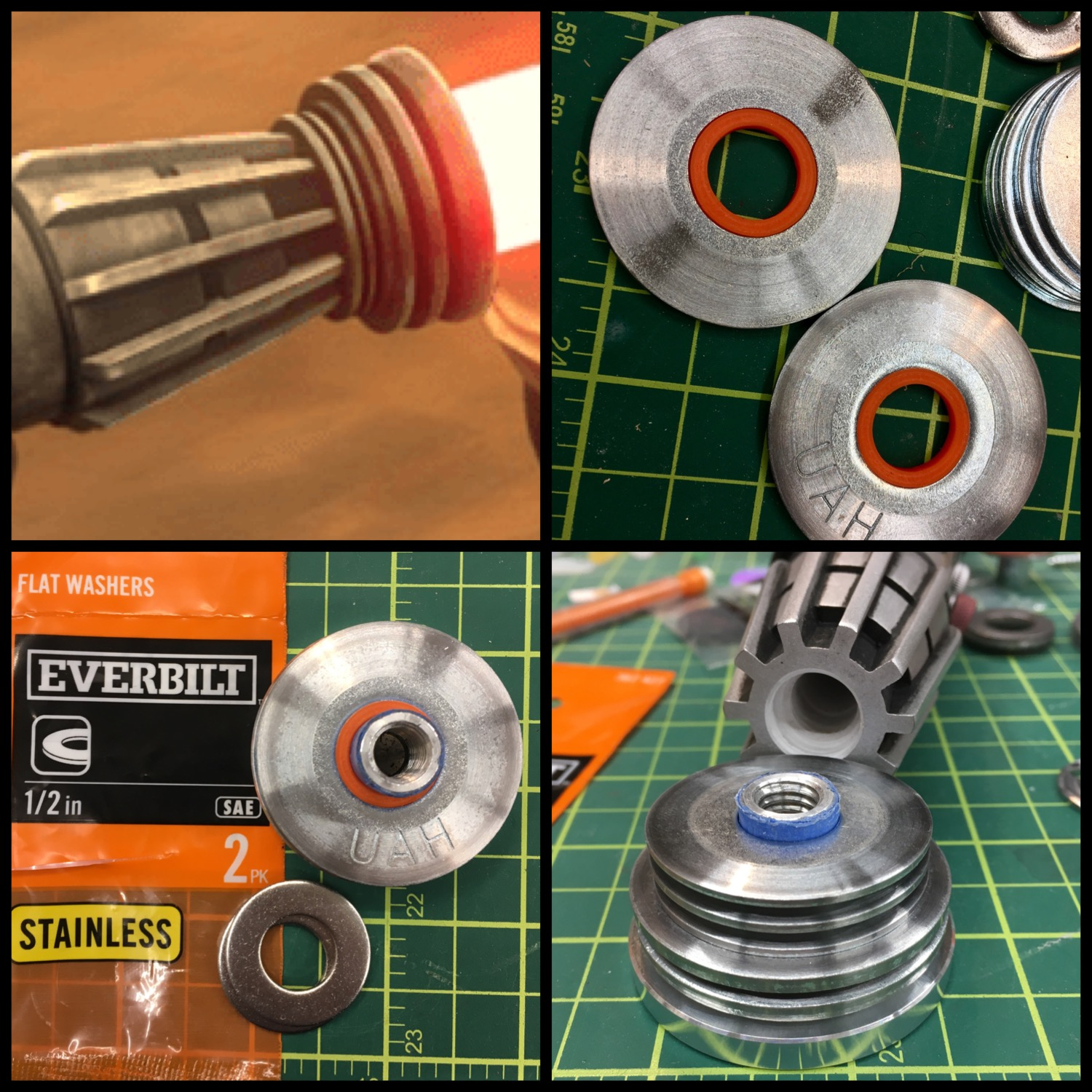

And because I couldn't resist I converted it to a Clone Wars version! :)
The animated show prop's model looks very faithful to the movie prop, overall, with the exception of a black screw in the covertec wheel and a smaller emitter. As a half-hilt, the smaller emitter makes the prop look better balanced overall IMO (maybe the original reason for the change?).

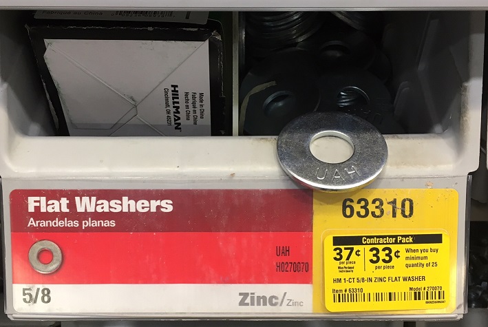

For the modified emitter, I just needed to pick up a few smaller washers. It has two "large" fins/washers versus the TPM version's three. I picked a 5/8 flat washer (Lowe's part 63310) for this which has an outer diameter of just over 1.75" instead of the TPM kit's 2". It's just a bit smaller than the machined emitter plate, matching the show reference. Also printed up a couple adapter rings to help center the new washers on the kit's machined emitter (the inner diameter is larger than the old washers'). The space between the emitter fins looked like it needed to be a little smaller so I replaced the two 1/2" kit washers with some thinner 1/2" flat washers, and used only one 1.5" washer between the larger fins. Because the washer stack is shorter now than the machined emitter plate, I had to drill out the end of the resin hilt to recess the threaded section into the resin.
I modeled up some guesses at what the cut end detail looks like from the few good shots of it that I could find on the show. It appears to be something of a very simplified version of the Master Replicas cut end detail. A stick-on gem from Michael's, silver paint, and a grungy black paint wash and that part is done.
And finished!
