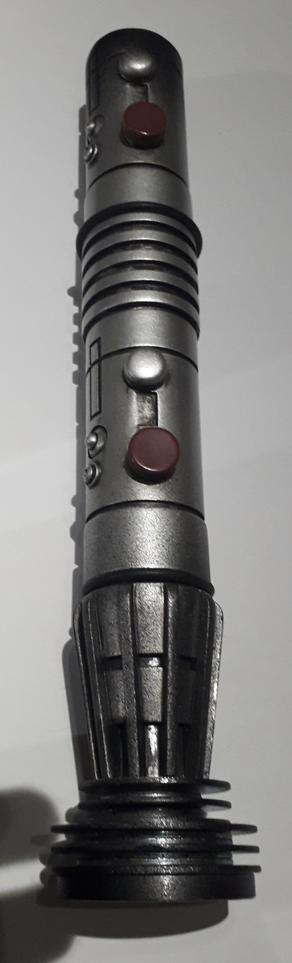

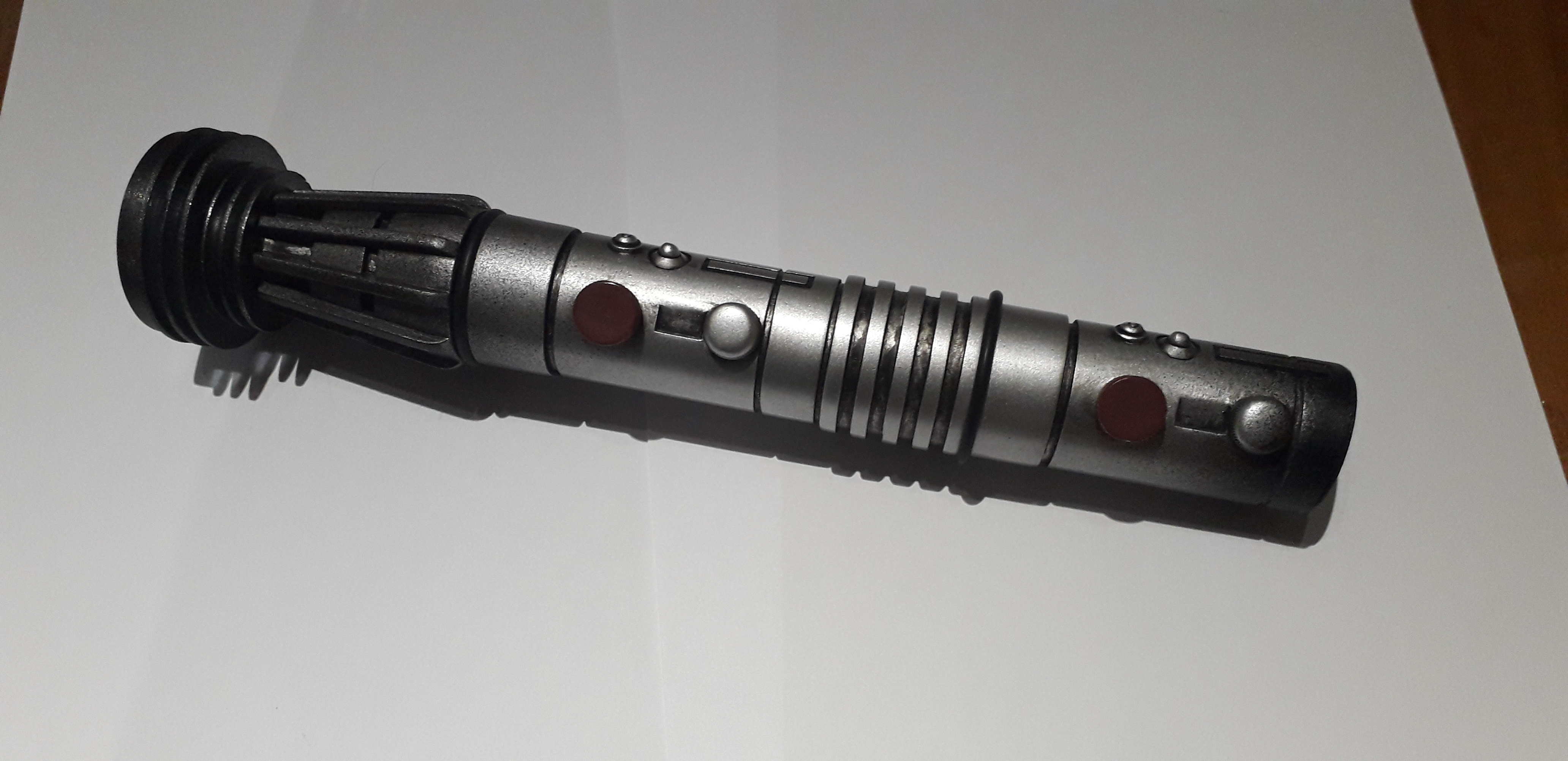

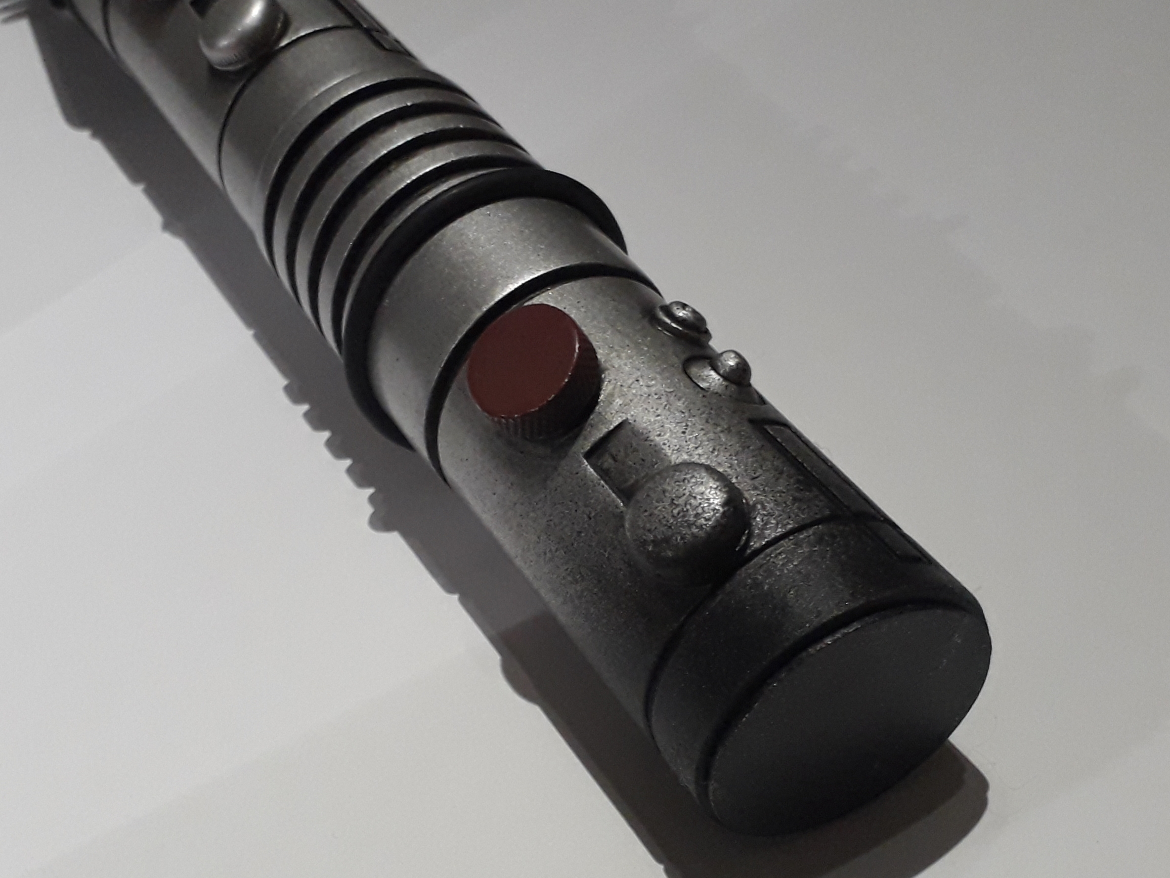

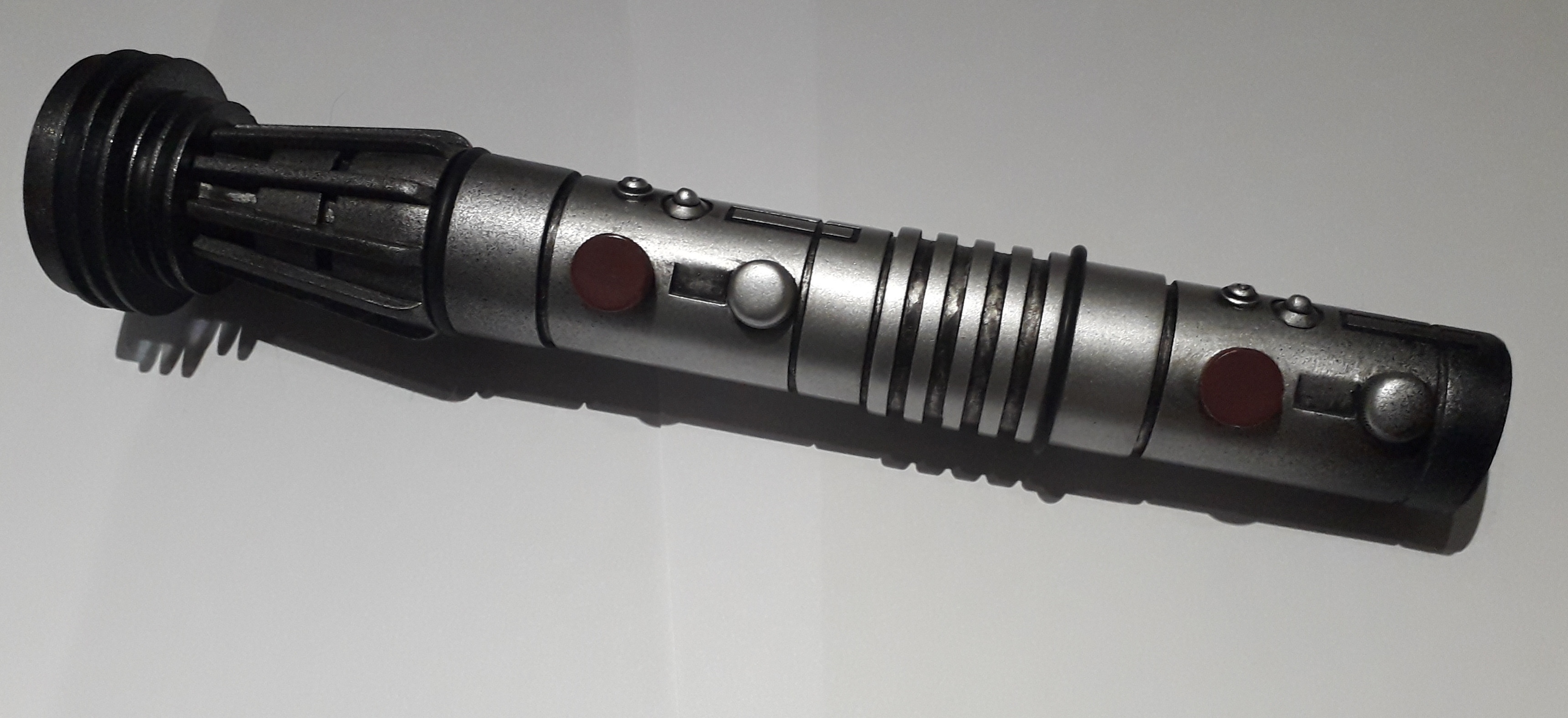

Changed my BD half today. I wasnt happy with what I did on the end so just put a blinking cap on for now. I like a weathered effect but might need to tone it down a little

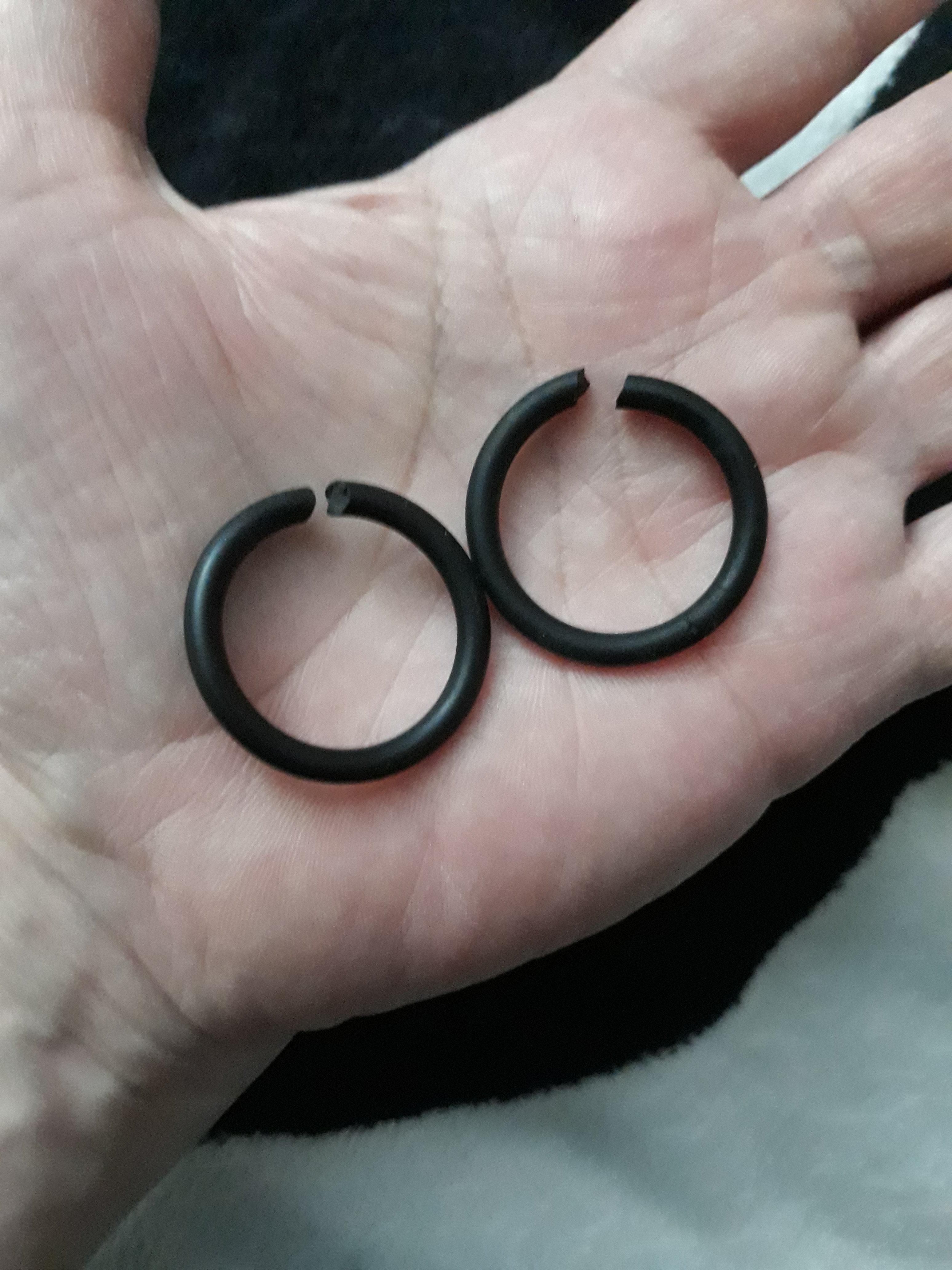

Has anyone had any problems with their O rings just splitting? Took a look at my saber today and 2 rings just mysteriously split and fell off

BTW, anyone know the size of the O-rings, I'll have to get some spares. I had a pack of #17 rings but they are too small

Bill I would bring them to a hardware store if they don’t have the o rings in the nuts and bolts bins, check the plumbing and heating sections

I matched mine at the storeroom where I work. They're somewhere around 1" to 1 + 1/8". The O-ring diameter is like 1/8" all on it's own (difference between outer and inner diameter specs, divided by 2). I used a 1 and 1/8" inner diameter replacement and it worked great and was easier to install, yet still tight.
