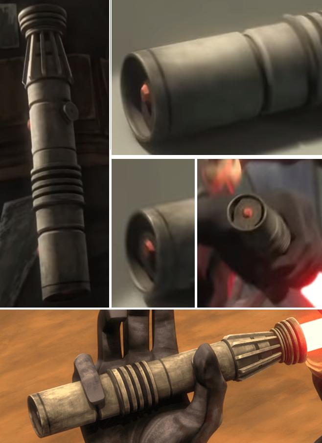

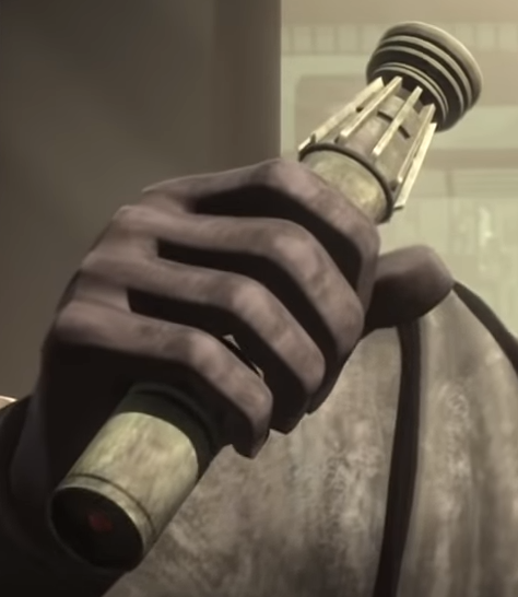

Here's the Clone Wars version... not a lot to go on but it's somewhat simpler than the cut end on the Master Replicas. Looks like there may be some additional detail around the gem but I couldn't find any better shots. Is there some concept art out there somewhere?

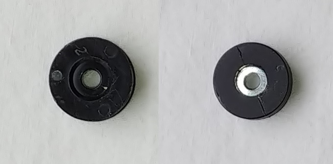

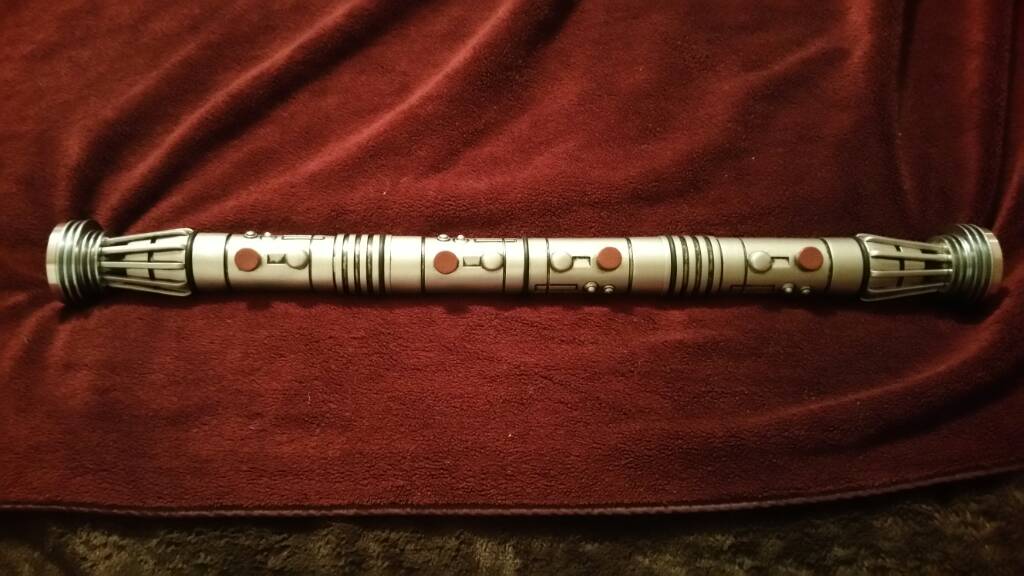

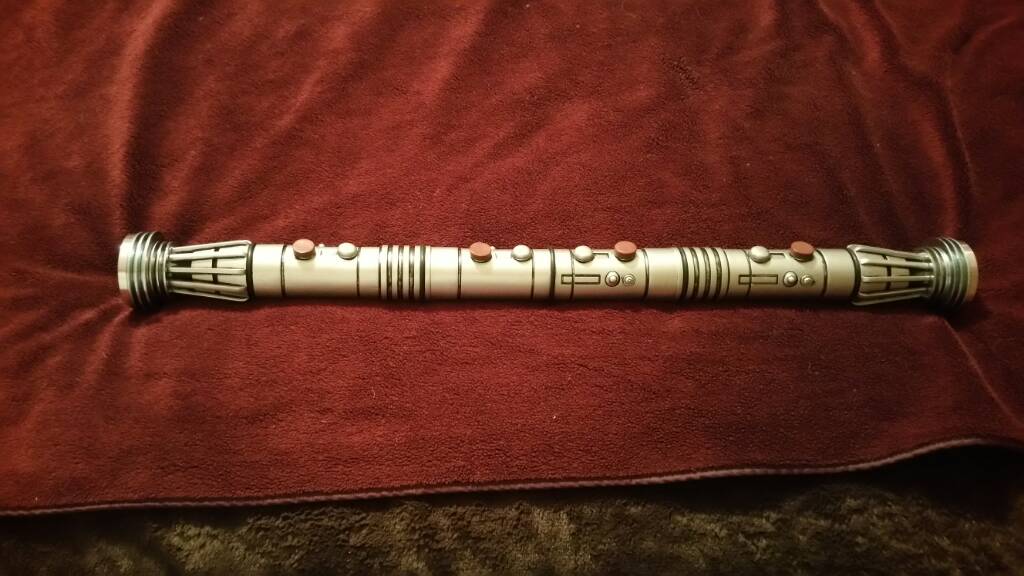

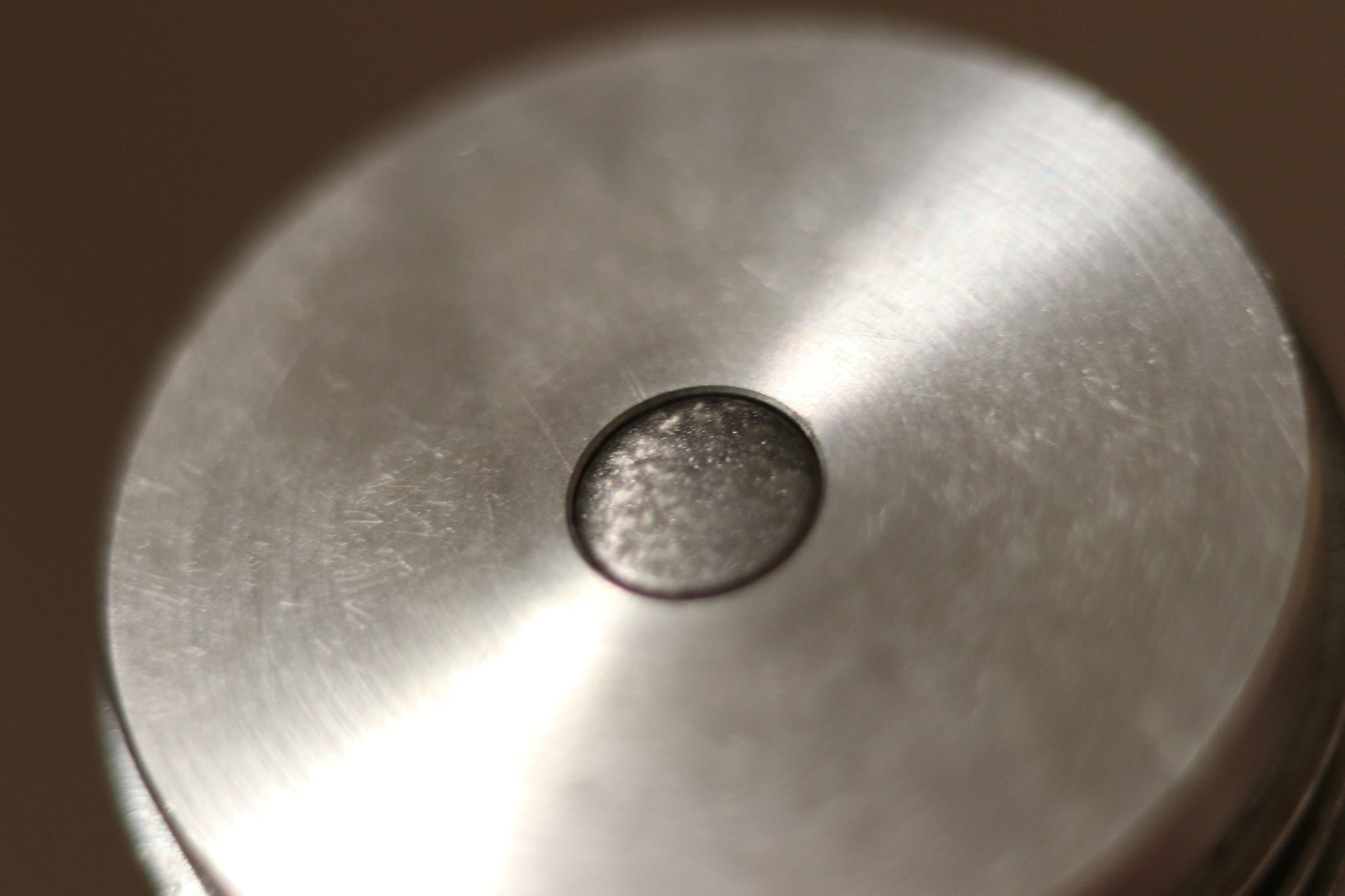

Got mine together. Thanks, Halliwax, for the threaded rod tutorial and assembly tutorial. I used a thin brass center washer from Hillman, it works great. I like the ability to slide the center alignment with a more slippery material. I asked Mister starkiller what he used, and he said a metal washer that he found in his spare parts. I like that choice, too-so I did similarly. I didn't even have to bore the center of the hilts to get them aligned. Guess I'll weather the washers and end cap when I get my V2 out.

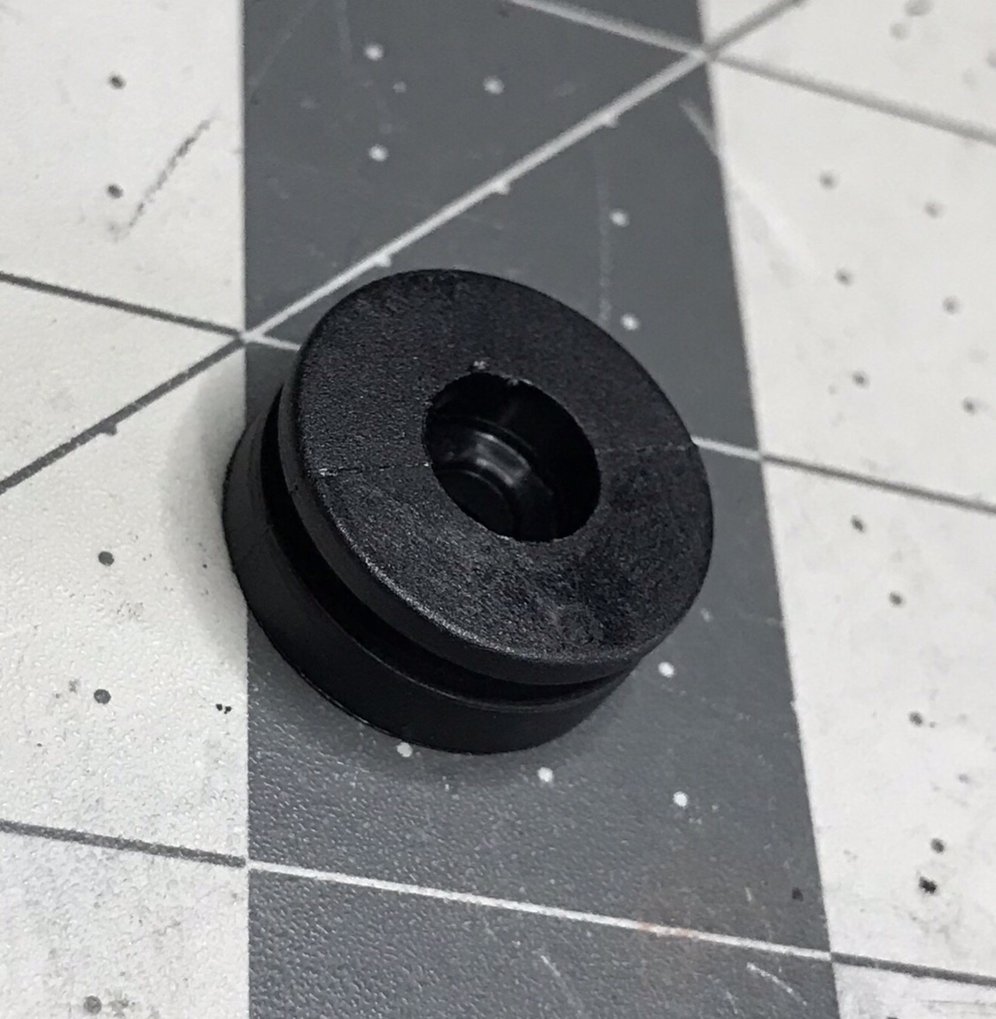

I'm wondering how accurate these remake Covertec clips are to originals... I had one back in the day and I recall them being glossy plastic without the mold lines. I know you can still get a later version official coverte clip that comes with the same wheel, I'm curious if those are cleaner.
I went ahead and did the button color repaint and painted the inner washers and emitter inserts and still finished in in about an hour.
Here's the covertec wheel I'm using on my saber. I've had it since the early 2000s.

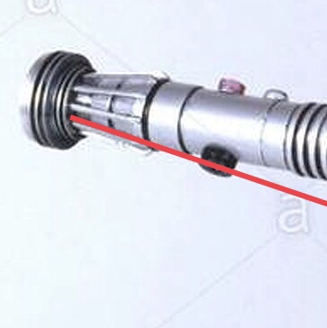

Here's another hero reference shot. To me it almost looks like that covertec wheel isnt 180 degrees on the opposite end of he buttons, it looks slightly to the right, if looking down the emitter.
Kinda looks like it’s sitting in between those 2 fins on the emitter... hmmmm
I used photos of the EFX replica when aligning my Covertec (which has a flat-finish and mold lines, as have all of the others I've ever bought). I went with somewhere around 6:00-7:00 for the positioning (with the red button at 12:00). Just slightly off-center, rather than 180 degrees from the red button. The emitter fins are not evenly spaced. One of them is closer to 6:00 than the next one over.
