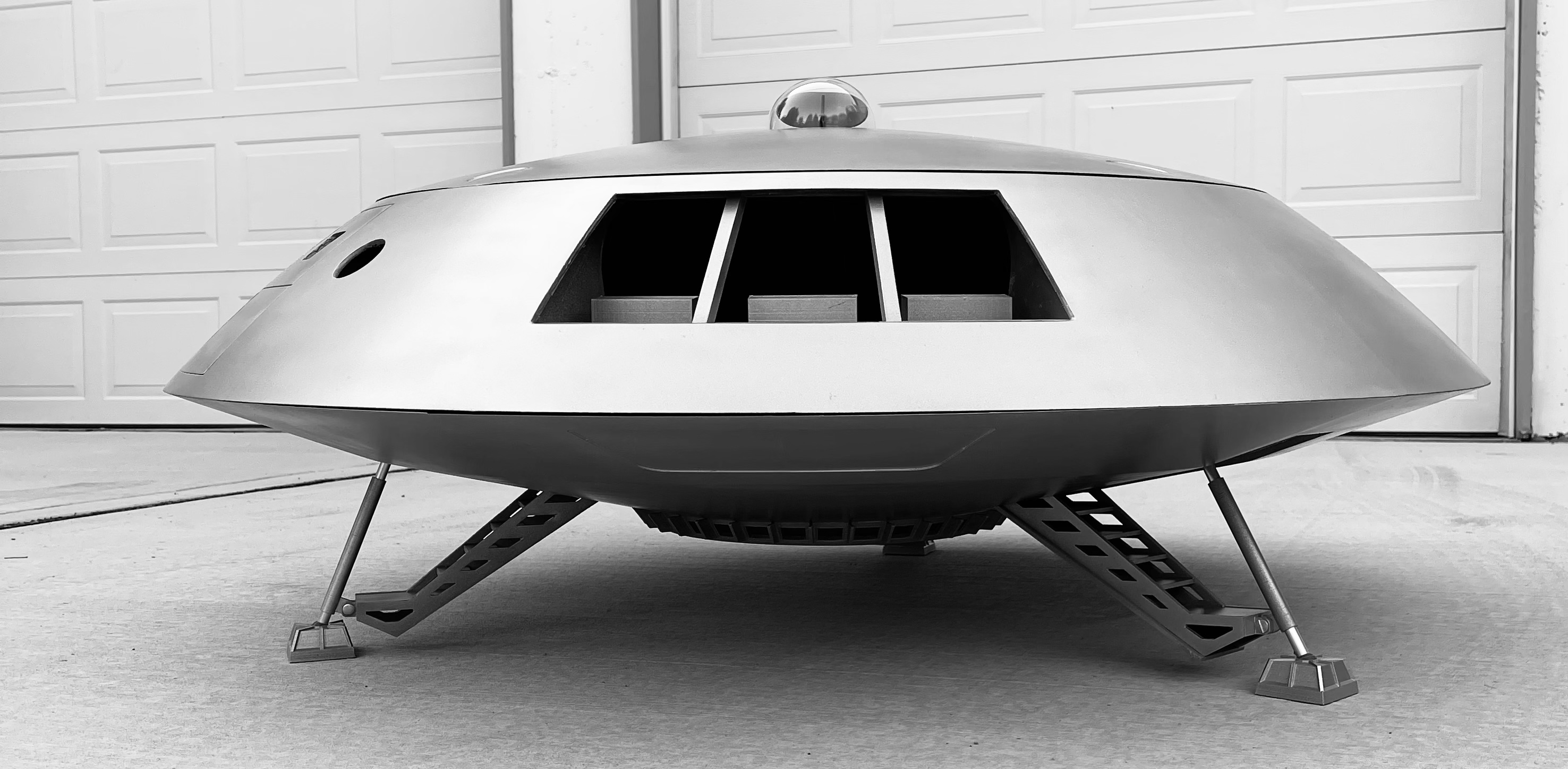

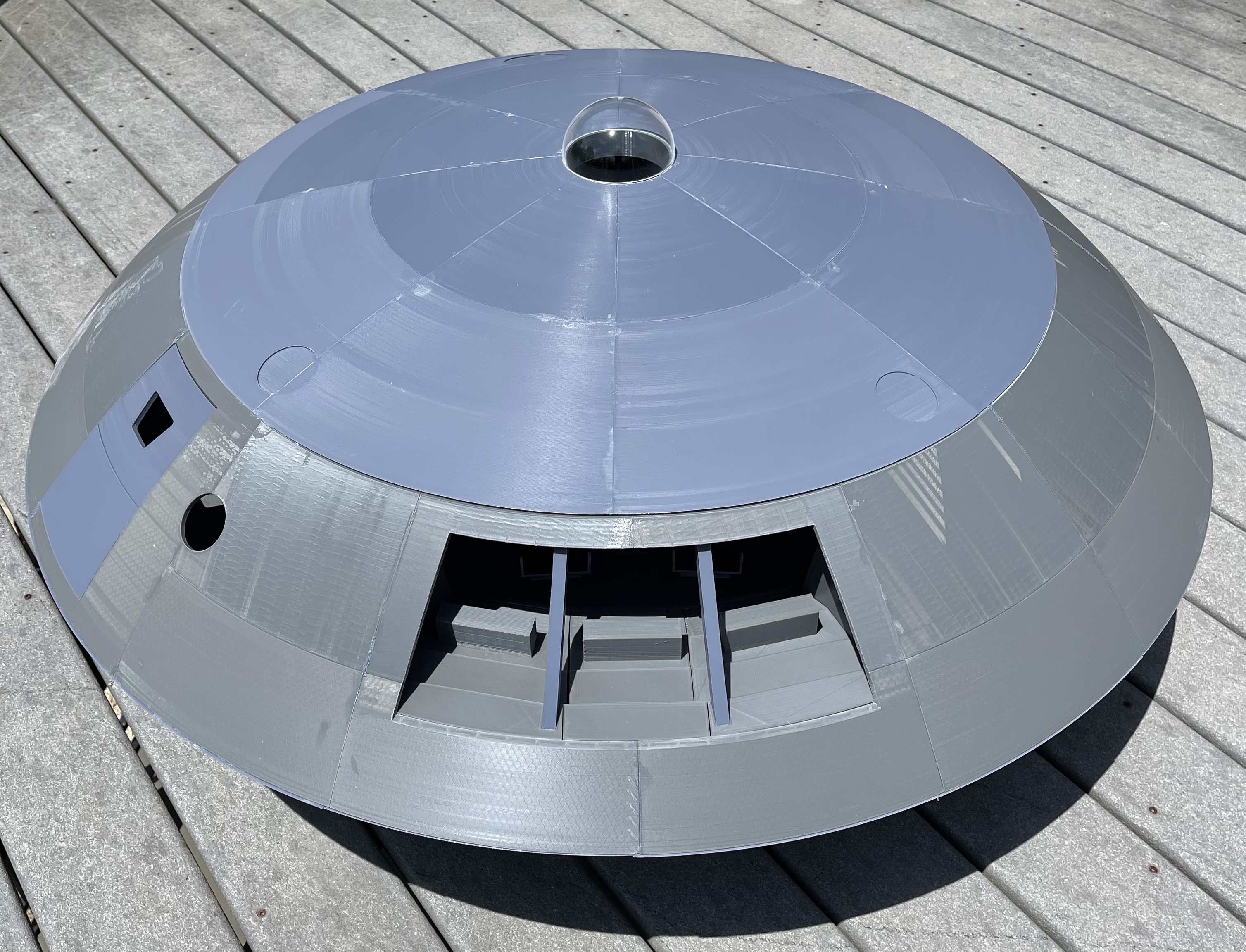

This is what I use to smooth my PLA prints. Brush on a thin layer, cure with a UV light, sand off the shine, and repeat 1 or 2 more times as needed. Here are the results off my Ender 3.
Also, just for clarification. It took more than just the resin to get that final finish. I also had to use bondo spot filler to conceal the panel joints. But the resin did a great job covering up the print lines, which I think is the intent of your original question.

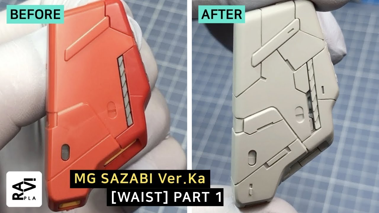

Keep in mind that bondo, resin and even plain sanding will also kill "desired" gaps, like panel lines.
But as this screenshot from a model builder video shows, panel line scribing chisels are great to have in your arsenal anyway:
