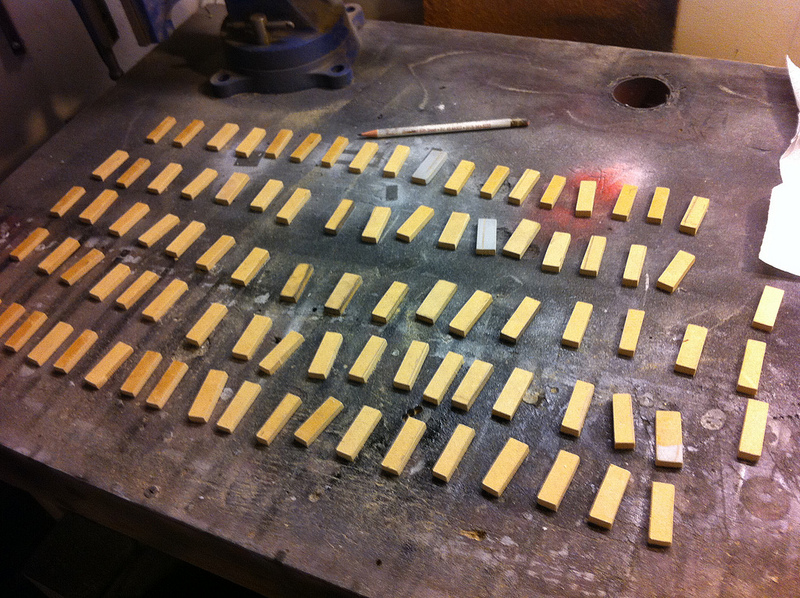

Creating the tread pattern is an exercise in insanity. Here's the process:
Cut LOTS of .25" x 1.5" wood strips (a great way to use lots of scrap MDF)
Hand sand each of them, then primer and paint
Then, using a paint brush, apply wood glue to the back of each strip and position it on the tread
Then realize that 125 pieces is not enough to complete even one tread
That said, I am definitely loving how these are coming out. Back to the band saw to make more pieces.
More to come...

More tread work….
Drawing out the cut pattern for the tread detail pieces
Yup, there's a lot of them
142 pieces cut and awaiting sanding
Sanded, primed and painted
Tread pieces glued to the tread plates and weathered
Oops, didn't cut enough pieces. Back to step 1...
More to come...
