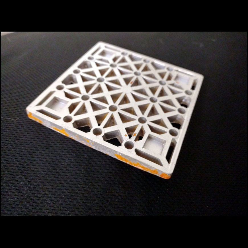

Step 3 was applying salt for chipping (my first time doing this) and then spraying the face and sides with Tamiya X-11 - making sure to not get proper coating inside the holes or gaps between the beams because the prop tiles were not thoroughly sprayed there. In this pic I had already started removing some of the salt.
The face, after brushing off the salt.

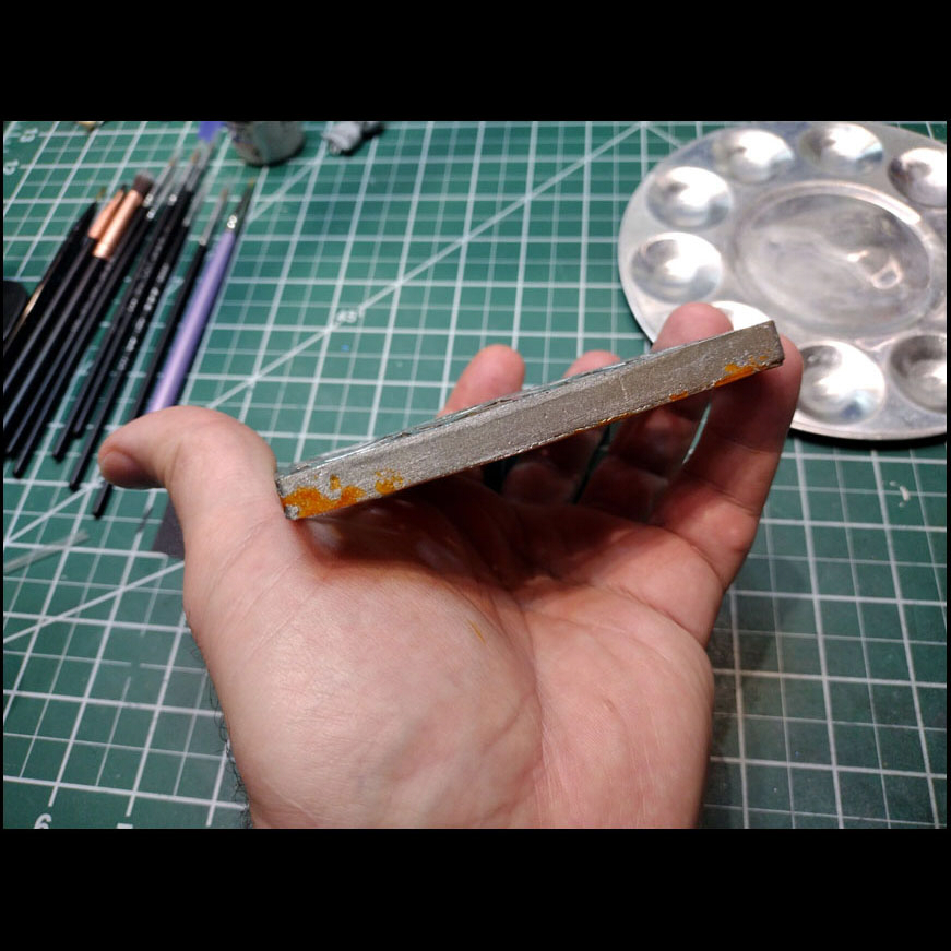

A side.
Rear+side. The real prop tiles had a wide variety of wear. This pic and the one above are representative of the most and least, respectively, that I saw.

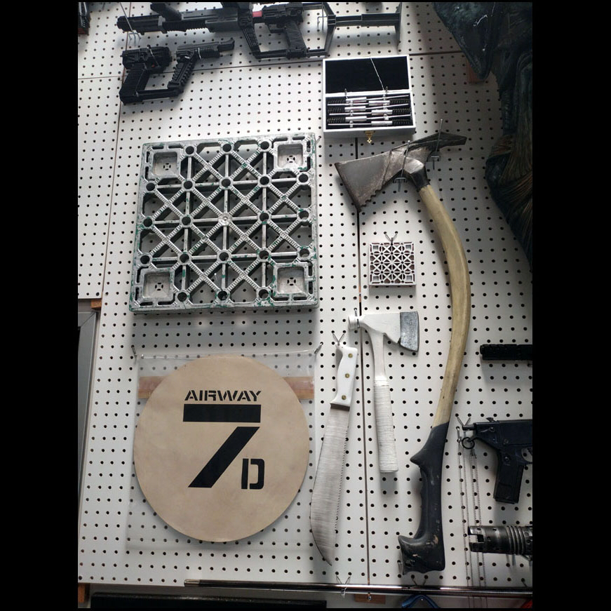

And hung near my 1:1 tile and related other Alien props and/or replicas.
