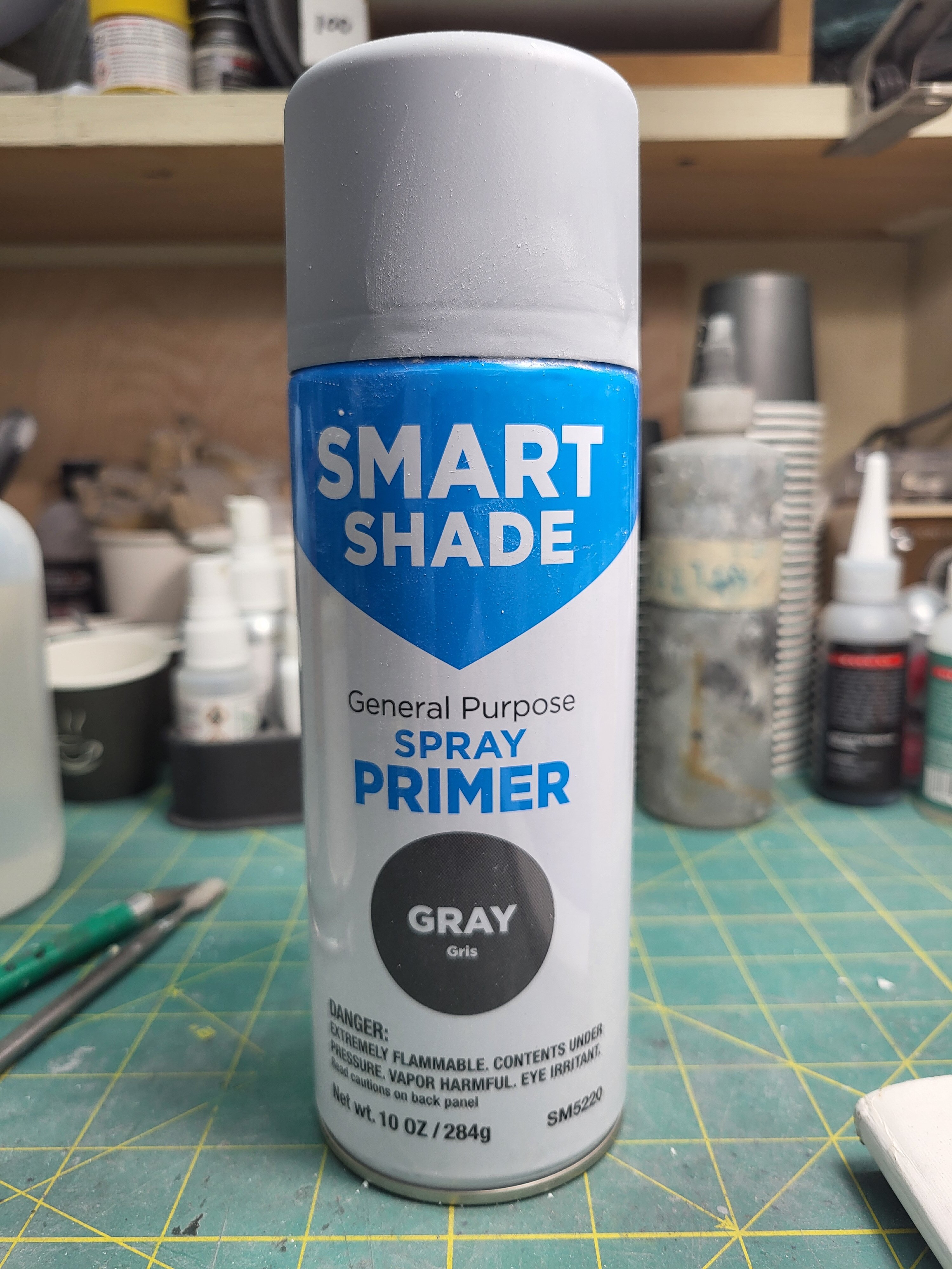

I used Duplicolor Primer Filler because I wanted something that would fill in any scratches from my misadventures in scribing. It went down great (insert mom joke) and only a few spots needed the attention of a little more filler.

The next day I began masking the wing panels and it was immediately apparent that something was up. Even after drying overnight, the Tamiya masking tape was lifting the paint off as I repositioned it. This was a serious blow. I had never experienced this before. The only thing I could think of was the Archive-X and the Duplicolor didn't like each other which was weird because I've sprayed it over lacquer primers before with no issue. It was that or whatever was going on with the paint was causing it.
I got the panels masked and used my go to TIE panel color, Mr. Finishing Spray 1500 Black. It's lacquer based and has a perfect sheen to it. It's also my favorite primer on the market. Sprays beautifully, acrylics don't treat to it, dries smooth, durable and dries fast with a hairdryer.
When I removed the tape not only did some of the blue paint come up but some of the black as well. This led me to believe that it had something to do with the Duplicolor primer.
