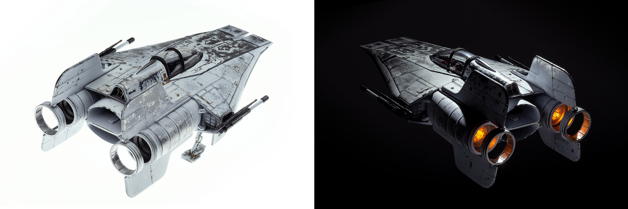

The idea of this build and paintjob was to not only replicate the white paint scheme but also try a paint chipping technique over metallic basecoat. I did it once before on a Bandai 1/72 scale A-wing and it was a partial success. Some of it went wrong, some areas look nice. I figured I got the hang of it though. This is the look I wanted for the big N-1.

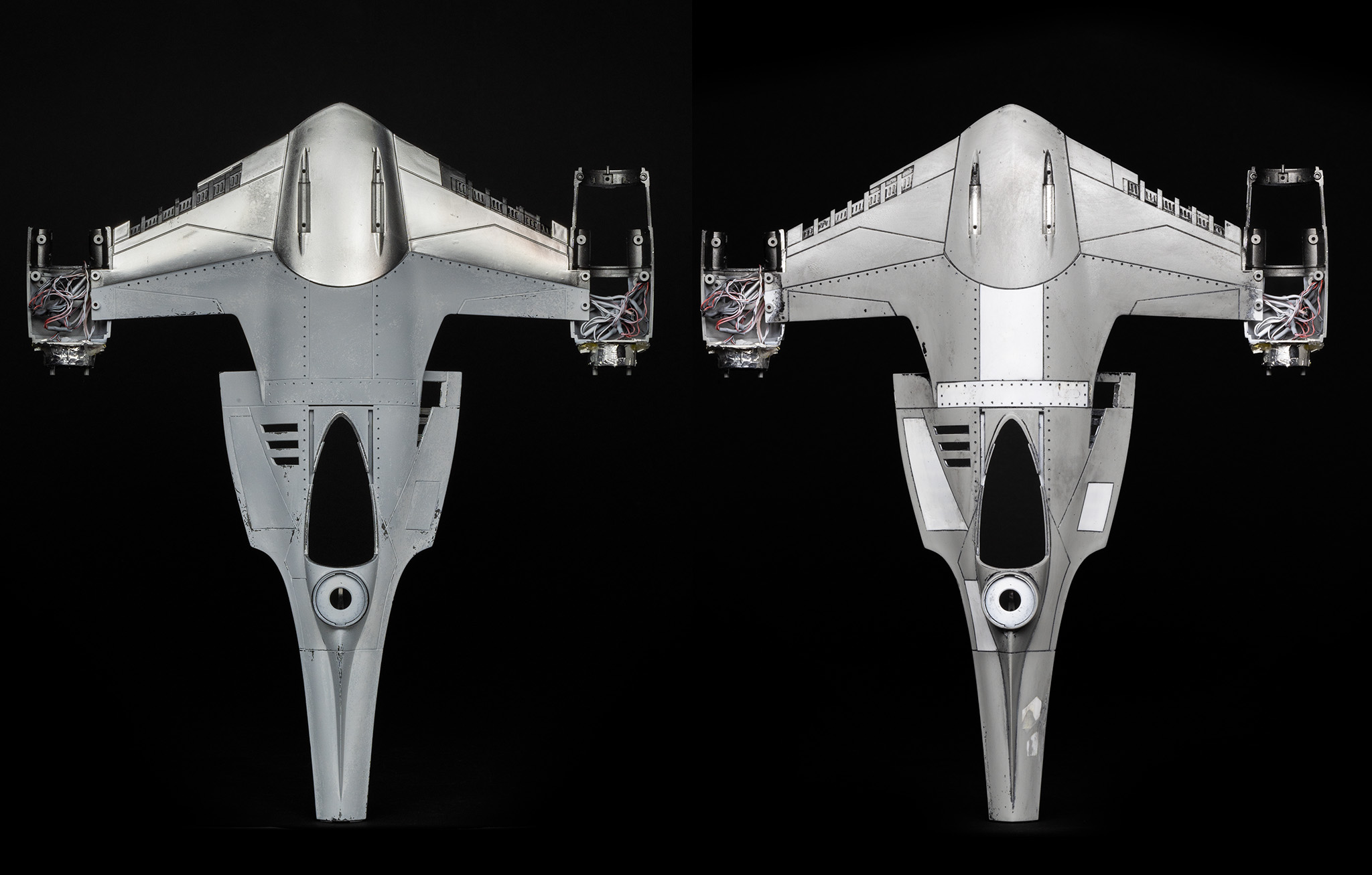

Well, after a good night's sleep I decided to stick to the original plan and paint the body white. I did like the bare metal look the body had after I washed the white off earlier but it would have lead to trouble with how to make it work with the engine cowls which already were white. I will save this look and how it happened for something in the future.
I figured the new pass with white would look nice if I made it thin enought for the metal/white show through a little, like preshading. It turned out I didn't like it. So, I decided to strip everything off from the top side and start over.
The thing was that I couldn't remove the paint by a drain cleaner bath, as I mentioned earlier. There are leds and electric wires in there. So I took a risk and wiped everything off with acetone. Acetone is very aggressive stuff and it does attack styrene, but the thing is that it evaporates in seconds and the reaction is too fast for the acetone to ruin the plastic. The paint came off easily and now I only need to clean/rescribe the panel lines. Also I get an opportunity to do something about those rivet holes, I made them too big.
Furthermore, this process was done so that it didn't affect the paint on the bottom side of the wings. They were okay after the first try and didn't need to be fixed. I'm happy how this worked out.
The second white pass on the left, after acetone on the right, not cleaned/sanded yet. All I need to do now is rescribe the panel lines, fix the rivet holes, clean everything with 2000 grit wet sandpaper and repaint.

I painted the N-1 body using two shades of white. Straight white on top and slightly darker white with just a touch of light grey on bottom, masked with salt. I've used the salt method many times and it worked as expected. No surprises there, I generally like the effect and I do it routinely. It's subtle, fairly controllable and adds cool patina to any surface. But the thing is that the body now speaks a different language than the engines and some other bits. I overlooked the effect of painting two layers of white, the coverage is better. Also, there is no metallic undercoat, so the paint obviously will look different. I underestimated the significance of these things little as they are.
The body would look nice once weathered, I know it would, but in the end it is, and will be, warmer tone to that of the engine. I cannot unsee the colour temperature difference and it drives me nuts. If you look at the engine and the white on the wing in the photograph you'll see it too.
I'll wipe this clean with acetone again and start over – for the third time. Black basecoat, gloss black, polished aluminium and white on top, that'll do it. This is borderline obsessive I know but what can you do? :)
The small rivets turned out really nice though, very small and in perfect line and spacing after fixing only three of them. This was a success and I'm sure I'll use it again when needed. Quite happy with this actually.

The white paint was a success. I learned a thing or two in the process but I'm pretty satisfied with how this looks at this moment.
There is no weathering applied just yet. This is the white coat after removing the salt mask. I like the salt method because it offers very small scale organic looking detail. I guess the effect could be achieved with adding chrome paint on top with a sponge or such as well. I just never have managed to get that to look nice. I've tried. Whatever the method, I like how the metal undercoat reflects light where the white is missing. It makes this thing look bigger than it is. Although, I gotta say, at 1/24 scale this thing is pretty big.
The weathering will be subtle panel lines, dirt streaks and such, the usual, maybe some decals too, nothing too flashy. Originally I intended to weather the chromium front piece as well but now I'm not sure if it needs it.
There was a small issue with the big spoon shaped bottom plate. It didn't want to go in nicely and the seams are not pretty in couple of places. I need to fix it somehow. It's not terribly bad but if I ever build another one I will leave the spoon to be painted last after everything is securely glued shut.
The engines are lit with three amber leds each. Cool bluish white would be the N-1 engine colour in Star Wars canon of course, but this is a custom, I wanted to make it a little different. I thought magenta but I couldn't find small enough leds in that colour. There is not much room in there because those engine spikes need a base to attach them to. Magenta would have been a nice nod to the X-wings.
I'll post proper photographs of the finished model once I get the weathering done.
