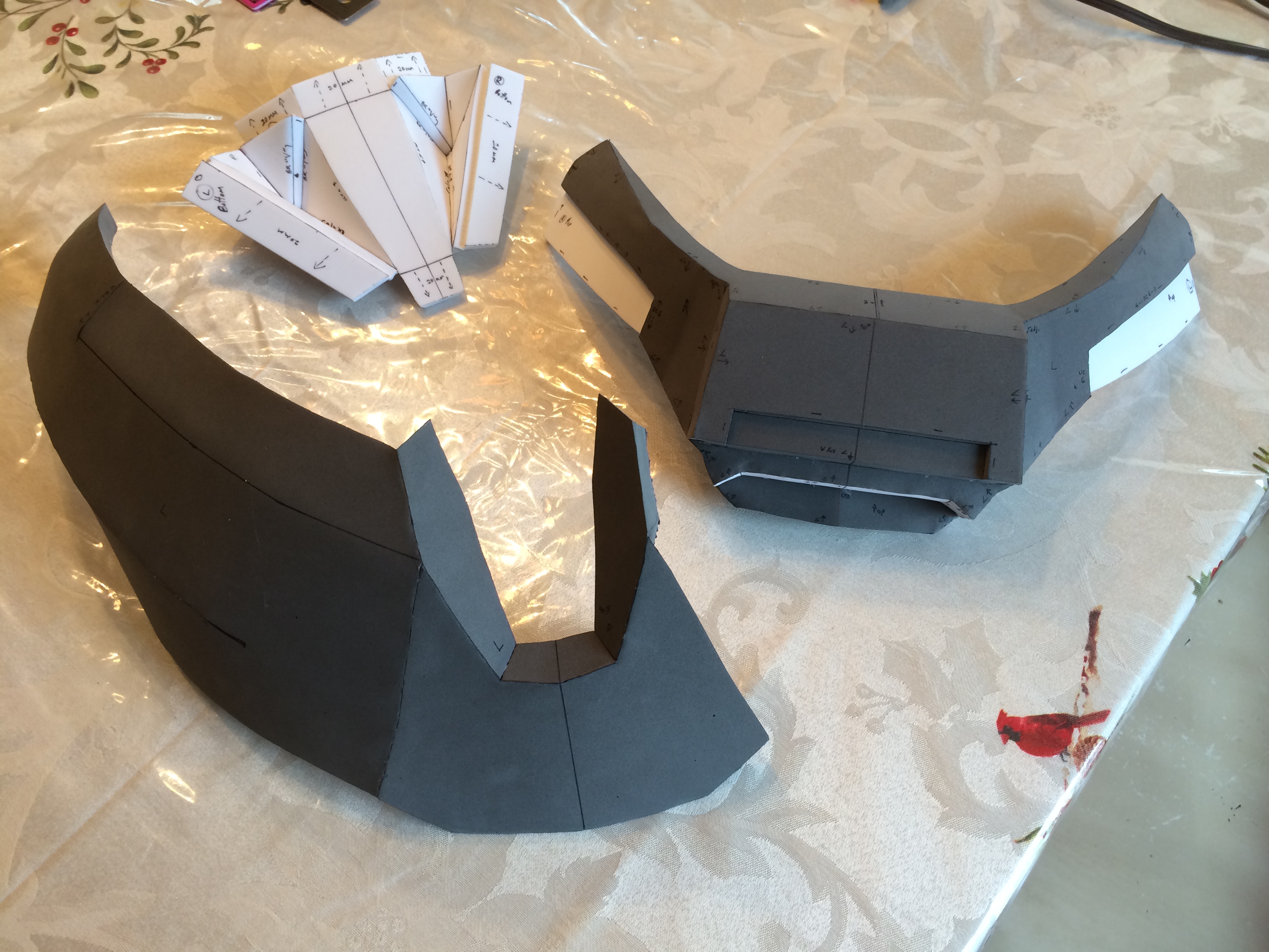

Started glueing abs and cod together. Here's another example of getting some details with foam by undercutting and layering pieces (compare to the 3D pep model).
For getting even spacing for indents, like the slots on the abs, I used a 2mm piece of scrap foam as a spacer, then glued from behind. Doing this gets you a nice, straight inset.
Abs done. These are three separate sections that I'll link together inside the costume with elastic straps.
On to the cod, starting with the back, "tailbone" piece... which was difficult, and that's an understatement. Whoever designed this was simply evil ;)

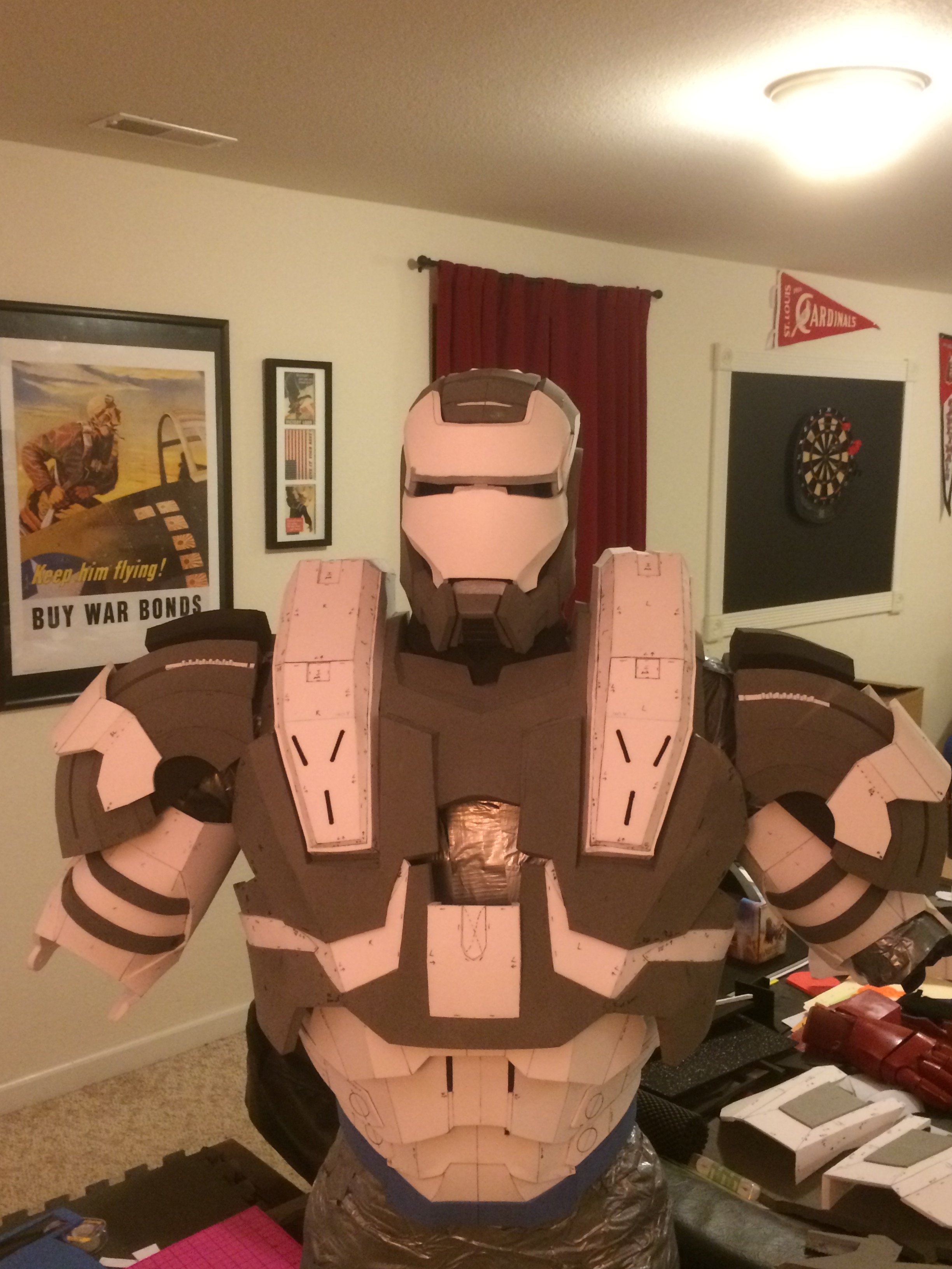

Feel like I have a steady build pace going again! Only have a few more pieces to glue to complete the cod. I'm still not decided on where to have the opening seam (Velcro backed) so I can put it on more easily; thinking ahead to assembling parts and in what order I'll be putting on sections. I'm thinking I'll do that on the right hip rather than the front or back. I don't like having obvious seams. Any other ideas are welcome.
