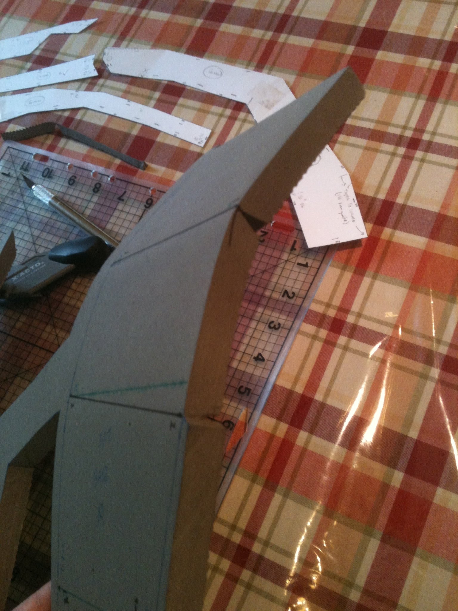

Tip: I often found it easier to add feature details to templates and trace them onto foam BEFORE cutting and assembly (example - a groove and bolt marks on biceps). By doing this, you ensure even placement of features on left/right side of your build. If you're using STEALTH's method of cutting out one template and flipping it over for opposite side, this will save you time and extra work.
Other KEY tip: They're not kidding when they tell you to keep a SHARP blade. If you want clean cuts for your build, keep your Xacto sharpened or have lots of replacement blades.

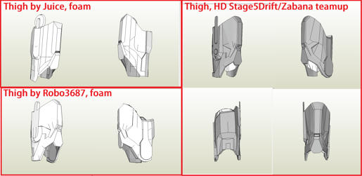

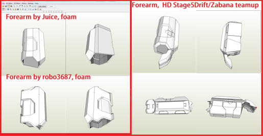

Depending on how far you are, I've got reworked foam unfolds of the original hi-def Zabana/Robo paper peps.... These are different than the other foam conversions floating around;tThey are a bit more difficult to build, but I wanted as much of the paper-pep detail built into my foam build as possible. Here's what I'm talking about (my foam unfolds follow the HD Drift/Zabana models):
If you're up for trying them, I'll upload a ZIP with those parts and post a link. I built a couple of suits using them, since then they've just been gathering dust in my hard drive.

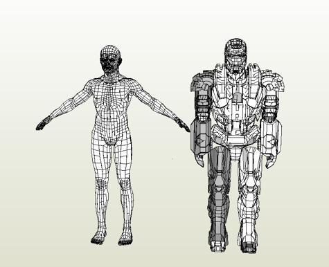

And, just to give you more garbage to download, the following file is a not-unfolded PDO of all the above pieces at their individual scales assembled, next to the mannequin of the guy they were built for. That file comes in handy to check part sizes in relation to each other. good luck on finishing your suit!

Here's one example of the foam layering I was talking about. The pieces in the picture are part of the chest, side pieces that go around the lower rib cage. I used 1/2" foam (exercise mat) for these pieces. I cut inward from the side of the piece to create a "step" where it's neighboring piece (6mm piece) will go. This creates an overlap, and on the surface creates an inset that matches the template. Knowing how deep to make the "step" depends on your template scale - so use point-to-point measurement. In my case here, I think this resulted in about a 4mm step. You need a sharp blade to do this cleanly.

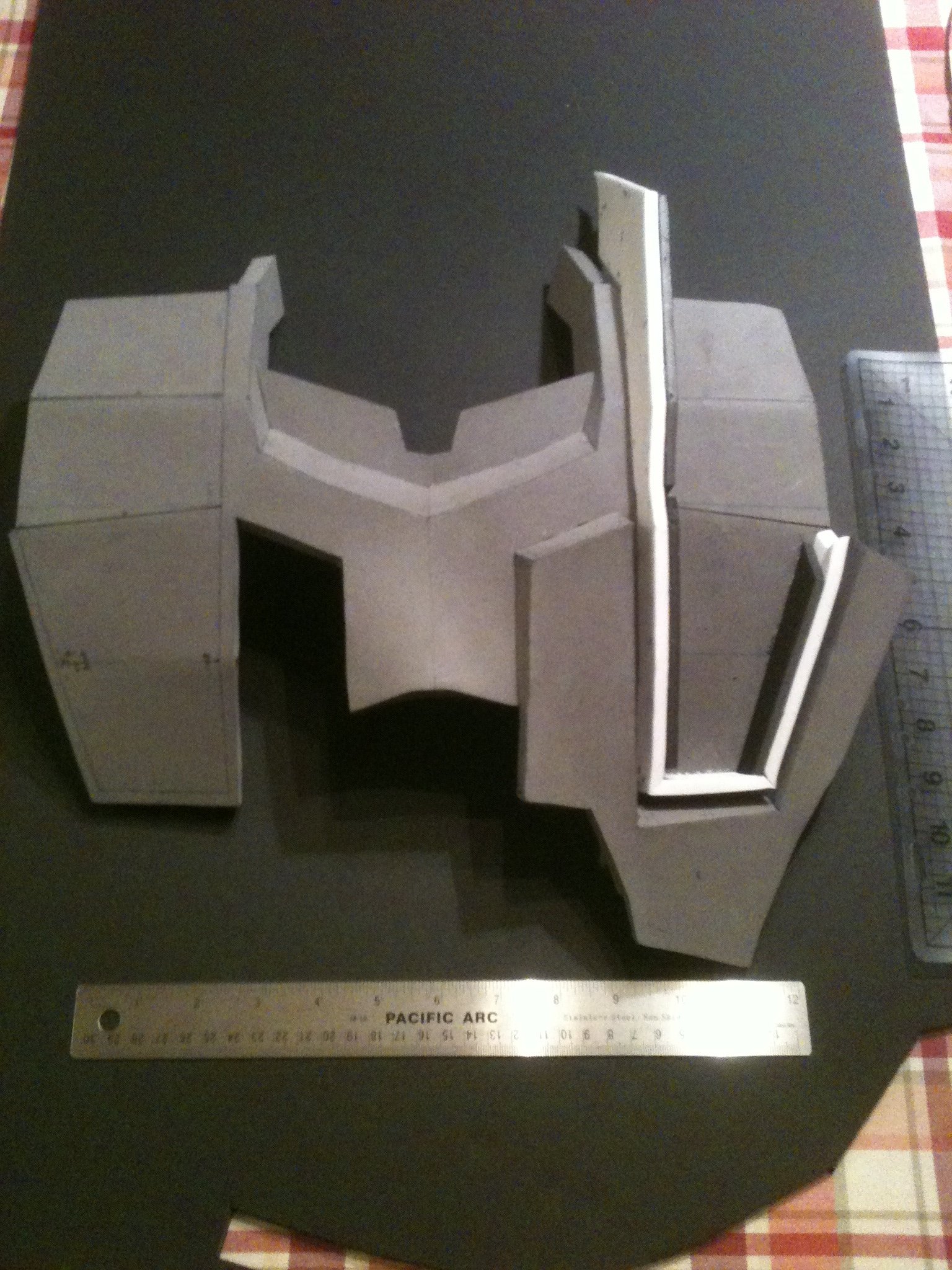

Some of the work done on the chest plate. Modified a little bit from the template to create a single base for the "straps" that come over the shoulders (see pics). I cut the foam on the backside ("V" cuts) to make sure the whole piece was angled the same as the template. This created a solids base for the foam chest strap pieces. I also added some solid core/rigid foam inside the chest straps to reduce any flexing and to help keep them straight.

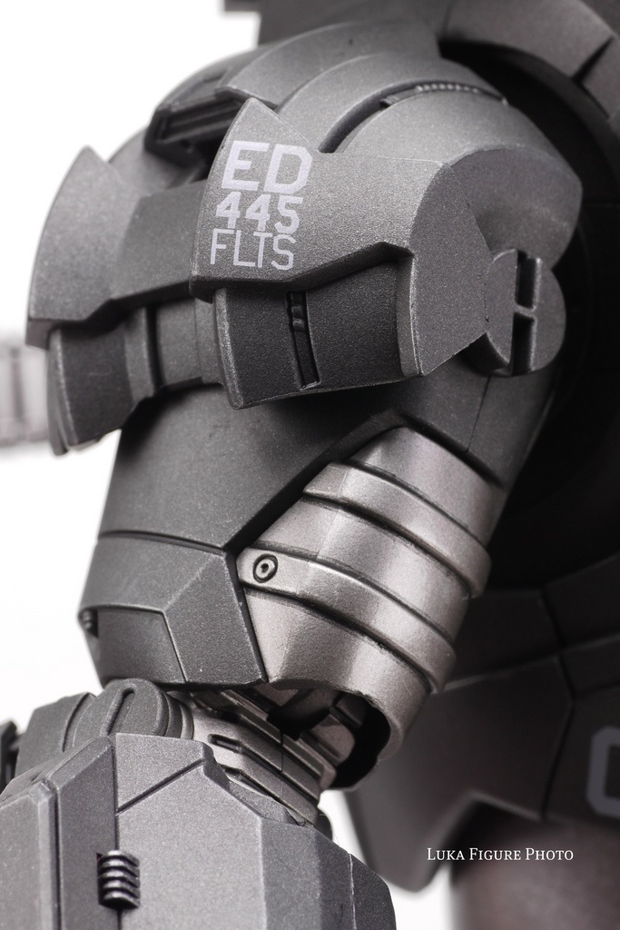

Work on the biceps...gotta show off some muscle. :)

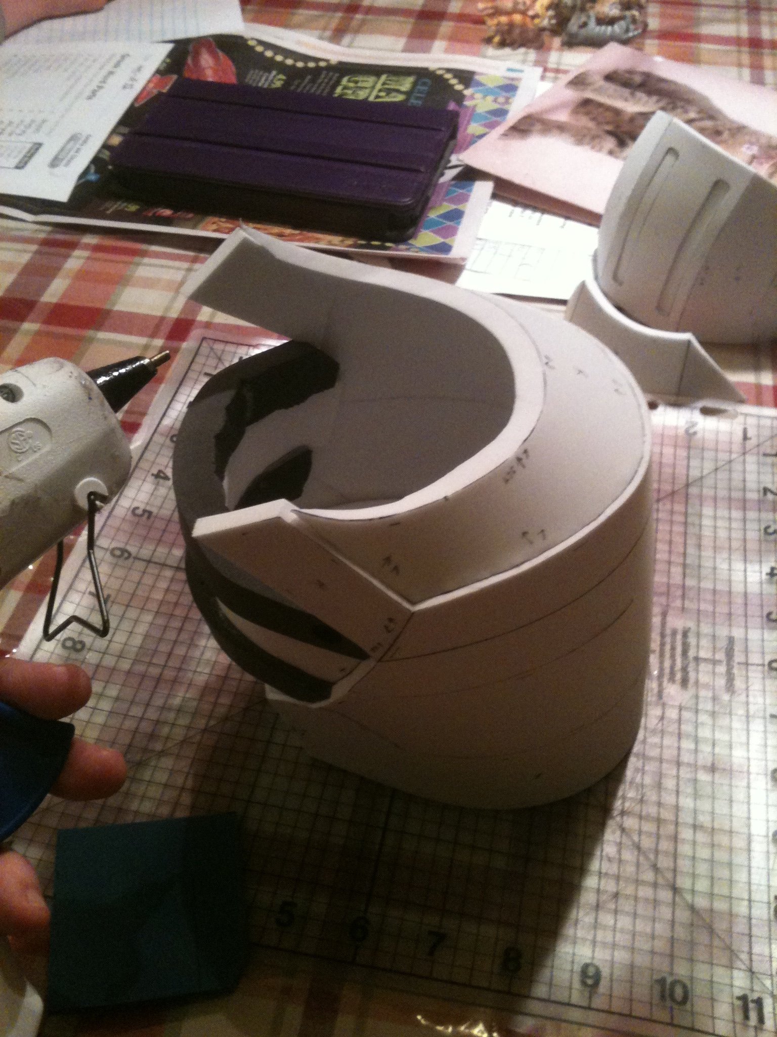

I used some of the extra pepakura template pieces (typically not used in a foam build) as guides to make these. I did this on the front face of the bicep and on the back. I basically taped the card stock guide to the foam, and used it as a stencil to mark setback lines for gluing to the next piece. By doing that I was able to replicate some the small edge details from the pepakura model on the foam section (see the "edge/lip" on the back of the bicep and comparison to a model). It was a little tedious doing this, but I liked the results.

Update - chest and arms. Still need to connect the forearm-elbow-bicep pieces. I'm planning on using chicago screws, which work great. Need to figure out connection point to the forearm though.
