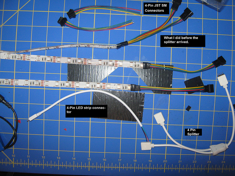

I've been lurking and watching this thread for months while slowly putting together my own Tron inspired costume using LED strips. Here are some WIP photos. I may start an actual WIP thread if I ever decide on a specific costume.
Forgive the blurriness. I don't know if it was because the picture taker wasn't steady enough or if the camera just could not handle the how bright the LEDs were. The lens flares are where the LED strip slipped out of my homemade diffuser.

In the next day or so, I'll put up photos of the LED strips laid out and with the diffuser off in my WIP thread, including pictures of the connectors and power source. I also have a few action shots from the time I wore it dancing with my plain clothes. I haven't had any time to get pictures of this versions of the lights in use with more Tron-like clothes yet.
Closer shot of the strips and connectors.
More photos here:
http://www.therpf.com/f24/tron-legacy-themed-wip-170254/
