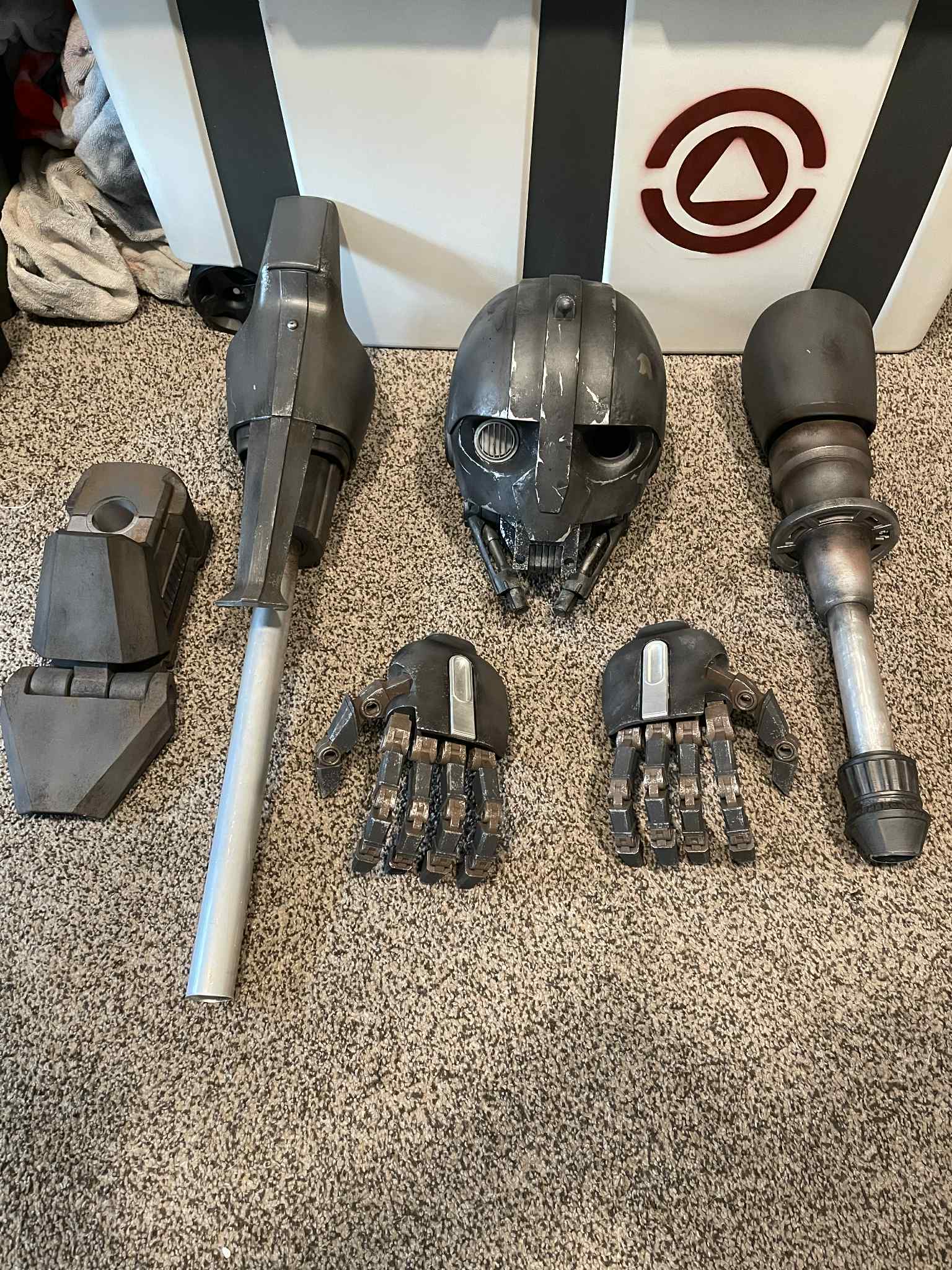

Not directly captain silvo, but I figured you guys would appreciate it. I'm building a full size SM33. These are the parts I have done so far.

Here is a link to the thread if anyone wants to follow the build. I'm going to be pretty brief with the descriptions but if anyone has questions I will answer with more detail.
Definitely don't let all the replies hold you back from your deadline but woooooow, that thread is sweeet!! I encourage anyone seeing this to wander over to the SM33 build linked above. For everyone who has their Silvo/Jod completed..... but do you have your SM33 to pose with????? Ha, love it.
