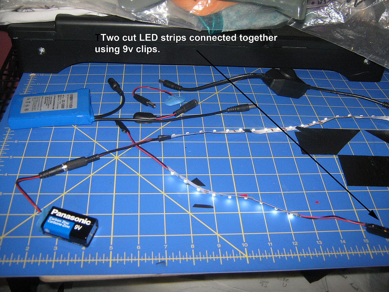

So question what kind of wires would i need if using an led strip and what kind of inverters so i can figure out the actual cost of this costume.
The layout of your strips is going to be really important. Nine-volt batteries are best if you plan on several disconnected lighting sections.
Assuming you already have soldering tools, the bare minimum you need are a couple 9V batteries ($1-$2 ea. for cheapies), a 5m roll of 3528 60 LEDs/m LED strip (~$12 dollars if you get it from China, ~$20 via Amazon), 9v Snaps (~$2 per 5-pack, get like 4 packs).
Optional: A 12v 3Amp dimmer ($5-$10) - it will give you an on/off switch if you use normal batteries and allow you to control the brightness of the lights.
Optional: Skip the 9v or 8xAA battery and buy a 12V 6800mAh li-ion battery off eBay/China for ~$25. It'll power the full roll of lights (it's unlikely you'll use the whole roll) for 3hrs. In comparison, 8xAA are at most 3000mAh and a 9v is 565mAh. It also comes with it's own on/off switch and if you want to control brightness use the dimmer.
Go to page 190 of this thread and read post 4728 by AOIfrost. He includes a link to his blog and a youtube video he made of how he put together his strips. I linked 2 instructables that used a similar method in my WIP thread ("Child's Quorra (Tron) Costume" and "LED Pants").
I also made some pictures just for you. :)

Thanks! not planning on a whole lot of junctions so the wire circuit shouldnt be too difficult im still planning on the same design i put on the coat but instead its going to go on the bodysuit instead.
I'm assuming you're talking about your sketch in post 5313. Even as a bodysuit, doing the bit at the waist and the section on the arms is going to be tricky. I see 6 sections: L+R arm, L+R lower torso and legs, L+R upper torso and back. Seven or eight if you throw in the waist and neck part. Is the circle part of the design or just to represent you're identity disc?
You might be able to do it as one (dis)continuous line but I can't think of how right now. It will be easier to split it into at least a left and right half. You're going to need to make or buy some form of splitter or use separate power packs in that case. Decide on what to use as power source and where you're going to put it. That is further going to alter your design. It will also determine if it's easier to make a buy the splitter.
In general you'll want short wires or connectors wherever you want angles but no noticeable gap in the lights. The 9v/PP3 snaps are pretty easy to hide. Use longer* wires where you want it to look like the lights stop and then start again elsewhere.

* The longer the length of wire you use the thicker it will need to be to safely handle your current. Someone posted a link to wire gauge chart in this thread already.
On a side note, a photo of me on one of the times I took the lights out for a spin. The wires I used were not easy to hide.
