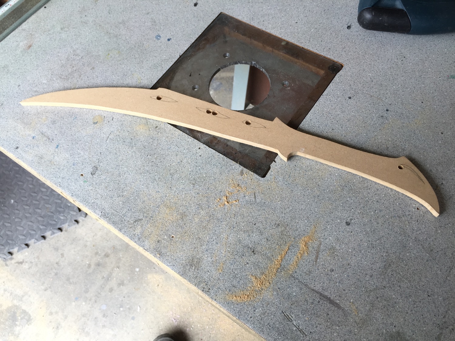

I started with a piece of scrap 5/8" thick MDF that I sawed down to 3/8" thick.
Transferred reference to MDF.
![tdcoregeek-1.jpg tdcoregeek-1.jpg](https://therpf-f28a.kxcdn.com/forums/data/attachments/235/235090-d80f89095b2c2a699144d819e803d755.jpg)
Drilled out spots to make cutouts with scroll saw.
![tdcoregeek-2.jpg tdcoregeek-2.jpg](https://therpf-f28a.kxcdn.com/forums/data/attachments/235/235091-ac3e888aacd5bc54659f6ae7c766e324.jpg)
Cutouts made. I decided not to cutout the two small hole on the blade. I didn't want to deal with them during the molding process.
I also decided to cut them in one string so I wouldn't have to fiddle with removing the scroll saw blade a bunch.
![tdcoregeek-3.jpg tdcoregeek-3.jpg](https://therpf-f28a.kxcdn.com/forums/data/attachments/235/235092-340c95dd01c4360fbae2977dea212414.jpg)

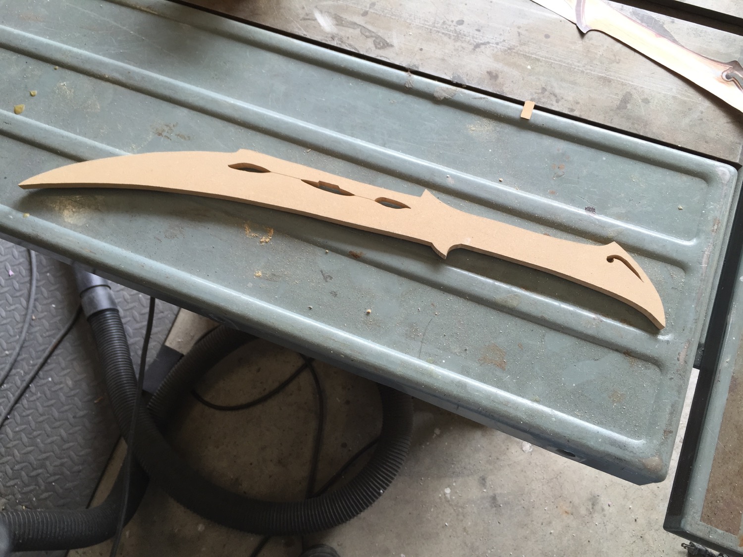

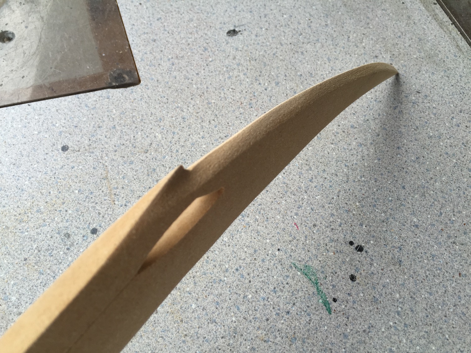

Starting the bevel of the blade. I freehanded this with my bench belt sander.
![tdcoregeek-4.jpg tdcoregeek-4.jpg](https://therpf-f28a.kxcdn.com/forums/data/attachments/235/235093-9bc609ce7925372435c3bababb923ab7.jpg)

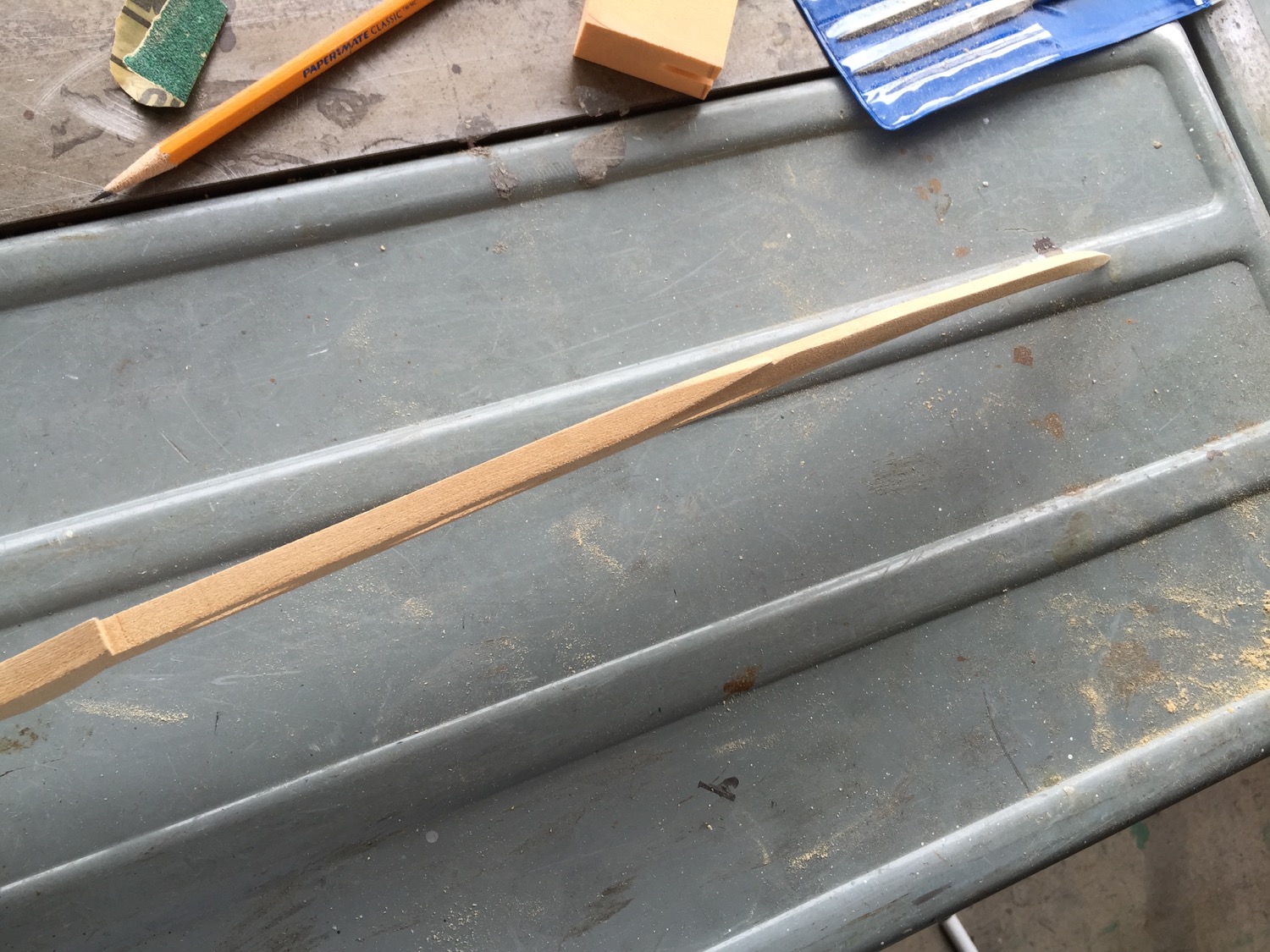

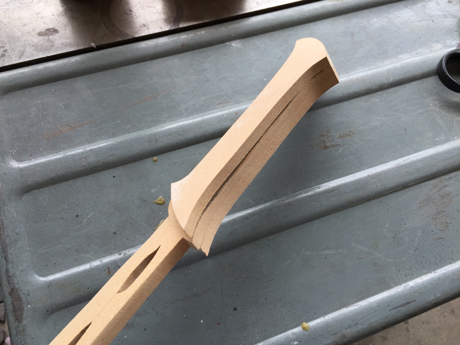

Shaping the blunt edge top.
![tdcoregeek-7.jpg tdcoregeek-7.jpg](https://therpf-f28a.kxcdn.com/forums/data/attachments/235/235096-ebb55149bea3a61efb6c5ffbd0d818f3.jpg)

Built up the handle thickness by gluing MDF slats on each side.
![tdcoregeek-11.jpg tdcoregeek-11.jpg](https://therpf-f28a.kxcdn.com/forums/data/attachments/235/235097-87f94b62dde43827f40c3339bbc2f19e.jpg)
![tdcoregeek-12.jpg tdcoregeek-12.jpg](https://therpf-f28a.kxcdn.com/forums/data/attachments/235/235098-9f327553ed2293e60f52735a2c5f2dd6.jpg)

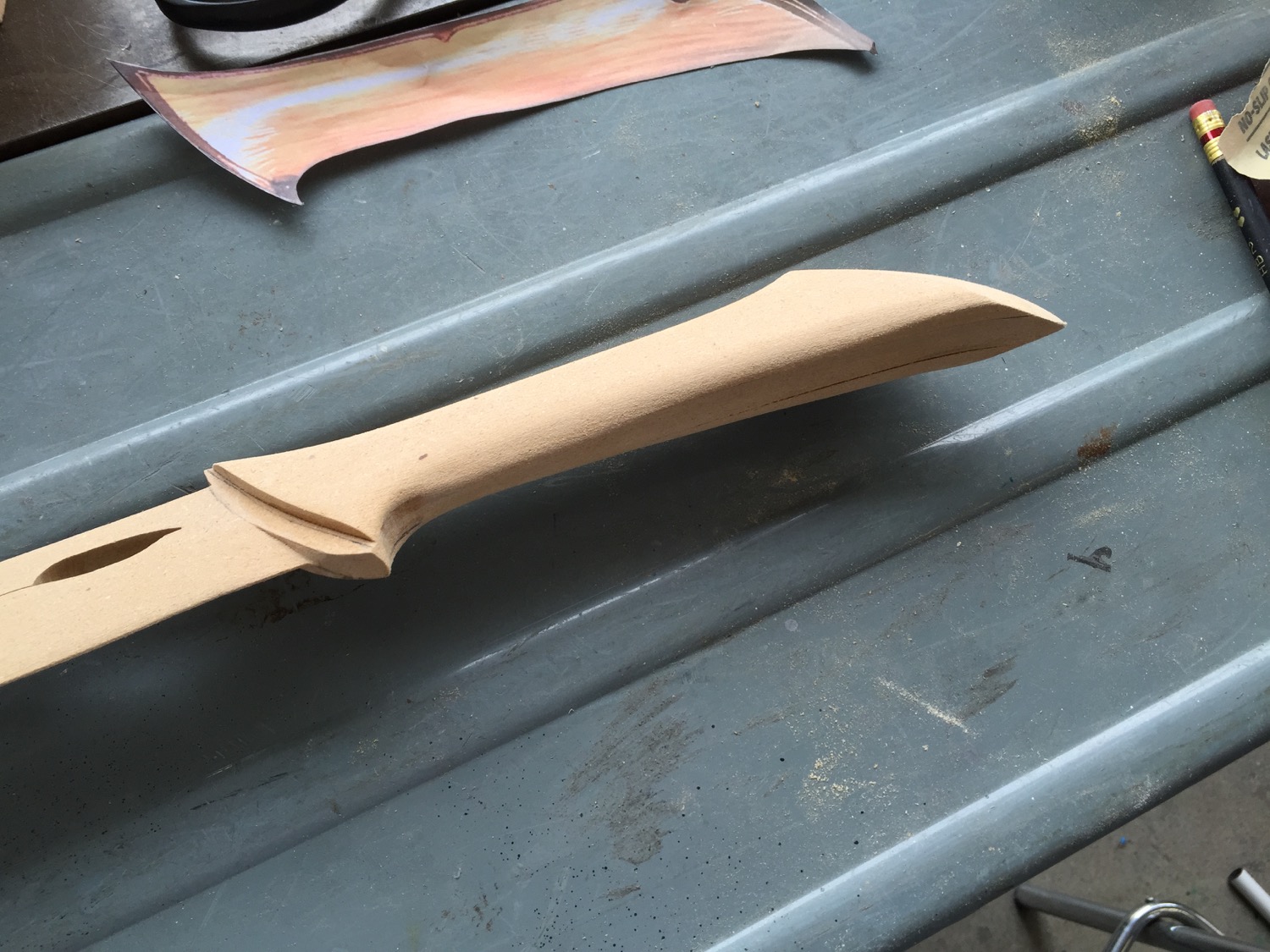

Shaped the handle with combination of belt sander and hand sanding. The handle had several angles that made it a bit of a challenge to get right.
![tdcoregeek-14.jpg tdcoregeek-14.jpg](https://therpf-f28a.kxcdn.com/forums/data/attachments/235/235099-b11b47a4e23afadba2215e326cd86c2e.jpg)
