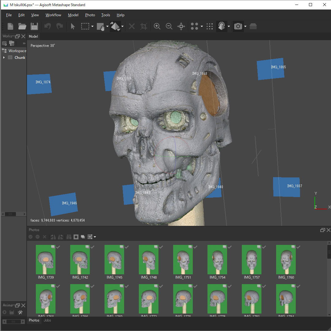

What did you use to coat the skull you photographed for photogrammetry?

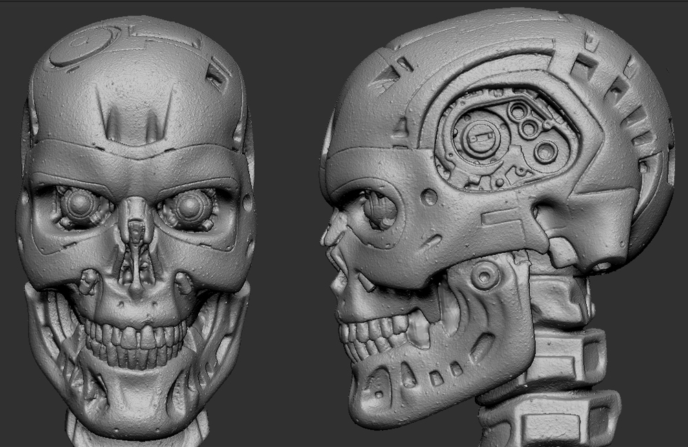

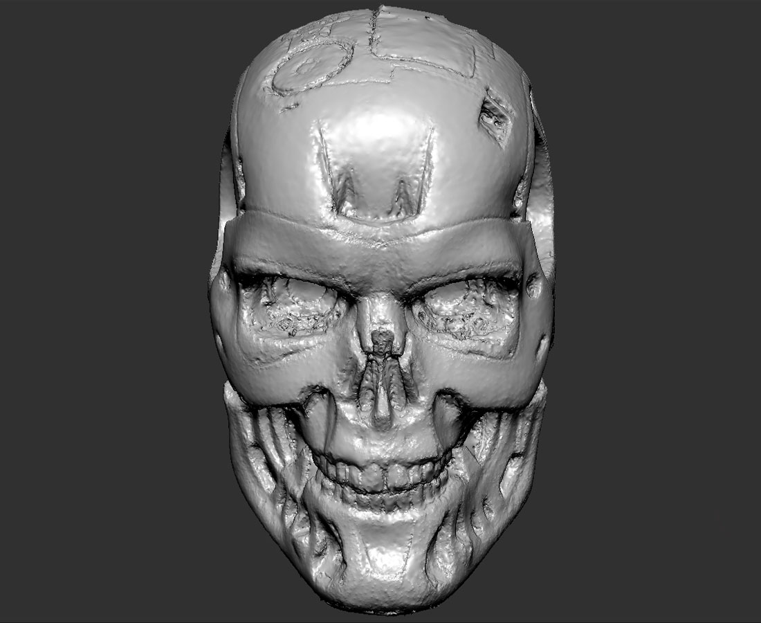

Photogrammetry is almost the same as 3D scanning.
Mirror surfaces cannot be scanned, so a water-based color is applied to the surface.
Noise is inevitably generated, so ZBrush is used to polish it.
Thanks for the illustration and explanation. I've been trying to get into photogrammetry for a while, but most of the apps for it doesn't work on my old phone... and many of the online options are either paid or limited in how many photos you can upload. Is your agisoft metashape a paid verison or did you do the photogrammetry during the trial period?

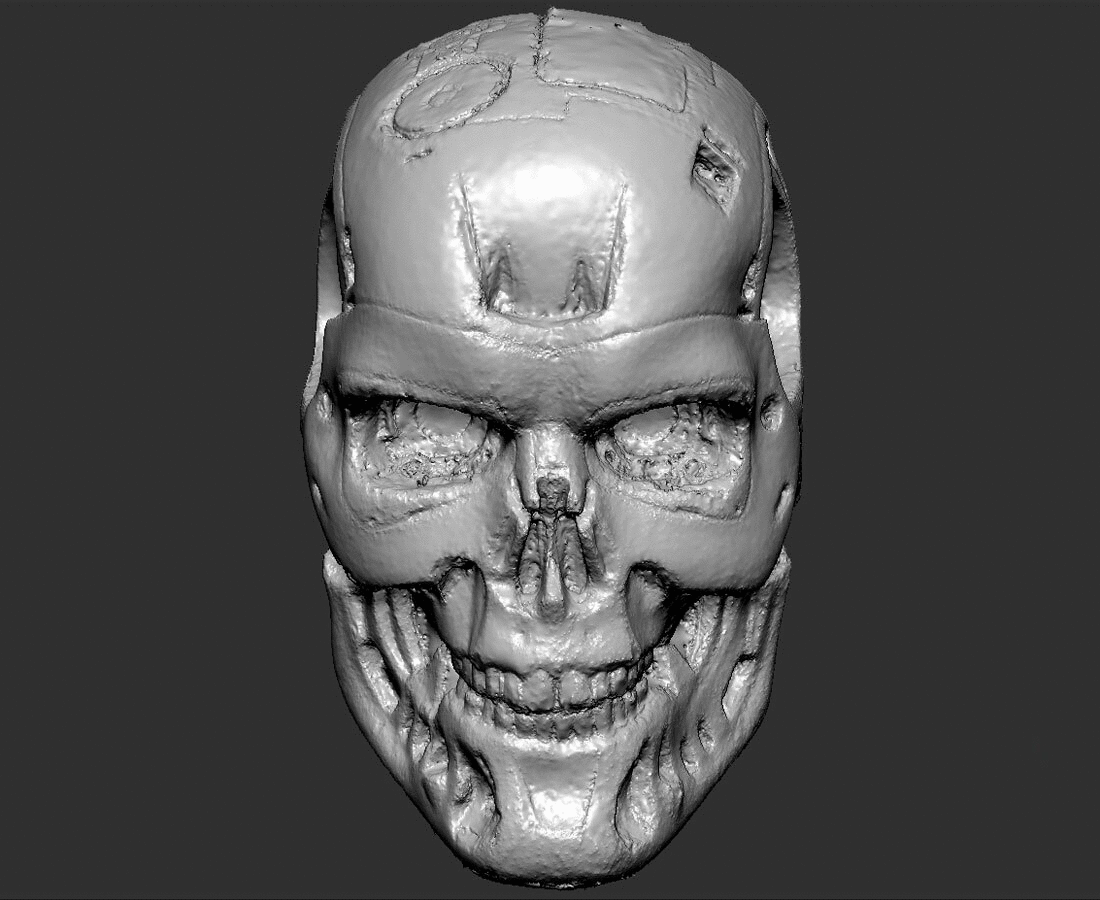

Man... that first model can almost be used as a damaged skull just lying on the ground being full of rust. Love how menacing it still looks in that rough form.
The second picture makes it look like the indents in the eye sockets are actually eyes that are looking straight at you. Creepy as heck. :)

T-800 is not symmetrical but distorted because it is handmade.
If it were a real robot, it would not be distorted.
My project is not to reproduce a prop, but to make an endoskeleton without distortion.
