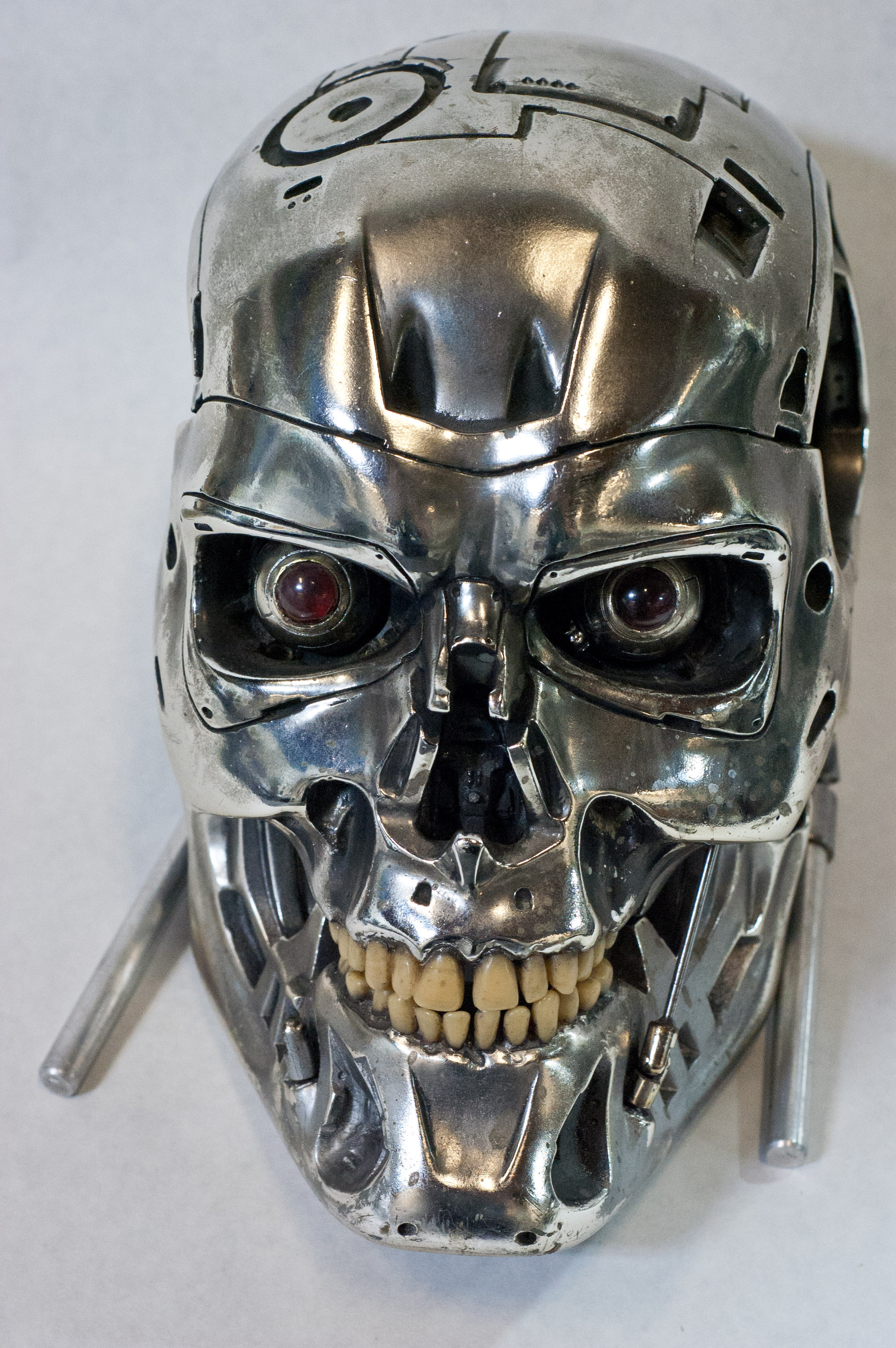

That skull is a resin M1 cast. My backpiece has the damage repaired. I got my cast from Jamie "Jaz Creations" over here in Australia. He never really made kits but I managed to score one from him. He restored a Tait kit for his metal endo.

Though I never did like the LFS teeth. I thought they had trimmed too much away between each tooth, so I really want to try to bring it back to how the original SWS castings were, but perhaps trimmed between the teeth the same way the gift skulls were. Those do look amazing.
I'm going to try to get this metal finish look for my kit. They are not shiny mirror chrome but looks more like polished steel. I hope this effect can be achieved with Alclad metallic paints.

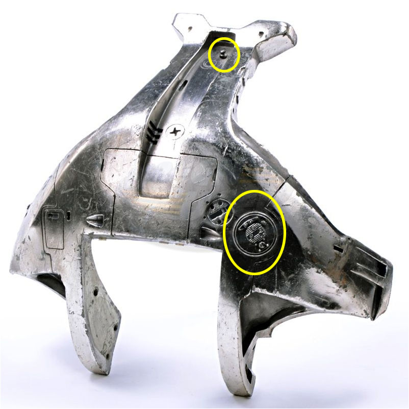

Anyone know what the original source for these two encircled parts are, as I would like to buy originals, as I may want to replace the ones on my kit.
Hope someone can help and thanks in advance.
The lower left chest greebles are from the Hasegawa 1/8 Le Rhone model kit. Not sure about the small, upper greeble, it looks like a zerk fitting.

The Hasegawa 1/8 Le Rhone model kit-part is also part of the M1 skull, I could 3d model it and you could get that 3D printed.
I can't just scan it without permission. And I don't have the money to either buy a scanner or have it scanned somewhere.
If it is illegal to import into Denmark it will be seized and destroyed.
They are round. And like in the pieces you showed this one also definitely has second ring at the bottom - I assume it's a washer between the part and the chest on the endoskeleton part. Like the other added pieces, the original sourced piece may not be metal, but could be plastic from a model kit as well.
