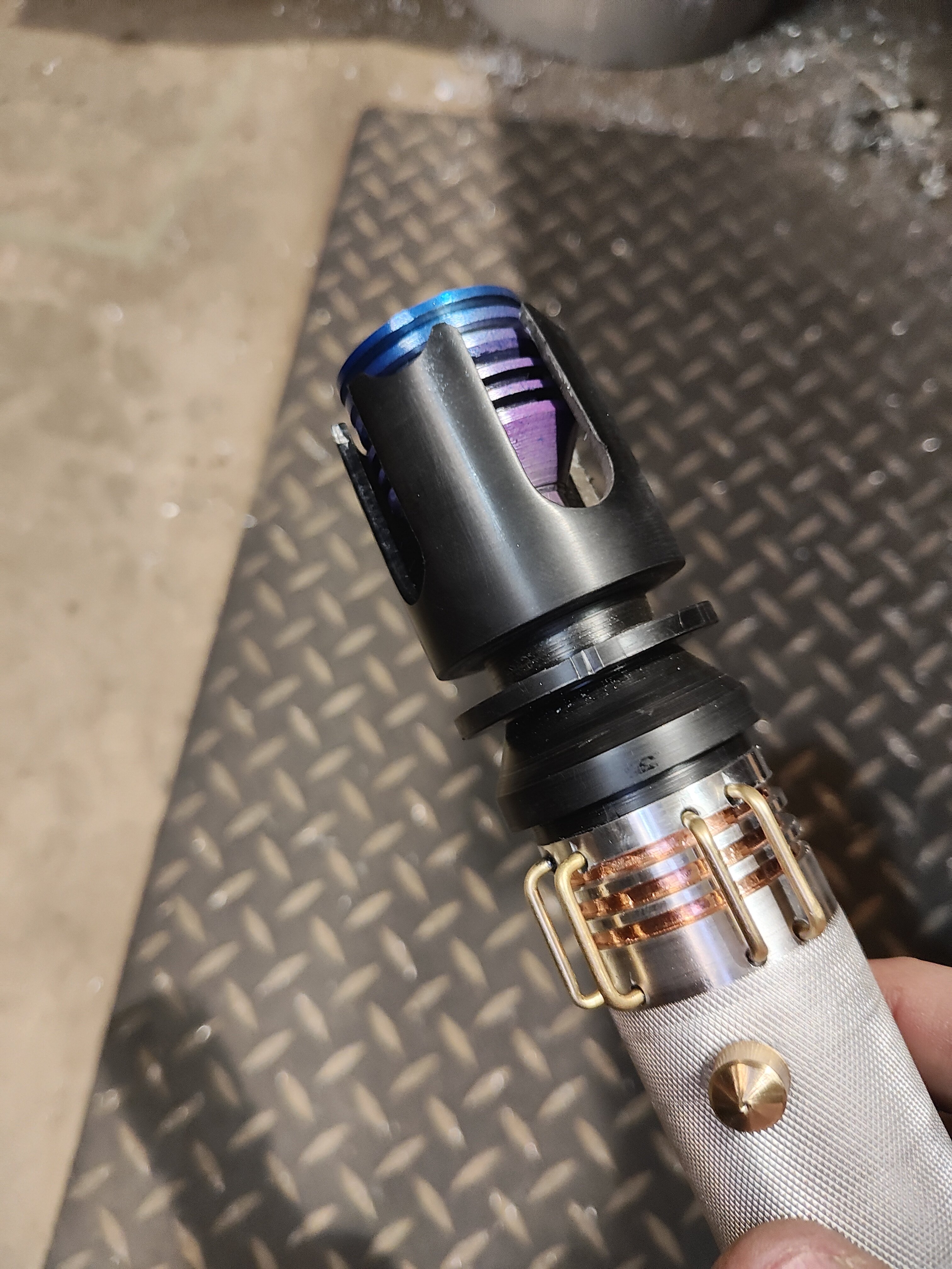

Little more work today, copper tape in the grooves a heat burn paint effect on the emitter, First time I have tried that paint effect, and some brass rods and a button.

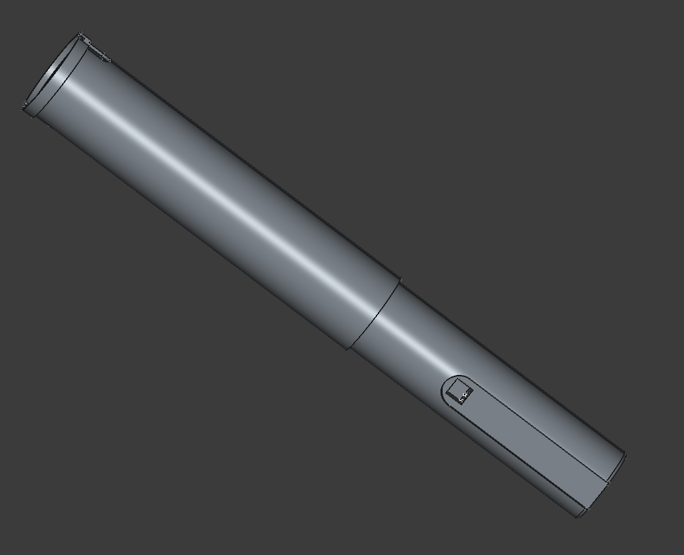

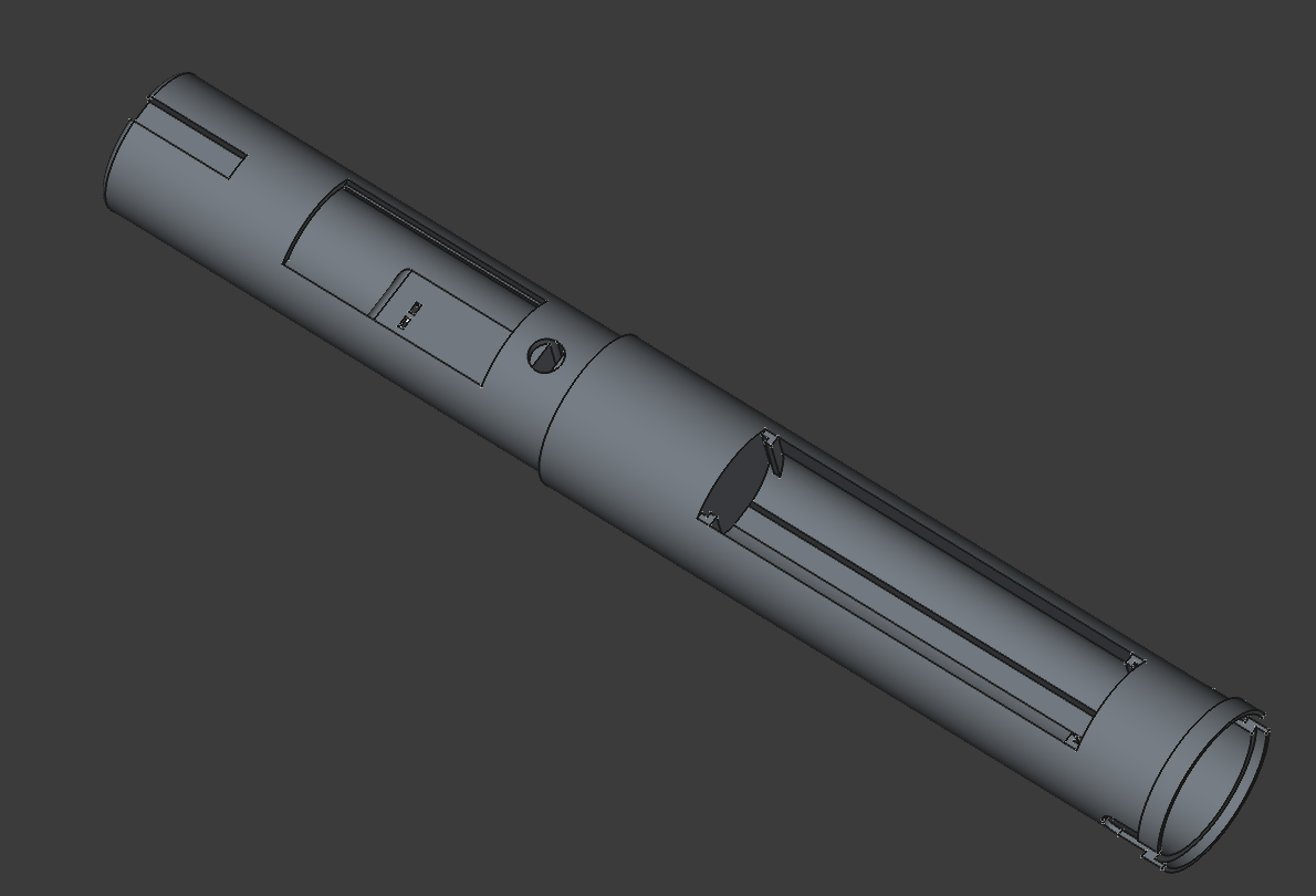

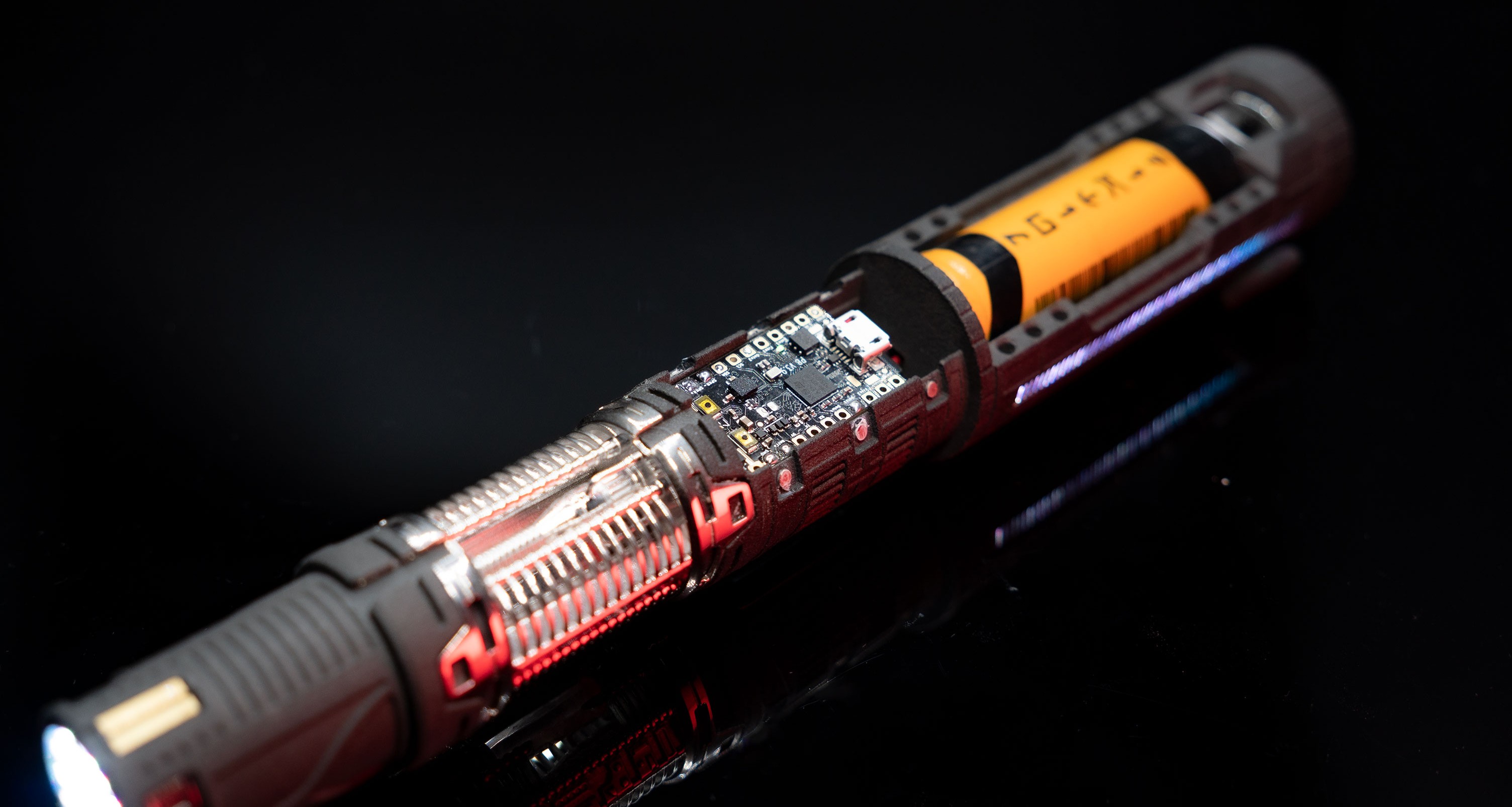

Been learning FreeCAD to create a fully removable chassis for my kids' lightsabers. They were originally installed with a jury rigged sled with built in battery and Verso boards, but this is going to be some Rolls Royce ****.

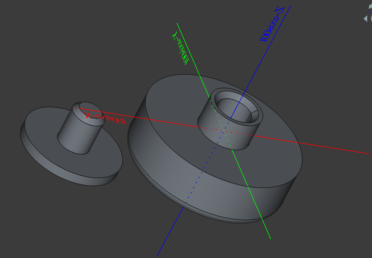

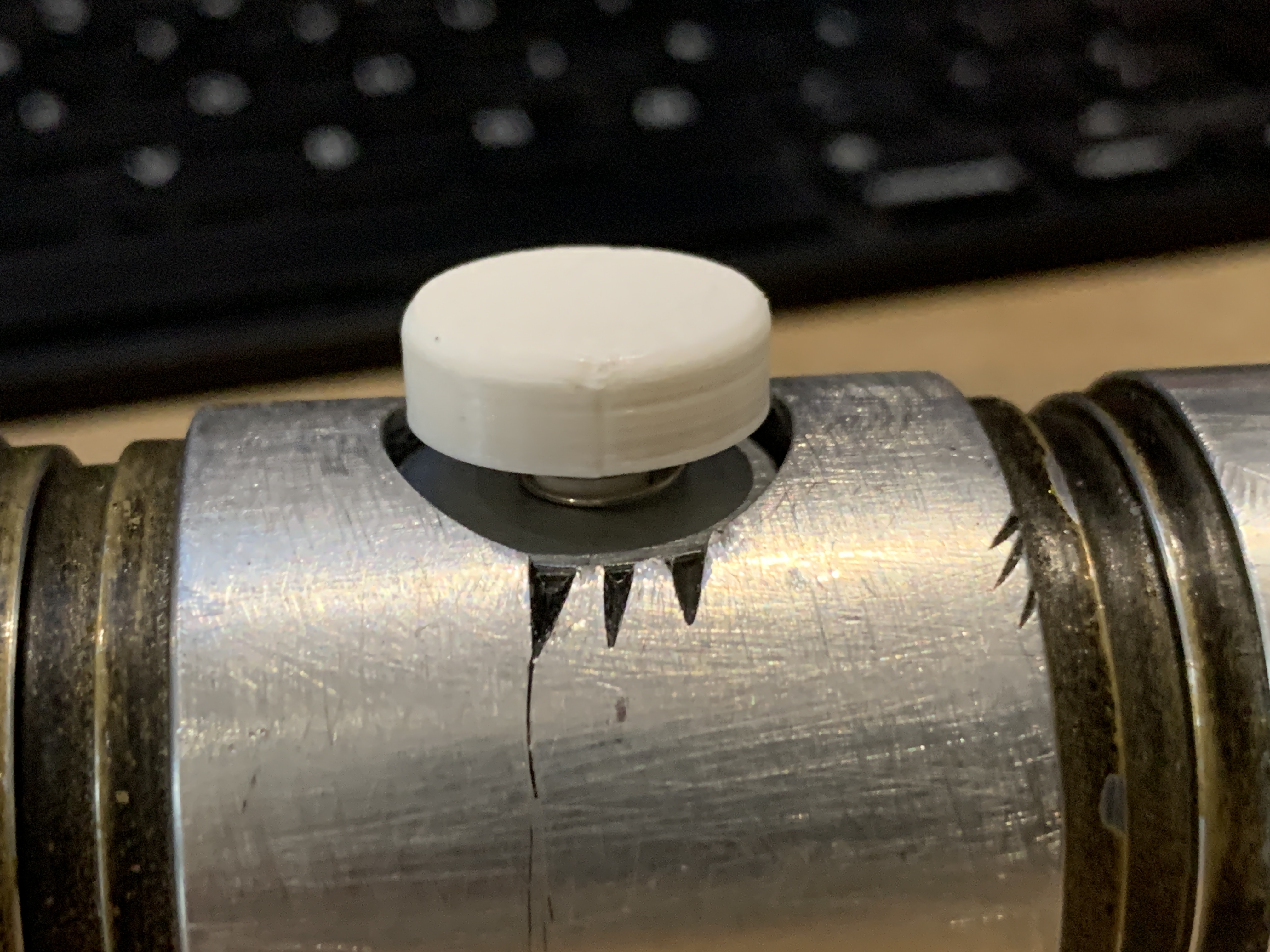

Part of the hurdle is making use of the massive 16mm switch hole. I ground down a large washer to fit, and came up with an actuator design, with a spring system in the prototype. It will work a red button tactile switch on the chassis. The final one will be spray painted.
There's also a small recharge port hole on the hilt, which will have a clear cabochon dome with sanded bottom to shine a nano pixel through, Proffieboard, and removable battery. The chassis is finished and waiting for 3D print prototyping.

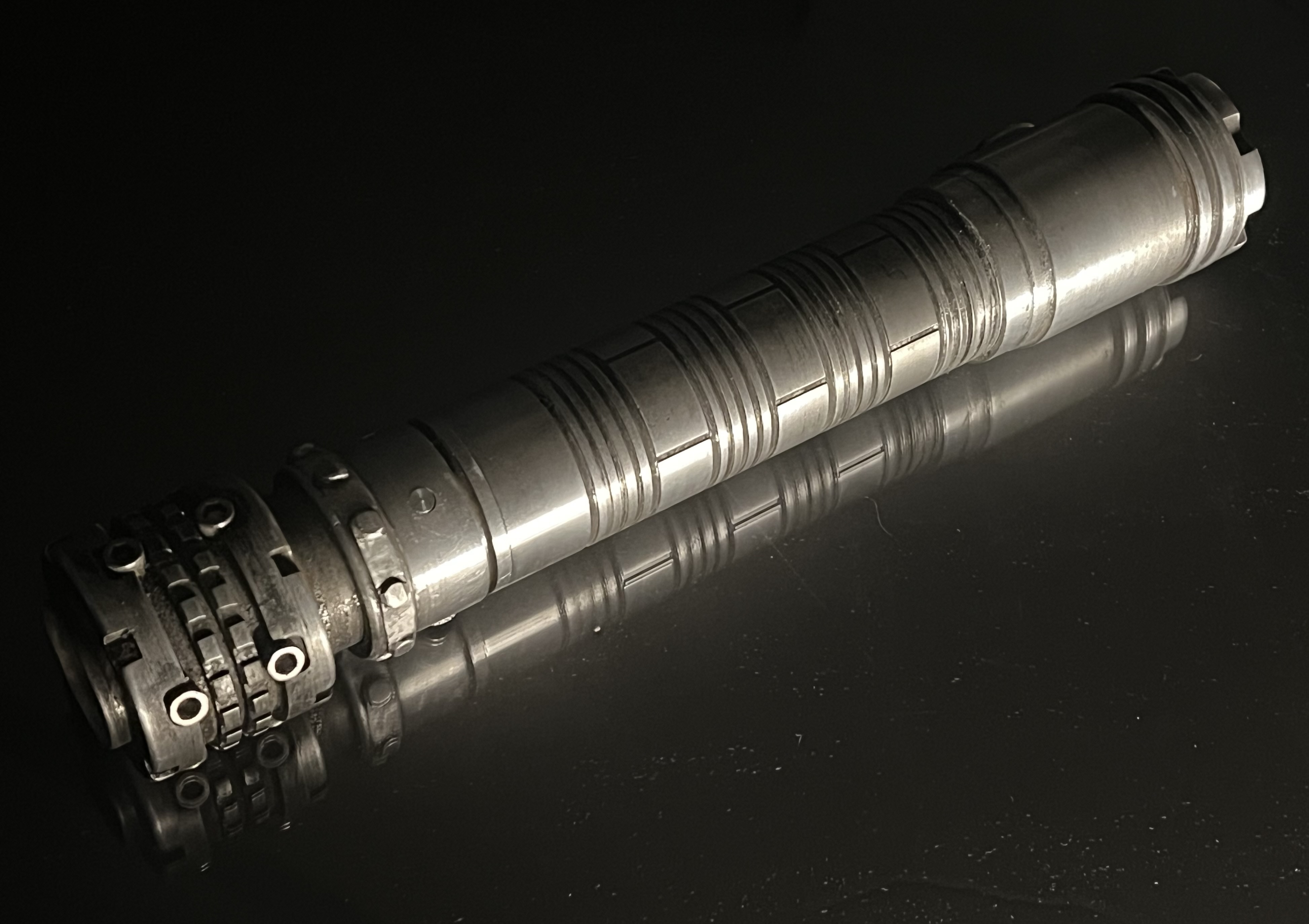

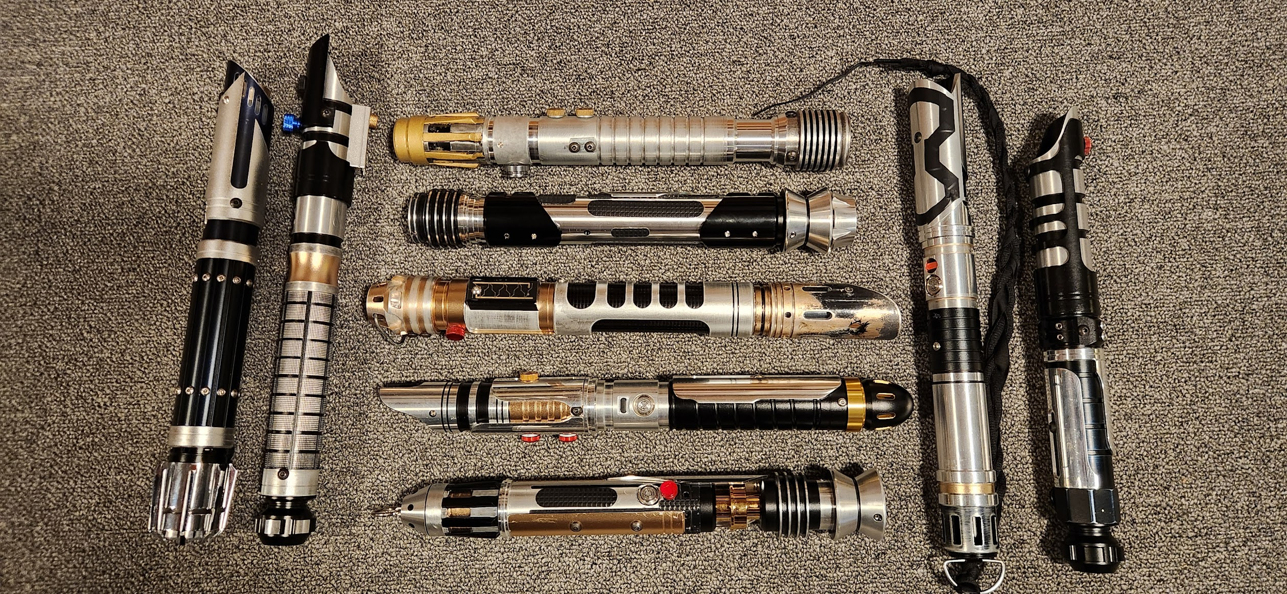

I saw your post in r/lightsabers earlier today, it was beautiful
My personal favorite is the two bottom-middle ones

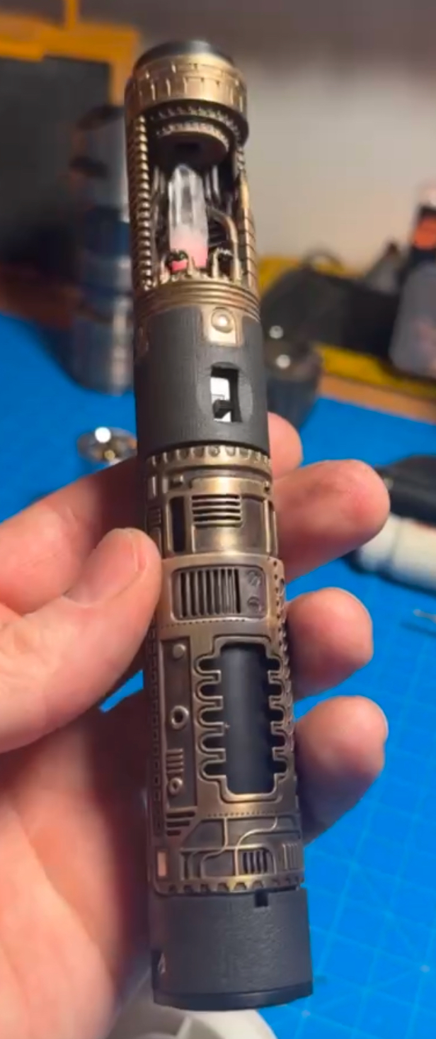

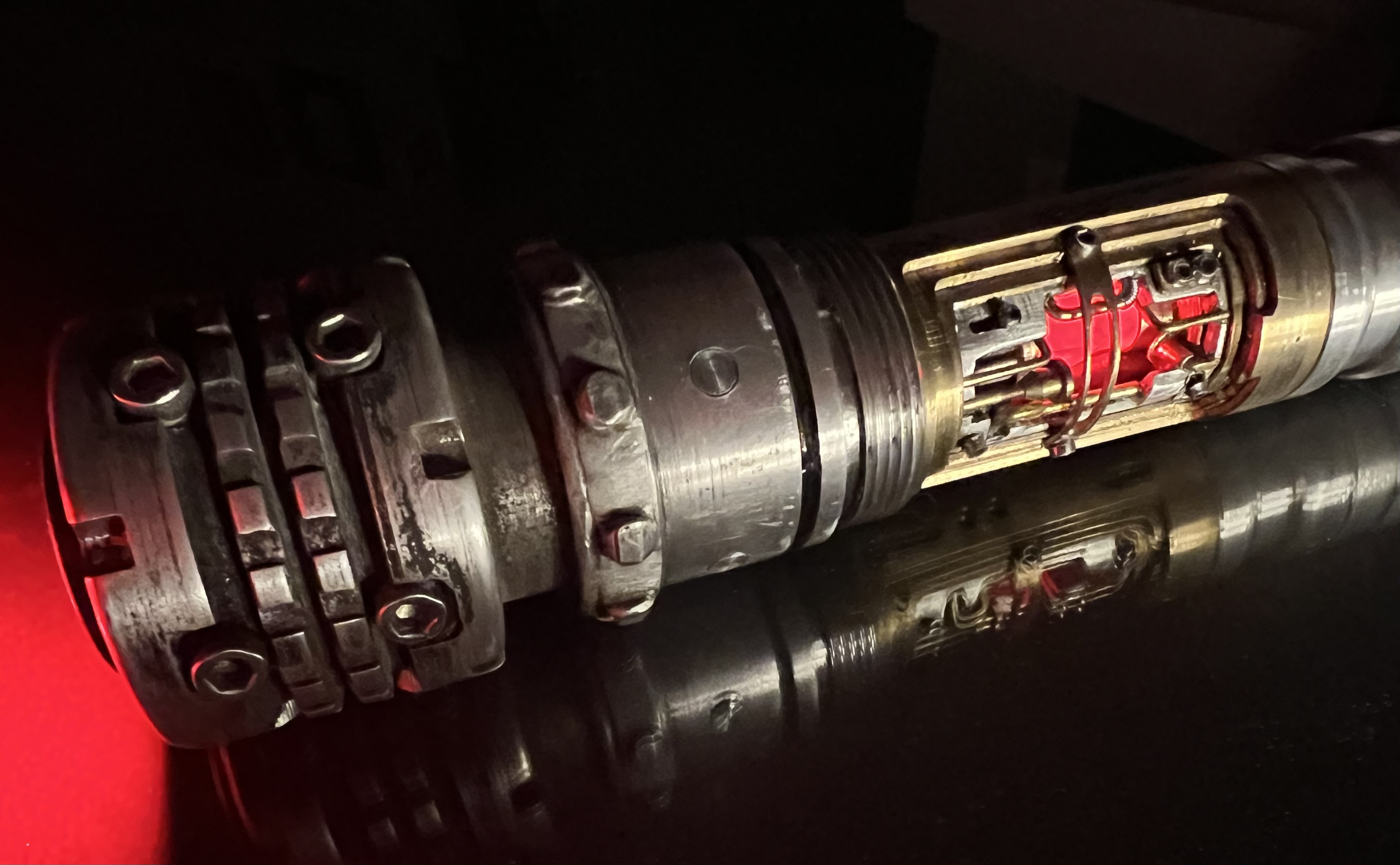

Thank you very much! The first of two you mentioned are the crystal reveal chamber that I did from scratch. The kyber crystal in it is actually an amethyst from a keychain.
The second of the two is my braced thin neck build. I put a brace behind the thin neck to improve grip options and because it's visually interesting. My favorite part is how the pommel came out. That's a lot of careful wire brush and sand paper stripping along with a cut and reshape of a left over part of a grip shroud to become the pop of color insert.

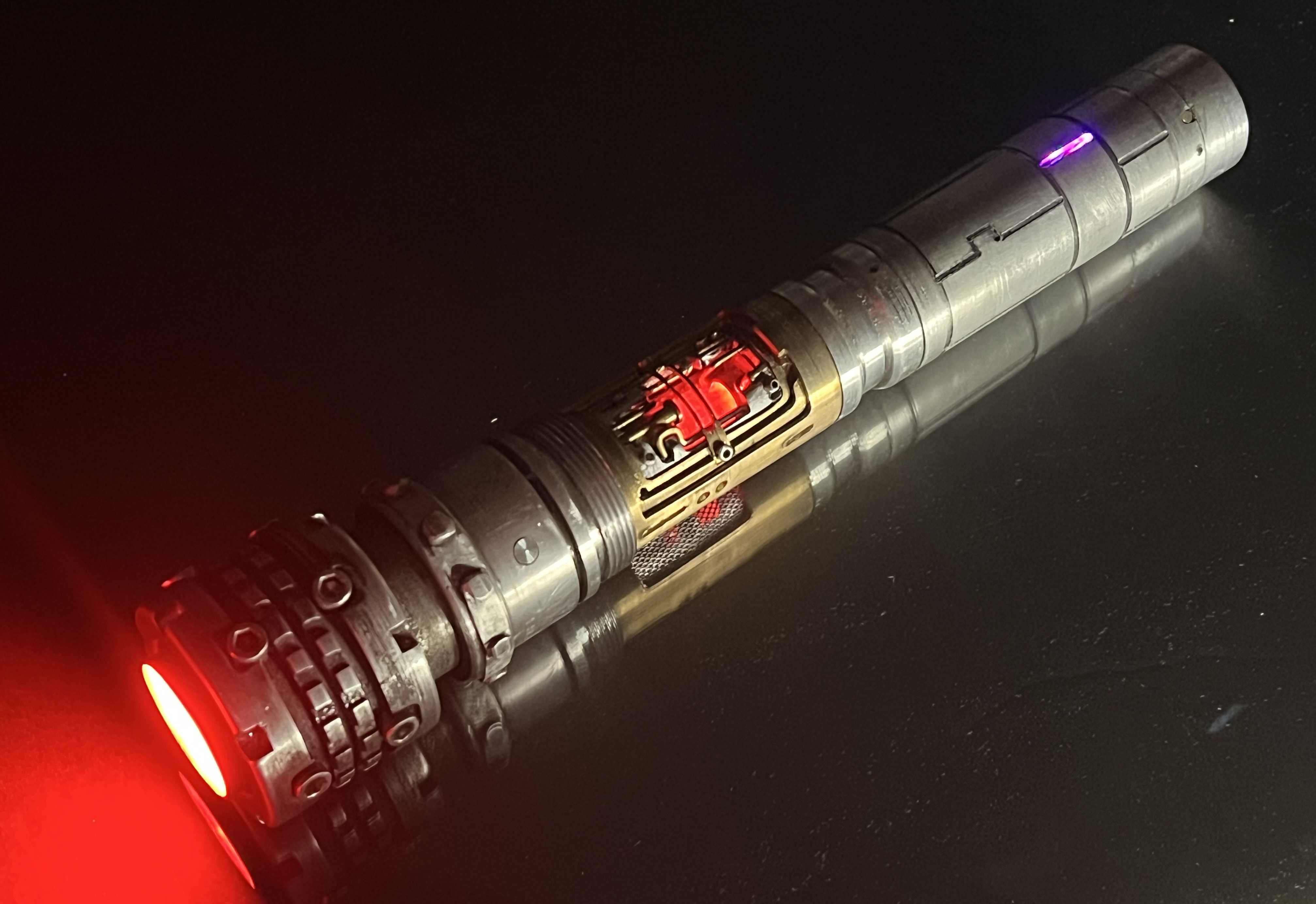

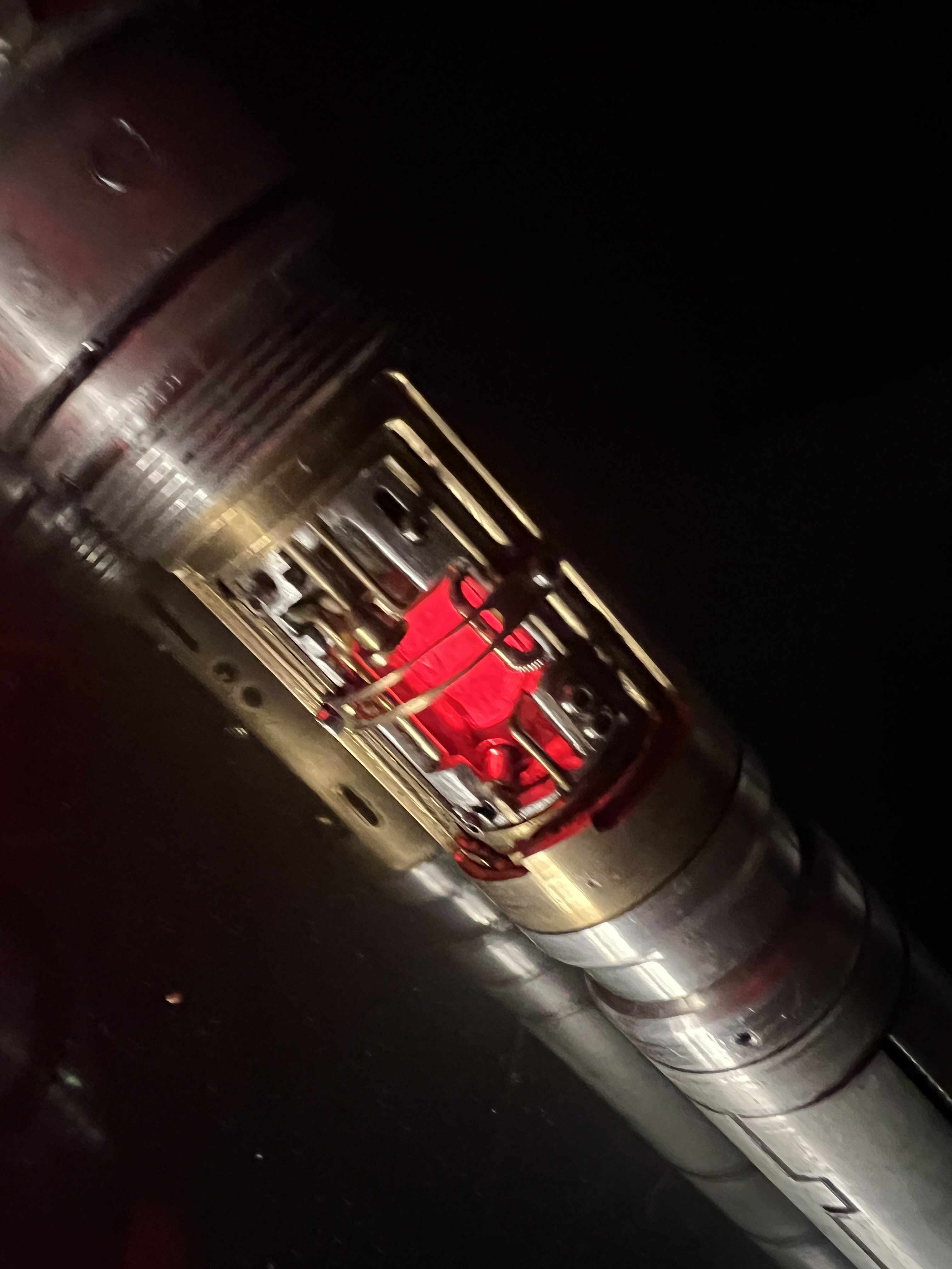

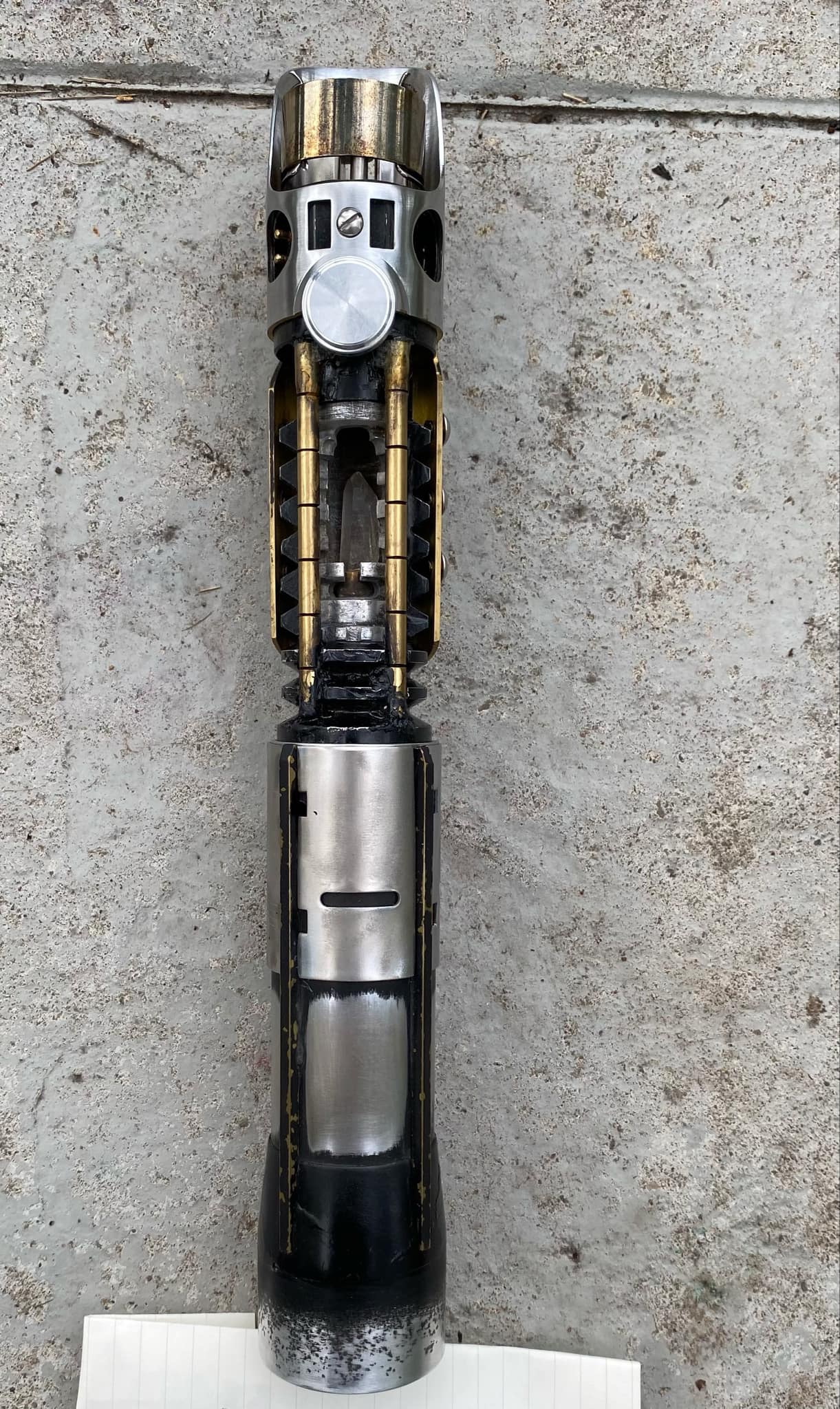

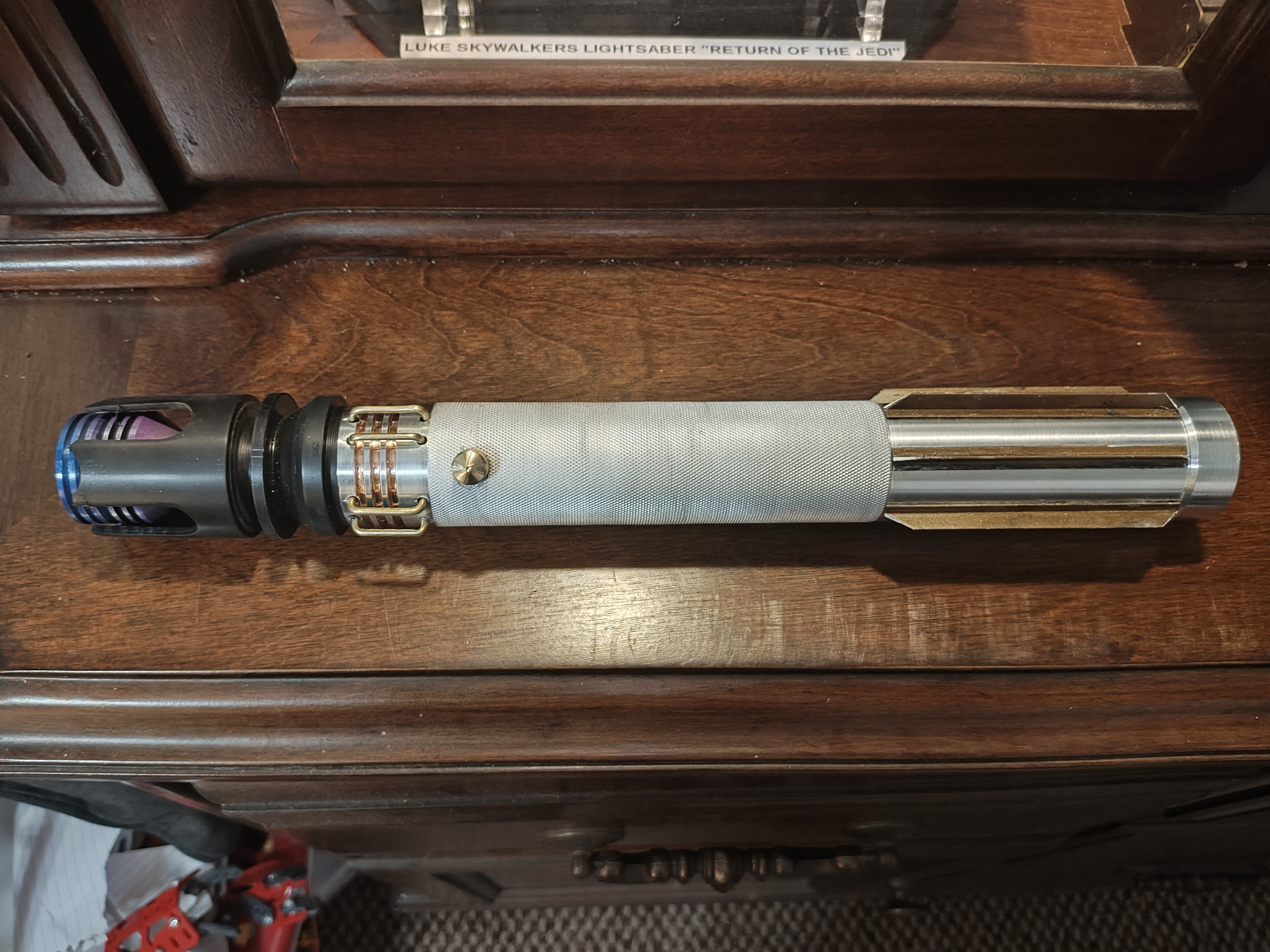

Hey all, I just joined 10 mins ago but here is my latest toy is the Korbanth ROTS-Flex v2 installed by Tierfon Orbital. This is a pic of the brass hybrid chassis he created for me. Next we are working on an SK (Graflex 2.0) with master hybrid chassis.

Tim does great work
