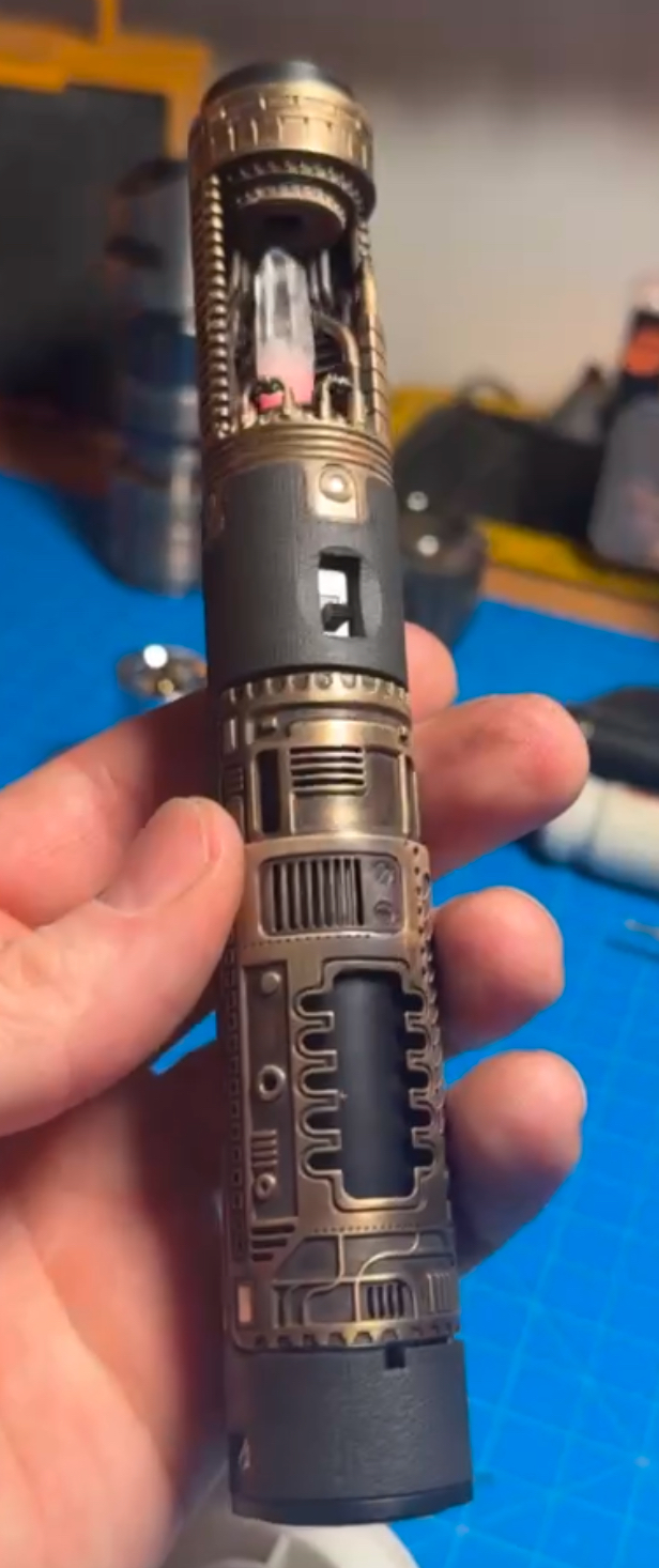

Just wanted to show off the Beautiful Master chassis designed by guabe for the Youngling Slayer
View attachment 1885943View attachment 1885944View attachment 1885945View attachment 1885946View attachment 1885947View attachment 1885948
Install done by my good friend Tim from TierfonOrbital
You are so lucky… The chassis I posted below is going into a Korbanth Aniflex but yours has that OLED screen and the side lighting that I think is beautiful. For some reason, Tim doesn’t add those strips often for me.
I didn't even know they were a thing. They came with the Chassis Kit
I think Tim has pared back his use of blinkies on the chassis. Same with Benji (Nerfherder).
If you saw a video, he did a couple months ago of a Korbanth SKV3 that had two red and two blue Blinky lights, brass doors/accents but no Neopixel strips, that was mine. i’m fine without the Blinky lights, but I do like the 10 pixel strips and the ring pixels.
This chassis is for the Korbanth ROTS-Flex v2 And I am extremely extremely happy with it. I had zero input as well, but I really wish he would’ve added an OLED screen. the next one I have him install is going to be a custom 2.0 SK and my understanding is it’s going to be a full on master chassis hybrid with an OLED screen and spinning crystal chamber so forth.

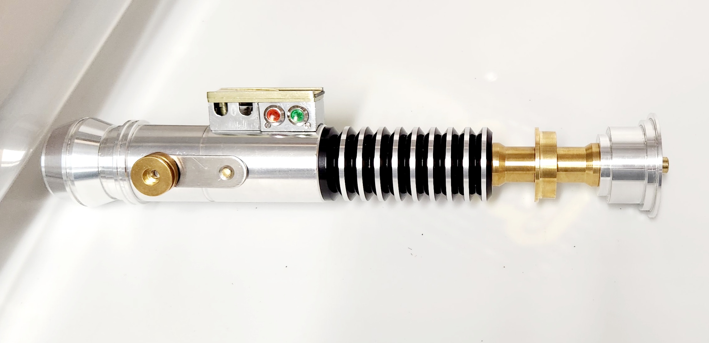

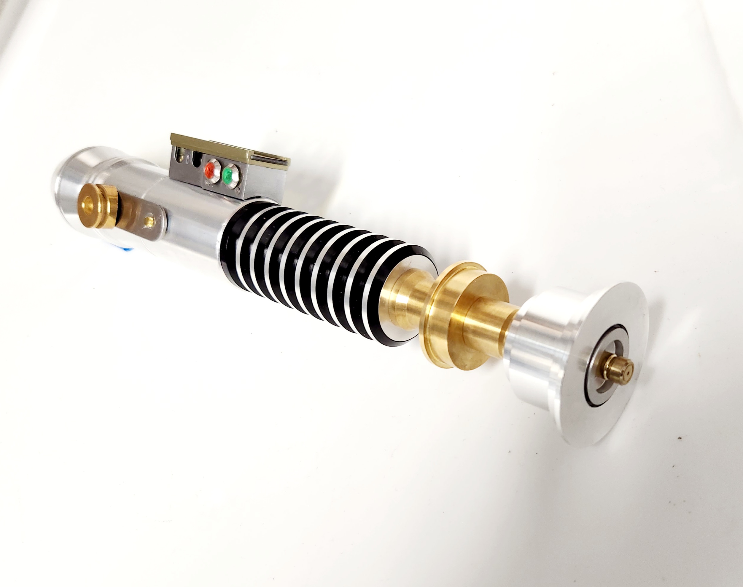

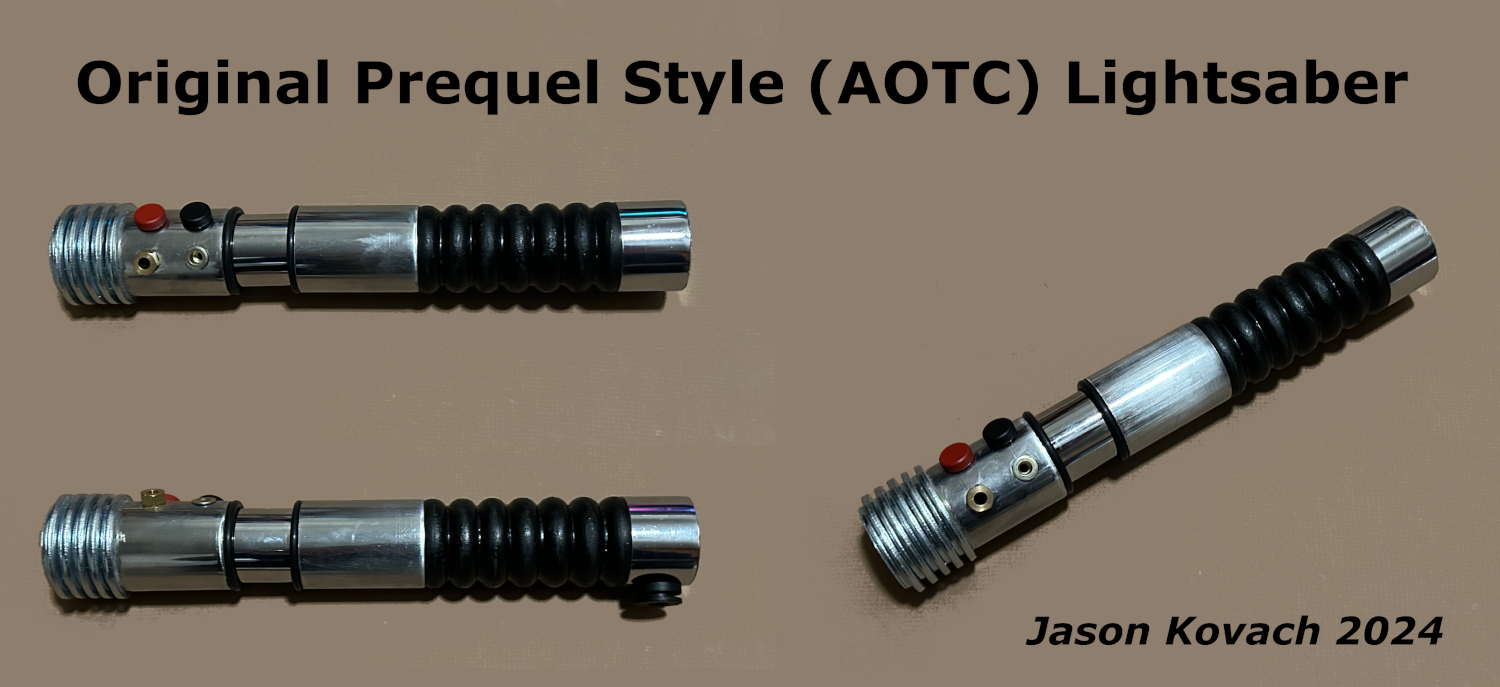

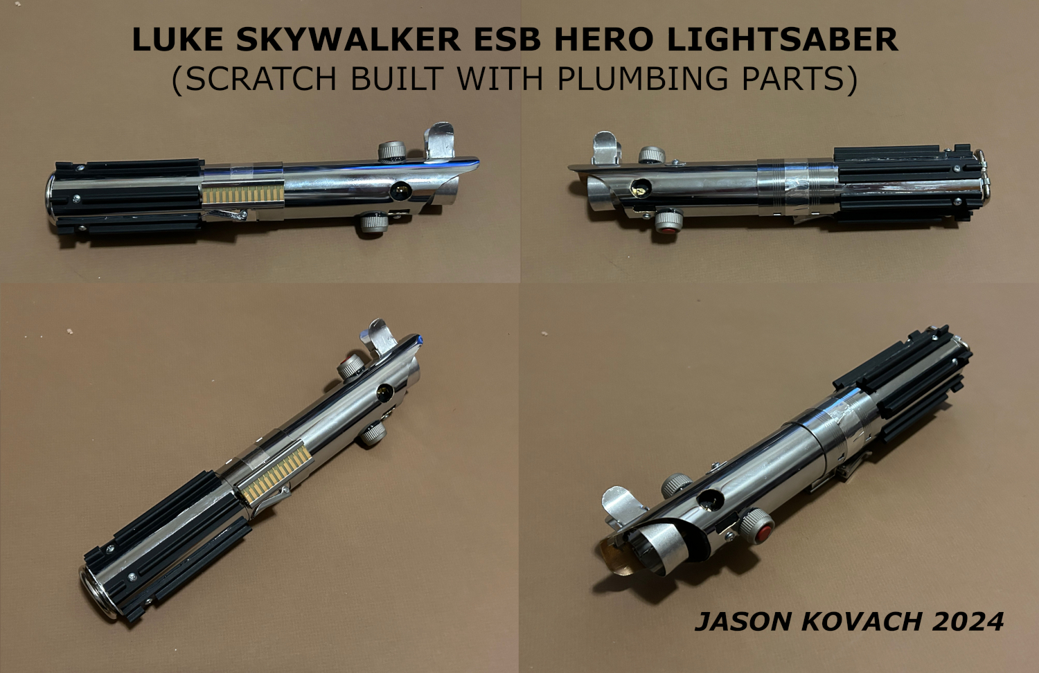

4str0m3ch Thank you. I wanted to a simple one. I also think the chrome plated sink pipe has an ATOC look, since they chrome plated resin for a lot of the sabers.

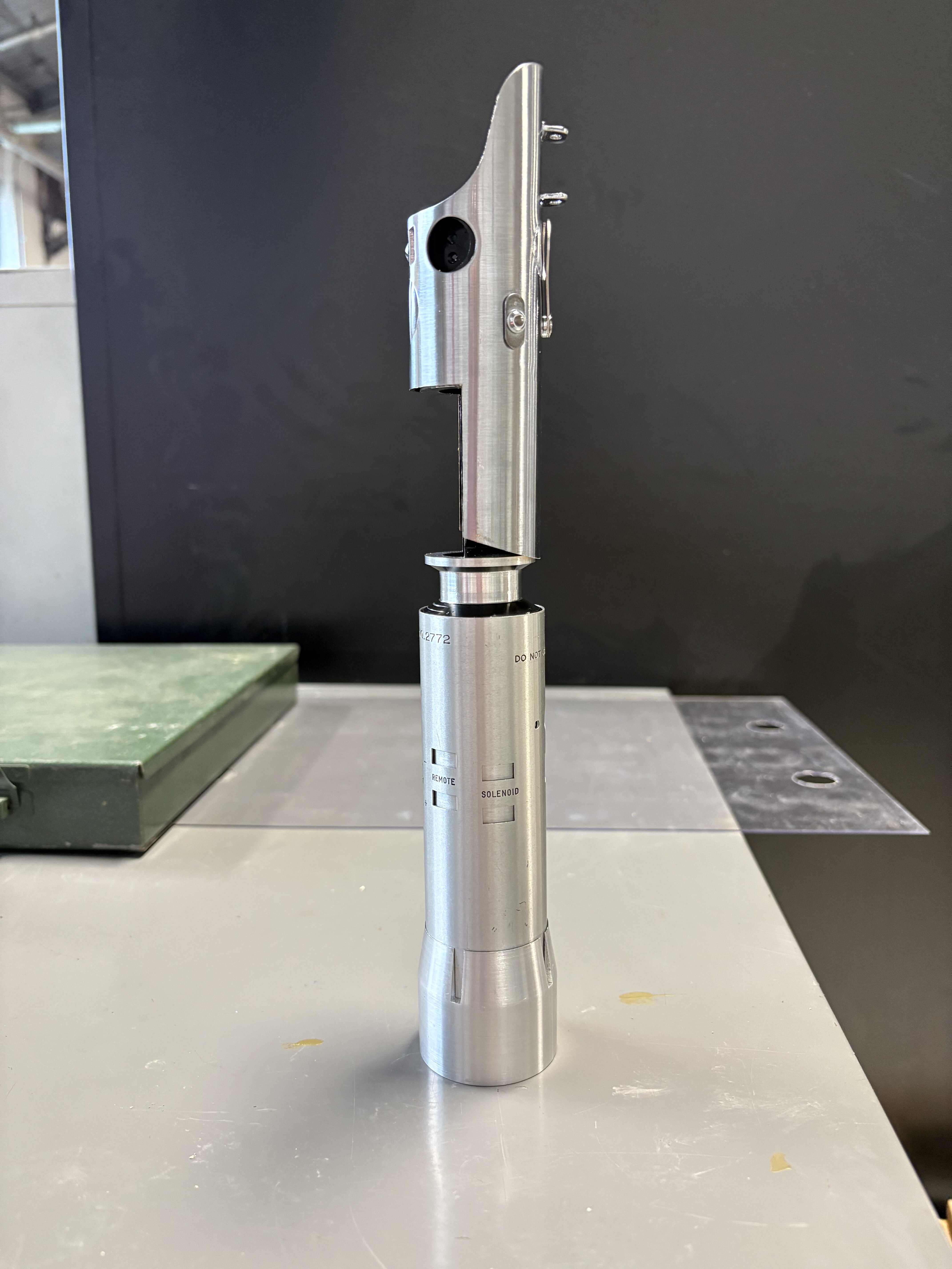

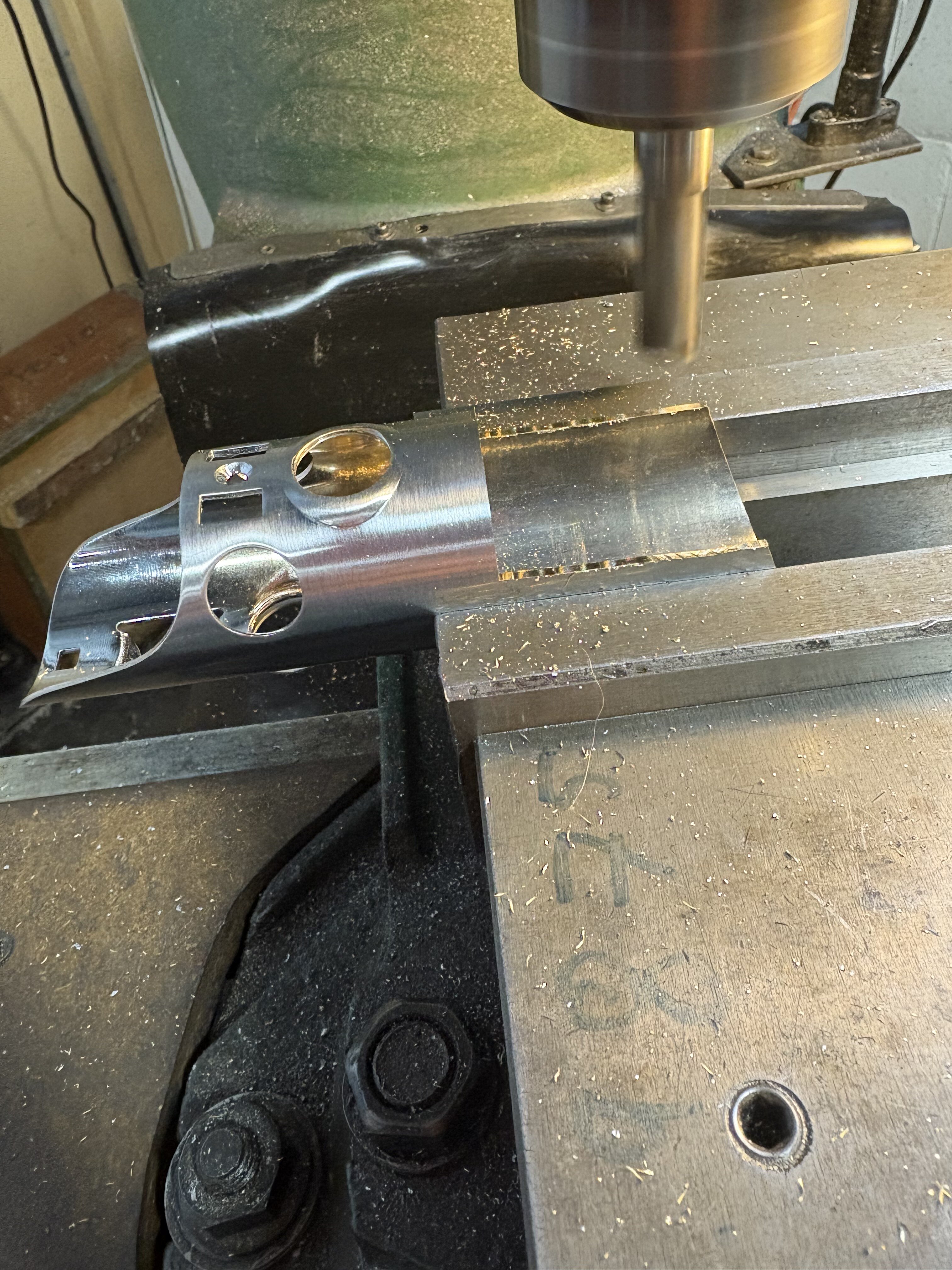

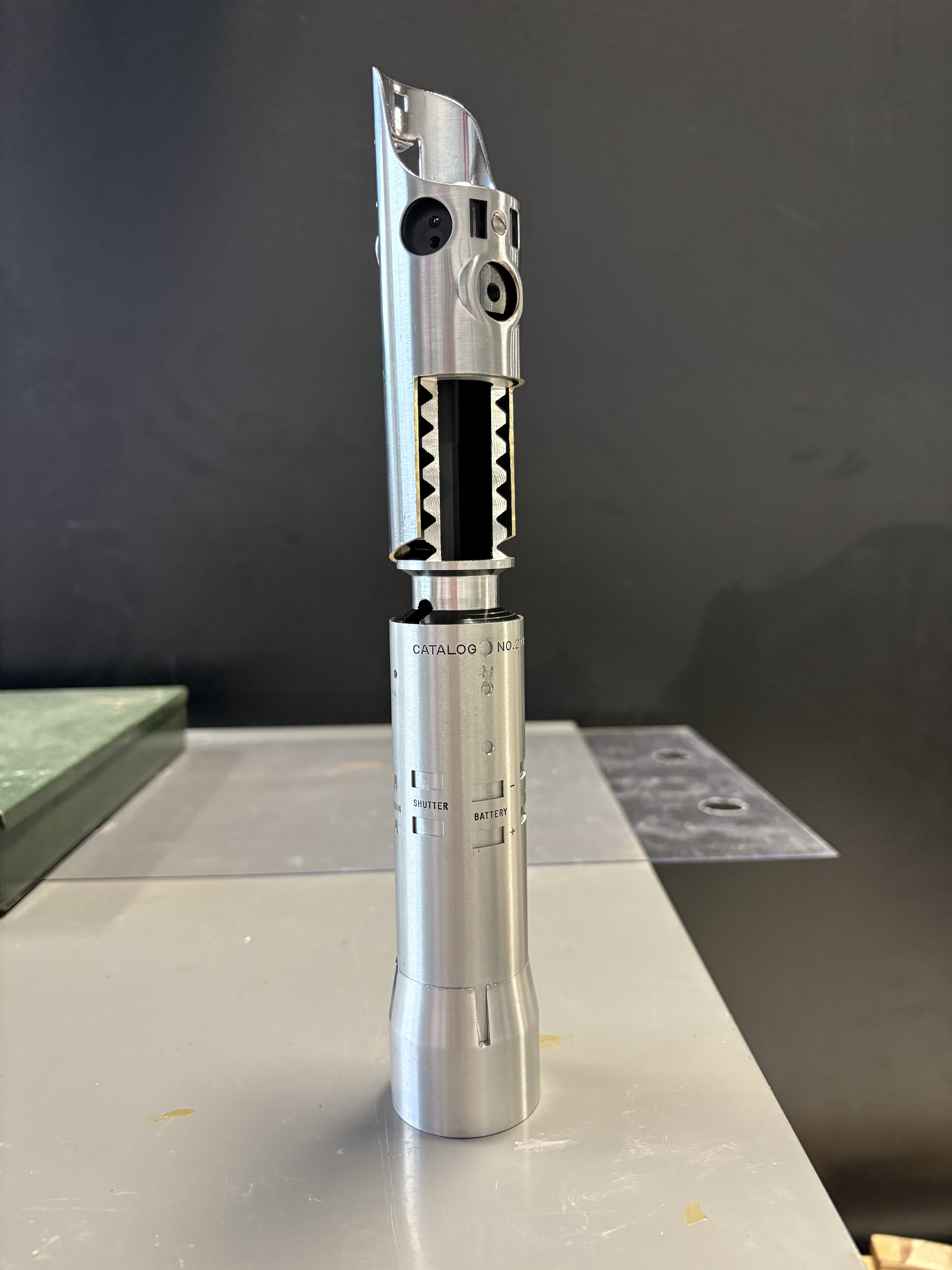

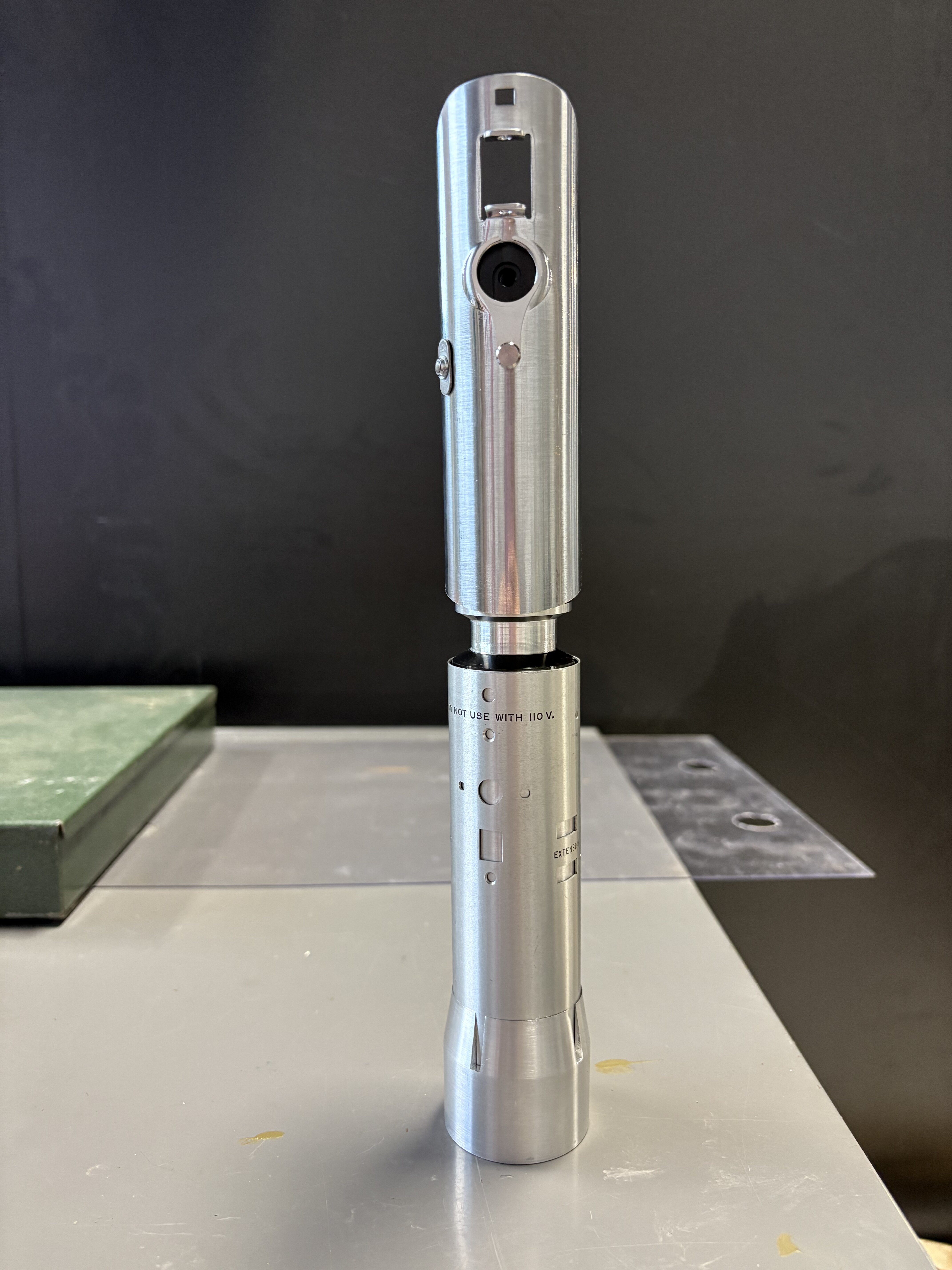

Not complete yet, but I am working on Graflex 2.0 to Starkiller conversion. Minus the pommel, I did the work on the rest of the hilt. Milled down the ribbed grip section for the exposed crystal chamber, turned down the last rib on the grip to create a wasp waist/choke point, cut/milled the replica Graflex shroud, and turned down the TCSS grip sections to fit under the vintage Graflite tube. This hilt is comprised of a Graflex 2.0 core, replica Graflex upper, TCSS adapter/extension, custom pommel, and a vintage Graflite.
