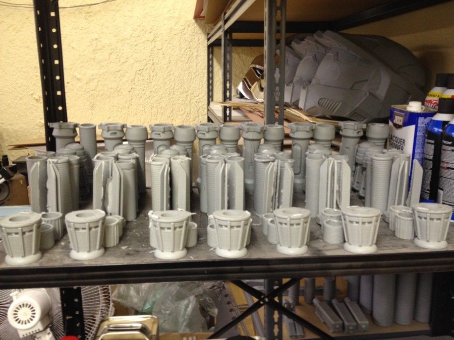

I'm definitely cranking kits out now.

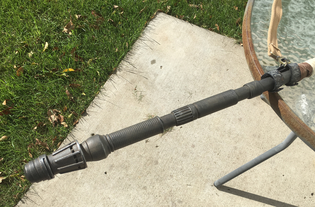

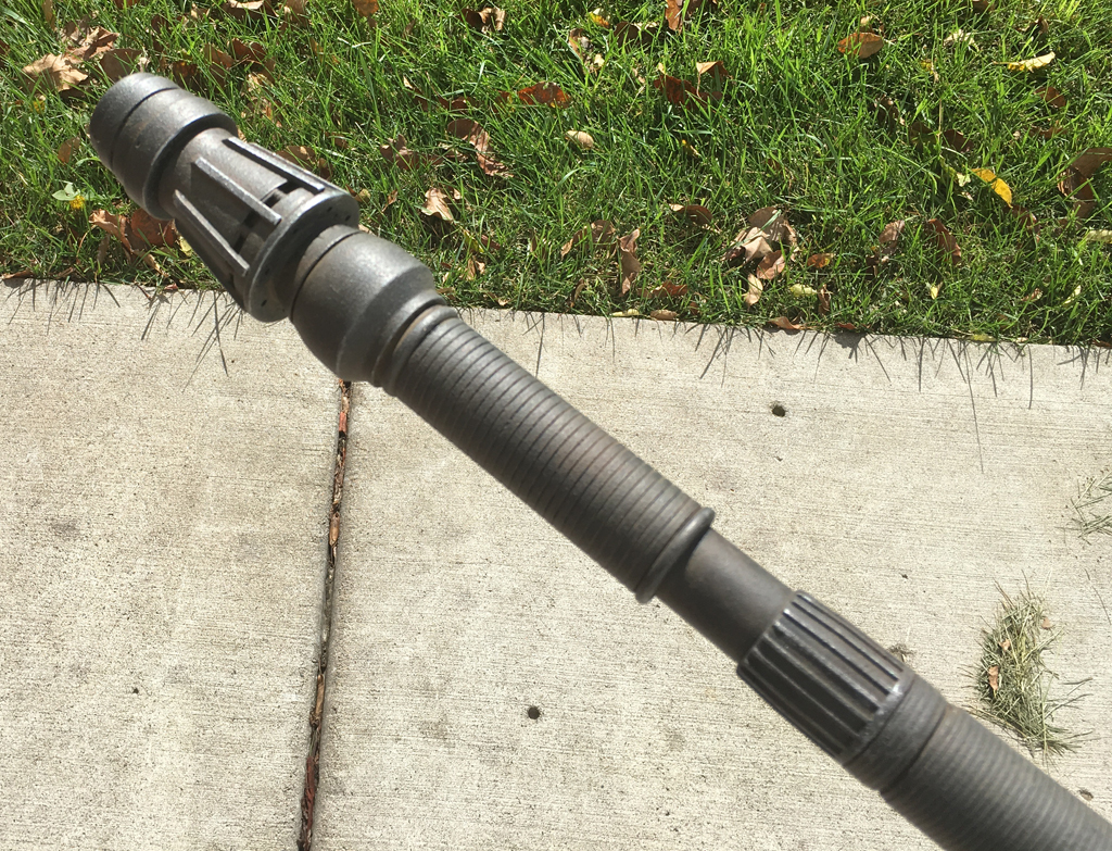

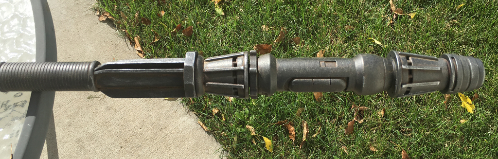

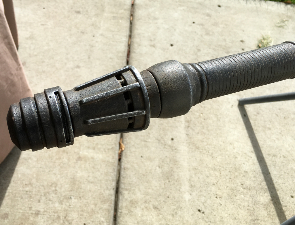

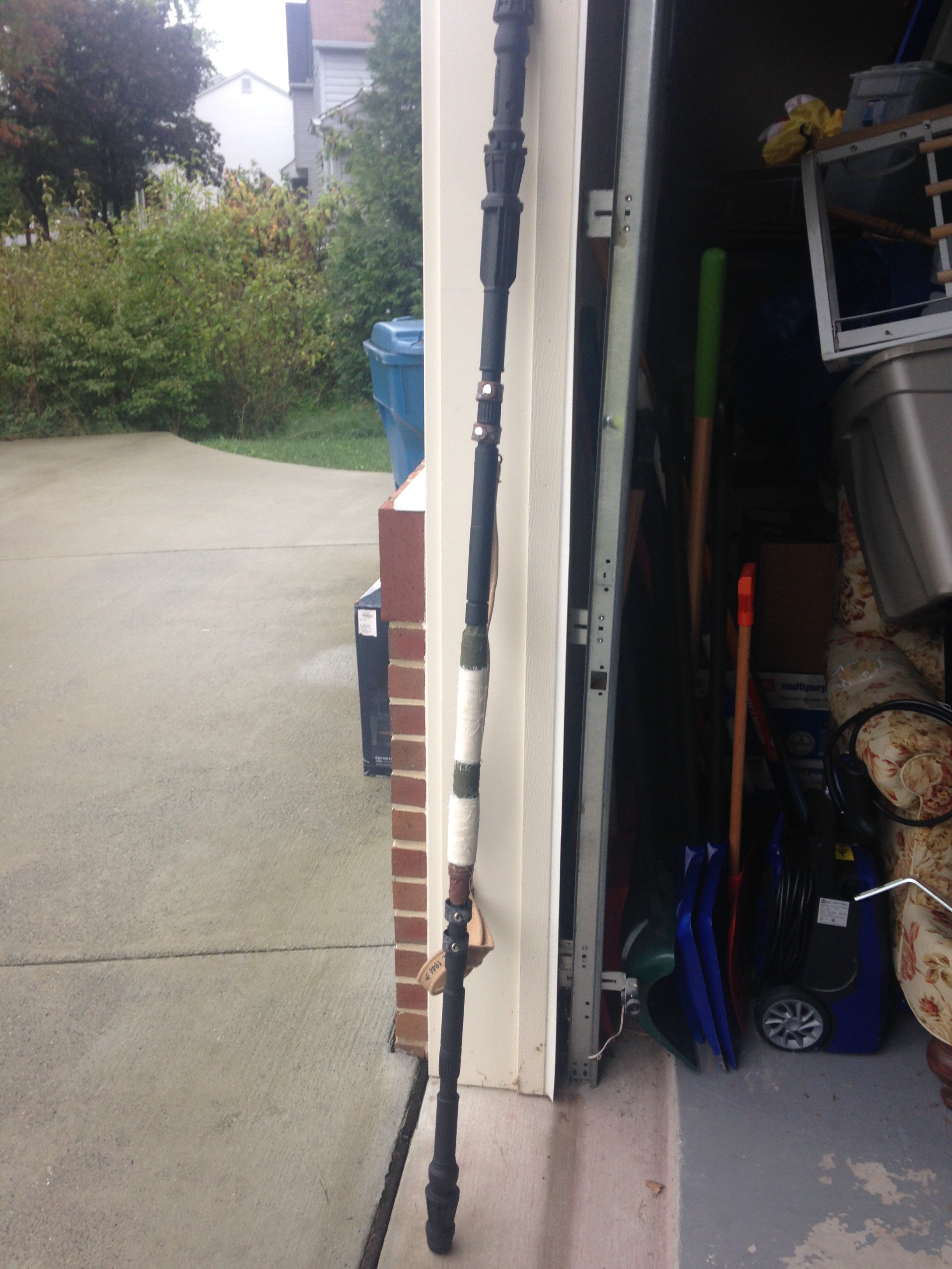

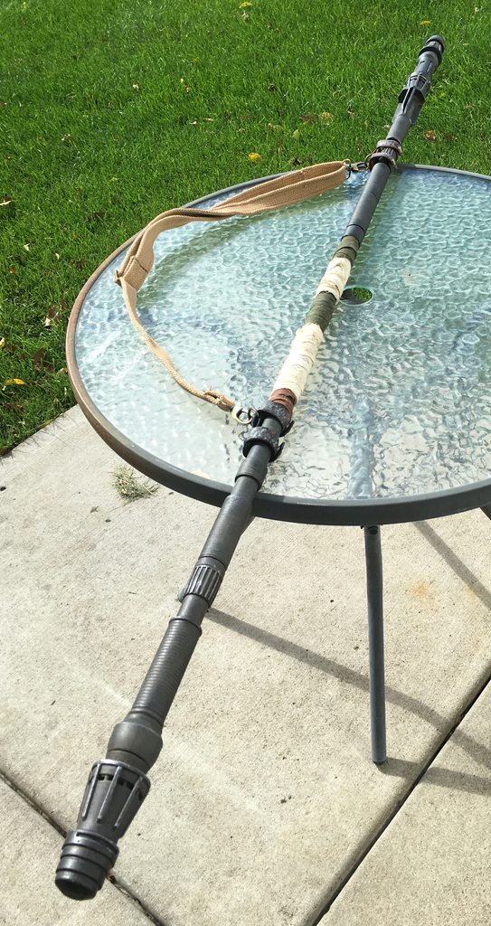

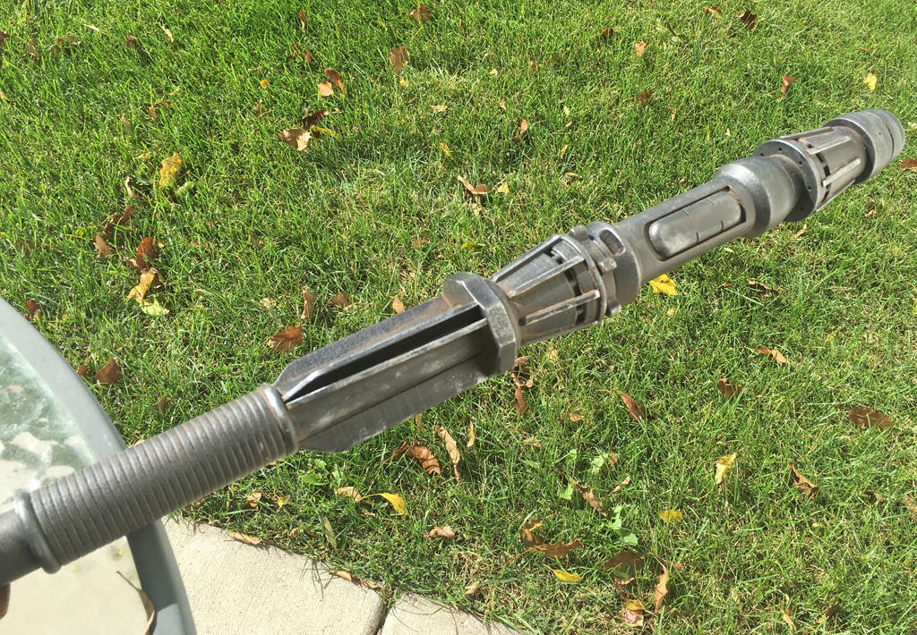

I used multiple stages to attain the look I wanted.
1. Primer
2. Rustoleum Textured Antique Iron (all over)
3. Rustoleum Textured Stone (randomly spots)
4. Primer again (Black)
5. Graphite powder rubbed all over (only where the fingers reach)
6. Seal with a Matte clearcoat
7. Several washes of raw sienna, raw umber, burnt siena, burnt umber, and desert sand acrylics
8. Dry brush silver in select areas
I think I got pretty close the the real one:
Rey_Staff_01.jpgRey_Staff_02.jpgRey_Staff_03.jpgRey_Staff_04.jpgRey_Staff_05.jpgRey_Staff_06.jpgRey_Staff_07.jpg
Thanks for a great kit, Justin! I had a lot of fun building this one. :)

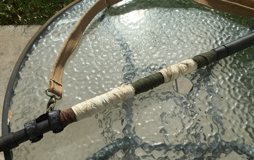

Any special secrets to wrapping the handle that people would like to share?
I just used some super glue on one end, and then started to wrap it around, and then super glued the other end. It holds pretty good, and I can adjust it if needed.
