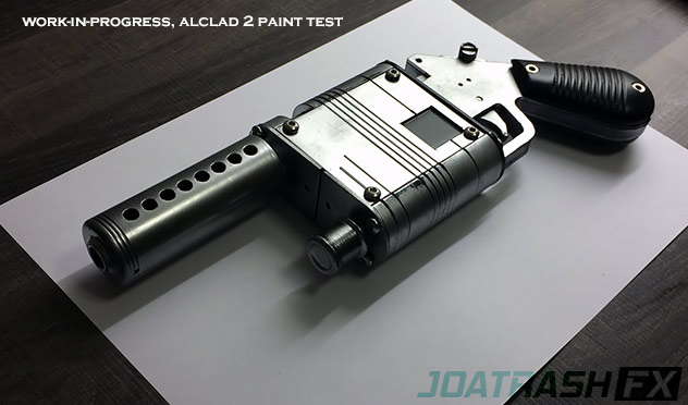

Joatrash, that looks amazing. Does the Alclad have decent adhesion, or does it have a tendency to scrape?
Thanks. :)
I'll copy-paste a response from the sales thread that will answer that!
"Alclad II "chrome", applied with an airbrush. You need to use their special clear coat as well though, since the chrome rubs off otherwise. You can see in the photo where it came off in places before I added the clear coat. The Alclad clear does NOT dull the shine like other clear paints do. Also note that you should "mist" it on over a black high-gloss base."
Awesome, good to know. I know a few people were having issues coating their Phasma helmets with it.
I threw a quick coat of Alclad II onto some parts. Missing some screws and I should have trimmed a couple areas a bit more before painting but I just wanted to get a sense of how it will look when done, since I almost never get to see my own props finished these days.

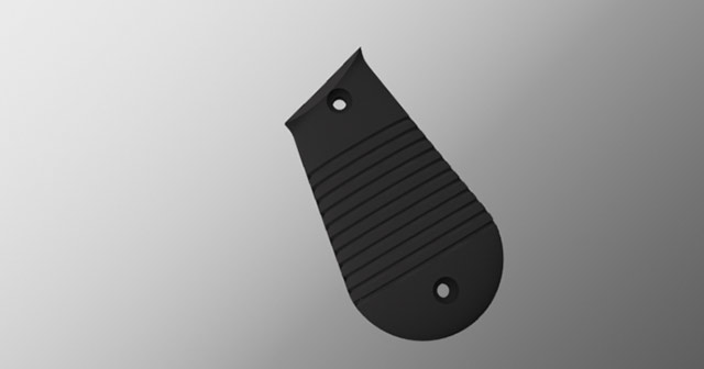

Are you planning onto updating the handle grips? Right now they are missing the little flaring the originals have at the top:
Yeah, I actually changed the pattern a while back, just haven't gotten around to printing them up yet so I used a set I already had for the paint test. Here's a w-i-p render I did while I was working on them.
