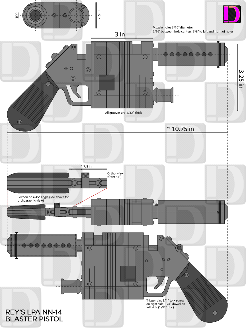

I noticed that there are different props: In some pictures the front plate is one piece, in others it is two.
Other observations: The barrel is slightly smaller in diameter than the width of the main body but thicker than the "ejector port".
There is no scratch above the right grip - the line in one picture is probably a fishing line used to hold it up.
The black squares are recessed less than the ejector port...
Things like cutting three exact grip frame shapes in different thicknesses would be a challenge[...]
I'm thinking of taking shortcuts here. Double up the left and right sheet metal parts, drill holes through both and screw together. Then cut those two together.
The inner core would be cut from MDF: the edge clad with aluminium tape. :$
The core would not need to be tapped if the plates are - there are a couple of bolts that go through from the right side - that could hold to tapped holes on the left.

I actually just got back from seeing TFA a second time, and in addition to still loving it knowing the twists and turn ahead of time I paid a lot of attention to Rey's blaster. After seeing how it looked in Harrison Ford's hand (a decent fit if a little on the small side) and in Daisy Ridley's hand (definitely a little big, keeping in mind that Ford is 6'1" and Ridley is 5'7") I'm actually a bit more confident in my measurements.
Re the front plate: wasn't sure about this myself, and I didn't really pick up on it watching the film again tonight so I plan on keeping it as 2 pieces for now.
Re the barrel: if you're referring to the muzzle shroud, I'm definitely with you. Keeping with my theory that the prop uses Imperial measurements (seeing the blaster on screen cemented the 3" x 2.75" measurements for the receiver portion for me), I would assume that the shroud is 15/16" instead of 1" as I have it now, since if it were something like 7/8" it would be more noticeable.
Re the "scratch": you're definitely right about it not being part of the gun, because in another image taken from the right side there is no line. I had assumed it was some kind of weld, but I've removed it.
I want to make all of these changes and finish the front view, but once I do I'll post an updated version of the blueprints for anyone who's interested
EDIT: Also if I were to do a run of these, would people be more interested in an all resin casting or if the metal parts were aluminum cold cast?
Side note: does anybody know how long a broomhandle grip is supposed to be? By length I mean the measurement from the bottom of the curve (where the outside of your palm would go) to the flat, angle part (where your thumb would rest)? I think my blueprints need some slight overall rescaling, and having that measurement would make things infinitely easier. I've never handled a pistol before so I don't have any past experience to draw on for the scaling
Some dimensions on the Denix are slightly smaller and some are slightly larger than a real Mauser. I think the grips in particular are a couple of mm too long.
Member VFX Freak had once posted a picture of his Mauser on top of a cutting mat - with a grid. I scaled and rotated that to match the grips on the NN-14 and then measured the grid. That would make the barrel shroud about 1 1/4" in diameter and the receiver box ~3.69 (~93 mm) vertically.

BTW, how do your measurements compare to IAmTheClayman's?
The problem I see with scribing using a tube cutter is that you get a curved v-shaped groove, with no control over width, that also slightly deforms the surrounding metal, in addition to the fact that a tube cutter will easily slide a bit while cutting. I would still rather set it up in a drill, using a solid core of plastic as a holder while scribing with a dremel. For the plates, it would probably go a slightly different route to get even lines that match the top and bottom. If the lower barrel piece is indeed a found part, I would still start looking at industrial video parts or film reel spools. However, that piece could probably also be machined using a drill as a lathe.
My overall length came in at about 278mm.
@IAmTheClayman, the longest point 87mm
That's on a Denix
Awesome, thanks. Now I remember reading somewhere that Denix Masuers are a little oversized when it comes to the grip (along with Darth Lars's follow-up post, which I only saw while typing this up), so the frame needs to be filed down to make it screen accurate. Since 87mm is 3.425", does it make sense that the frame is filed down 5mm (for a length of 3.228"), 7mm (3.15"), 10mm (3.03")? Does anybody know the dimensions of screen accurate grips?
EDIT: since Joatrash's post came in right before this one I figured I should mention that I have scaled everything up right now, and as a result the overall length of my blueprints is somewhere around 10 3/4" or 273mm

Don't mean to be posting so often, but I've been working all day to finish up my blueprints and I'm excited to share. The major difference between this and my first version is that I scaled everything up, now working on the assumption that the broomhandle grip is roughly 3 inches long (or 77mm). If this turns out not to be true...well then I guess there'll be a 3rd version of this for me to work on.

By my measurements the barrel is 1.25" and i feel pretty confident about it.
