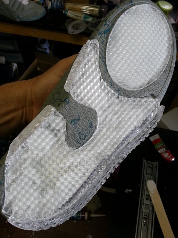

UPDATE on that caulking silicone. When used on a pair of shoes that had no polyurethane on the mid-sole (you may have seen images of my US8s where I had layered white rubber in the recess?), the bond seems good. However, it seems to just peel away from where the polyurethane was. Maybe because when it air cures it goes shiny, don't know. So tonight I had to grind out the white rubber I have laid in there and then trim my clear parts to make sure they fit (the poly left a build up) before using the silicone. Even though cure time is less than 2 hours, I will let it set up over night and see how it is in the morning.
I must say, the white looks really cool under the clear (even on the darker soles) especially with the lighter grey on the mid-soles. If this method works, it "kills.two birds with one stone".

UPDATE on the silicone. Ummm, yeah. Great for a dispolay pair, not sure it would stand up to wearing them. If it is thick enough it works, but if not, it just peels.
attachment.php
So I will stripping back both pairs I am working on now (even though technically they are both display pairs) and bonding with a proper glue after I re-coat the surface in white polyurethane rubber. I might just coat the inside of the clears and let them set up on a level surface. That way the inside surface is 100% coated.

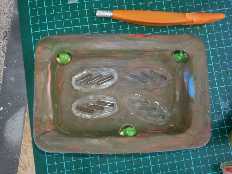

I am also making the mold for the re-worked ankle bubbles. I am making these standard size to fit all V2s and HCs the bubble itself being larger, so it protrudes.
attachment.php
After I finish my new heel cups (and mold those), I will making a slightly larger more accurate set to go with those.

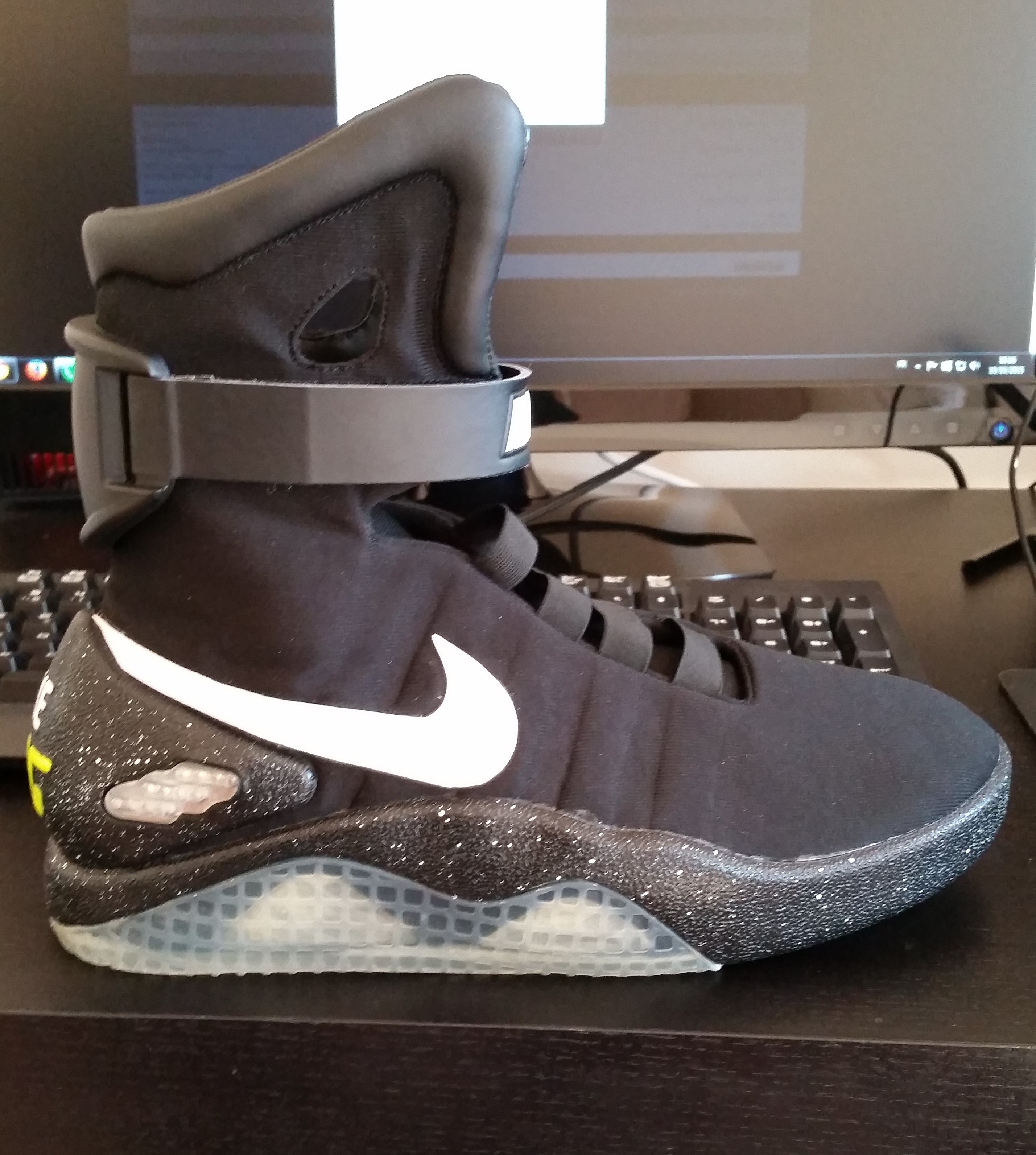

White swoosh on, it is handly cut after 20 tries of laser cuting only the left swoosh was good enough so i had to do 15 tries to reach this swoosh with xacto, i am not 100% satisfied but you have to look really close to see it is handcuted.
nice Klen. If I were to get a set of black V2's I'd just go with white and black too. Wasn't a fan of that gold colour. Did you try cutting with a really sharp, new pair of scissors? How would that work out? I haven't worked with fake leather yet as there is no shop near me. But a materials shop is opening close by soon!
I Could give it a try but cutting this material with scissors is hard because it is thick (~2mm).
When you use scissors on stuff like that, you need to make each cut a single one or you get small bumps along the line. Not the easiest thing to do sometimes. Laser cutting would be ideal for this.
