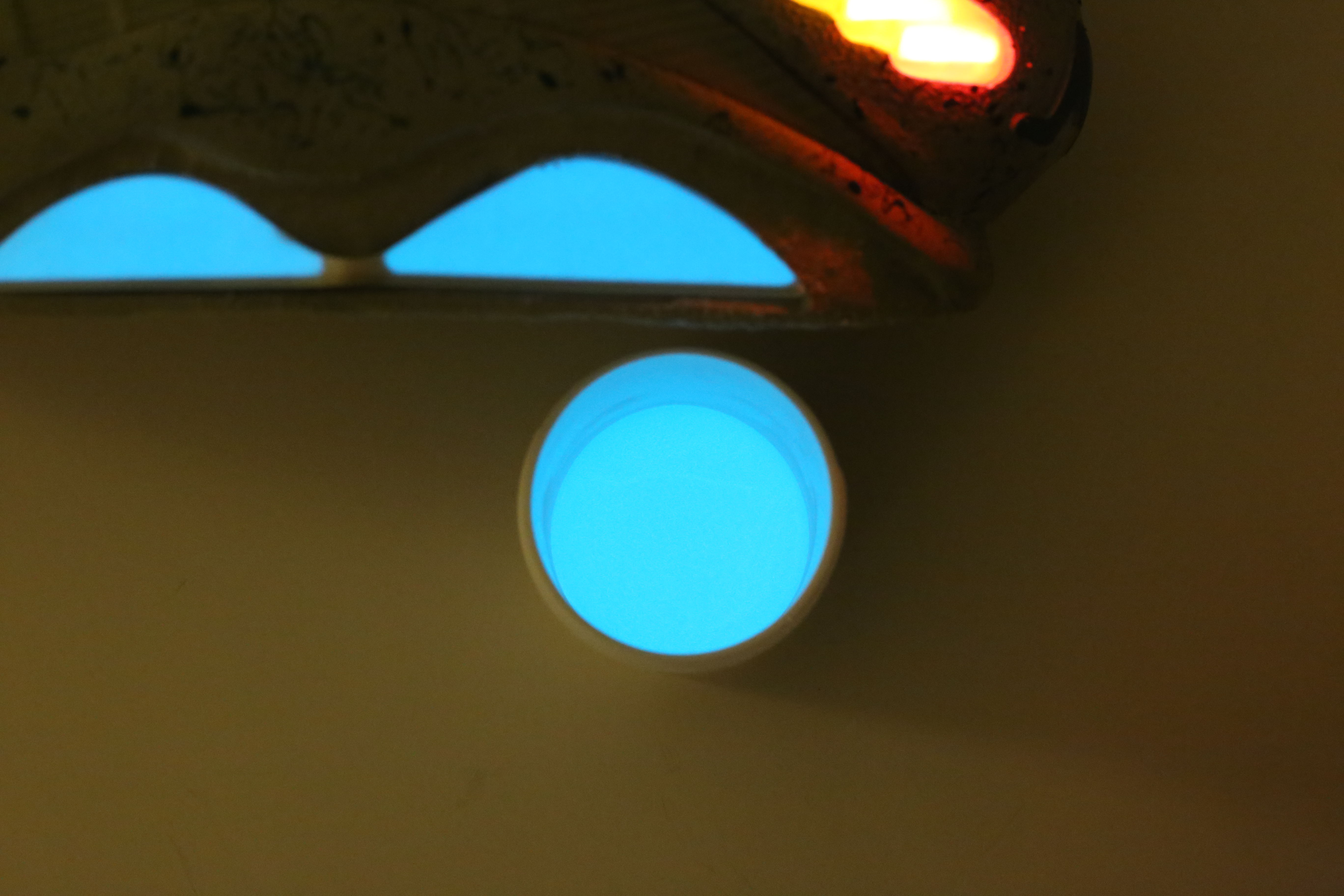

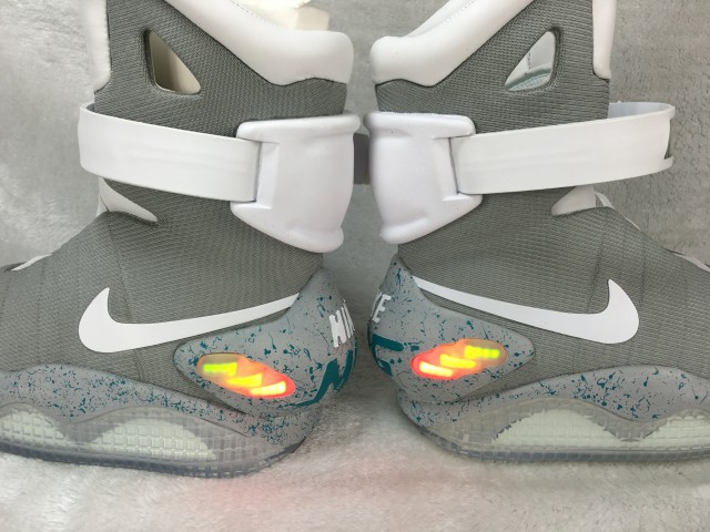

I actually have some glow in the dark powder which is a VERY close match to the actual EL panels on these V3's (see pic) Its strontium aluminate based powder, which is some of the best I've found (and unfortunately the most expensive Ive found too lol) The initial brightness is brighter than EL panels, but that doesn't last for more then a few minutes...and its downhill from there. However, this stuff will glow dull all night long. I bought it to do a custom pair of V3s hopefully, I want to do the soles completely glow in the dark like yeezys are lol. Wouldn't have to worry about glow in the dark domes breaking though...would be nice haha.
Nice. My 1KG bag was $127. It is CYAN in colour and as you said, super bright for the initial run. It fades quick, but glows dull all night.
What percentage did you mix yours at?
It is supposed to be 5%, but I have taken that to 33% with no issue (I did tests to 50%, but it does not pour) and it glows really bright then. The problem is, I had to mix blue into the rubber so it would not look like custard when not charged.
At 33%, it light sensitive. Just the light reflecting off my projection screen is enough to make the panels visible in the dark. The LEDs on the car headlights charge these to max brightness in 10 seconds.

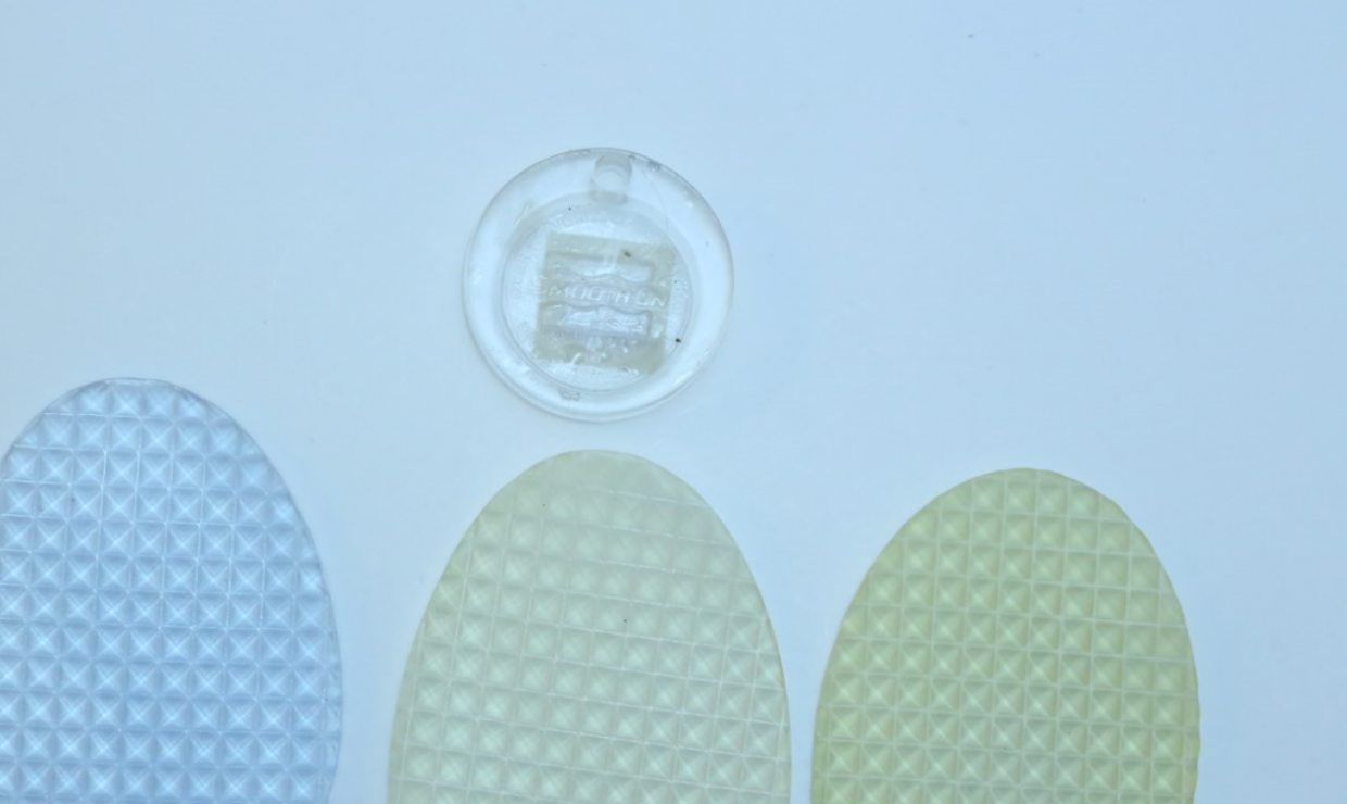

So how long do your new water clear soles last until they turn yellow when in direct sunlight for a very long time? Also what sizes of V3 do you make the soles for?
The round sample part in this photo has been outside all day every day for going on 2 years and its still water clear. It has the same UV inhibitors as the rubber I use, just a different hardness. I haven't seen mine go cloudy yet, but I have read they eventually can. But yea...that's if your shoes were outside all day every day haha I am still checking sizes, but right now I know these fit 10 and 10.5. It will probably have to be done by measurements because I have seen inaccuracies in the actual sizing of these shoes. (Either that or I have received a mislabeled shoe)
I always go as thick as I can, I normally just coat my molds with it though very thick like paint...then go back and fill them up with regular material. Cheating I know lol saves a ton of glow in the dark material though.

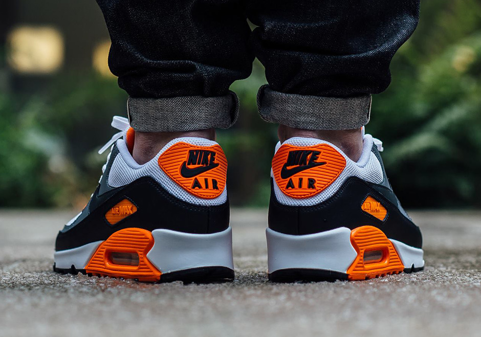

Interesting that the shoe itself does not have AIR anywhere on it. They even made a special version of the NIKE/SWOOSH logo that incorporated both the NIKE/SWOOSH and the word AIR. You will see this on some retro shoes where this new logo was embroidered onto the heel.
I always associated the word "MAG" as the model name, such as the "Roshe" which also doesn't have air.
The Air Max 90's might have been the kind of combined logo you were thinking of? It's a rubber panel sewn onto the heel.
Prior to these molded logos, these were sewn in. If you watch the 1990 TOTAL RECALL, Sharon Stone's character has some sports shoes on with this.

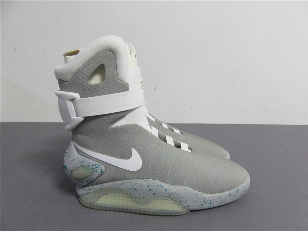

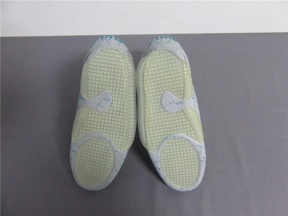

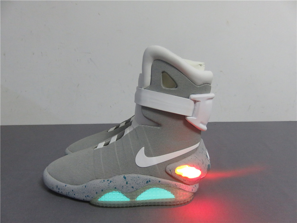

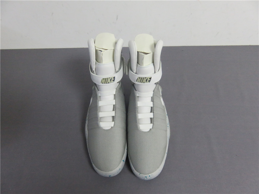

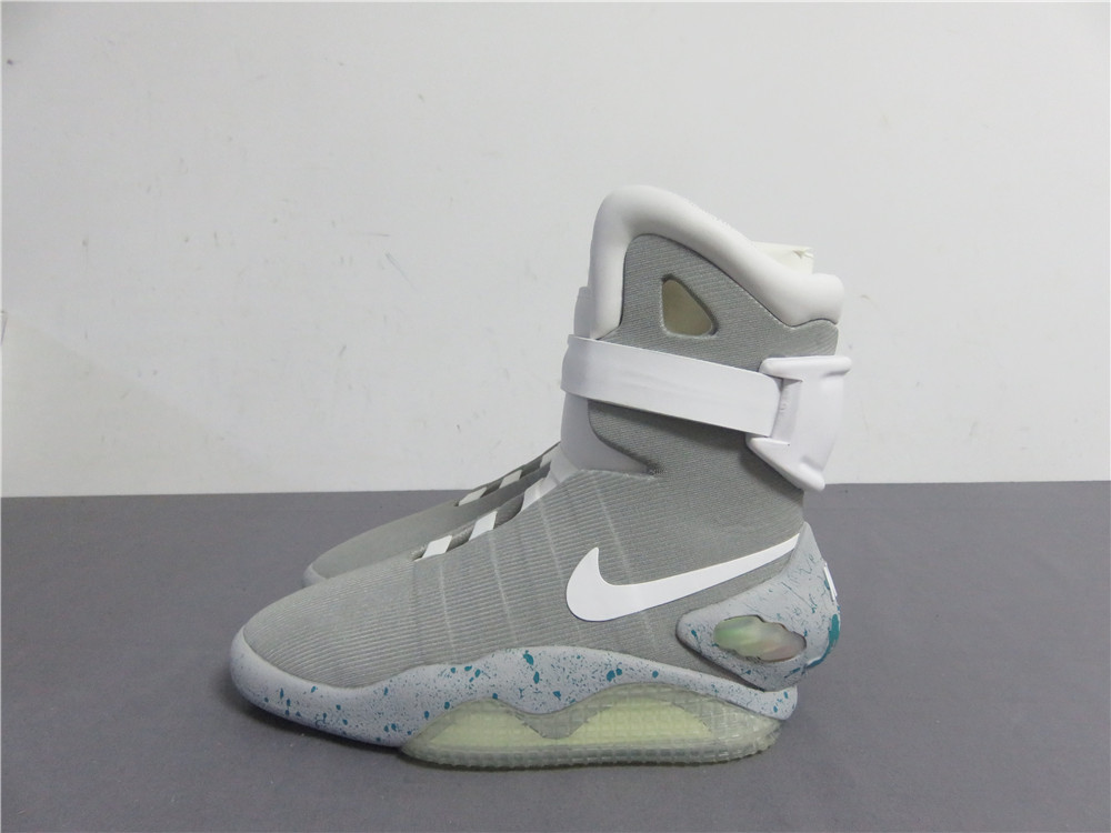

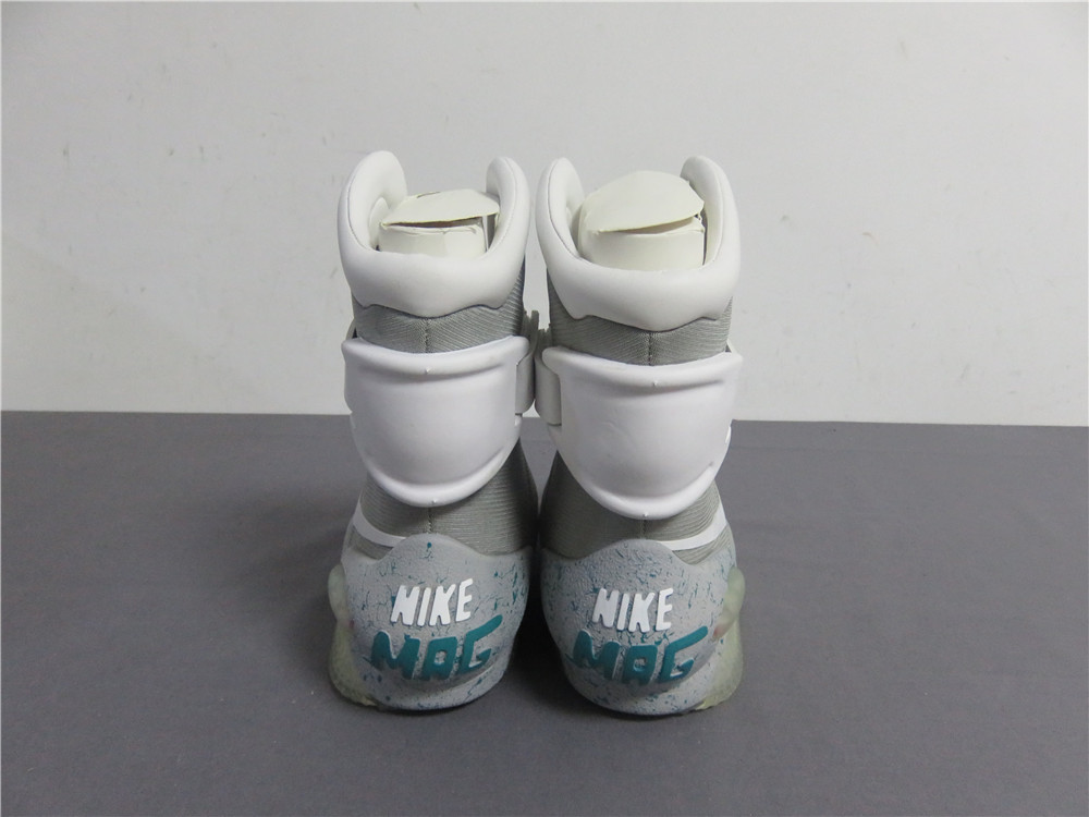

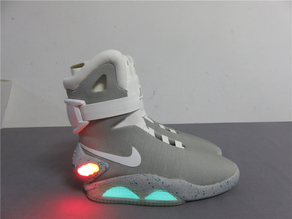

Guys i need some advice. is it just me or are the EL pannels very dim on this pair ?
they aren't on and neither is the strap I assume
The fact that they'd even send those QC pics is kinda insulting..
