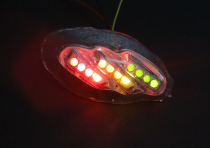

Yea I think I am with you on that, especially since Its not going to be as easy as just adding an inverter. If it requires changing all the panels (which it seems to) I'll probably leave it at that too. It really doesn't appear to be a big difference in brightness either...now those LEDS yea those are way too bright.

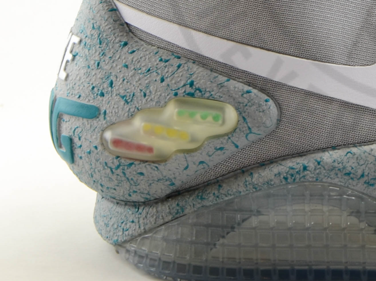

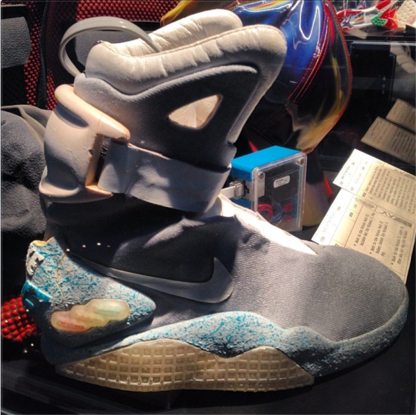

Having never seen the RD in person kind of tricky to know what needs to be done to make the bubble accurate. Going off pictures...it looks like the original 2011 bubble is actually frosted as well. I think the thing that will make these V3 bubbles look like the RD...dimming them and maybe even moving the LEDS closer against the plastic. (You probably already saw for yourself) but yea they sit like 1-3mm away from the plastic.
I think I am getting close to the brightness right though (all of the leds on the END are the original brightness, so far I have only got the top 3 green dimmed right) Also that's one of the bubbles I cast, it came out way too clear. Will end up sanding with 1000 grit to frost it a little, or adding a very small amount of white pigment to make it look frosted. The picture below is the RD one I am going off of...it actually looks pretty darn frosted to me...yet you can still clearly see the LEDS I guess because they are closer to the plastic

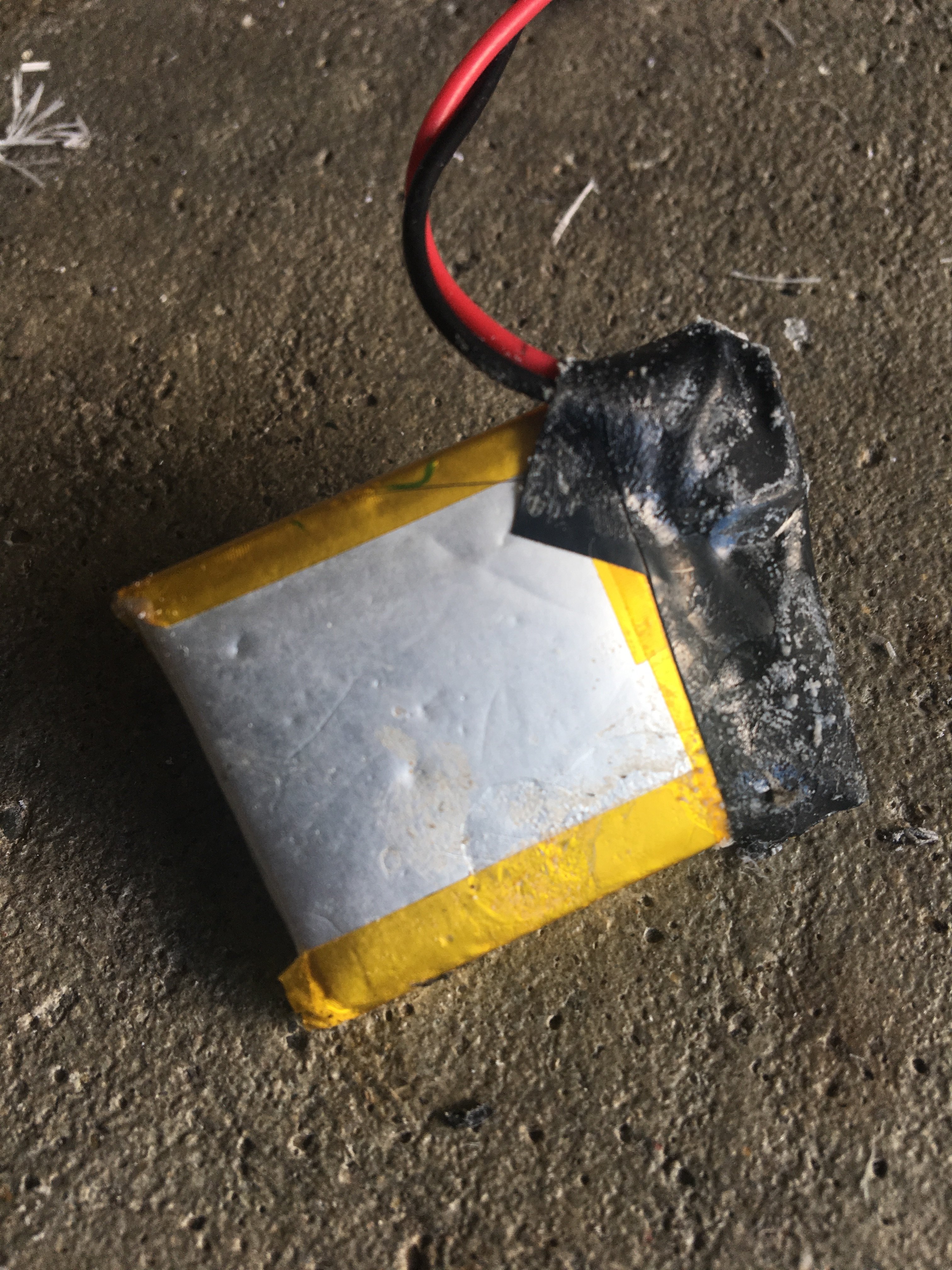

So this tape has been on this battery a while to tape down leads from breaking off. It's the only lipo have had that has puffed up. Looks like that causes issues in my opinion. I don't think there were other factors involved but I may be wrong. Just a guess. You make the call. It's full of air ready to pop.
