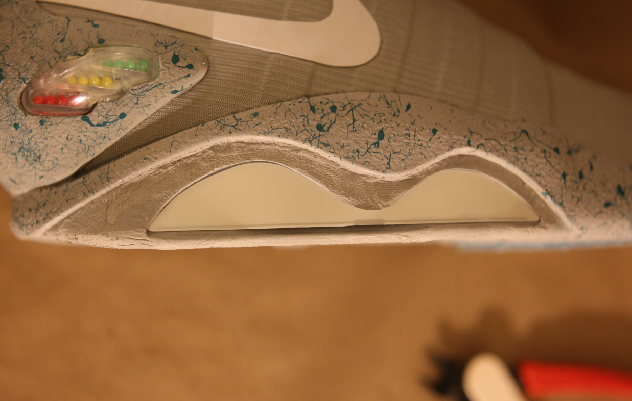

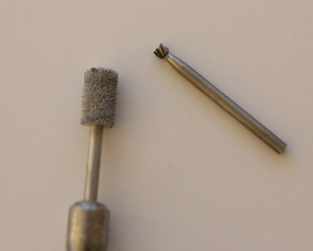

Here are the bits I used to smooth out the foam. Carbide bit and a carving bit. (sanding drum also works pretty well) Once the area was leveled out I hit it with a jet lighter quickly to get rid of the fuzz that the bits leave behind. Wiped down with 91% iso before glued. You don't want to get it completely smooth anyways, you can't see it once the clear soles go on and you need it to be roughed up so it adheres well anyways. The side soles I make are slightly thicker so the area can be sanded off, and when they are glued they will still be flush.

I used the same rubber (but with tints added) that I make my clears from. The rubber I use has a 15min potlife, after which it turns to a gel and then becomes really, really sticky. using a stick, I can apply it to the midsole and shape it. It still takes 6+ hours to cure and sometimes I have had drips but they are easily ground off using a rotary tool.
I also did my spatters the same way.
