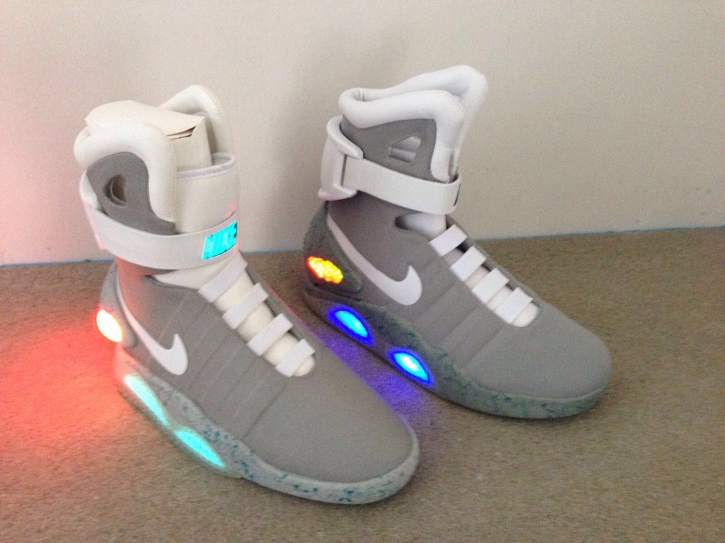

Some quick comparison pics from my V2's vs Emma's V3's

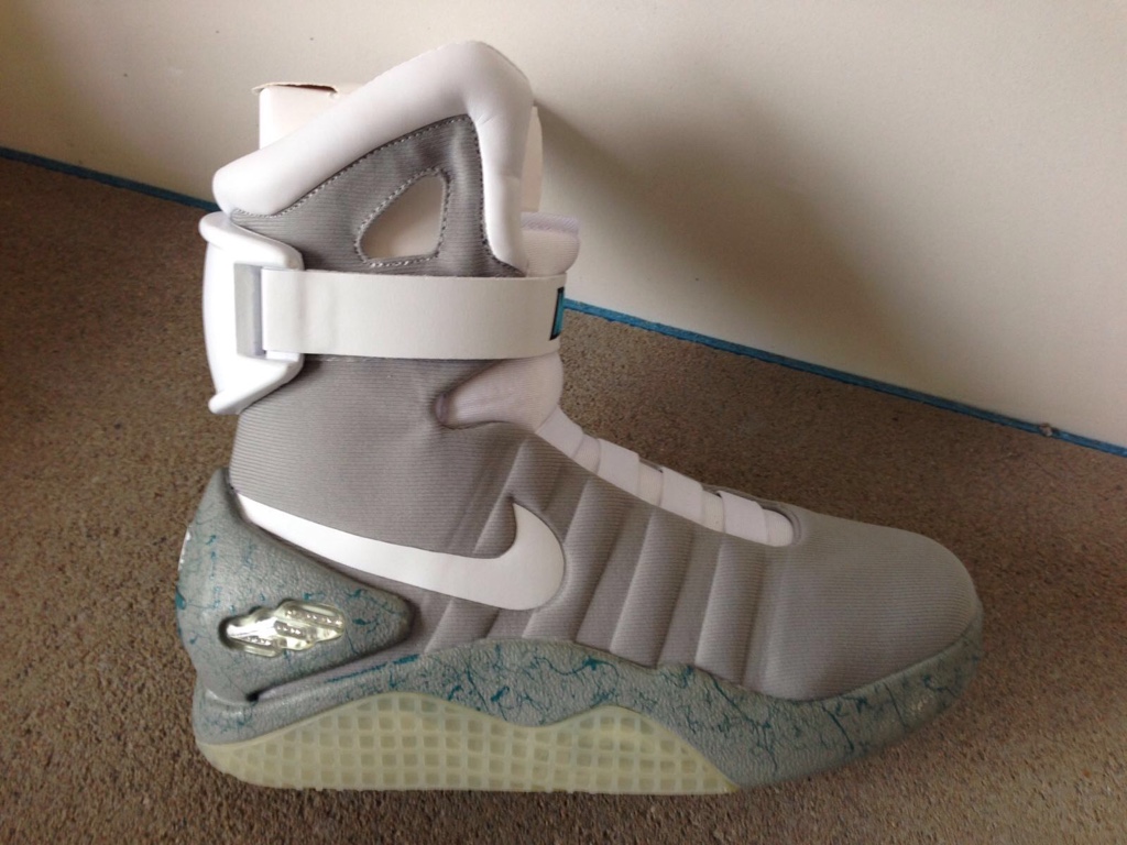

The glue I was testing didn't hold very well...removed it (thankfully only did a small test section first) and going to try something better. Also still trying to perfect the right amount of blue pigment. This batch is mostly clear, with just a hint of blue. I have never owned the RD, but I think I like this the best. Here's a quick pic before I try the proper glue...as you can see the ankle bubble mod and the icy sole makes a pretty noticeable difference.

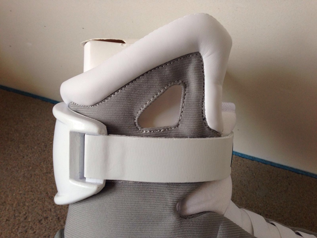

Wow, now tha you've opened these backs, could you look what materials are used under the fabric ?
Can you take some closeups (and / or macro) of the white material and tell us if it is fabric or foam or something else ?
really curious about that as i made several uppers but can't figureout what is the best material to put inside them :/

Its a hard foam, soft enough to leave the imprint of your fingernail...but not much softer then that. Then there is a white mesh type fabric between that and the grey fabric, which is probably there to absorb/spread/reinforce the glue I'd imagine.

@001FAB awesome comparison. Damn, those V2s (that we idolised) look bad now.
Thnx!
They once looked amazing for most of us, but this indeed shows the huge difference between the both unmodded versions.
Sounds like the stuff I pulled out of the toe box on my V2s when i did a sock toe slim. It is thin weave/low thread count, but is used to "stiffen" the fabric so it holds its shape.
