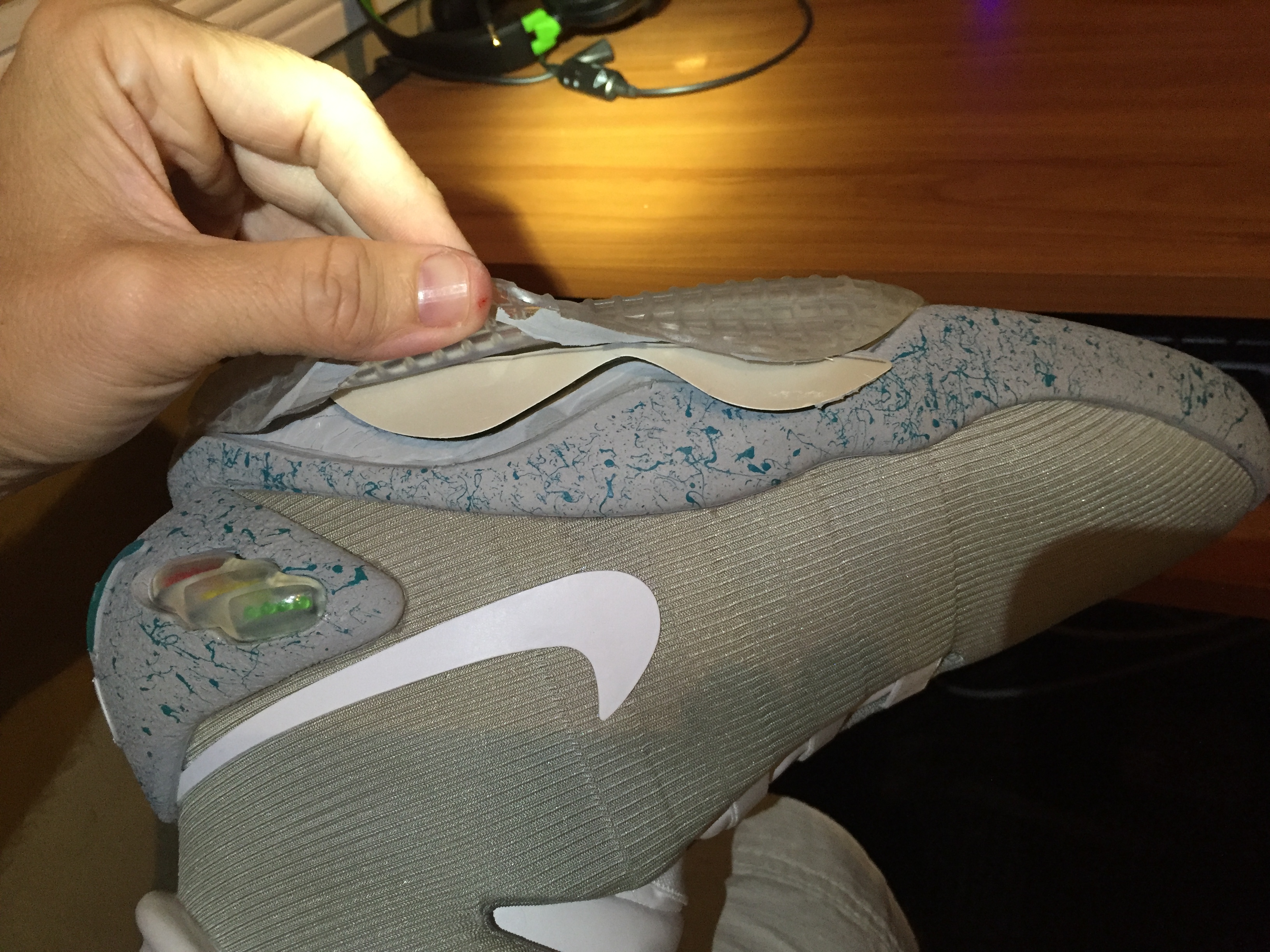

Its a hard foam, soft enough to leave the imprint of your fingernail...but not much softer then that. Then there is a white mesh type fabric between that and the grey fabric, which is probably there to absorb/spread/reinforce the glue I'd imagine.
I guess that is the same mesh i found in the HCs and on the V2 Toebox.

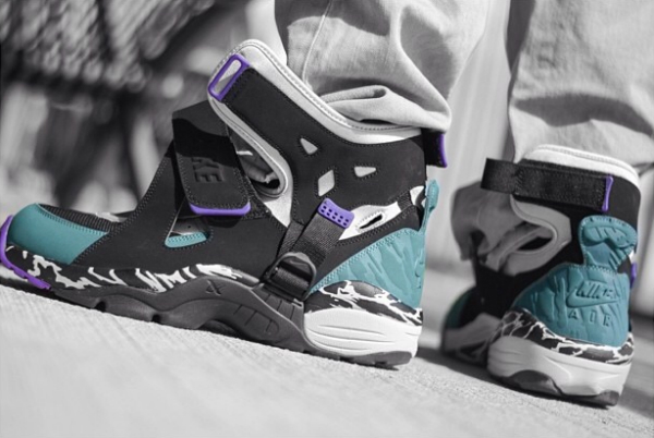

The weirdest looking shoes I've got are the Air Carnivore. (photo is not my image)

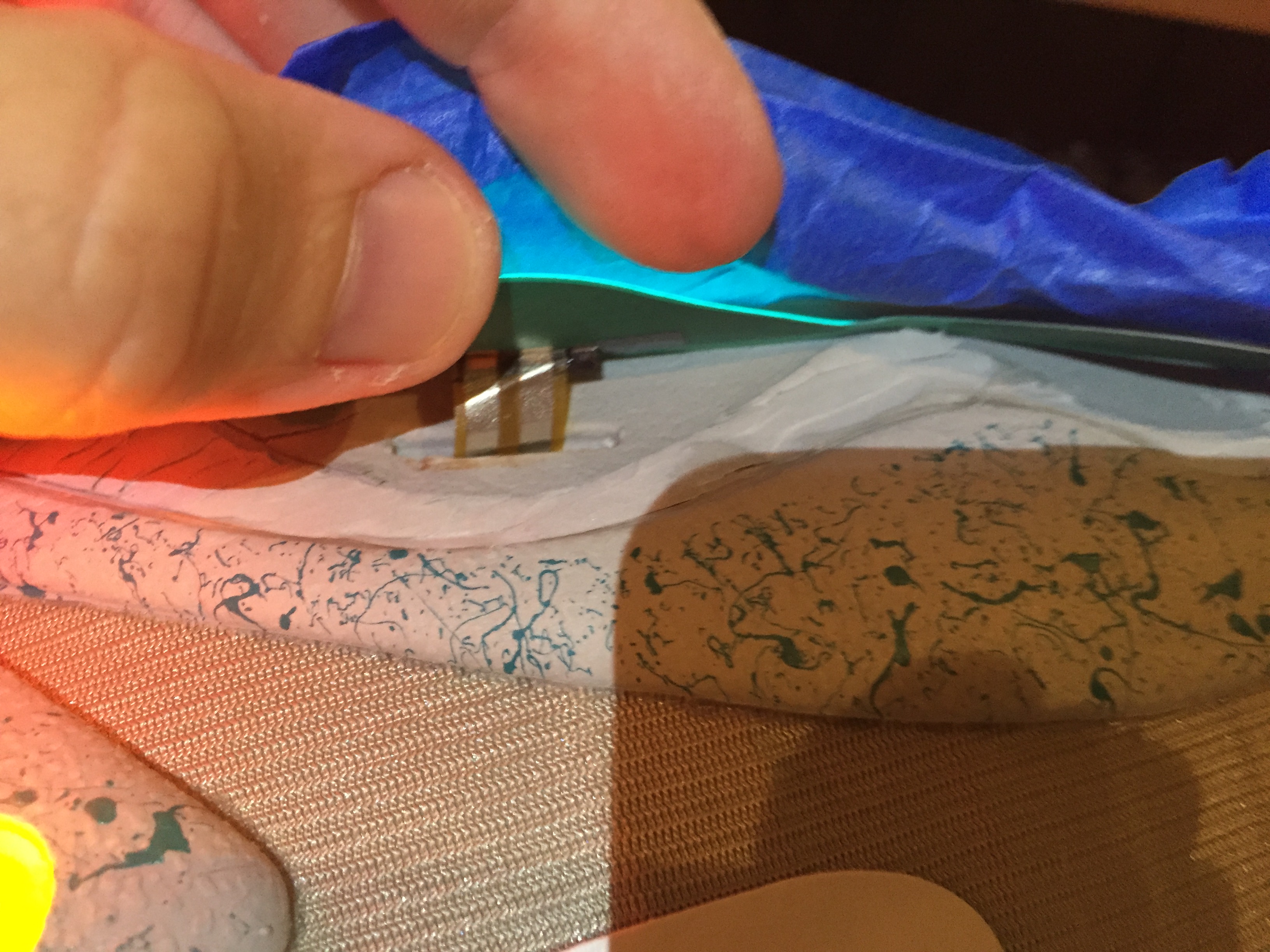

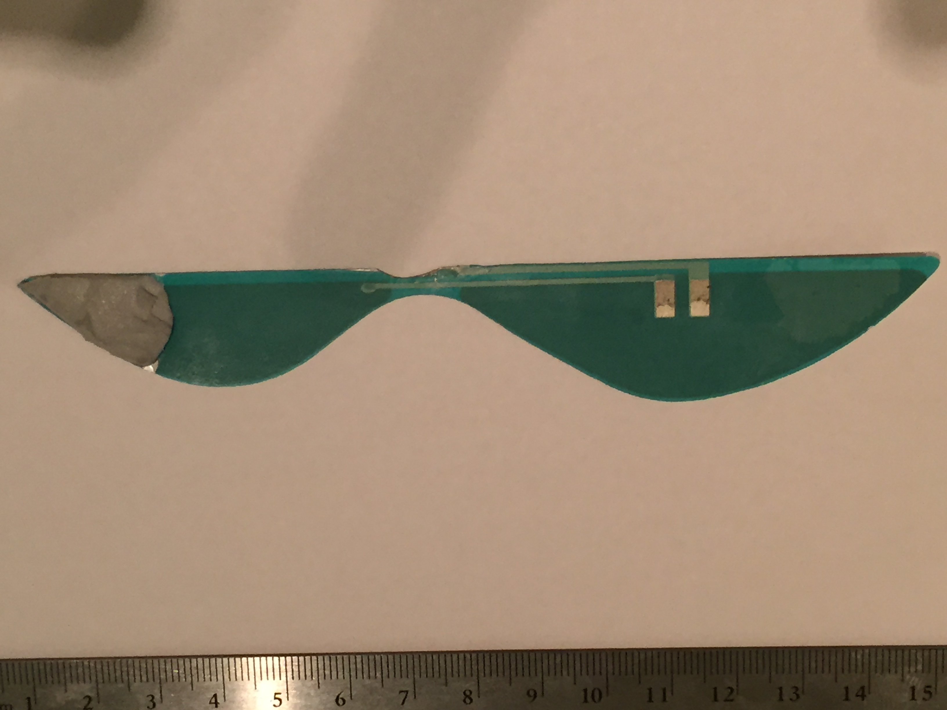

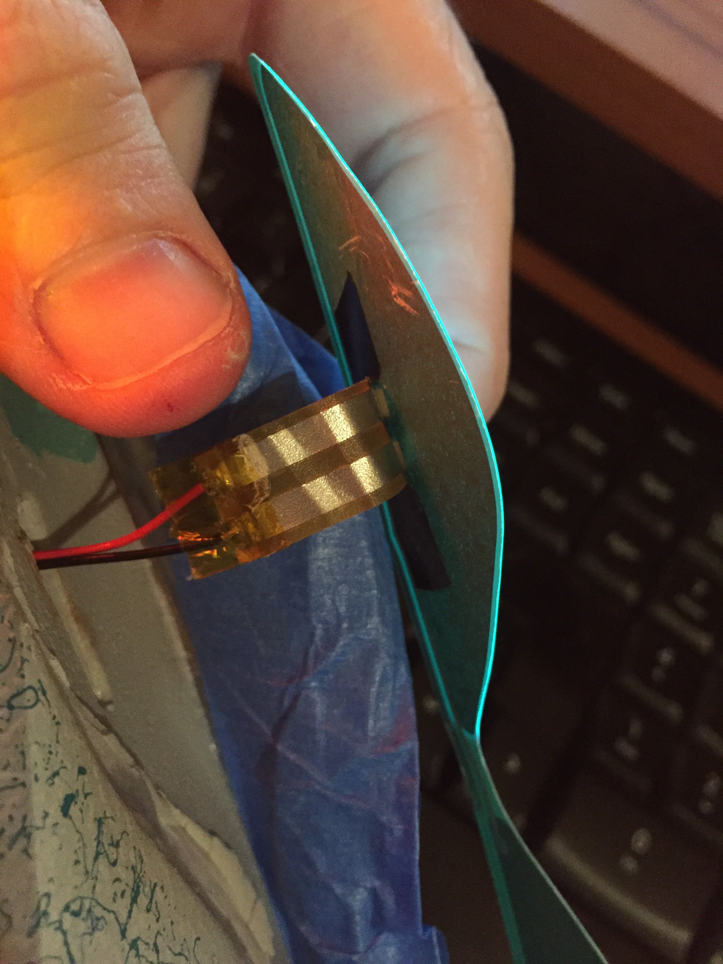

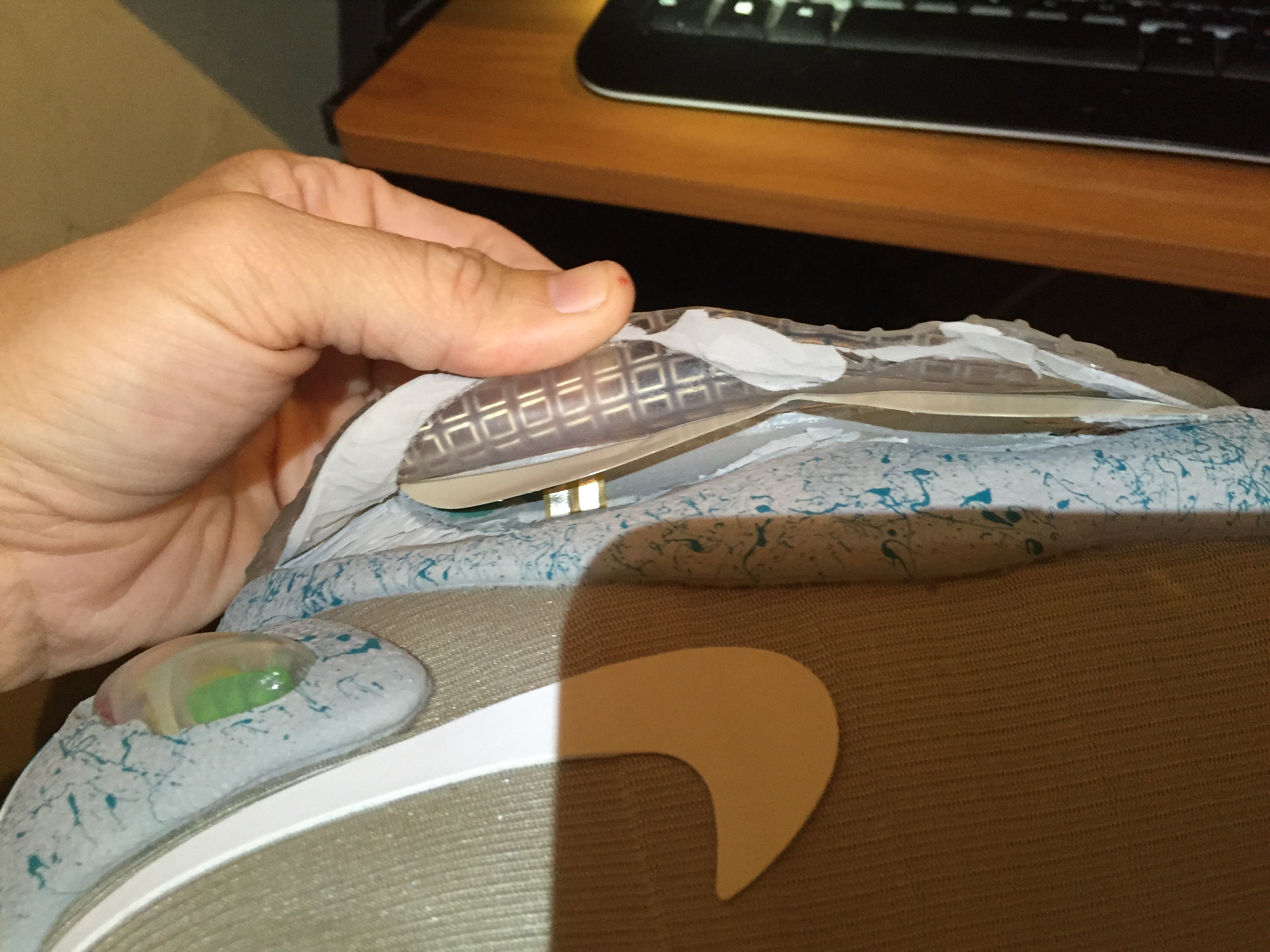

I am working on replacement V3 panels. They should be much stronger than the existing ones, and since they are made slightly differently, there is virtuallly zero chance of one half moon going out.
The key part is the connection from the panel.
On my current ones, the connection is going from the end and folds over behind the panel, whereas these V3 are connected via a thin copper tape which seems to peel off easily.
