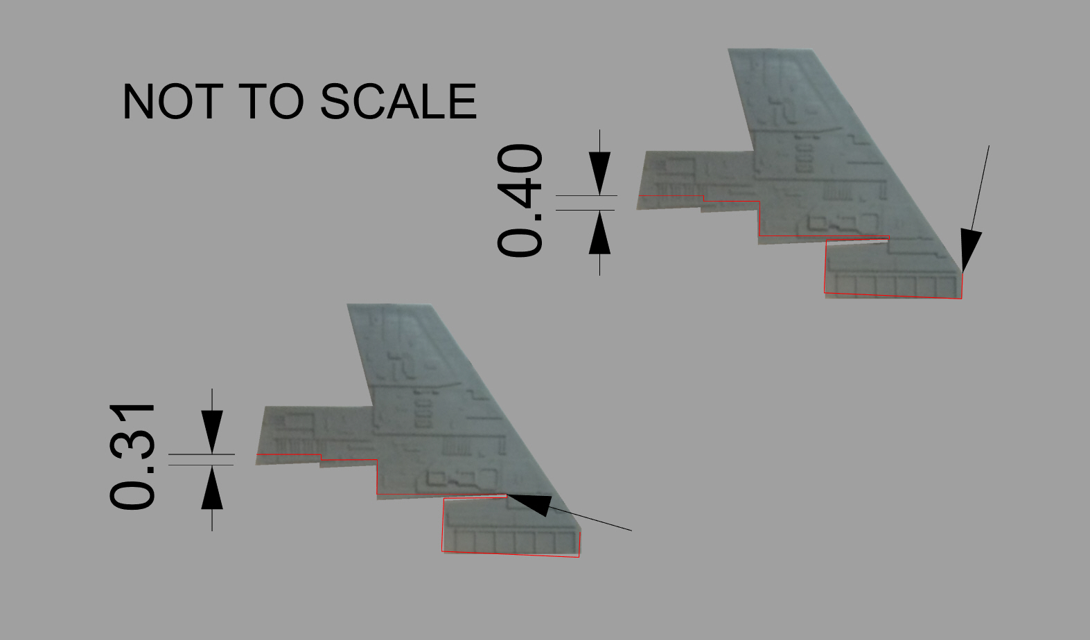

On another note, I'm trying to get my head around how best to tackle the angle of the bridge. I'm thinking in general any trimming should tilt the assembly forward, hinging at the aft-most edge, rather than raising that rear edge, but I'd love to see anyone who has come up with a solution throw some pics up!
I don't have my own ZSD just yet - a week or two out, based on others' luck, but I did play with one of the images that was posted of the tower sprue.
While the aft most point of the tower is a logical spot to begin, I think that results in losing too much tower overall, and would be a harder edit. On the other hand, a rotation about the upper aft corner of the slot for the upper edge of the superstructure seems to be a bit better, in my opinion.
On the gripping hand, this does mean that the bottom aft corner will need a bit of plastic added, and whatever other adjustments as may be needed.
The numbers shown only reflect the relative difference between the two options - I just took the image and threw it into Rhino to play with.

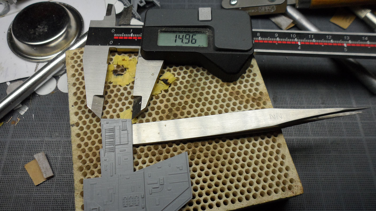

If you need some measurements please feel free to ask;

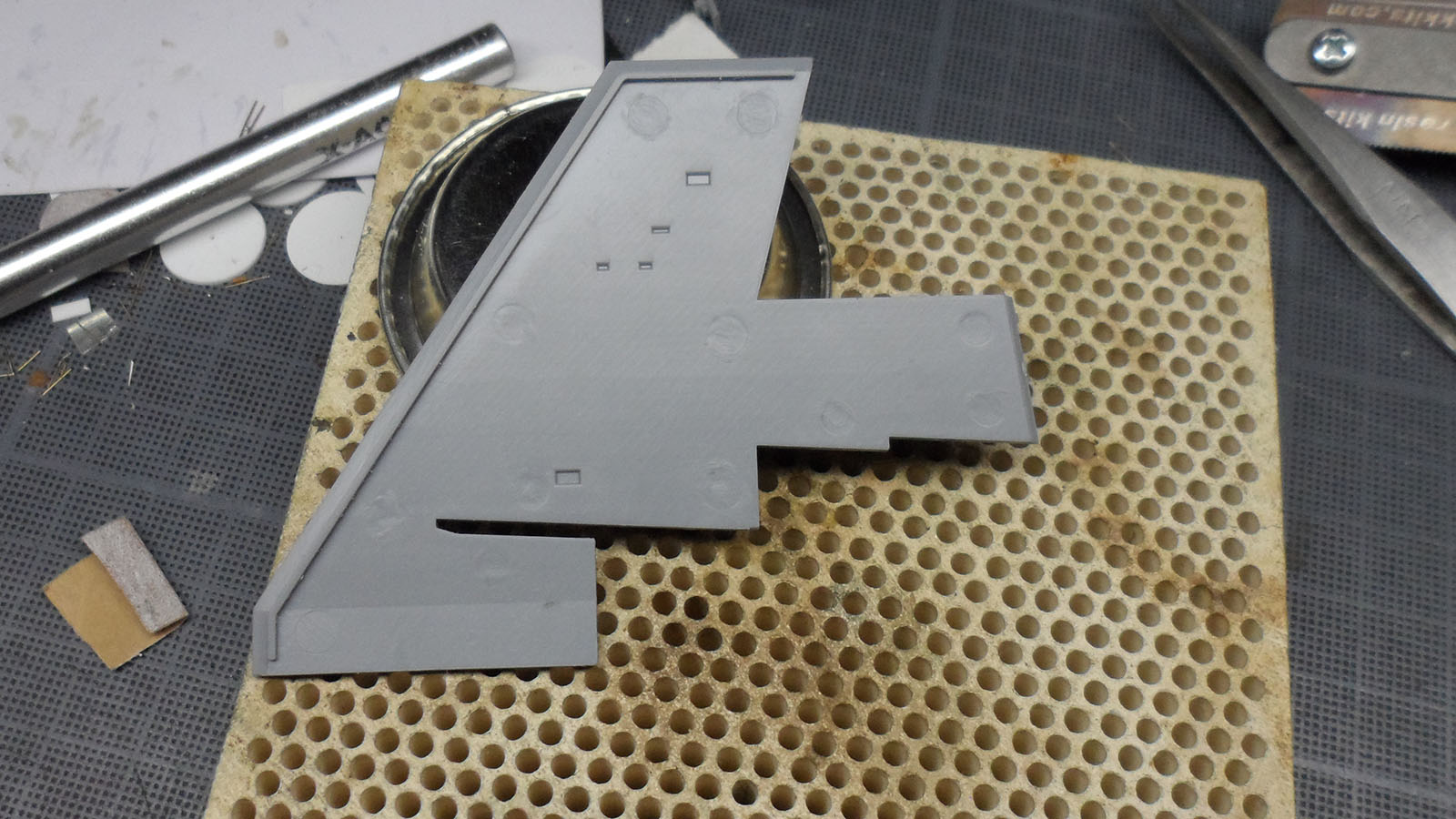

included a pic of the back face of the piece, which isn't flat, there's a small 2-3% angle decline at 6mm from the base.
It's not necessary to tip the whole tower, just the bridge structure.

Once you get yours in hand, you may find that complicating the geometry puzzle is the fact that, as far as I can tell from dry fitting the pieces, the tower doesn't actually sit on the upper hull, but on a teeeeeeeny-tiny angled ridge that runs fore-aft from the back of the cake layers. My reasoning for tackling it from the back edge is that I THINK you can tilt the whole thing forward, making the bottom of the tower assembly parallel to the hull, without cutting into those rectangular details at the bottom-back edge, and just dropping the forward end closer to the wedding cake. I think the space between the bridge module and the wedding cake is a little too large now, so....perfect?
It may be that it's necessary to remove a bit of material from the bottom of the tower as well. The key will be to alter the interface angle with the superstructure while correcting the overall height at the same time. So it won't be just a matter of analyzing the pieces - I'll have to do some serious review of images of the studio miniatures.

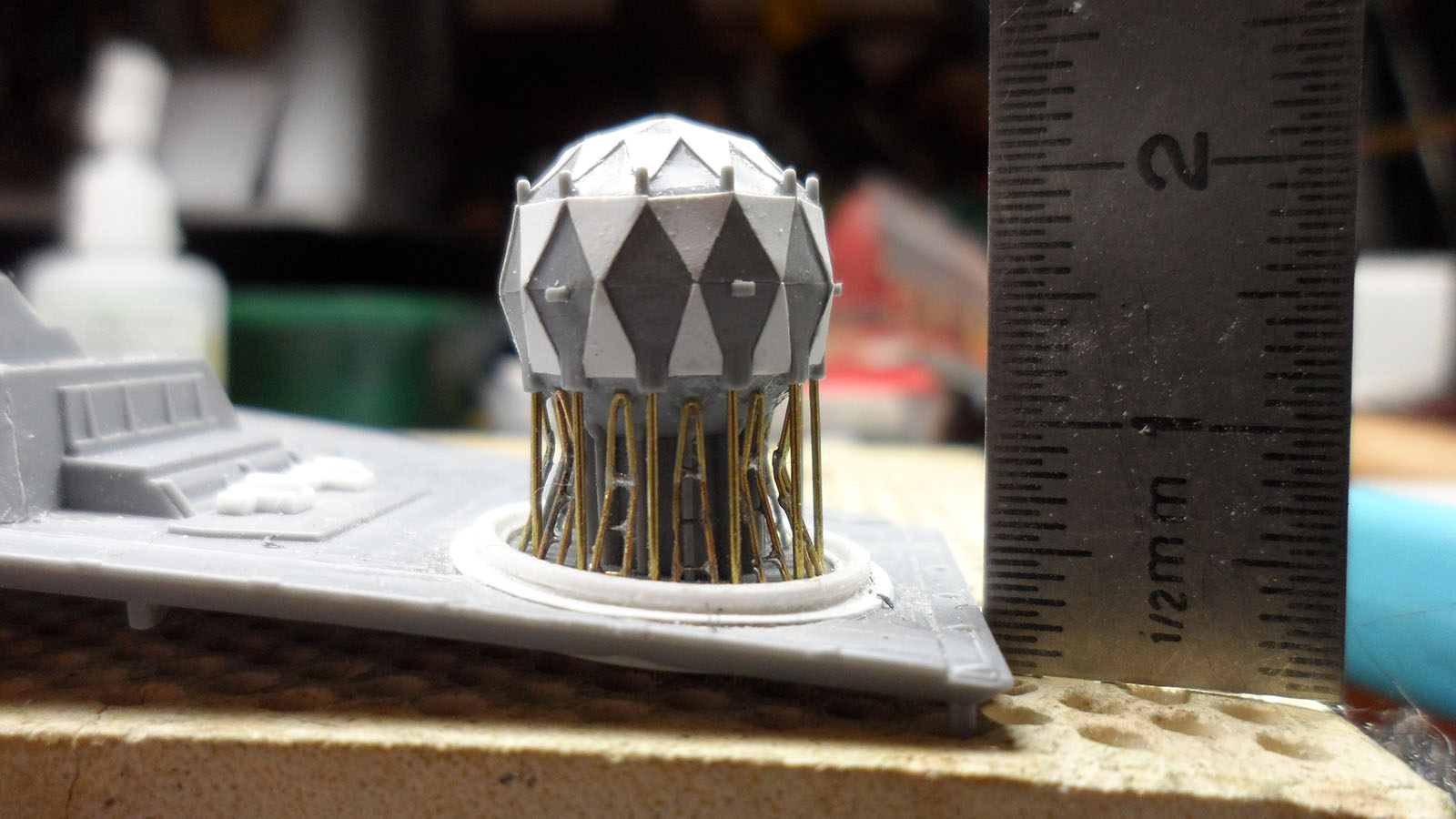

Just wanted to drop this here in the Zvezda thread. A new set of shield generators from Tony, aka 308bits, on Shapeways. You will need to modify your bridge to fits these as they are screen accurate. They will not fit the hexagon base of the Zvezda kit.
Those shield gens from 308bits are sure pretty, but the supports don't seem slanted so you'll have dig a circular trench in the bridge's roof through the octagonal bases which will not be easy or replace some roof sections entirely .
On my build the inner supports aren't as nice, but vary from 8mm on the outer edges to about 6.5mm on the inner side. ... sOoo many rejects .
Maybe Tony or someone could design a slanted "cup" with a flange that the generator would sit in? The modeler would just need to cut a hole, drop the cup in and then drop in the generator into it.
Pardon my crude drawing skills.
