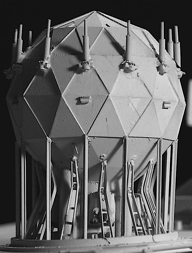

Nice work. Bill,
Two things though..if I may... the inner supports should maybe be a little less angled and extend closer to the flange's diameter
the other thing that look a little off, are the antennas, that look a bit short .. or have you done them that way to leave the opportunity to drill them and add the thinner segment?

Nice work. Bill,

Dude!!! That is the pic I've been needing!!! Thanks. I couldn't tell from my references some of the underside details. I will adjust accordingly. And I'm up in the air about the antenna, the print limits them too large for my taste so I was thinking they'd be better replaced with wire. Not sure.
Thanks again for the pic. BTW, I'm slightly colorblind so it looks pink to me. :)

You're welcome...
Got the pic from this post, link is still active to raiders' Onedrive archive.... huge amount of pics.
http://www.therpf.com/showthread.php?t=208234&highlight=Avenger
There's also a Montreal expo but pics are in Raw format and need to be converted for ease of use and space.
In general quite a few threads to search for refs. in the studio scale section.
about the antennas don't sweat it ... people that care for accuracy will add wire others won't ... if you're at minimal thickness for shapeways it will still be very small.

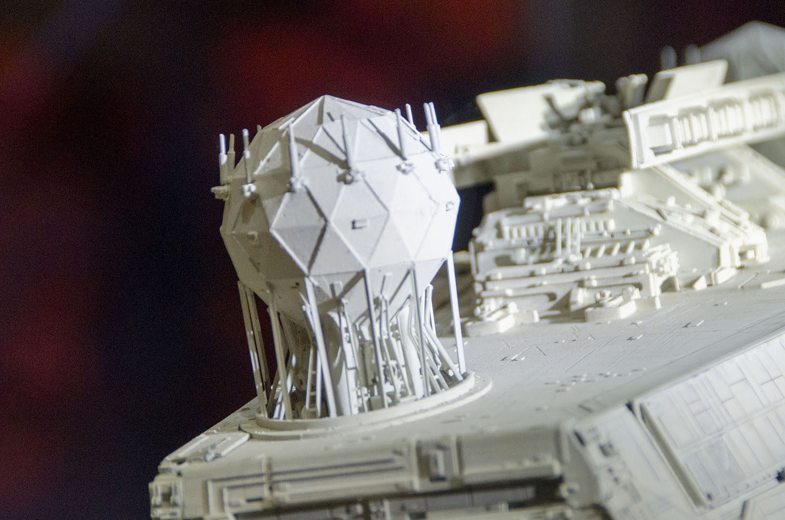

ok, I did a little more work to this based on the pics you'd provided links to. Thanks so much for that! Its still not perfect but I think it's getting closer. The problem is the limits of what can be printed and still come out looking correct-ish. Any other suggestions on this?

Since the depressions on the little ladder shaped greeblies are actually holes, but you probably can't do that at this scale, how about making them just a bit deeper? That way they'll capture more of a wash when painting, looking more like holes.
I'm up for two, certainly. Nice work - not easy. What's your modeling app, by the way?
Thanks Steve, I'll look into seeing if those recesses can be a little deeper. At some point they start being considered as a wall instead of an engraved feature and Shapeway won't print it. The program I use is Solidworks.

Nicely done.. But the slope on the lower section does look off to me, it may just be angle of the render though. Regarding the ladder structure, I've been able to get short runs of .4 mm successfully printed in FXD for biplane struts. Is the tube and the dome itself hollow to reduce cost?
Thanks. It may be the render angle but I'm pretty sure I got the angle down to match what Zvezda has for the bridge top and that is pretty darn close to the photos I've seen. Here is a rough mock up image with my done on a pic of the bridge. the line I drew on the left side is extended off the pic roof so I could see that it's not catching glitches of the photo due to resolution issues and is lining up pretty well.

Well, You're assuming that the slope of the model is the same as the image...I'm going to go out on a limb and say..not a chance... I've got the kit under my desk, but don't have and angle measuring too, so I'm going to say it's not going to be as pronounced as that image makes the angle look.
Thanks again. Actually I had the roof in hand and measured it before using the image. It came out to an angle of approximately 7.5 degrees. I went with that, printed a drawing and lined it up on the kits part. I didn't notice how close the kit was until I made the composite shot after it was rendered. Pretty sure I'm close to within a fraction of a degree (+/- .125). But please do correct me if I'm wrong. My kit may be warped or what not. That's why I want to print a test shot before I make it to where anyone else could get it if they want it. I'm mainly doing it for my build because I enjoy the design process. It may not come out as good as the others out there but it's something I did so I like it.
