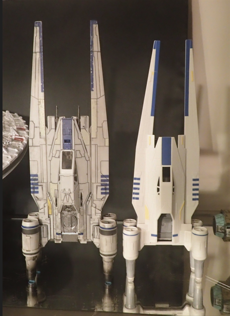

In the case of the U-Wing, it was definitely larger than the Revell kit, and according to Rebel scale, seems to be around 1/78, and it actually looked more accurate!
It had details Revell's so called "model kit" just simplified out of existence like the engine cooling vanes or whatever they are, (those things that look like the back end of a Snowspeeder)
I had always wanted a 1/72 kit so I picked it up. Same with the AT-TE. It is bigger than the Revell kit, and again, actually more detailed as well
These are pre-painted, and often a it of easy assembly is needed like snapping wings in place.

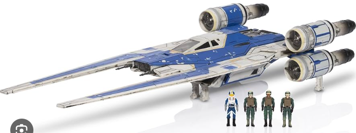

On the left is the Micro Galaxy U-Wing and on the right is Revell's U-Wing
Some subjects are better than others when it comes to the pre-paint and weathering.
The U-Wing is pretty impressive out of the box and I do not feel much of an urge to repaint it except maybe to mask of the blue areas and tone down the heavy panel lines

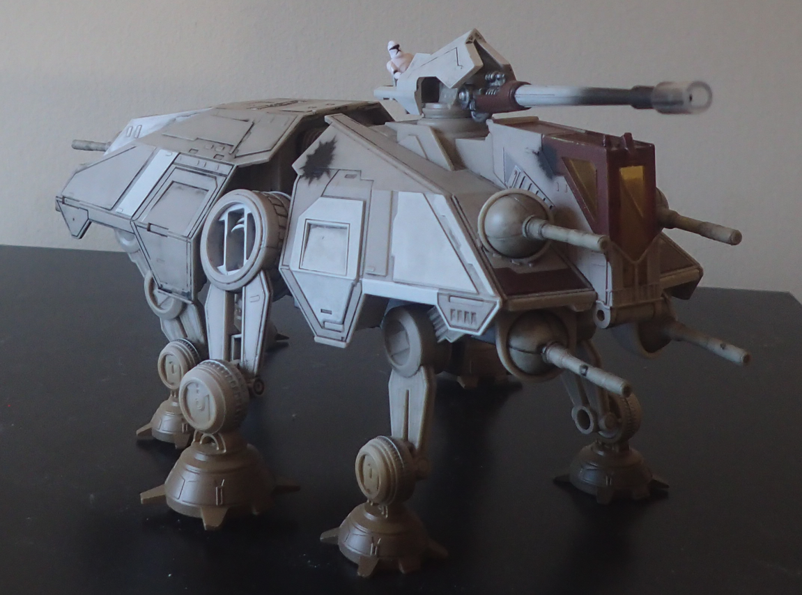

Next up is the AT-TE
This is supposedly 1/72 on the mark

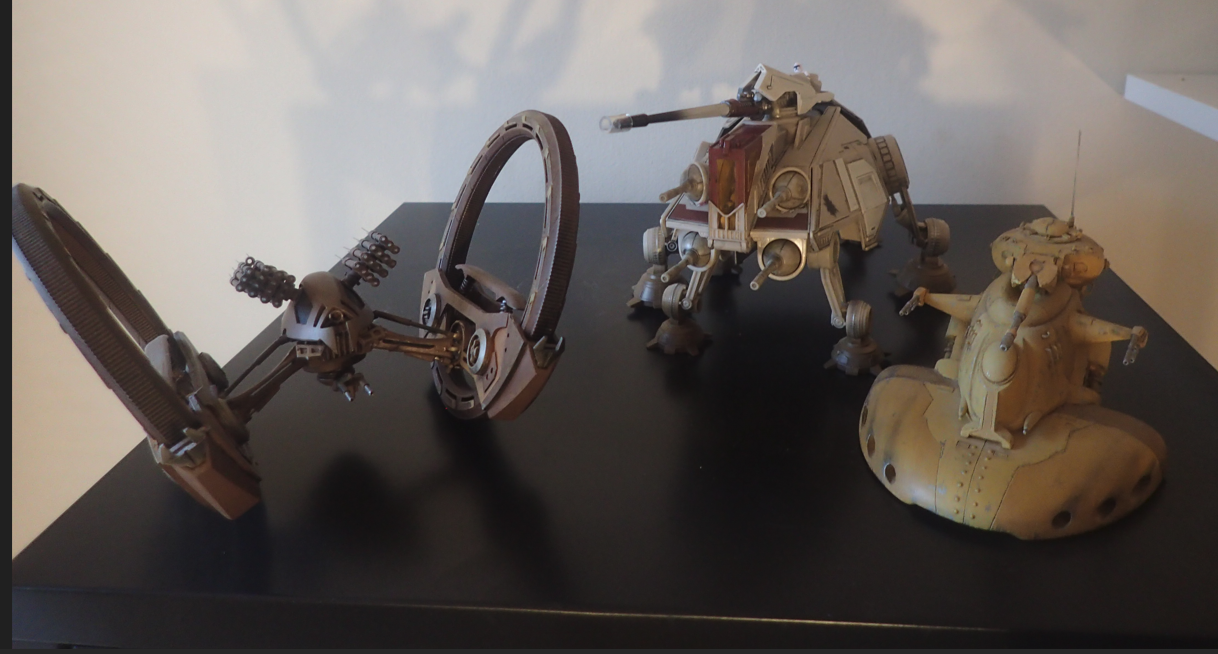

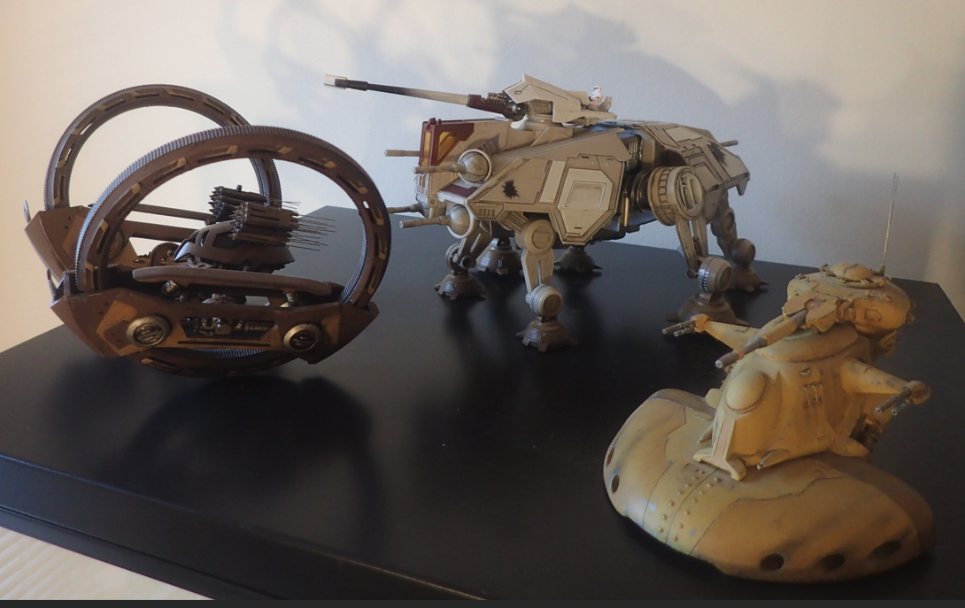

Here it is with some other 1/72 Trade Federation kits stuff from .jpg productions

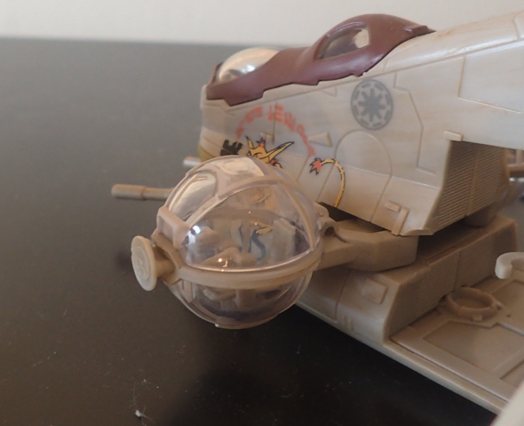

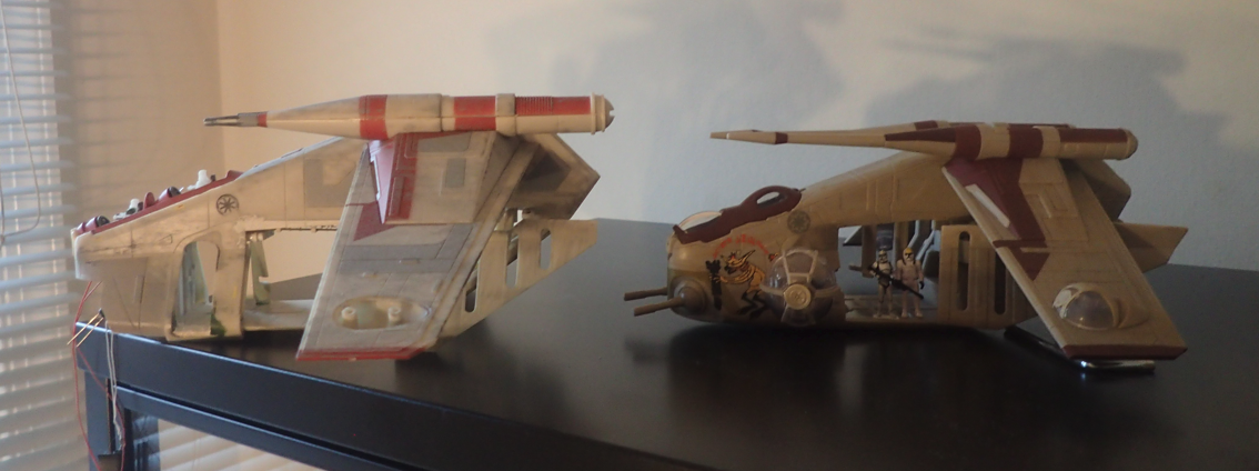

The Republic Gunship is also close, but on the small side for 1/72 around 1/78 or so. The Revell kit is a little larger, but the Jazwares item is much more accurate to the movie version
I can try and get some better quality pics when the sun is not glaring right in the window, but for now...
Revell on the left, the Jazwares on the right in the middle

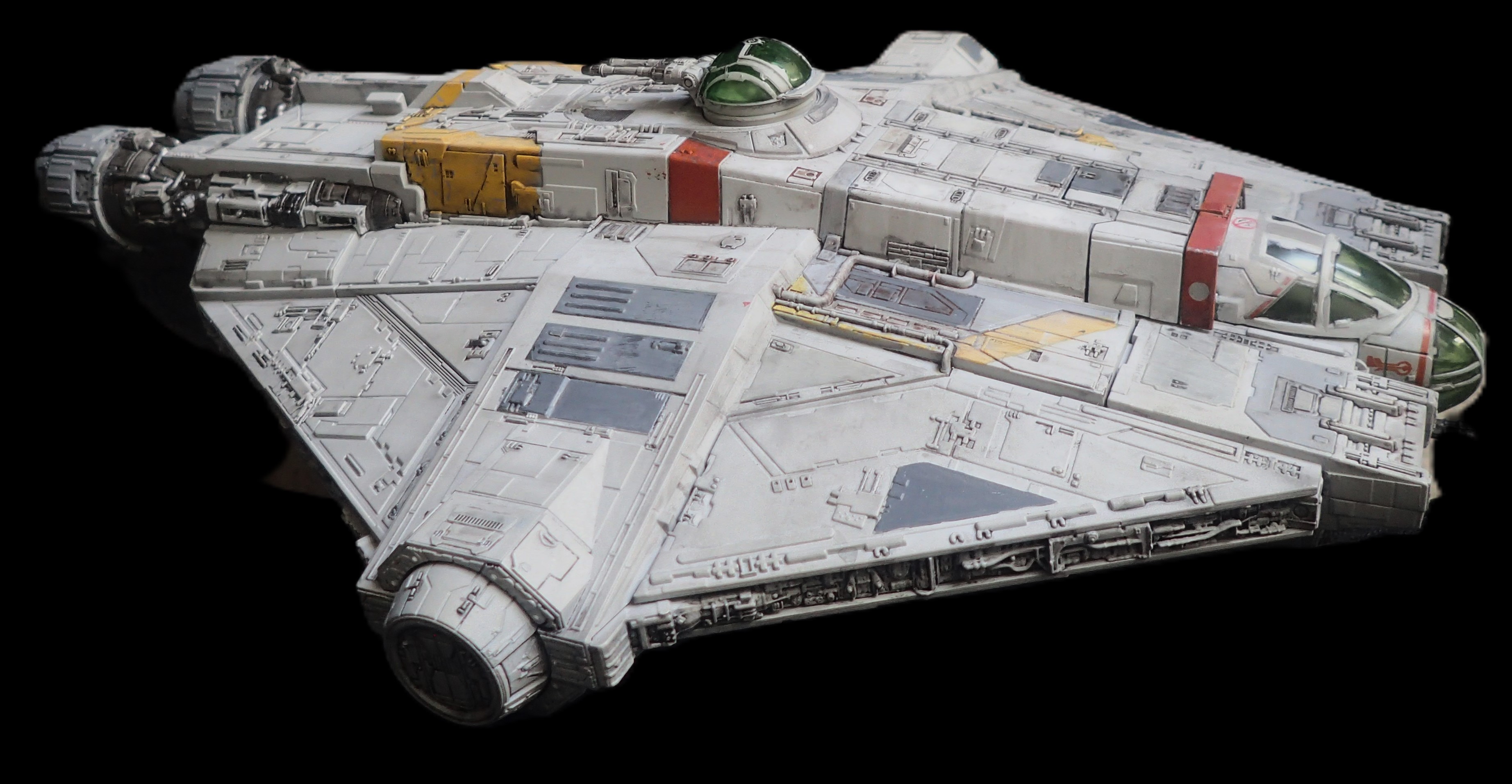

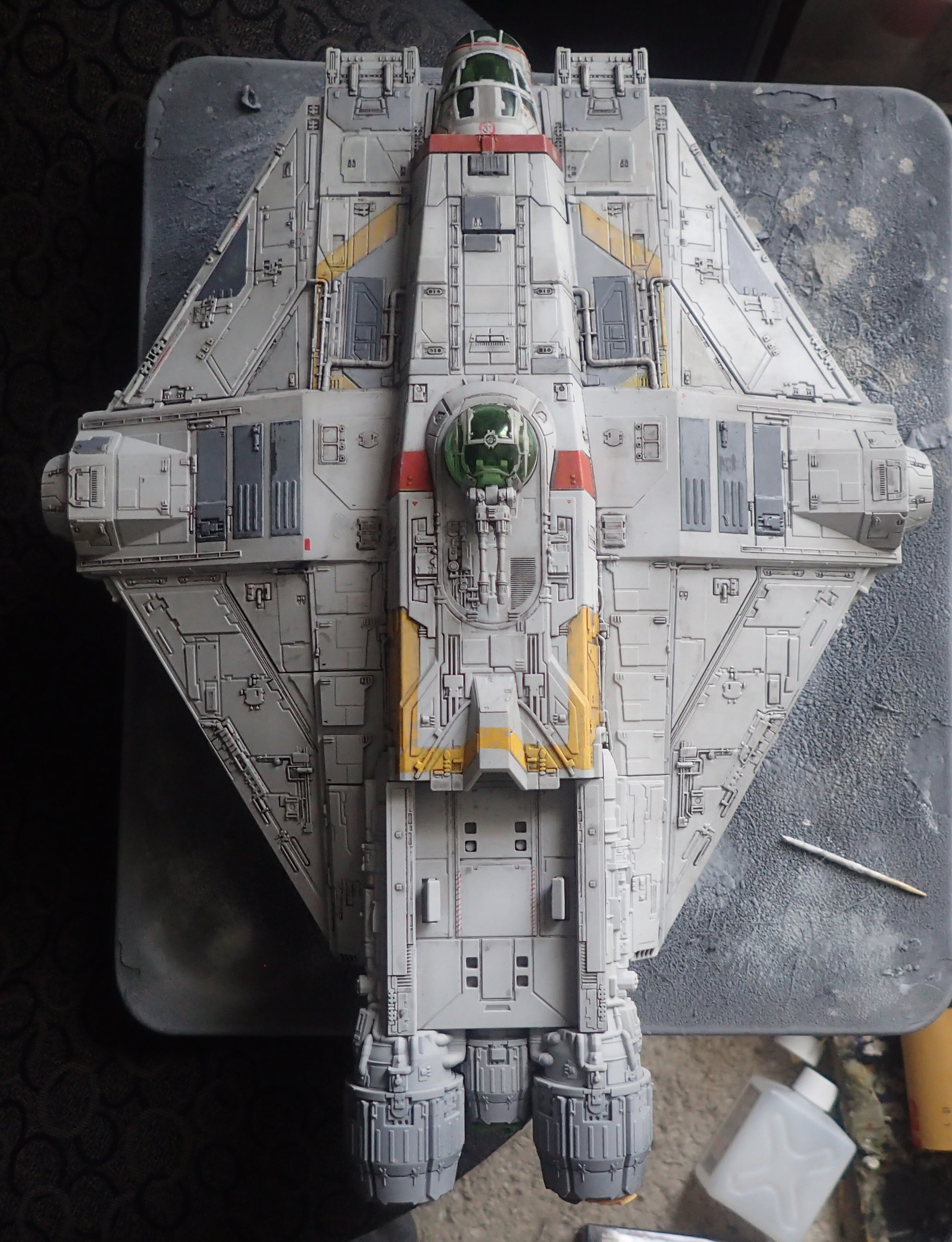

The weathering on this was way overboard. I also am not a fan of the colors on it. It may be accurate to the cartoon, but I prefer the live action look like below. I had always been on the fence with the design, but seeing it like this vs the cartoon look finally sold me on it
Fortunately that is an easy fix with a repaint. So...

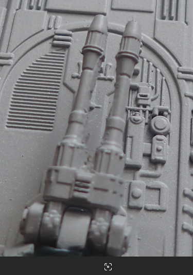

First thing was to get rid of the toy look of the guns by cutting out the excess material. They really should be replaced since they are a weird rubbery plastic and obviously they want it as a toy to hold up
so after some creative carving with an X-Acto and repaint it looks less toy like

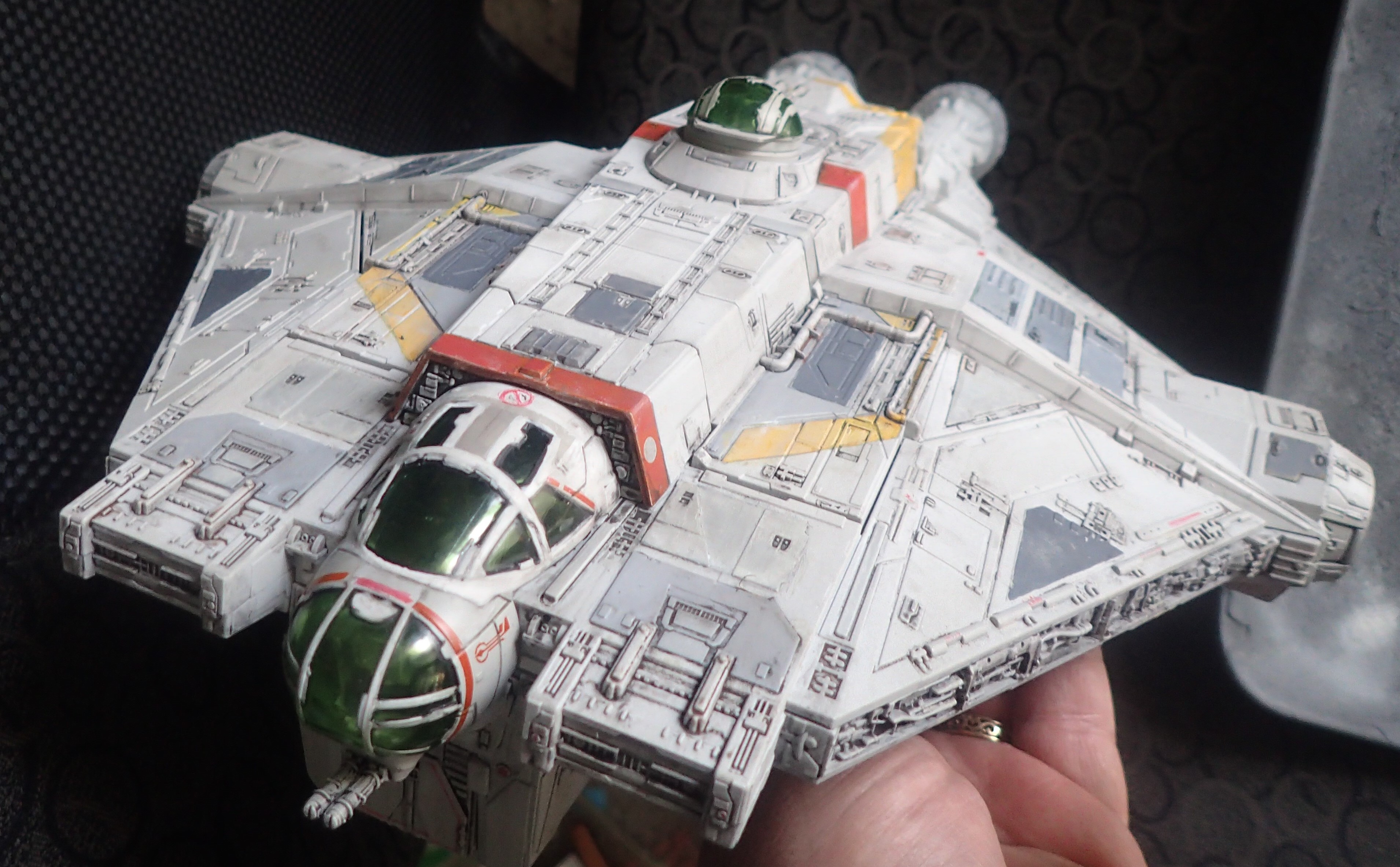

And in general it looks much better now with a repaint. Still have more do do as well as a whole lot of more natural looking weathering, but it is now a much better base to start from
Have to tone the yellow down as well and maybe replace the orange with Red as well as add some of the darker triangular panels

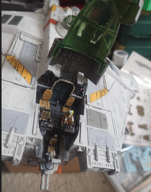

I did fully paint the cockpit as well since that was unpainted and all white plastic
Some weathering added

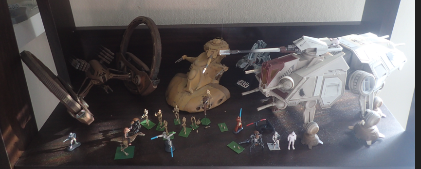

Here are better pics of the AT-TE. This one is going to need a repaint. Not a fan of the blast marks and the color differences between panels or the dust/dirt effects on the feet. They just look too toy like
The legs, and guns are poseable as well as being able to turn/steer the front from the back
and with a 1/72 .jpg Trade Federation tank and Hailfire Droid for size reference
and a better comparison of the Revell "1/72" Republic Gunship on left vs the Jazwares roughly "1/78" one on the right.
Note: the Revell kit has been modified quite a bit with things like cutting out the arched side doors, changing the shape of the side door frame etc... to resemble the movie kit more compared to the original out of box look
I am tempted to pick up another Jazware one and use some of the parts from it for the Revell kit. Namely the pods on the side (which Revell's does not have), those gun turrets on the wing as Revell's kit is opaque, the missile bay interior on top, and those engine things on top as well since the Revell's kit is totally off as it is based on the cartoon version

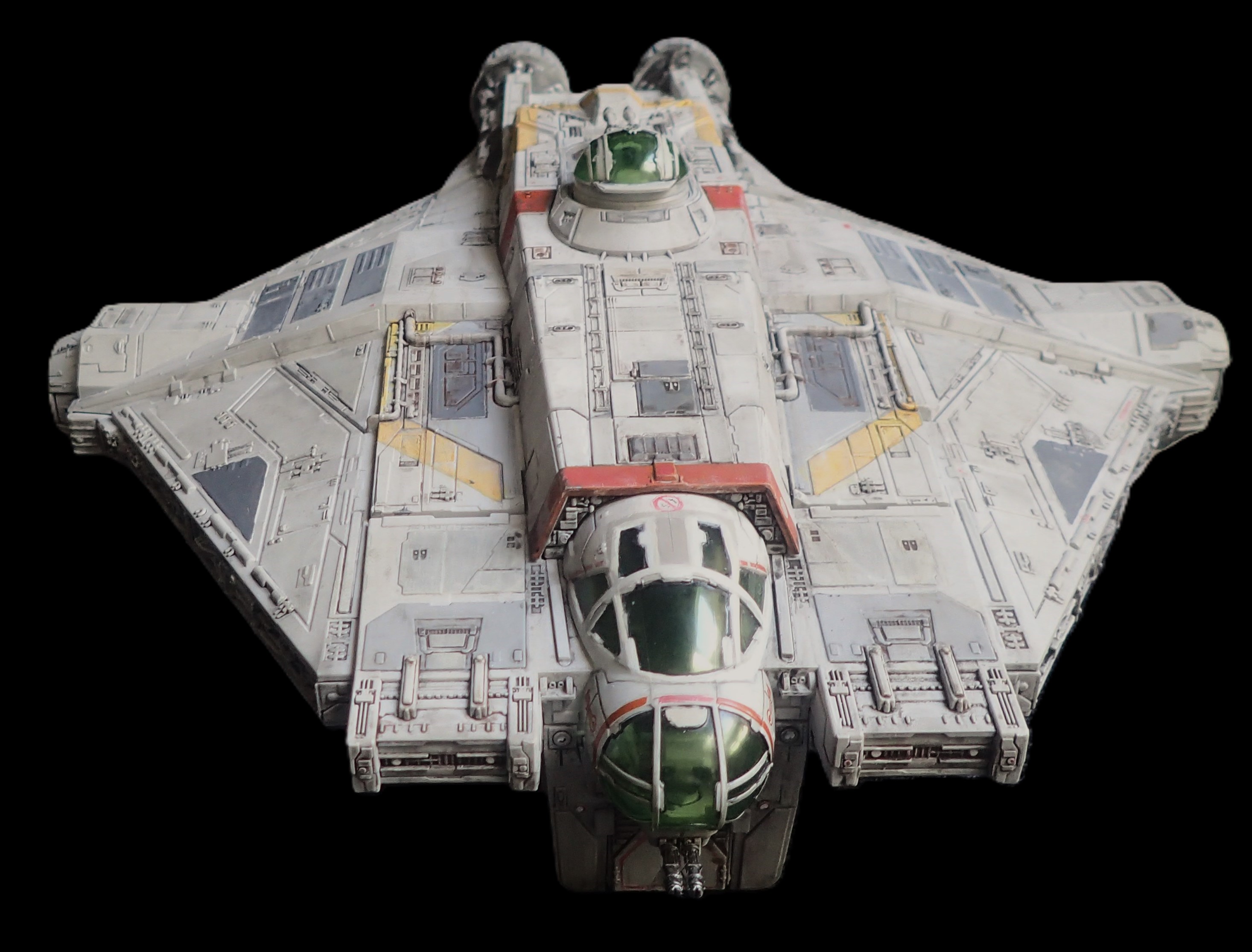

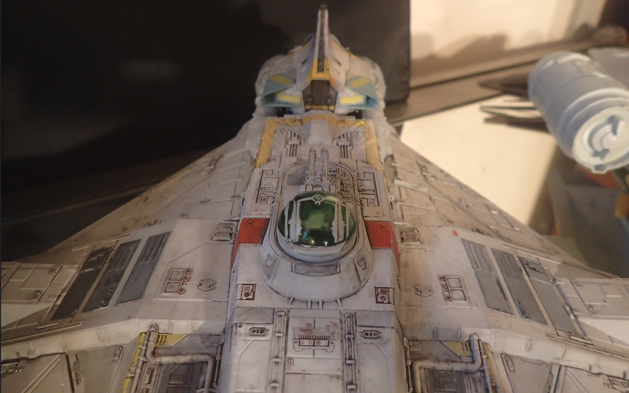

I think I am done with this one, at least the overall painting/weathering. I may go all out and finish the interior as it is unpainted. Might also try tinting the "glass" to be a bit more black than green, but not 100% sure
A quick replacing of the background in photo-viewer helps the overall effect
Great work on the Ghost. I second your opinion and find the toned down colors to be much better.

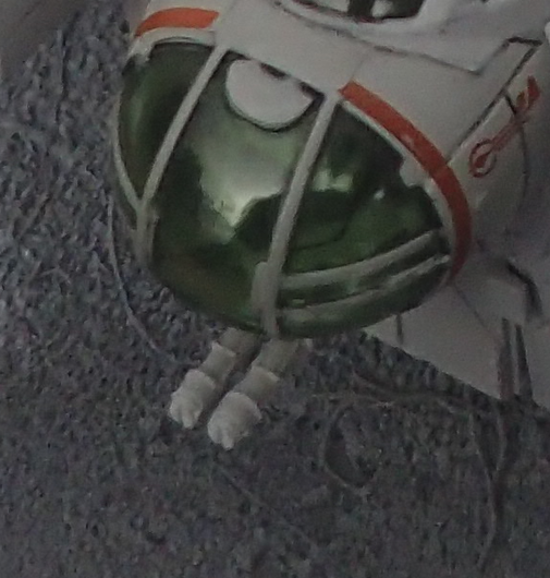

Regarding the green glass (yes it does stick out a bit too much... not necessarily bad, but definitely different), unless you mean to paint them opaque, I would be afraid that the green tint will still show through giving you just a darker green. Looks as if the frame is painted directly onto the glass canopies or can you pop the green glass out of the frame? If so, it might be easier to print or cast new ones in clear and then darken them up instead of the originals.
Good point about it just becoming a darker green. As far as the canopy, yes it is all one molded piece with the frames painted, so a replacement would be tricky
[...] it is all one molded piece with the frames painted, so a replacement would be tricky
yeah, that is kinda what I thought. It is a shame that all the surface is rounded. In the past I have used the tint for car windows to mirror or darken up canopies. To do that on a normal curved structure covered, you have to use little strips, but this is curved on two axis... not impossible but probably a real pain to get everything in without wrinkles or overlaps.
I am sure they were trying to get that "bullet-proof-glass" type of green, but when I look at it, all I can think is an "aquarium that has not been cleaned in a couple months" typ of green. :)
If it were me and I wanted to go through all the trouble, (assuming the pieces can be detached from the main hull) I would probably cast a couple of copies with transparent epoxy and work from there. Then all you have to do is try to match the white of the hull to the rest of the ship.
You can get aerosol tinting for use on tail lights, that may work. Otherwise some gloss clear, thinned down, with a drop of black and red in it would darken and the red will cancel out the green hue somewhat.
Just ideas.

Worth a try
Worth a try
This may be obvious but if you're going to try adding paint to clear to make a candy of sorts, just make sure they're all the same type of paint. Example, add acrylics together, not enamel colour into acrylic clear. Because chances are the paint will separate.
Cheers,
Josh
Cheers,
Josh
I was thinking of using Tamiya Smoke XF-19 as it is like a tinted clear that has a blackish/brown color. Possibly mix in a bit of the Tamiya clear red (typically used on clear parts like running lights)
And speaking of that paint, it is a great transparent color to use for exhaust and oil stains and stuff
