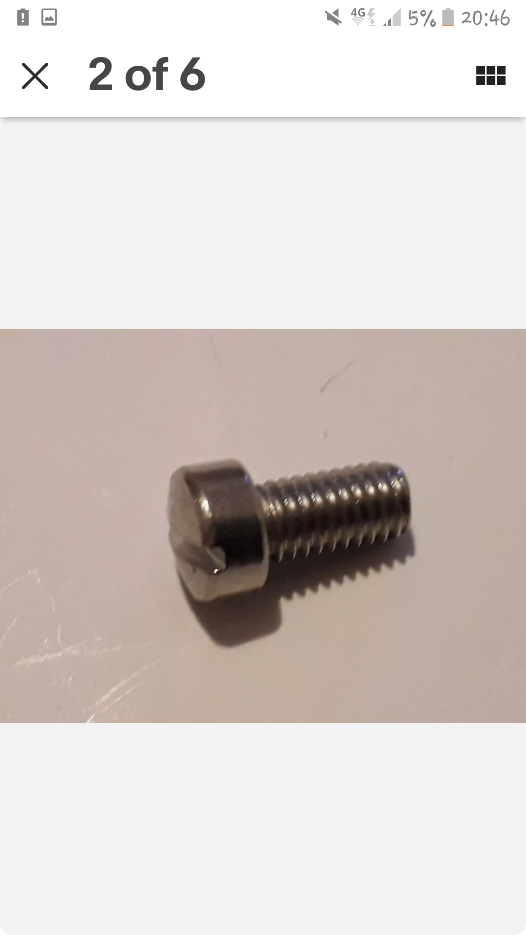

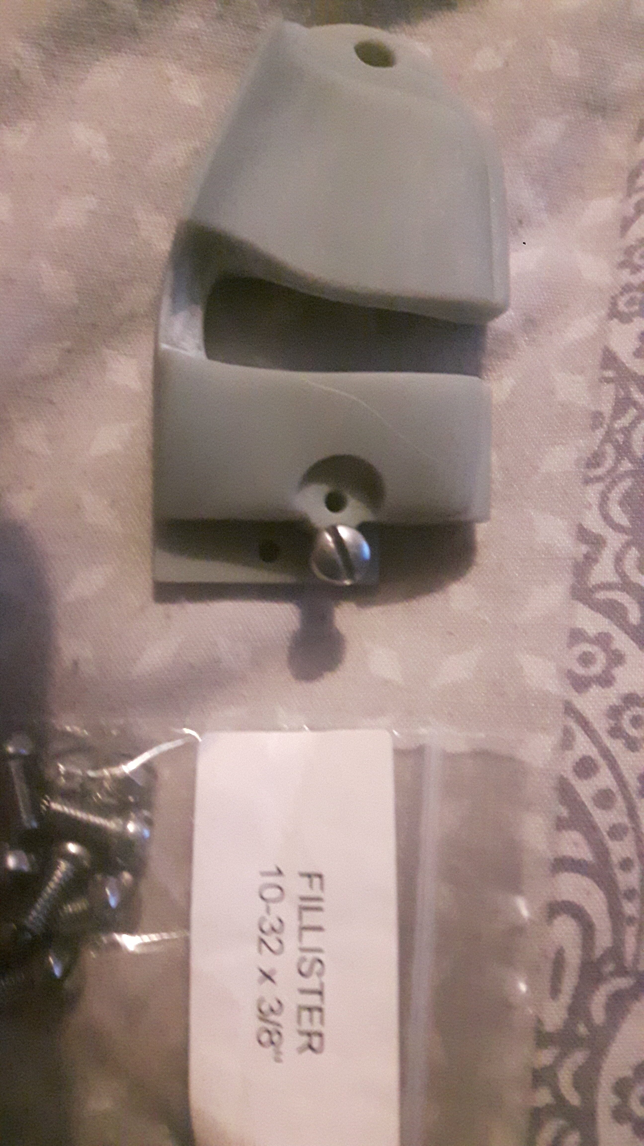

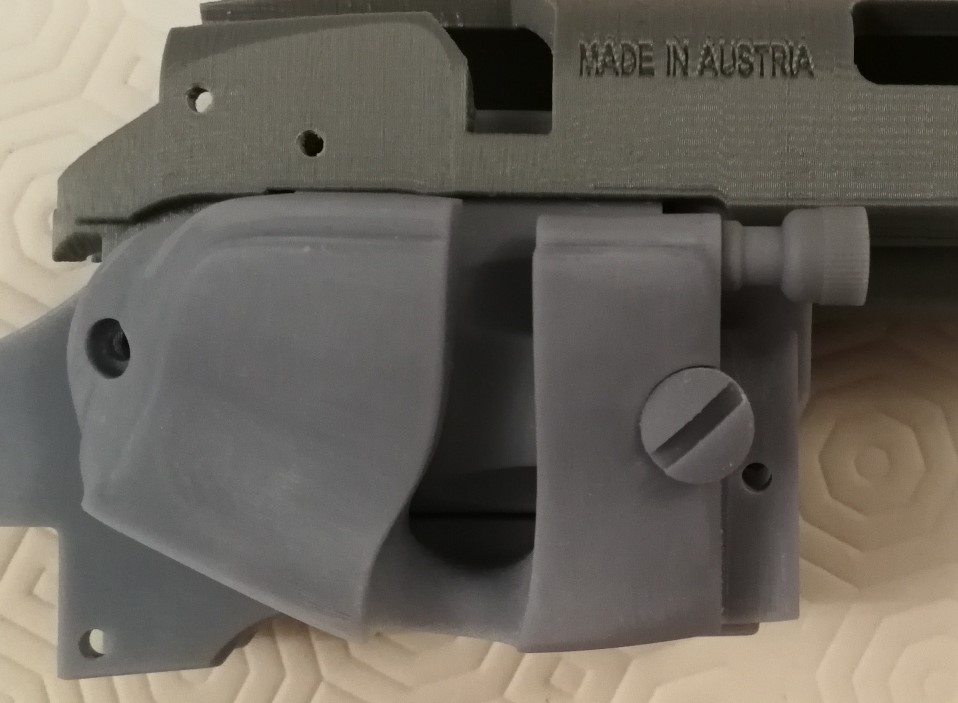

Received the fillister screw to replace the Weaver knob, but the diameter of the head seems a bit too small. Hmmm.
Anyone have any sources for an accurate screw?

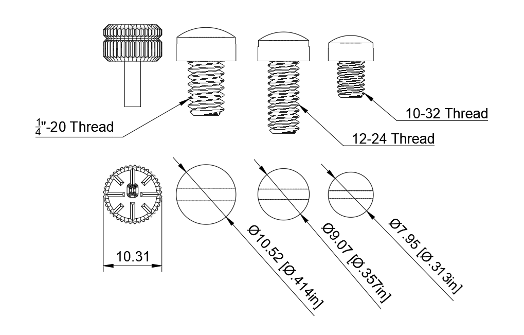

1. Can someone give me a reference photo of the fillister fitted to the hero prop. Most of the reference photos I have are post 2006 and have the screw with the gradients marked on it.
2. I think the Fillister required is closer to the 1/4"-20 thread part on McMaster-Carr (example pn 90280A842). It's possible to load McMaster-Carr Parts directly into Fusion 360 so I have done the following comparison.
I'm going to try and print some samples out tonight and will post some photos.

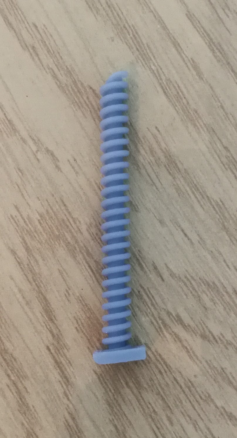

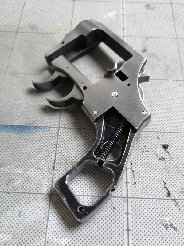

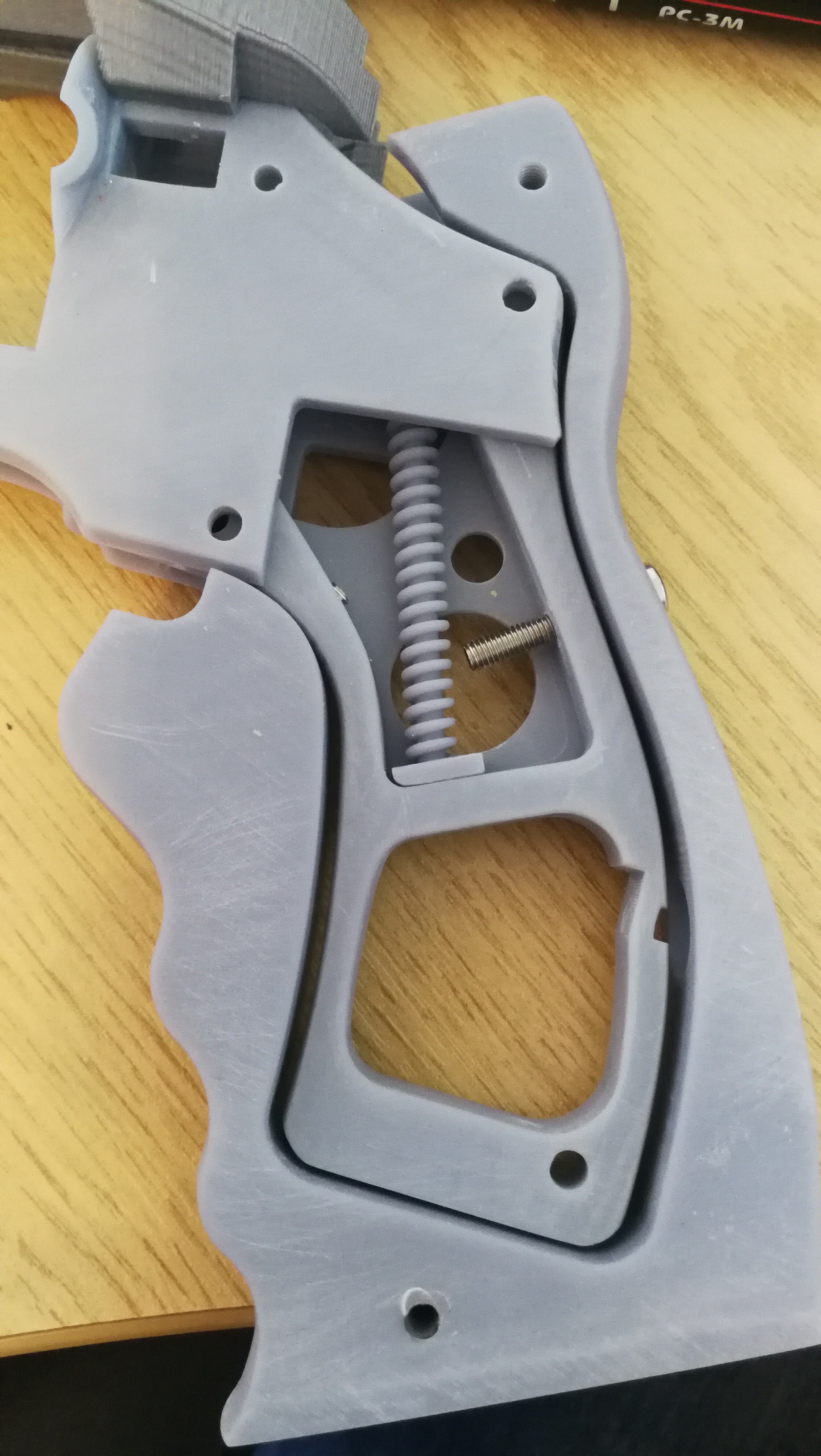

I also created a "quick & dirty" model of a main hammer spring. It's not 100 accurate, but I think should be good enough when seen through the amber grips.

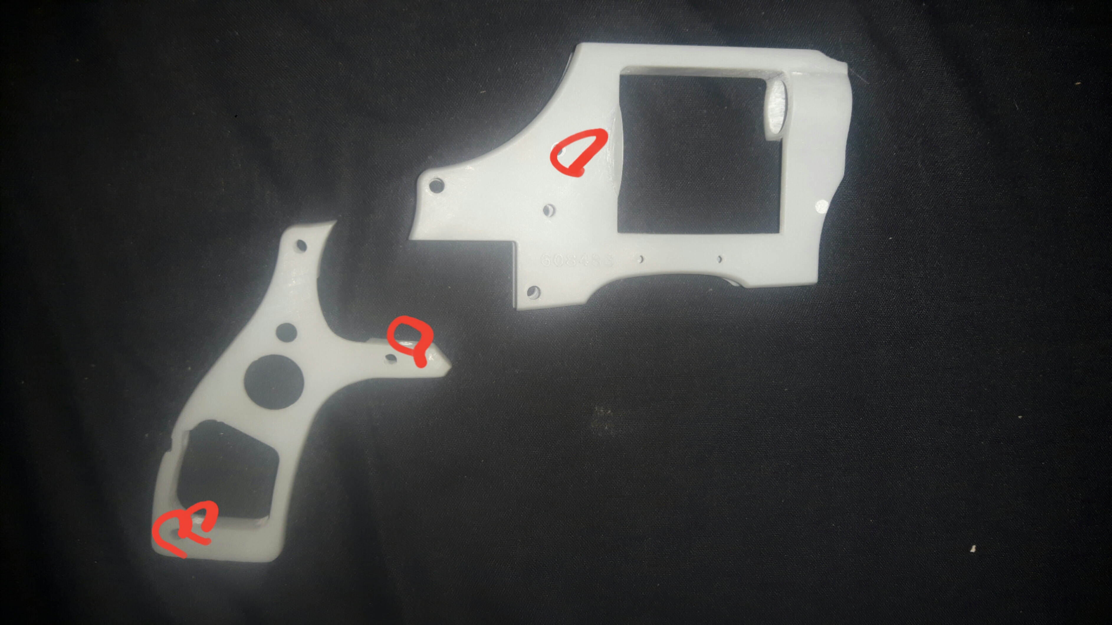

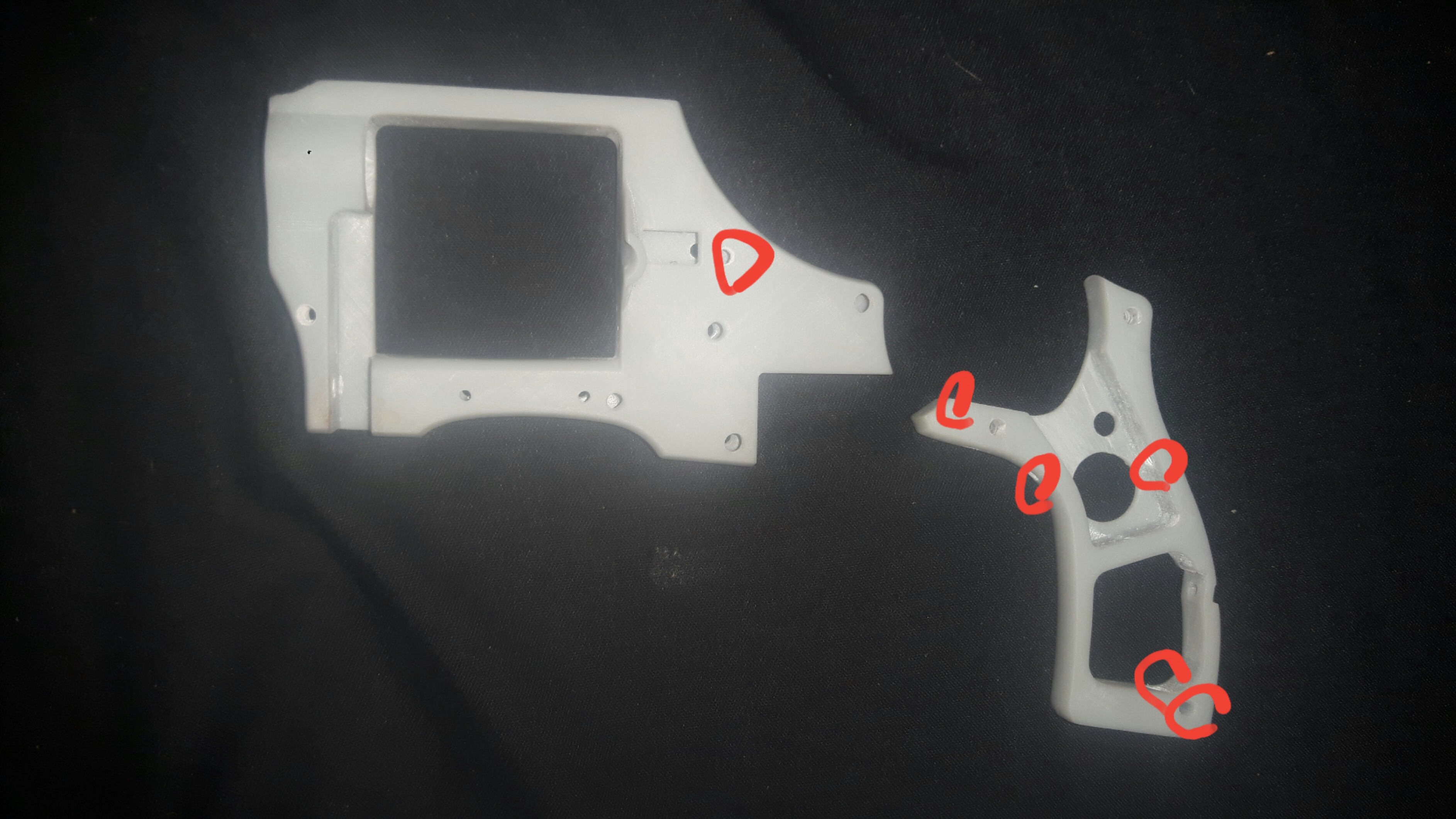

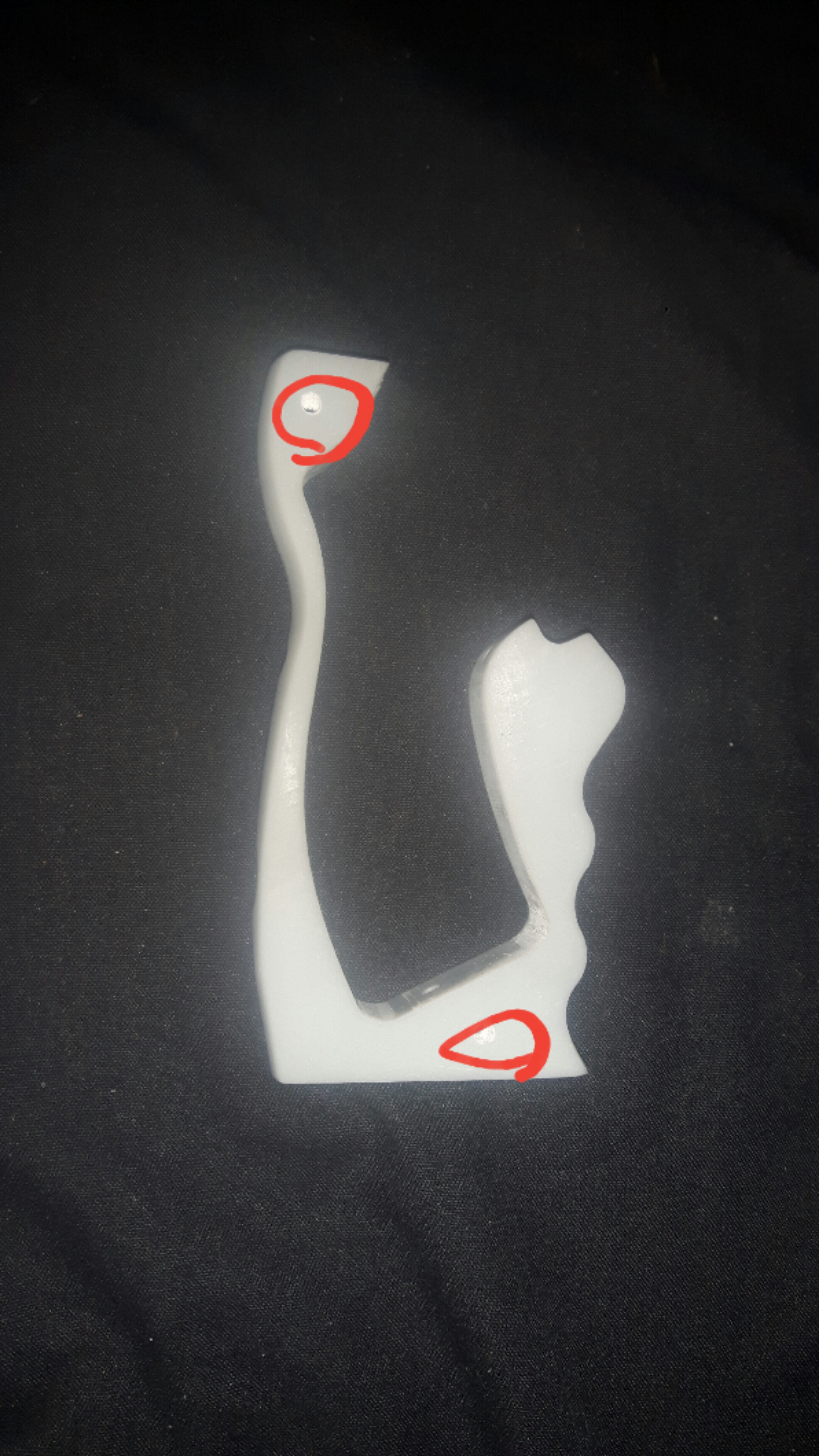

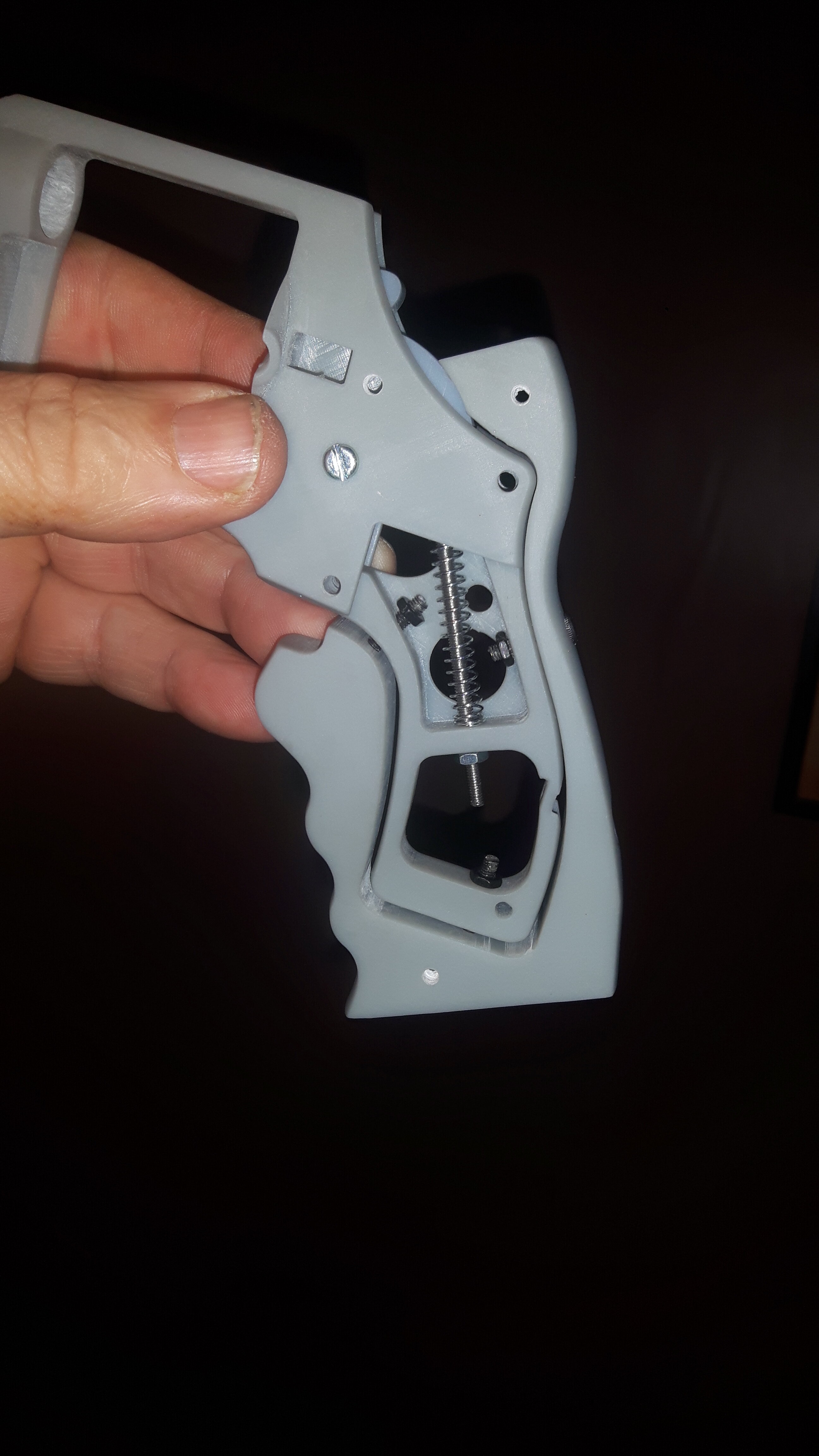

I haven’t gotten to the mainspring, yet. I have the spring which came with the kit (as well as the domed topper which fits into the divot on the hammer, but I have yet to search for a central bolt or rod to attach them to.

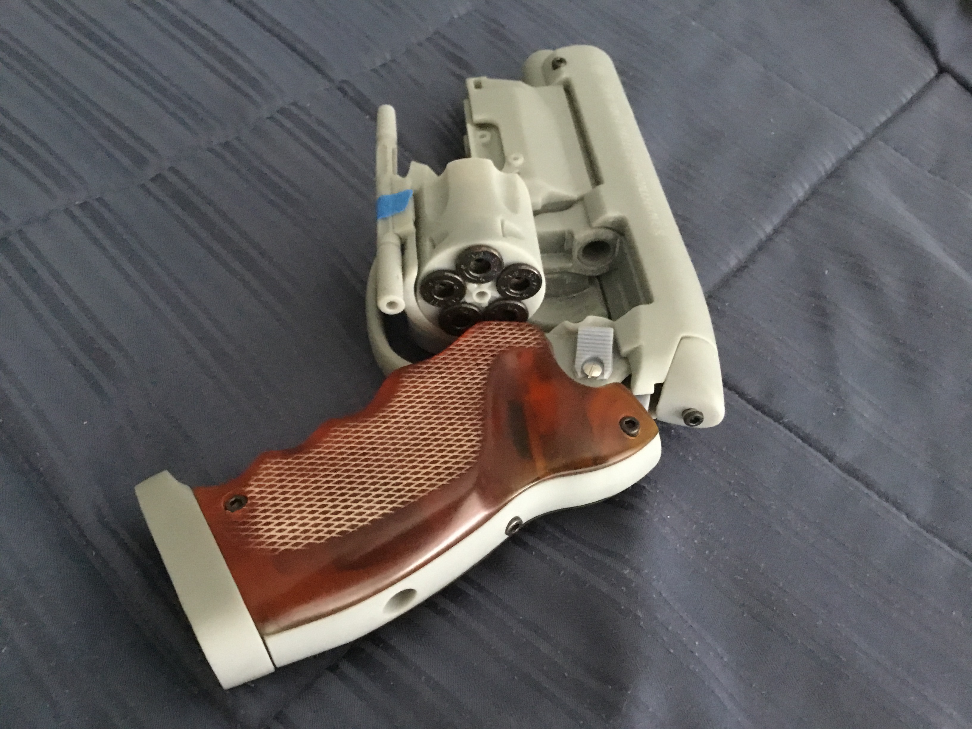

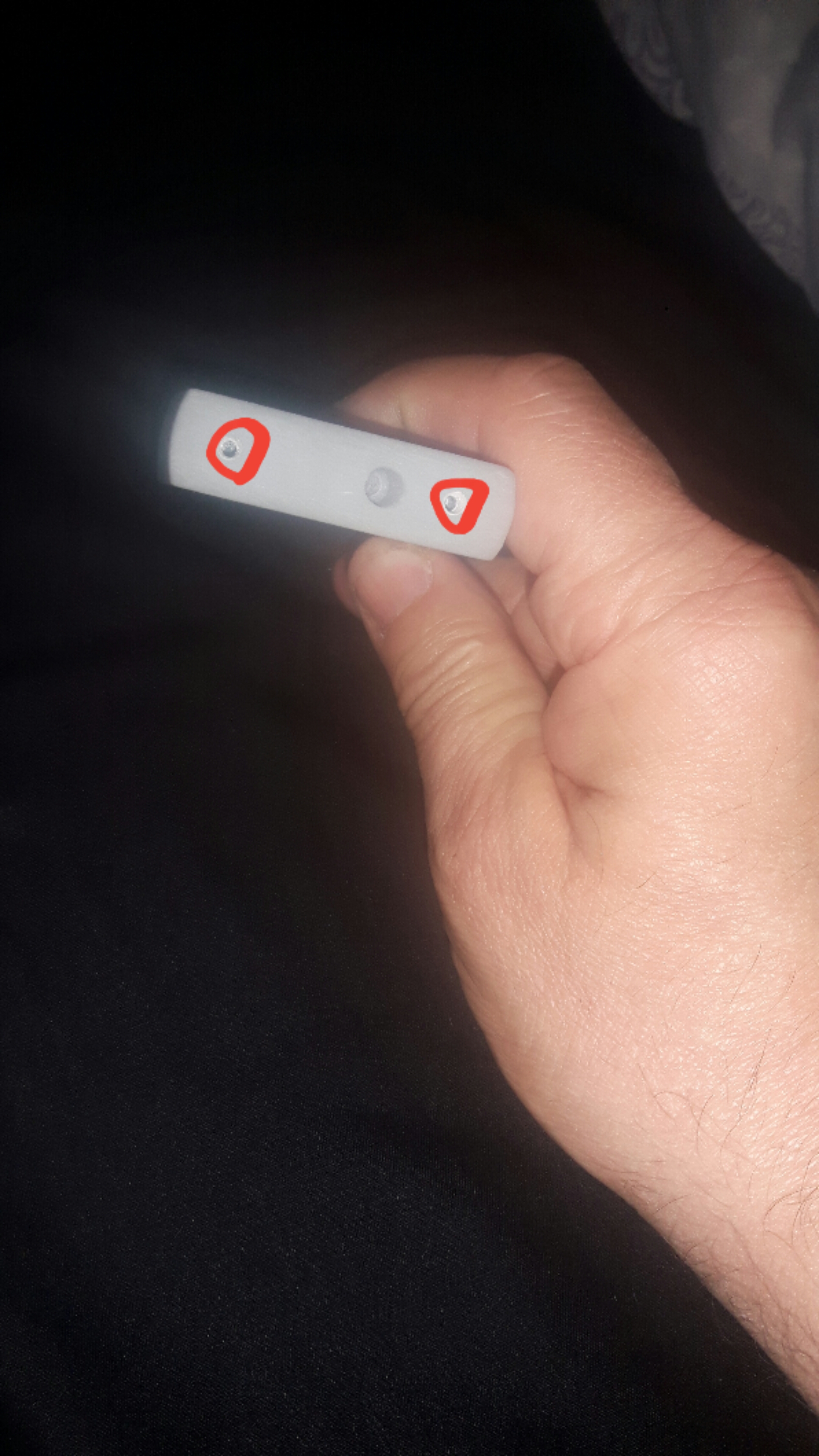

Meanwhile, I test-fitted the triggers and glued the magnets into the clip. All tests were successful.
However, the bolt assembly’s fit/tolerance still needs work, as it binds when sliding open and closed. I also filled a few screw-holes with JB Weld in order to re-drill and re-tap them, because they got stripped during my test-fits.

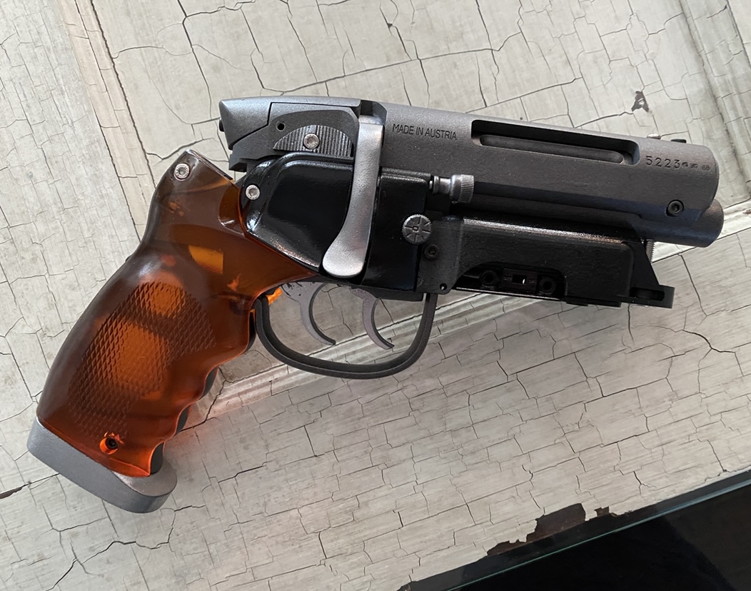

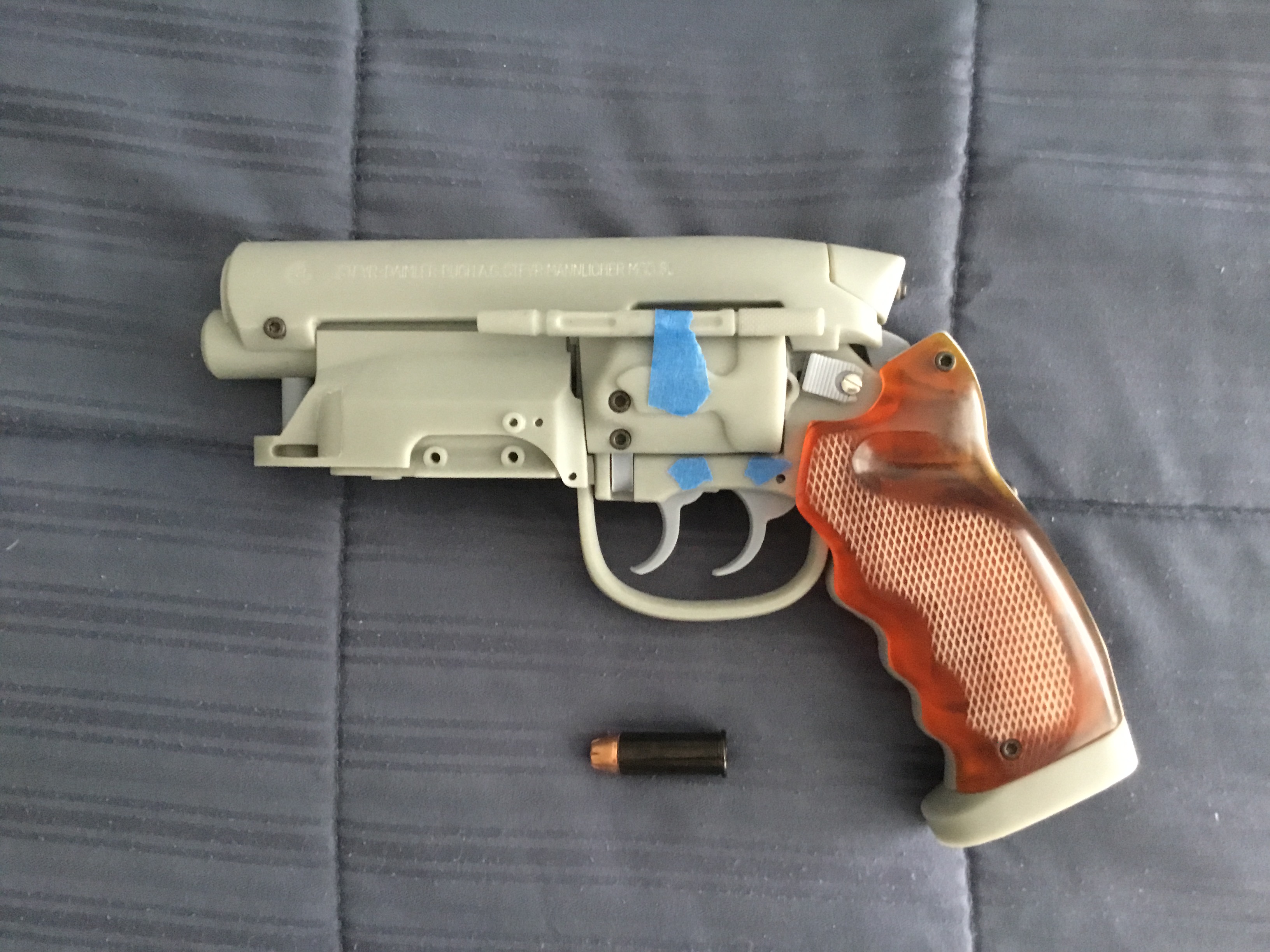

Looks great! Just finished mine. Got it of eBay for $90. I have limited resources so even though it may not be entirely accurate, It still looks good in my opinion. Mine is also an Anders model and I think the end result came out great, especially since it’s my first time building one of these. This community that surrounds this film and it’s props is pretty insane. Never really knew it existed until I did my research. Anyway here’s my finished model (just imagine the white wire on the opposite side and the LED’s in as this is an old picture and I’ve only just recently got all the little details on it).
Oh and I’ve also switched out some of the screws for some more accurate ones. Hope y’all like it!!
feel free to give me some feedback as I’m still learning some techniques!

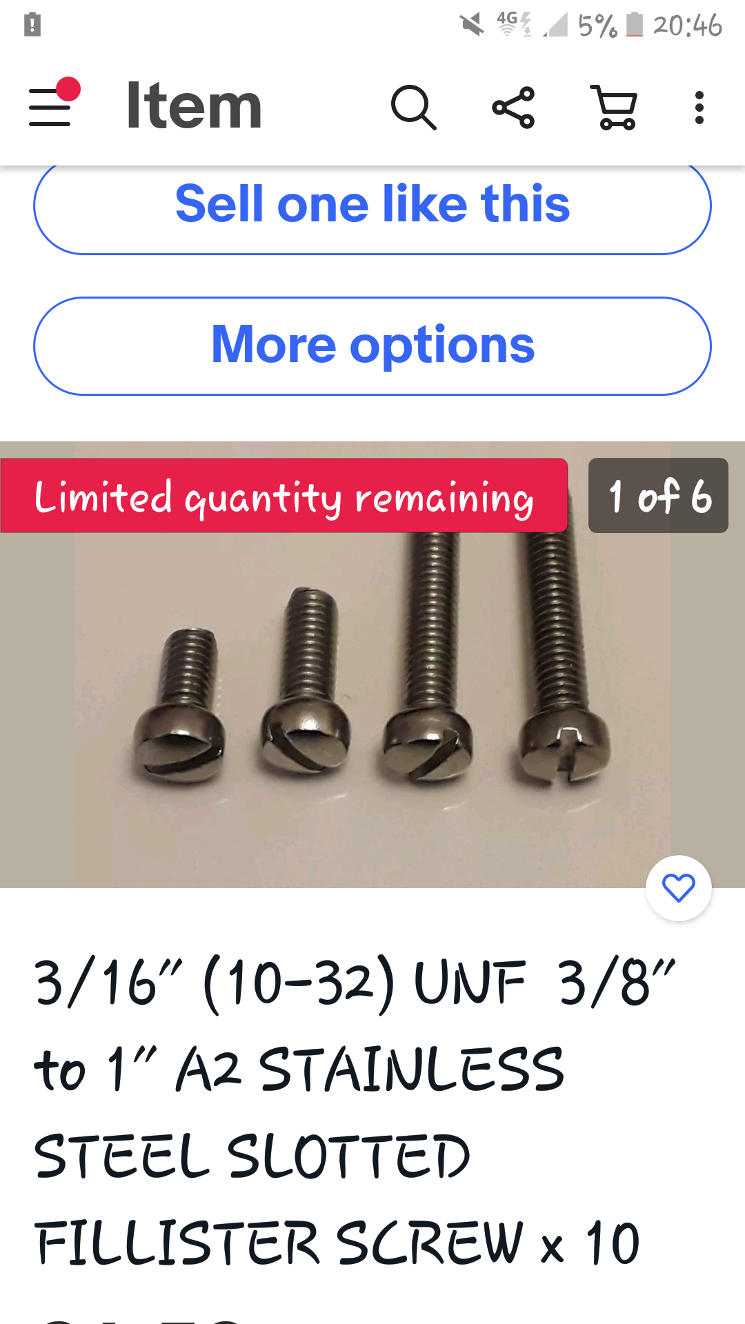

Awesome, keeping an eye on this as I ordered a fillister head slotted screw.

Looks like the head of the 1/4"-20 fillister screw is a perfect size. The resin printed version rubs very slightly against the recess, but I think that's due my resin print being ever so slightly oversize.
I'm still looking for a reference to this screw on the Deckard hero prop. I've only seen.it on the Tomenosuke and the casting of the early stunt blaster - or is that what people are trying to replicate.

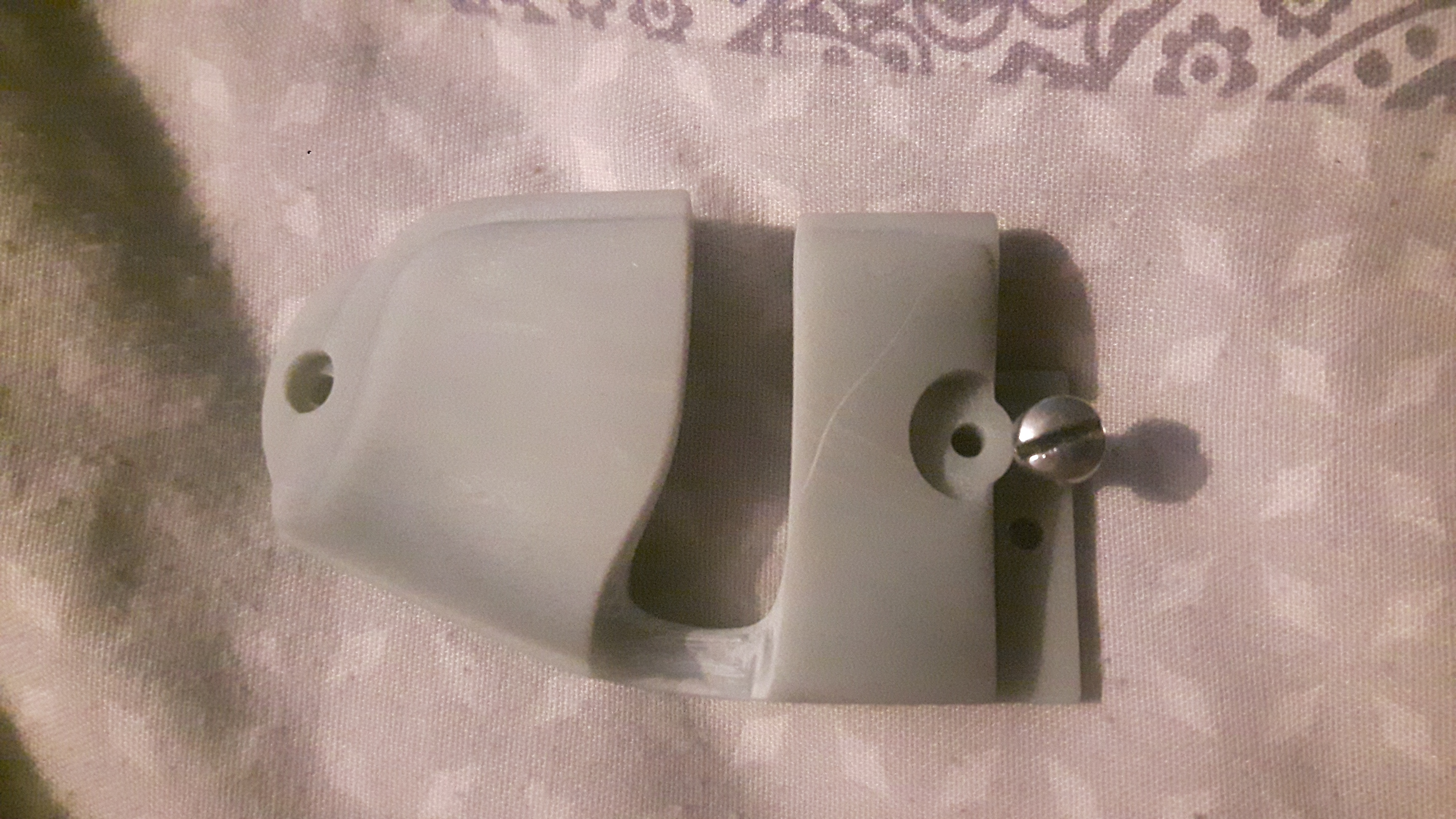

I received some more goodies in the post today. Do you think the fillister screw looks a little small?

Epoxied alignment pins into the sight/screwdriver piece. By all accounts, the green LEDs did not light up during filming, so I’ll likely keep them static on my build, as well. Of course, the white wires WERE there, but, as I understand it, they were covered by black tape on-set (and thus weren’t “really” supposed to be visible), so I probably won’t include them on mine.
I also successfully re-tapped a few holes, and, with the addition of the triggers and the sight, the test-fit is now complete. It’s a gorgeous replica, especially for 1/5 the price of the Tomenosuke.
Still having a bit of trouble with the bolt action. The next step will be continuing to clean up the parts to prepare them for primer, and working on the tolerance of the moving parts.

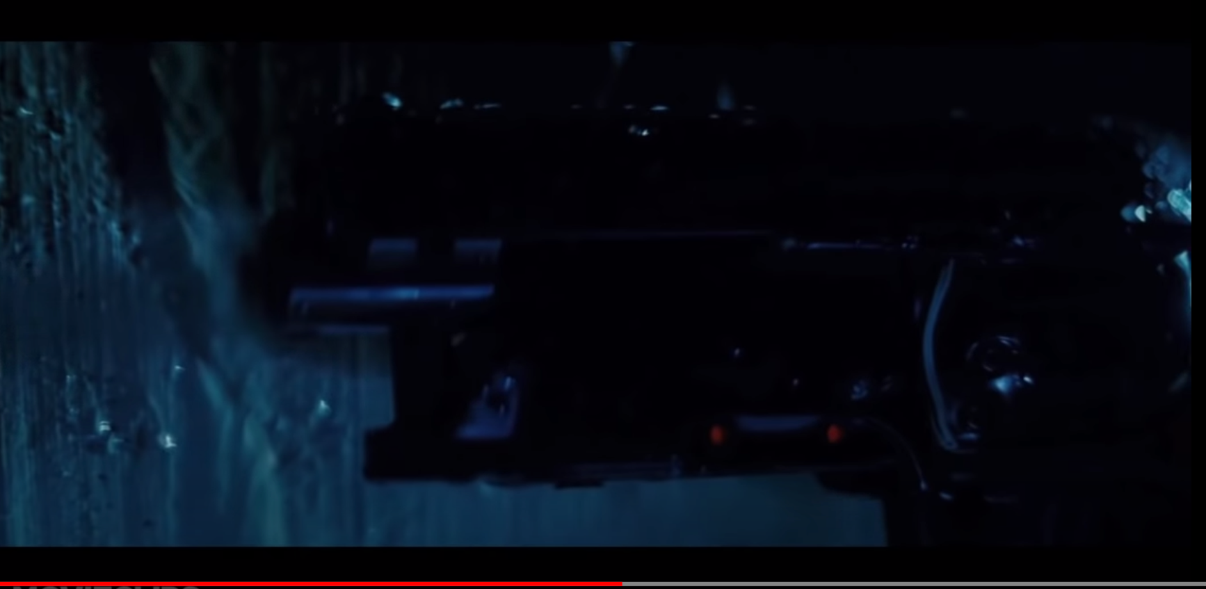

My reasoning was that if the definition of 'canon' is 'appeared in the movie'... then the wires are canon! :lol:

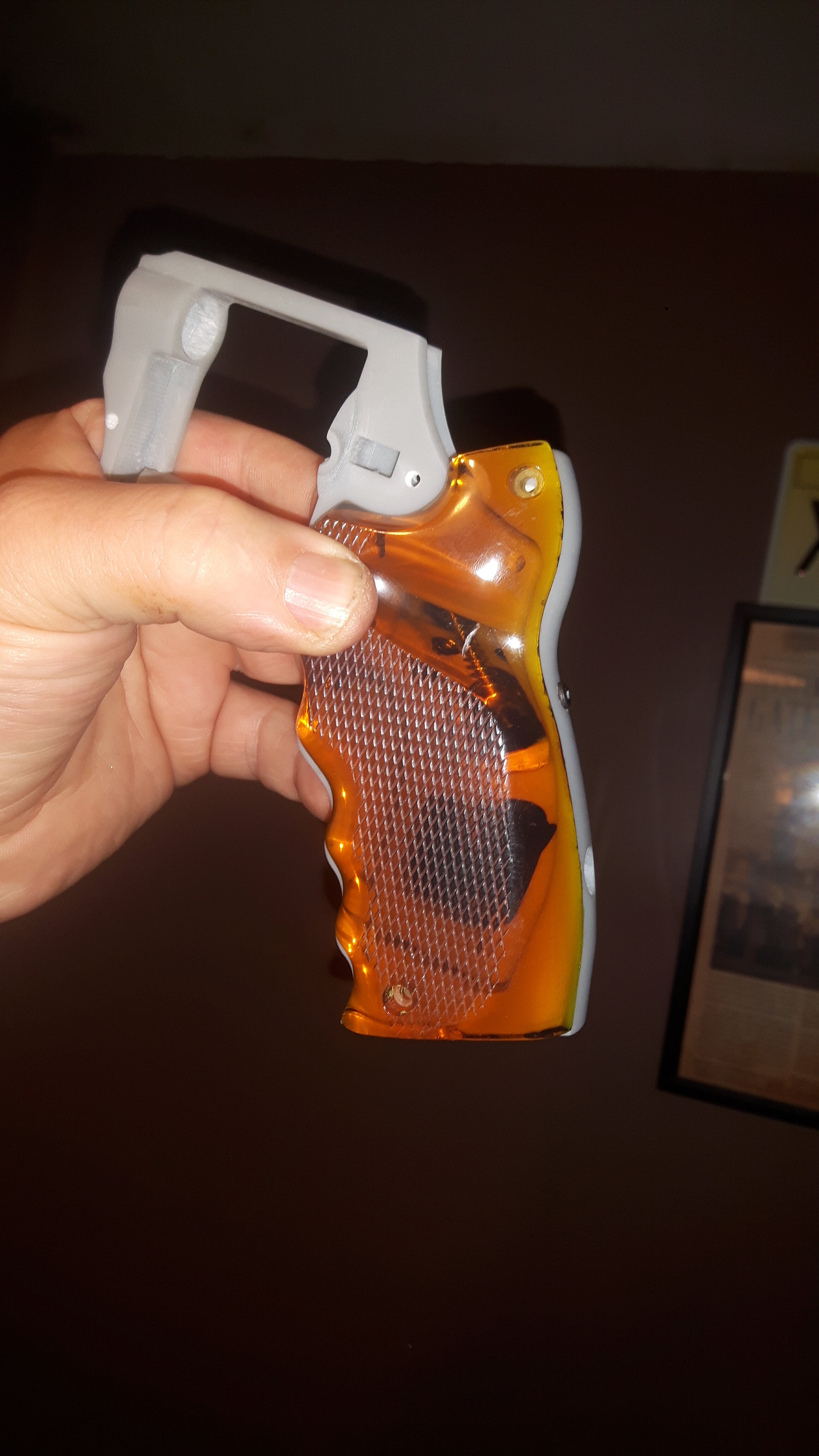

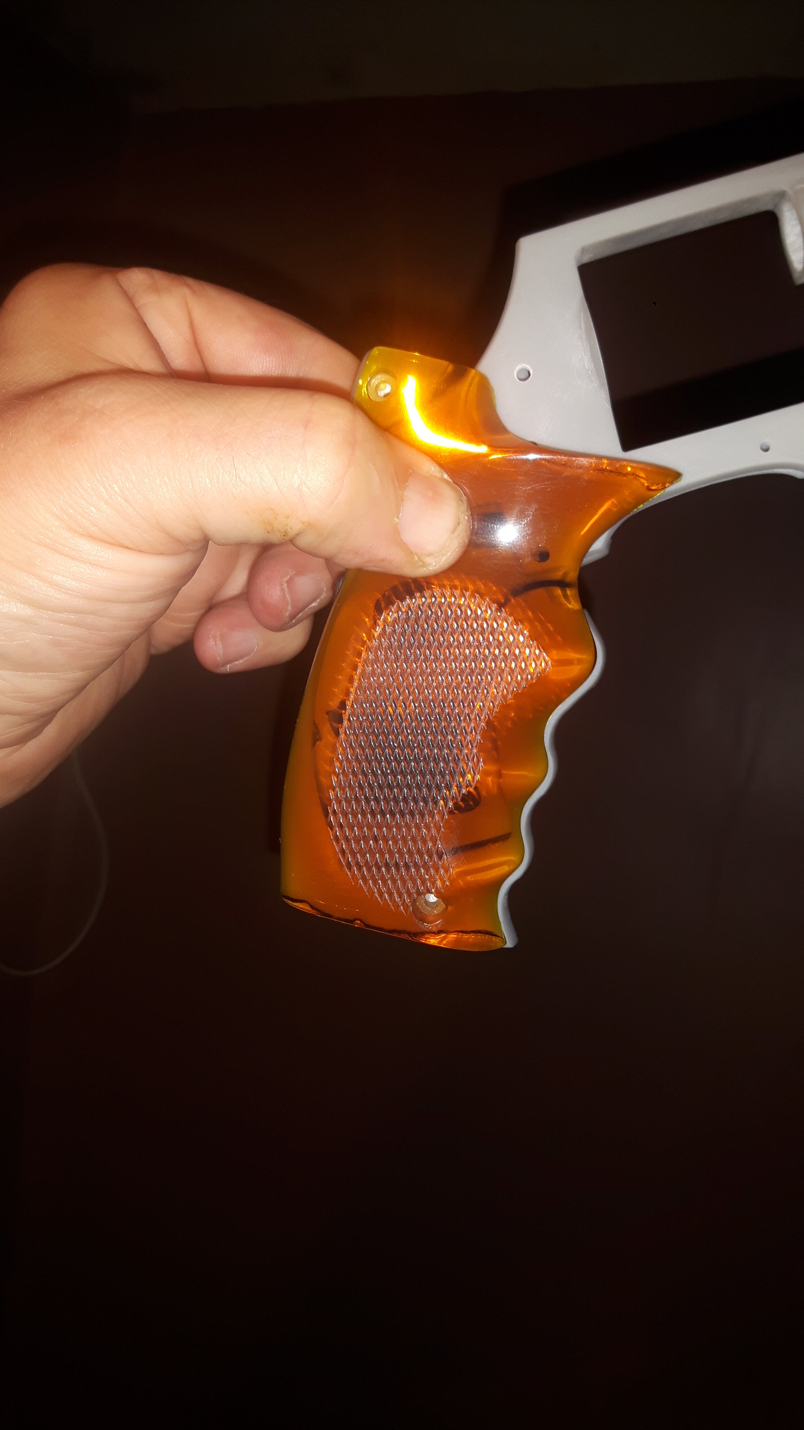

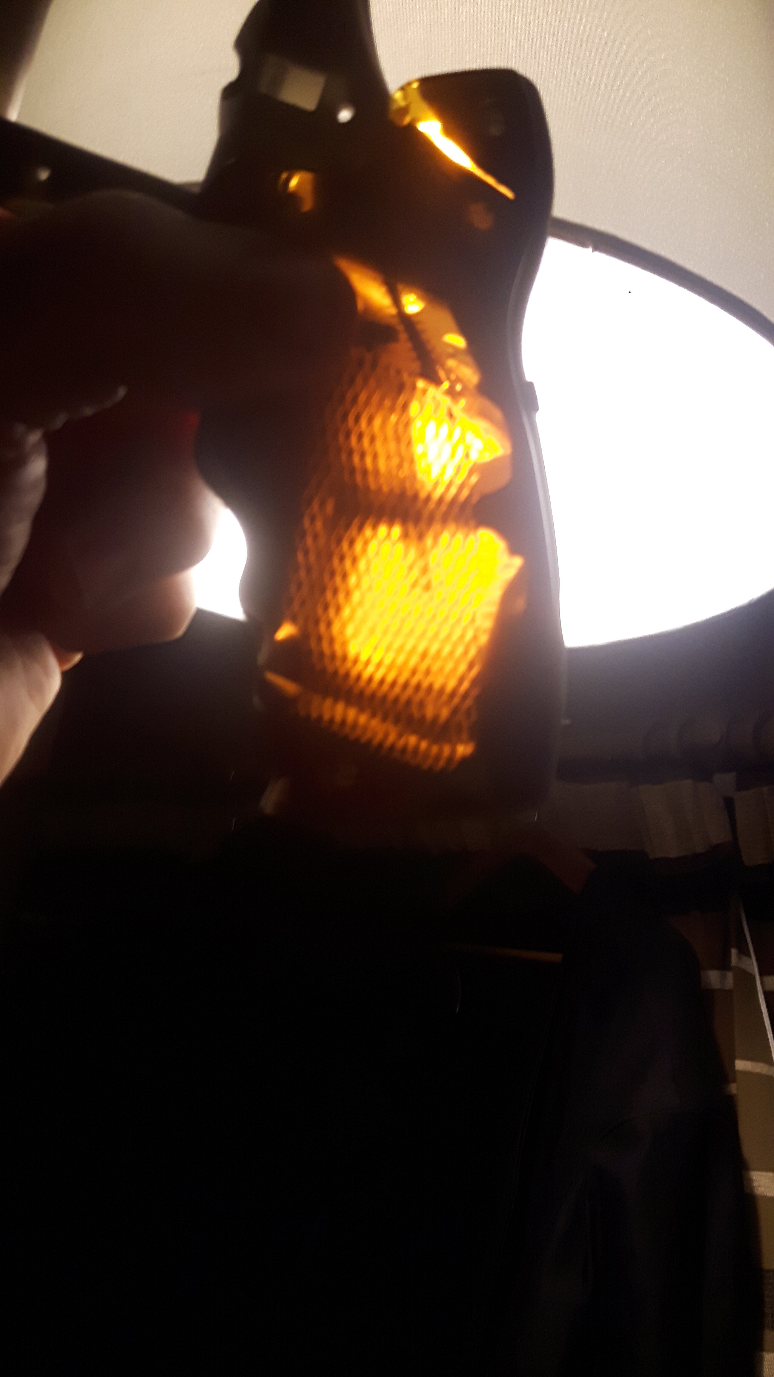

Working on sanding the insides of the amber grips so they fit flush to the bulldog frame, and polishing them up for a nice, glass-like appearance.
I’m also building up layers of polish inside the textured diamond grip-patterns to replicate the look of the original.
Well, I gave the grips a good polish. First with Novus # 3, then # 2. Then, I worked to carefully layer # 2 into the grip texturing. Did a few applications. Still needs a bit of work before the final Novus cleaner/glazing for the rest of the grips.

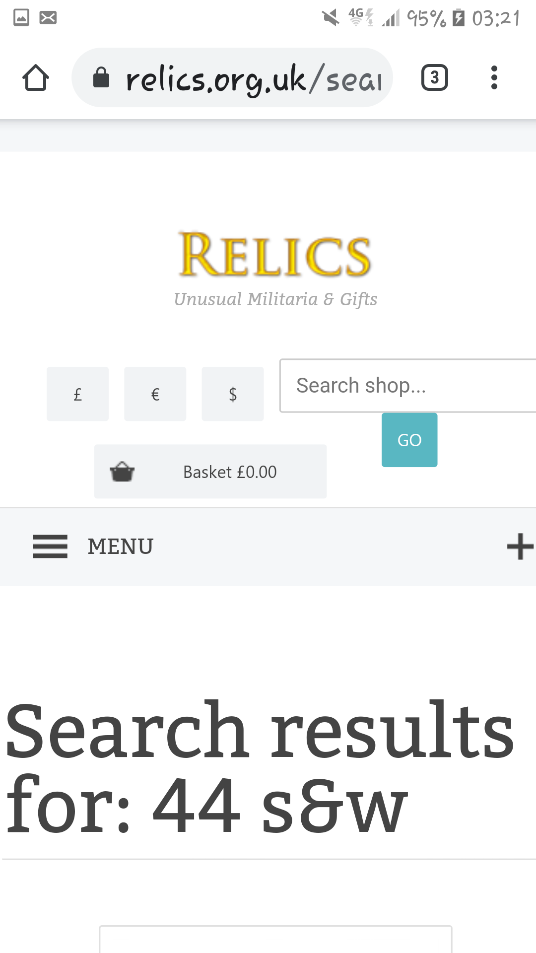

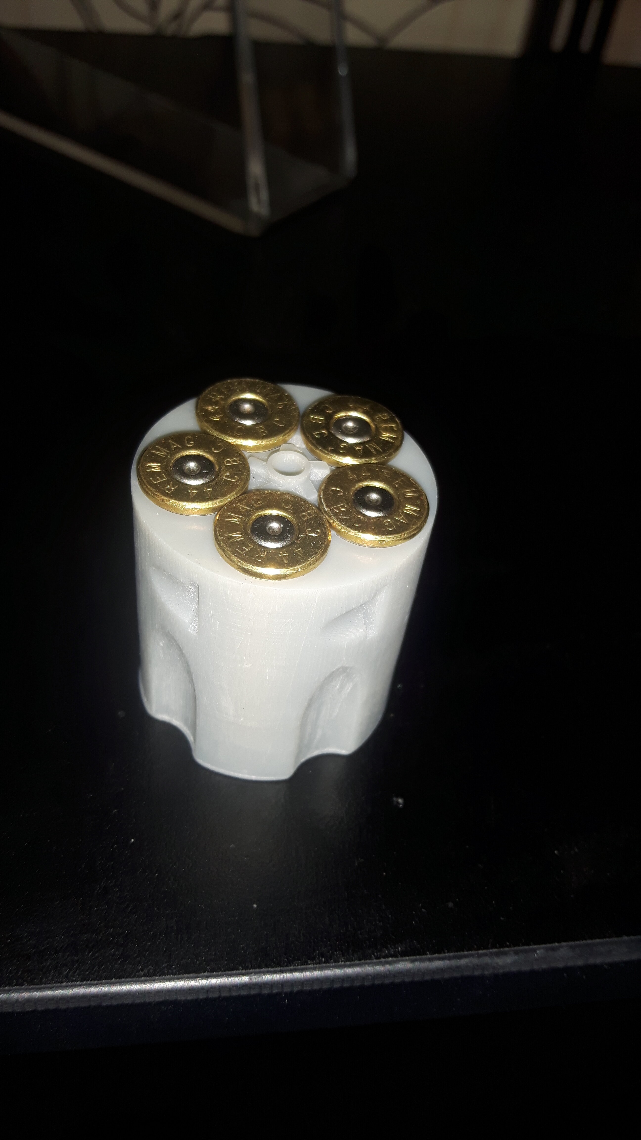

For my .44 rounds I got some empty shells in the UK from a company called Relics.
