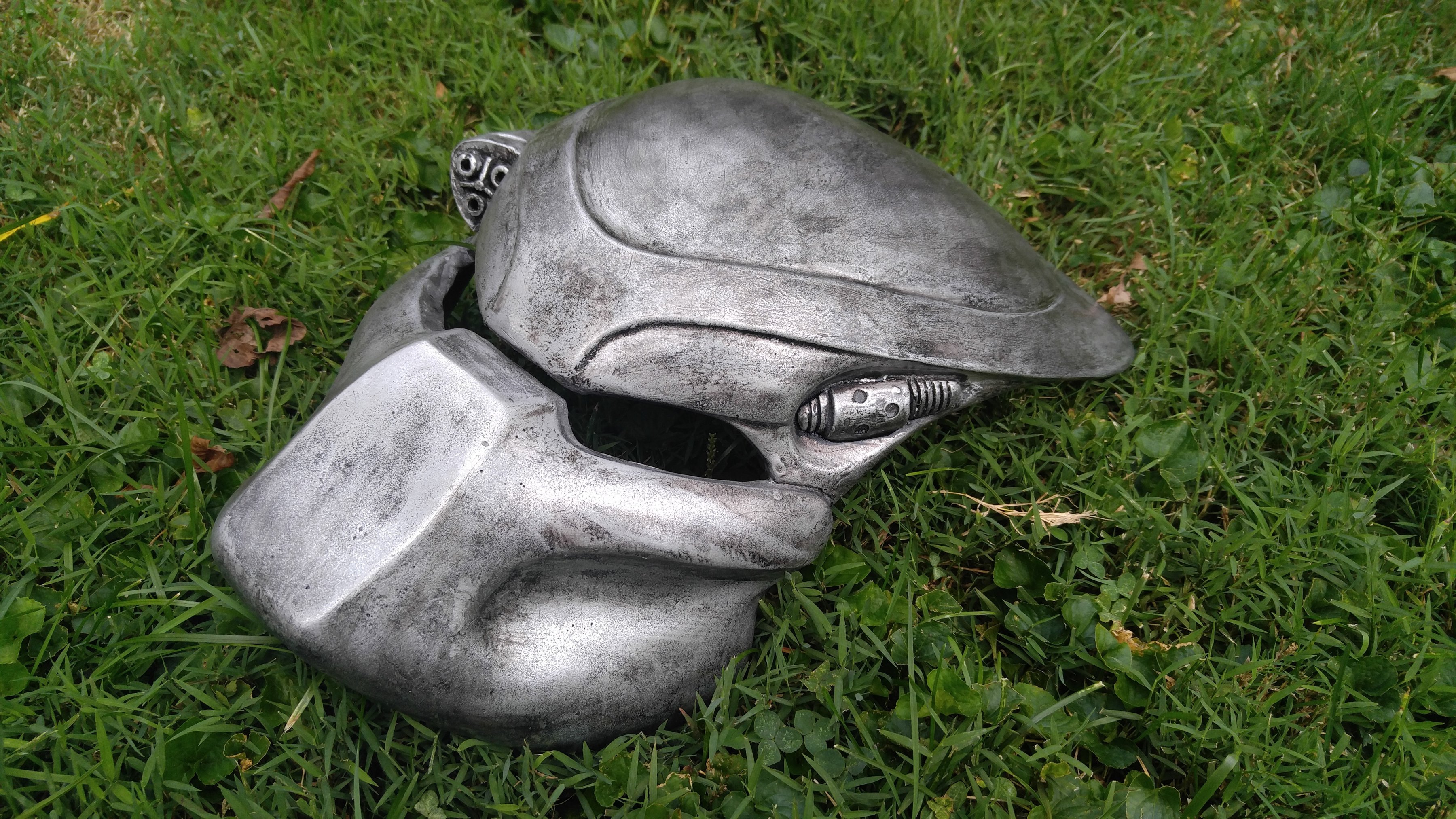

Start of the helmet paint job and the finished paint under that.

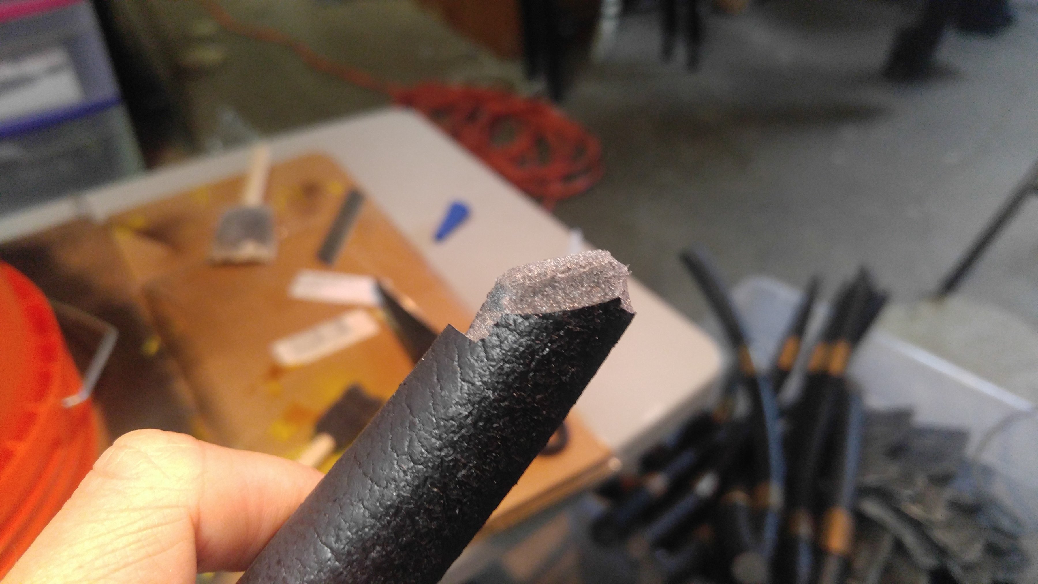

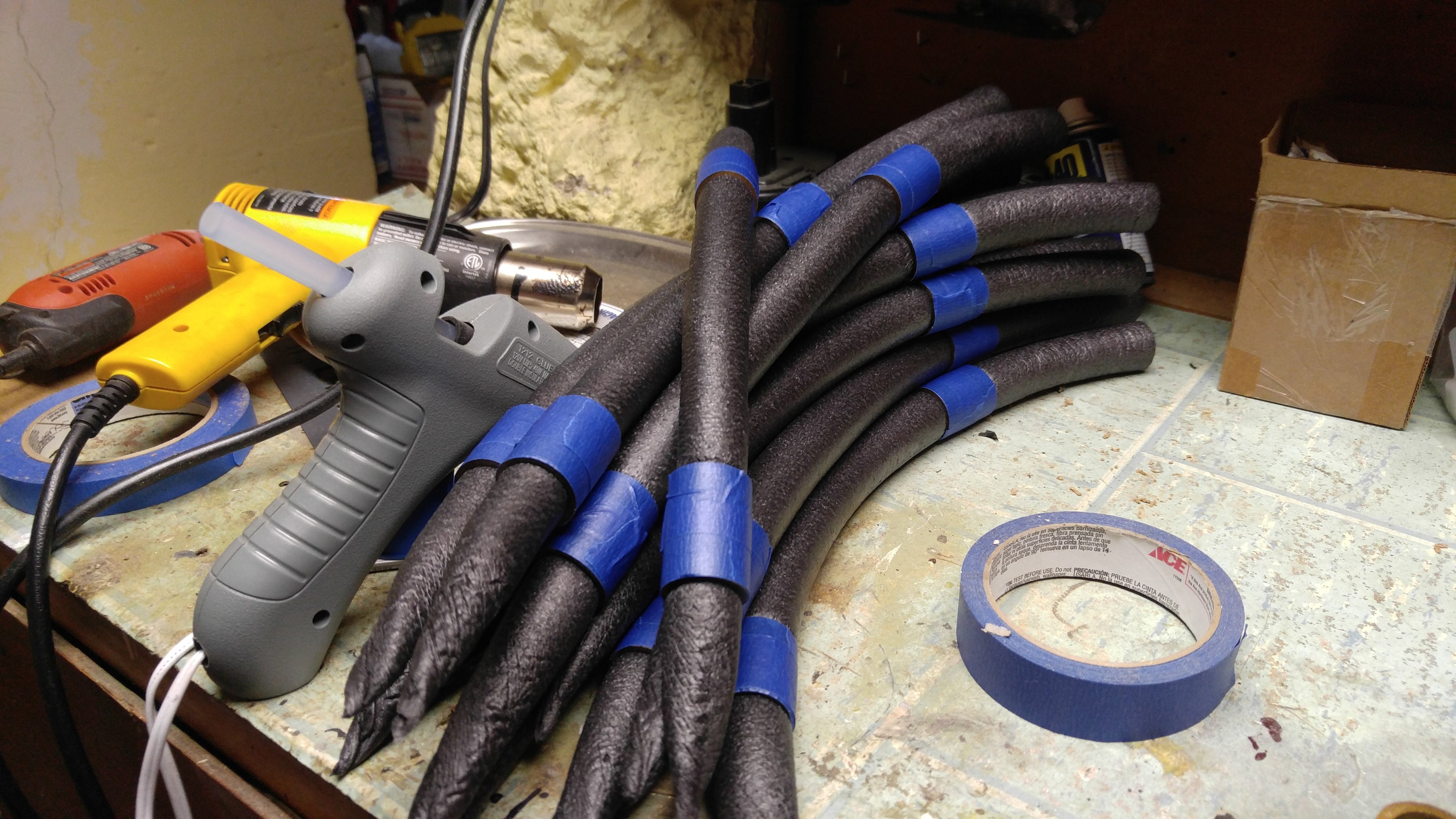

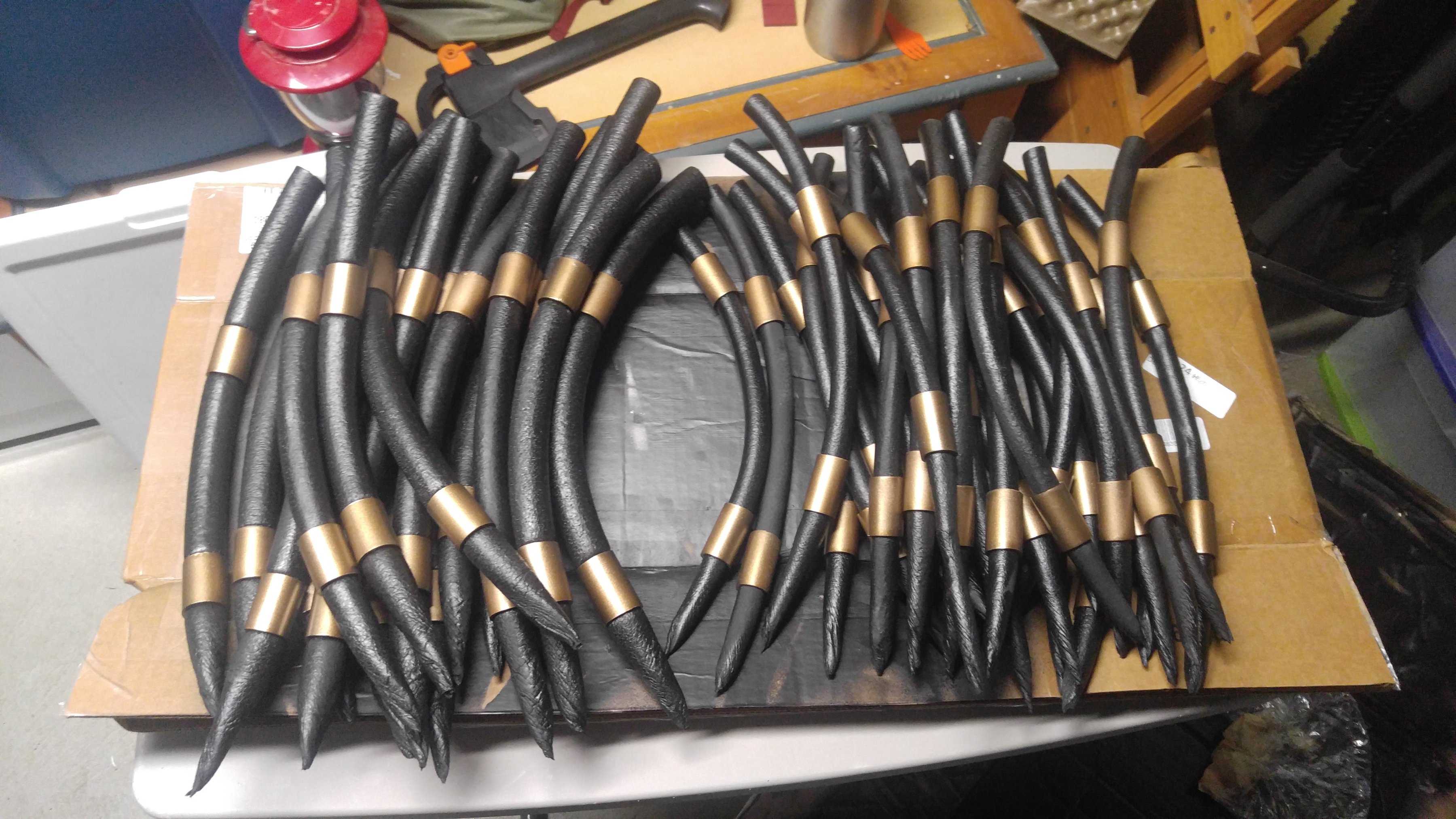

For the dreads I decided to go the cheap route for now. I made the beads out of thin walled PVC tubing, the dreads from backer rod (Ø.75" and Ø1.0") and painted with Plasti-Dip. As far as look I think they turned out good for the price, they do add some weight to the head but nothing I can handle:cool:. There are a total of 60 dreads.
To attach the dreads I cut the ends on a 45° angle then notched them out to fight tight against the head, I didn't want them to stick way out as you see with some people who use backer rod.

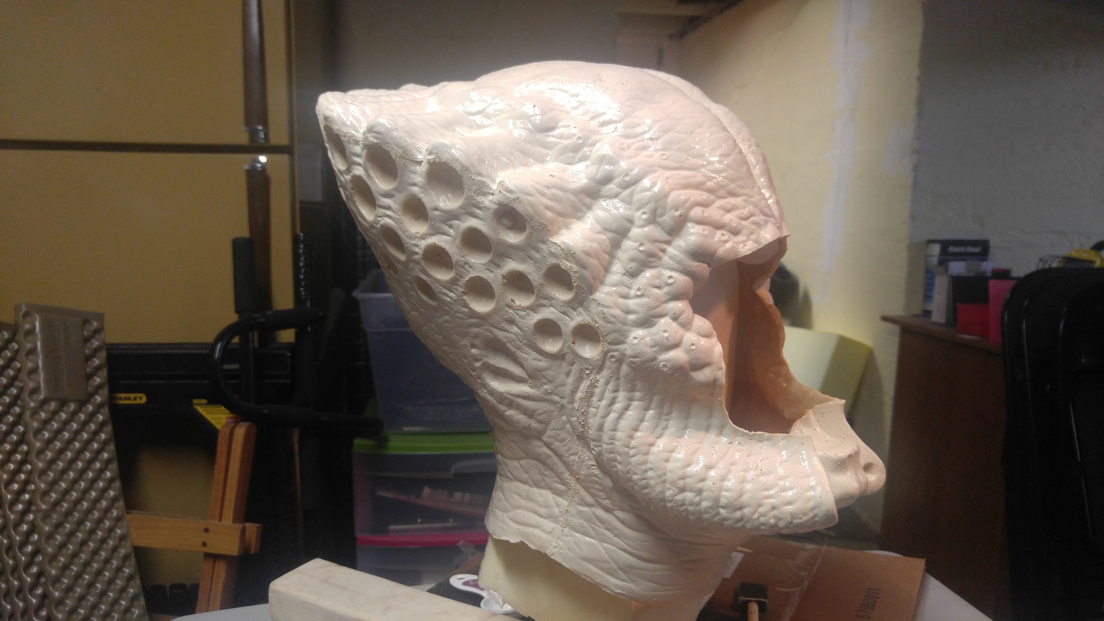

I then began the process of painting the head. Started with a light tan as the base coat mixed with some liquid latex, I then moved to a yellow, orange, brown, then eventually black for detail. I did paint more of the mask than I needed to since its a half mask but I wanted to do it for the practice. I'll probably get a full mask in the future after having fun painting this one.

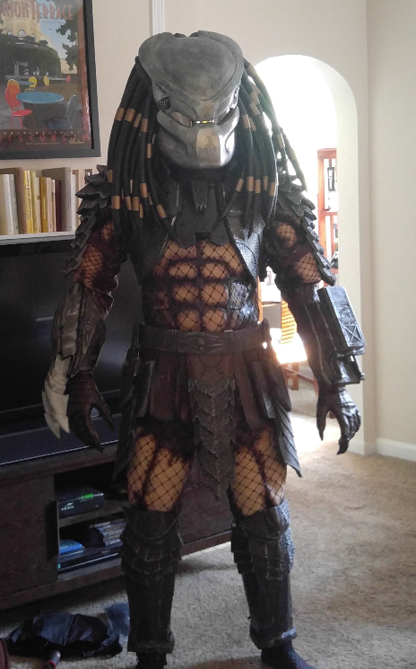

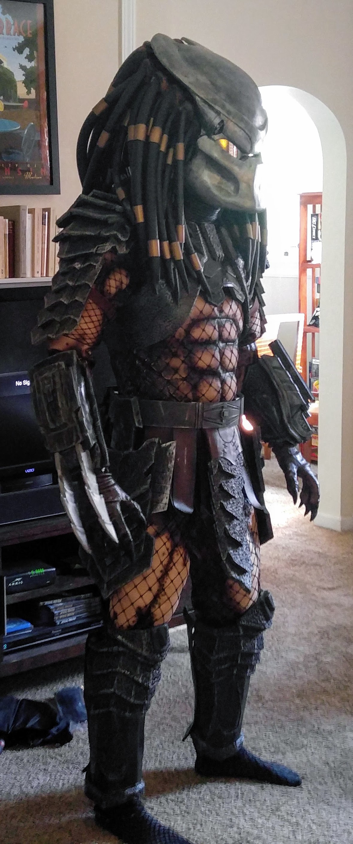

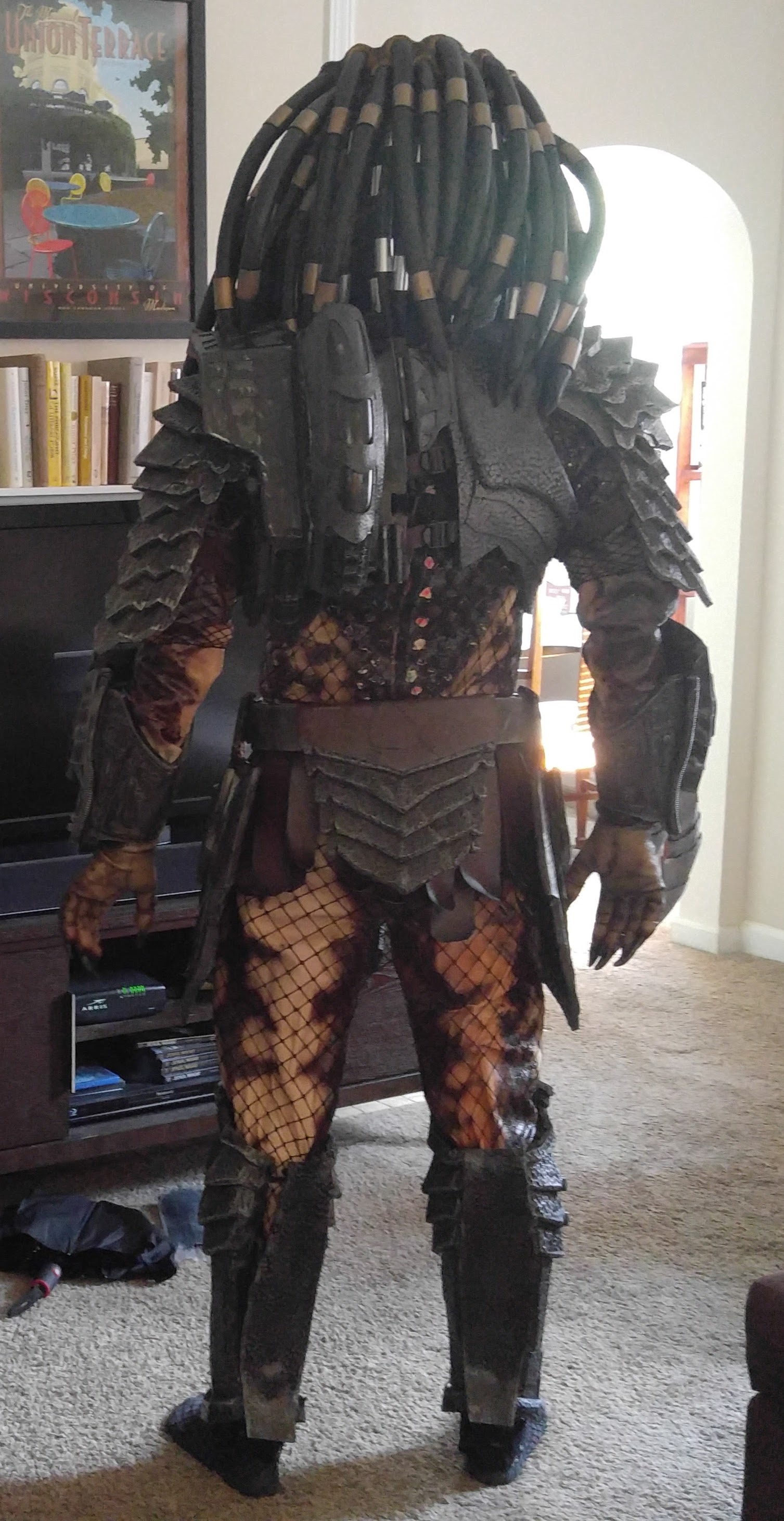

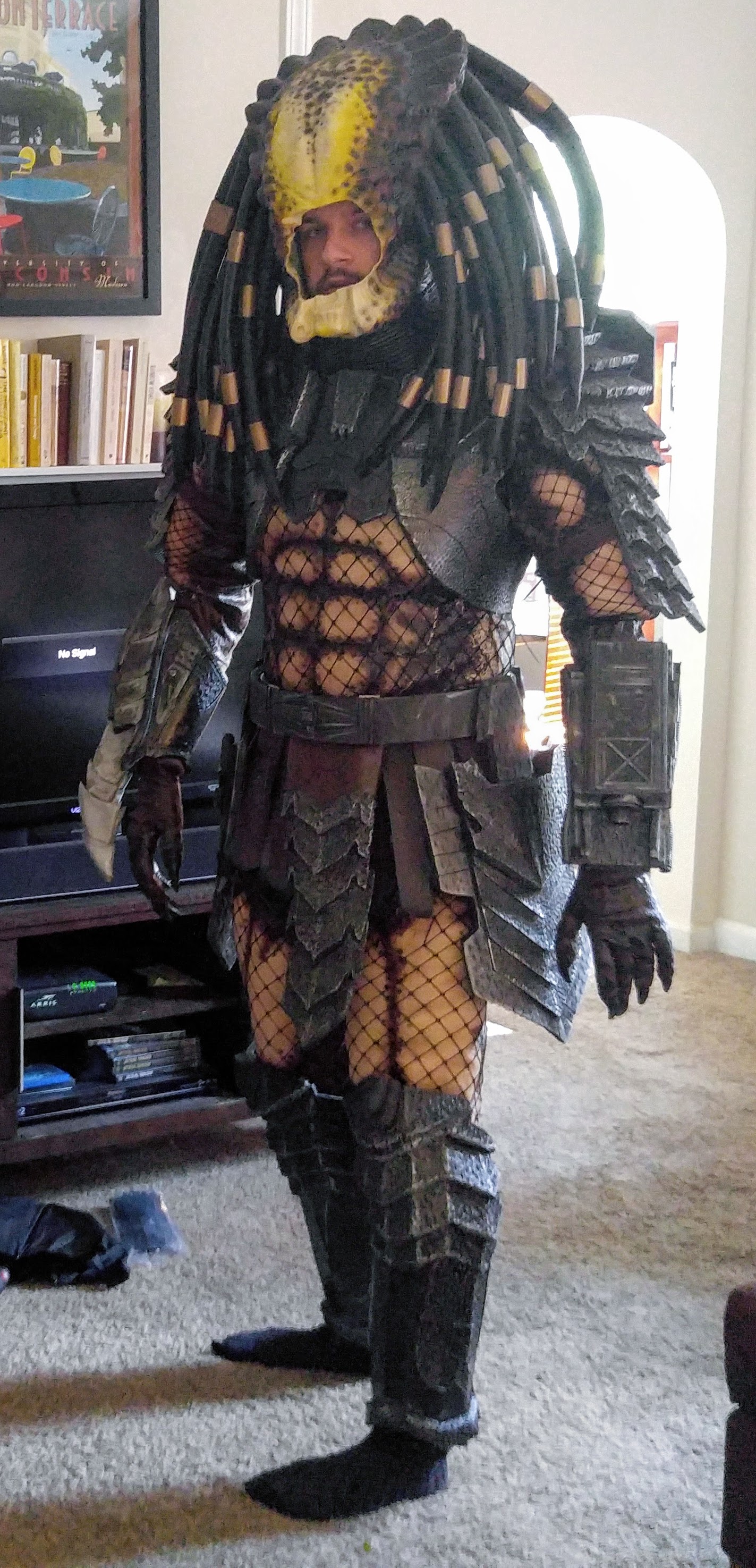

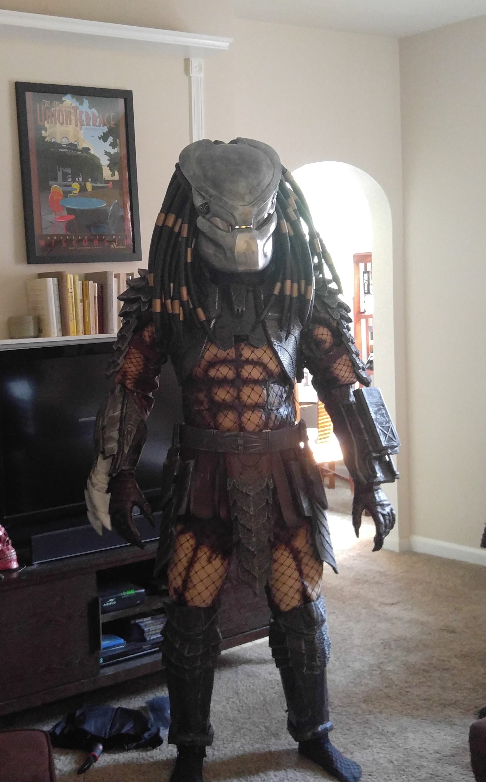

Lastly here are some pictures suited up fully, I forgot to put on the skull necklace and sash so pictures of that will be done later. All in All I'm happy with the look, one issue is that I have trouble turning my head because of the stiffness of the backer rod. I plan to add some foam to the mask to assist with the head turning. Also I need to figure out how to attach the plasma caster so the dreads don't knock it around.
