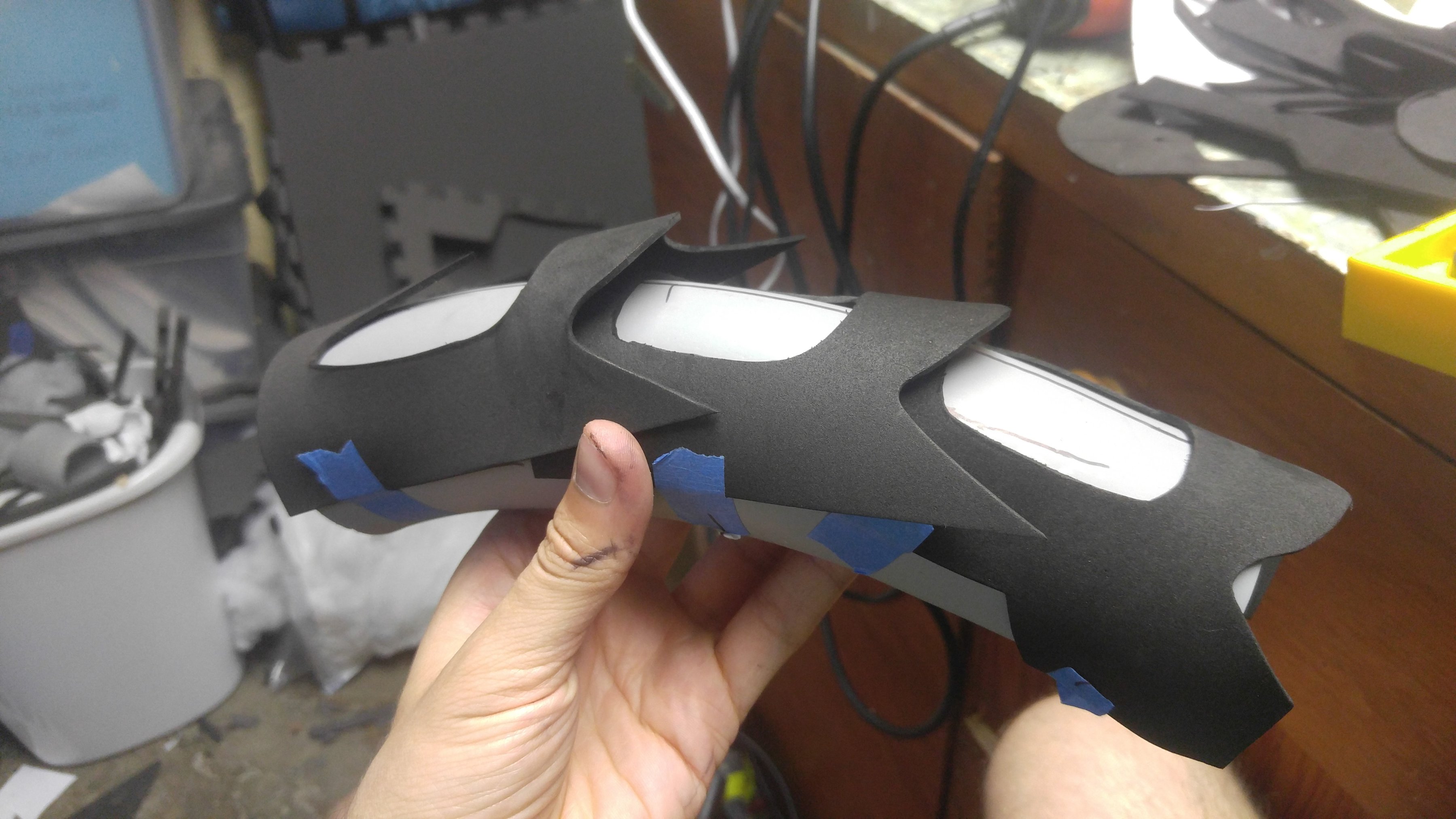

First update to the build, been working on the blade gauntlet and med-pack backpack (thanks to VinMan's scratch build). Also started the chest armor, needs a lot of work still.
The gauntlet is mostly together but I need to figure out how to make the blades out of foam...and make them look good!

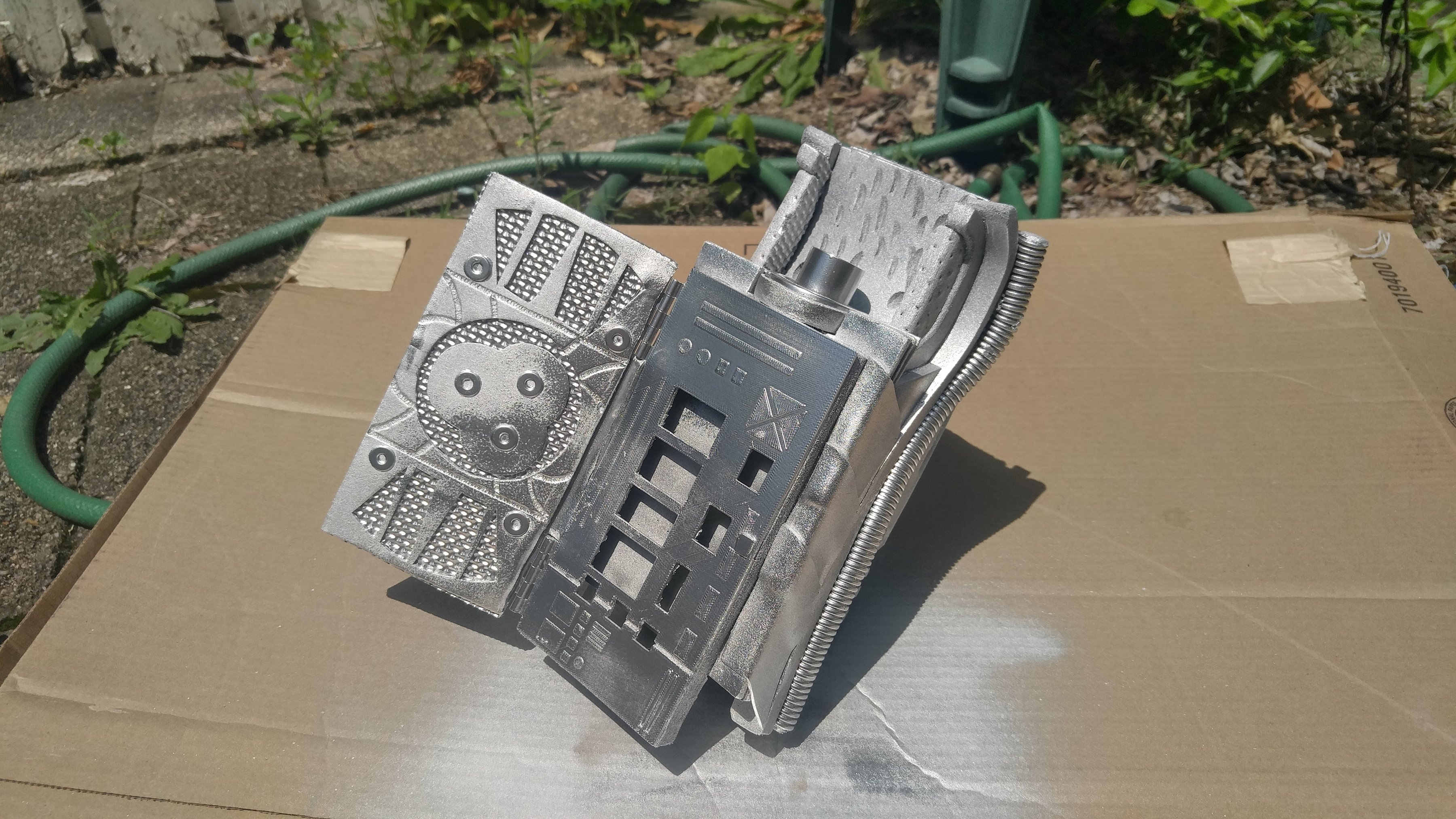

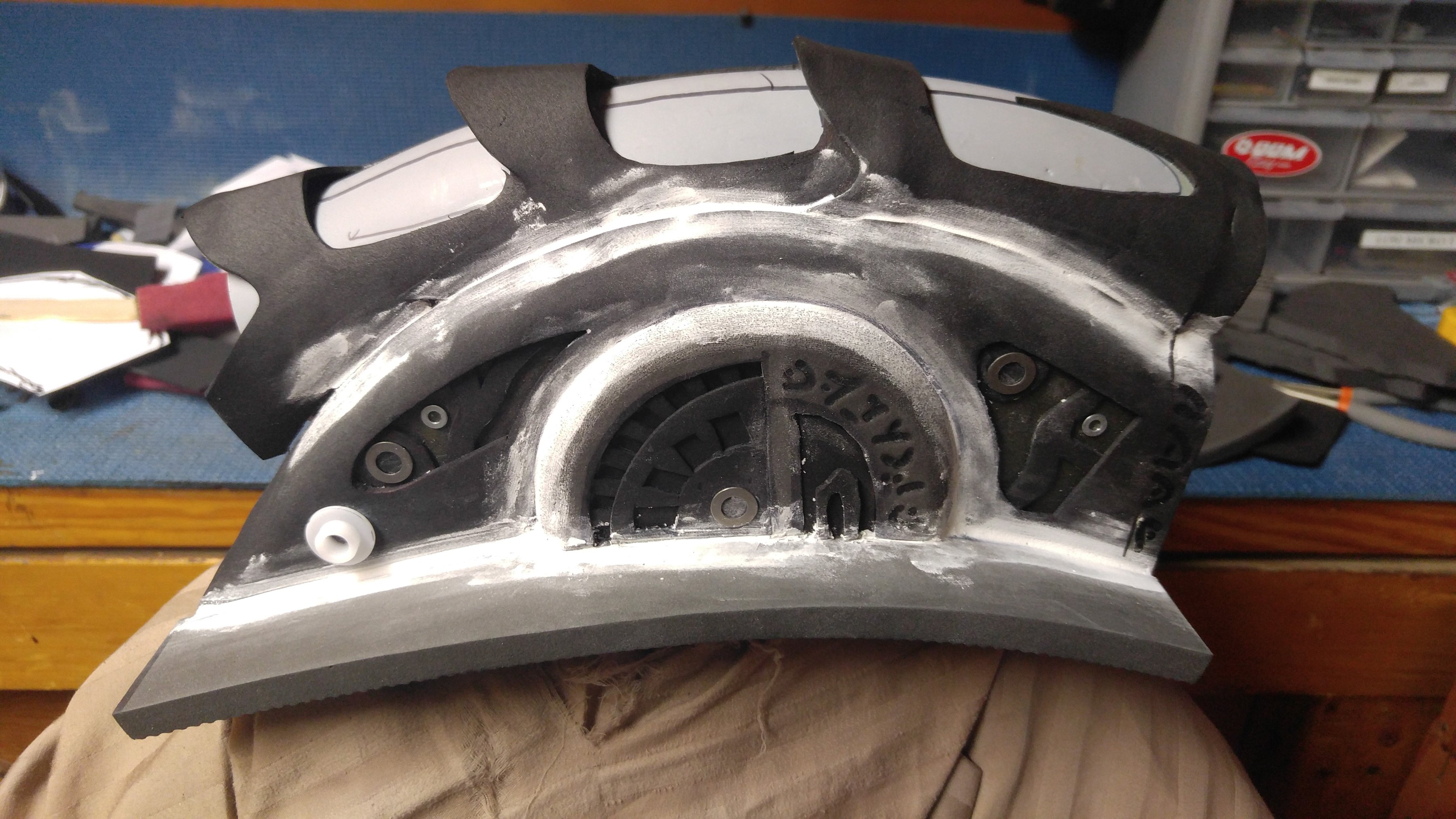

Here are the second set of updated pictures to my predator build. I've mostly been focusing on the wrist gauntlets and the Med-pack.
Few things that I have learned:
1. You can apply a bit of heat to the barge cement to make it cure faster, has speed up the building process quite a bit.
2. So far Flexible Dap has held up well filling seams and it is remaining flexible. We'll see what happens after I apply a paint.
3. One thing I haven't seen people do is use their cellphone for the wrist bomb/computer. I found an app on this website that displays 4 of the 5 countdown lights as well as some other lights that when pressed plan a few different noises. I plan to place a bluetooth speaker under the med-pack and play the sounds out directly under the plasma caster.

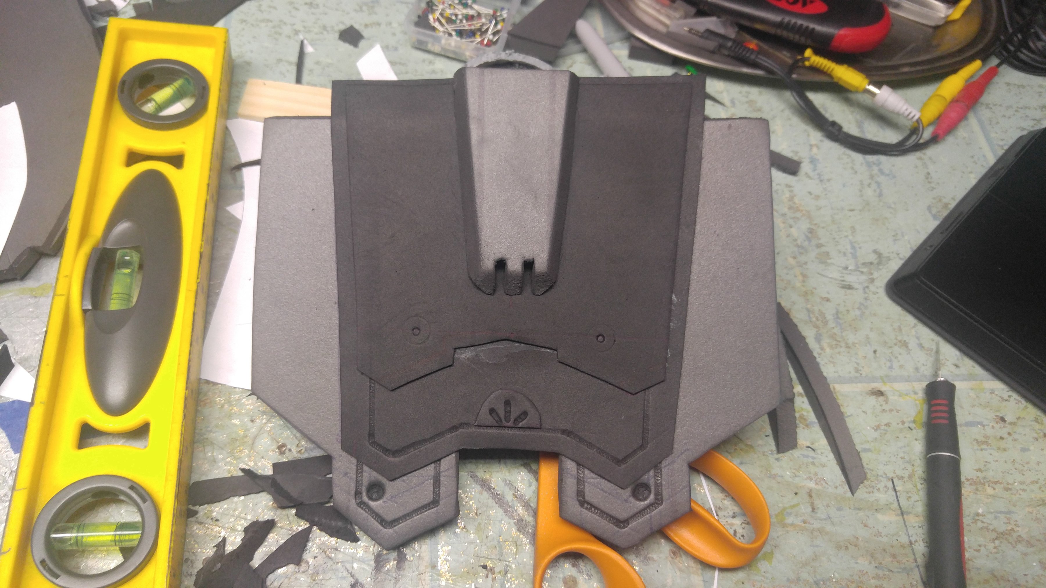

Med-pack with Flexible Dap, needs to still be sanded.
Symbols created with soldering iron, melting foam.
Pinning foam in place helps to locate parts before gluing, also allows you to trace overlapping parts so you don't put glue on exposed surfaces. heat gun should seal most of the tiny pin holes.

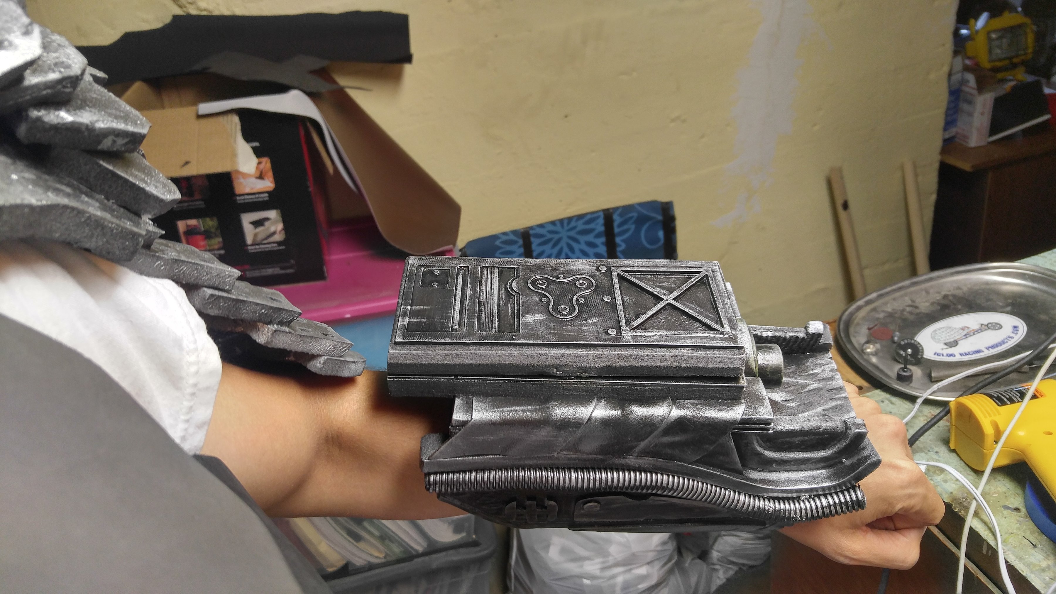

Thanks everyone for the kind words! Here is another small update of the wrist gauntlet painted and weathered. I added some 3D printed parts to add a little more detail to the gauntlet. Easier than making a bunch of small parts out of foam. Also I've added some length to the leg armor, they seemed a bit short before. Lastly connected to Bluetooth speaker into the med pack, now I just need to find a way to secure it to the chest armor.

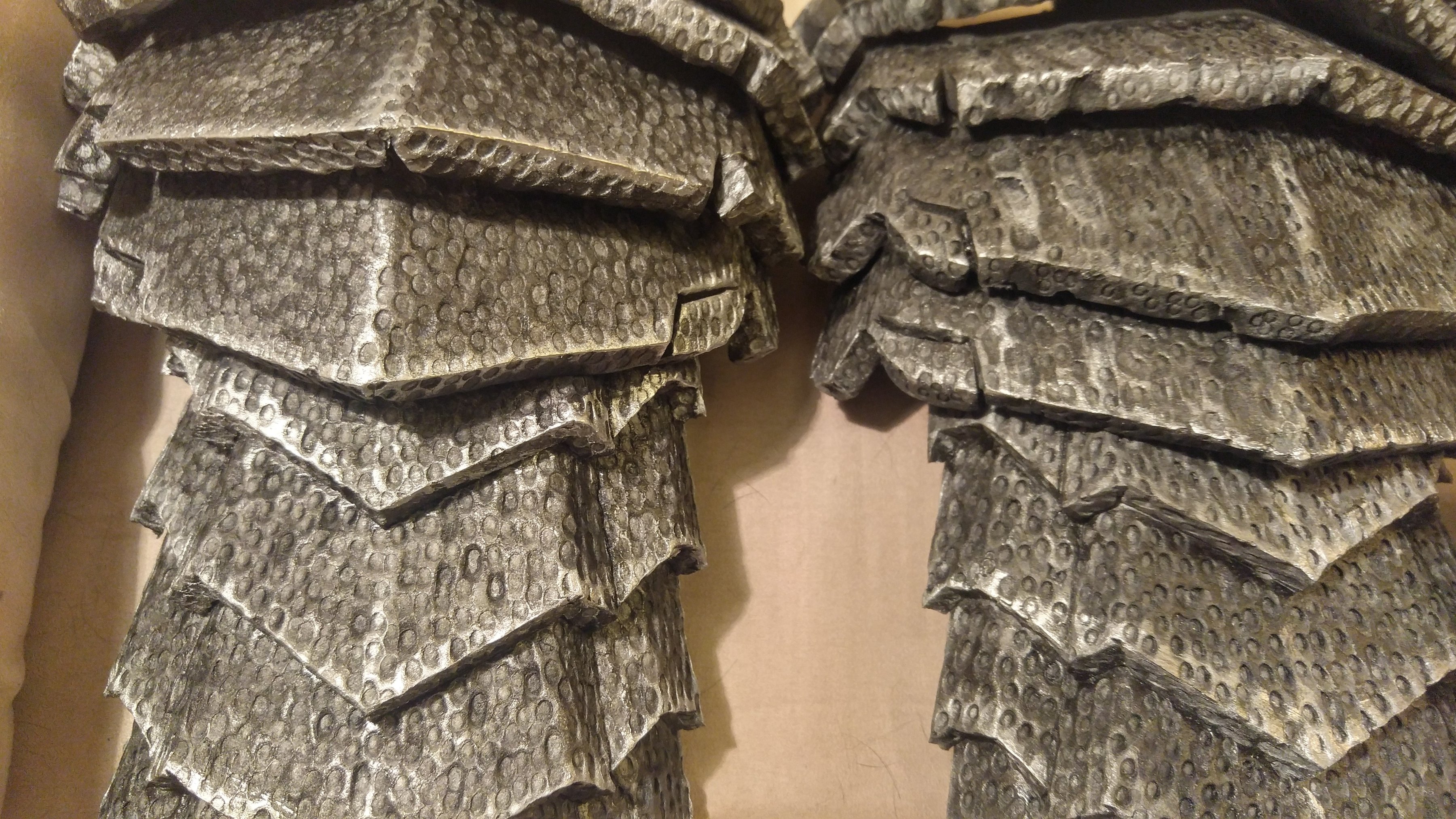

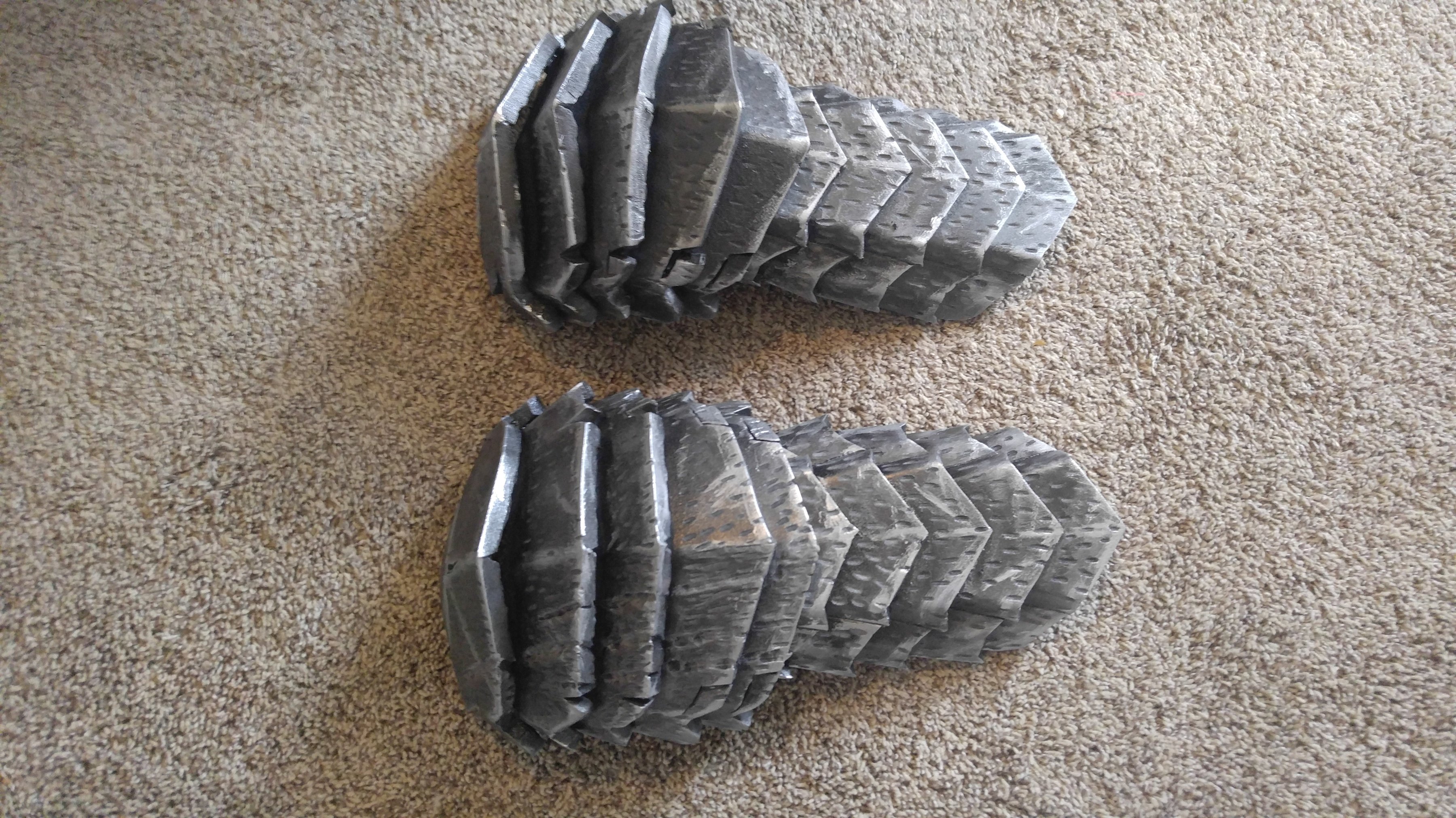

Here's the next update, I wasn't happy with the texture I got with the dremel tool so I went back in and retextured everything with a soldering iron. It took a lot of time but I really like the result. What do you guys think?

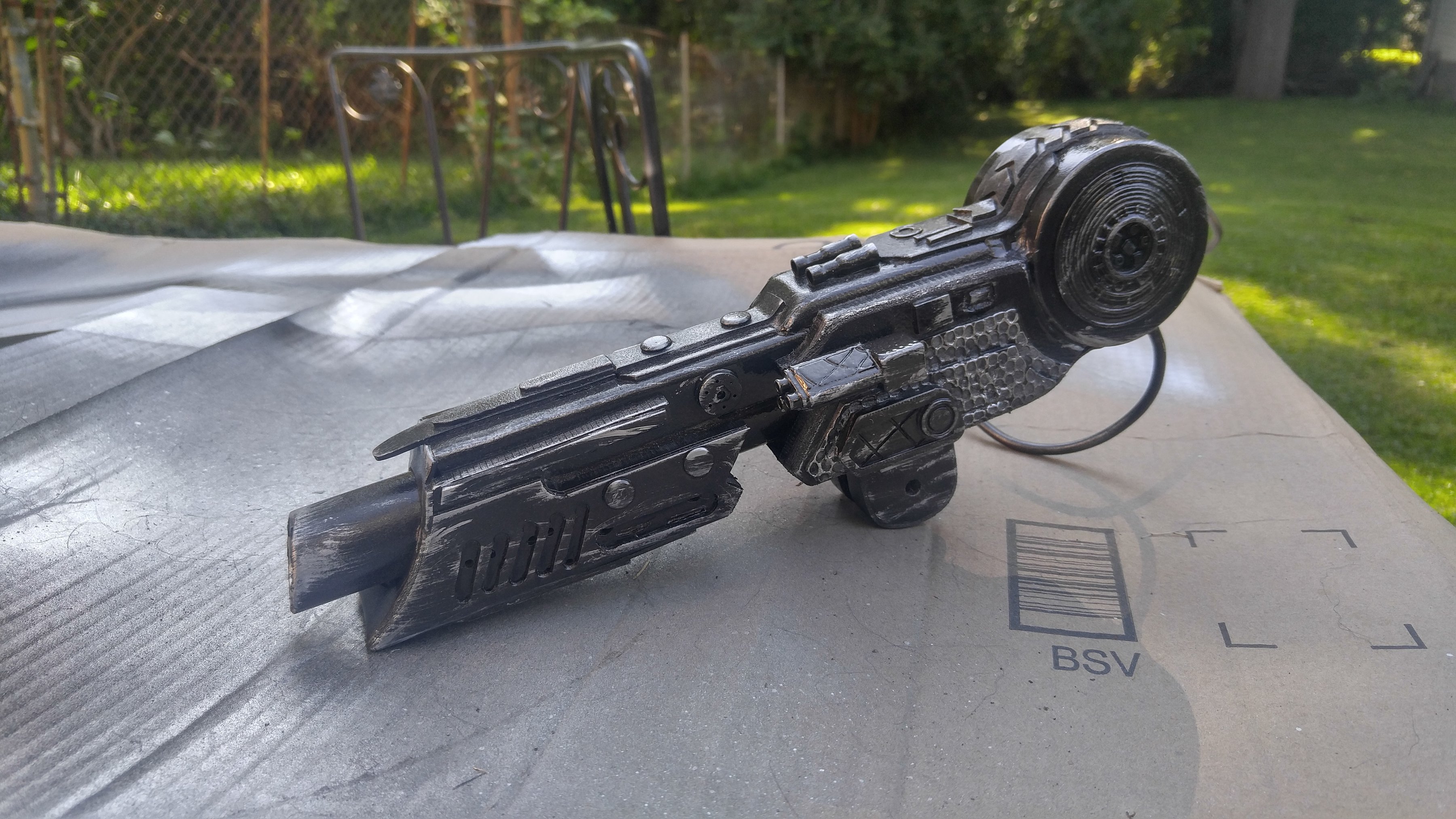

I've also been working on the AVP Scar plasma caster which is almost complete. Not 100% screen accurate but some of the detail is to complex for the tools I have... I haven't seen to many of these on the website so I made a thread under the props section to help people out if they're looking at making this. Here's the link: AVP Scar Plasma Caster Scratch Build (15 Pics)

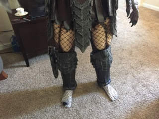

Legs completed, I needed to add a fill piece to the back since they didn't fit entirely around my legs. it just Velcro's on so its easy to remove.

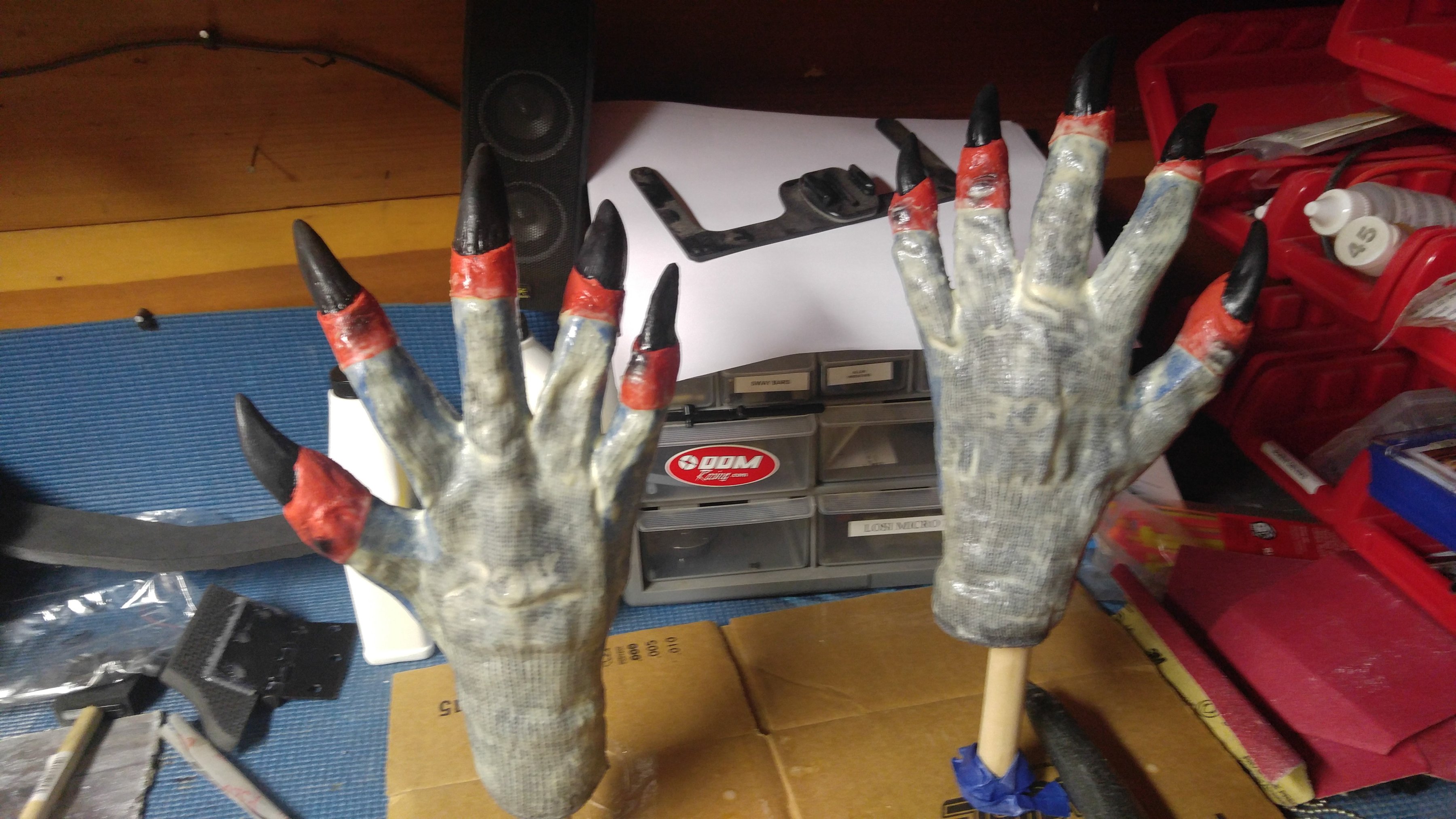

Finished the hands, used a $5 pair of gloves from the hardware store and glued claws from some latex hands onto them. Then I latexed the whole thing and painted. I had issues with the paint sticking to the latex with adhesive promoter so I mixed the createx airbrush paint 50/50 with latex for the first coat and that stuck really well. Need to finish with perma-wet still.

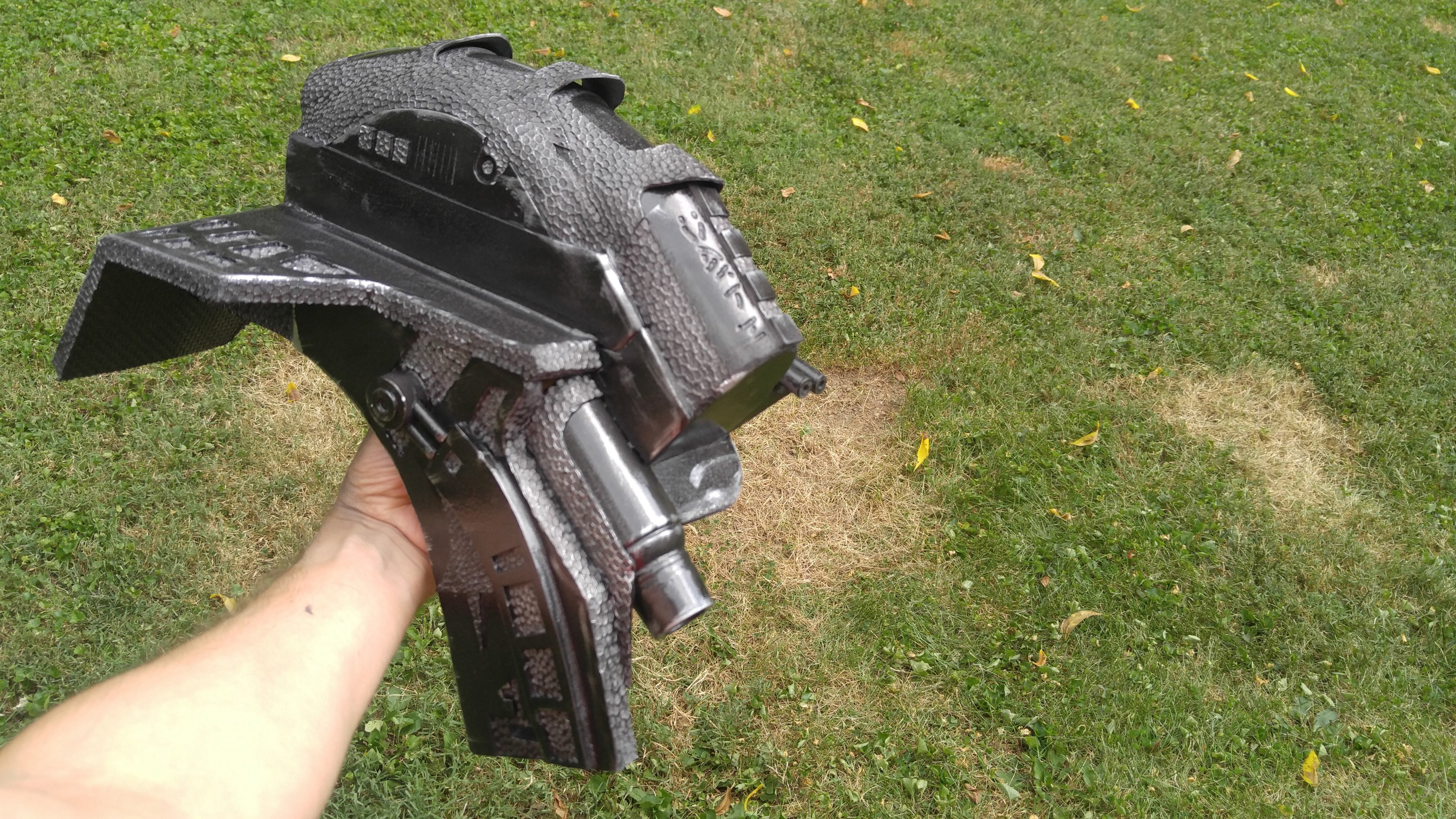

Completed chest armor, hooked it the back with 3 straps. these will be covered by the dreads, backpack, and back strap piece.
Finished Med-Pack, still need to determine how I'm going to mount the plasma caster to it so it doesn't shake around. Any thoughts? What have others done?

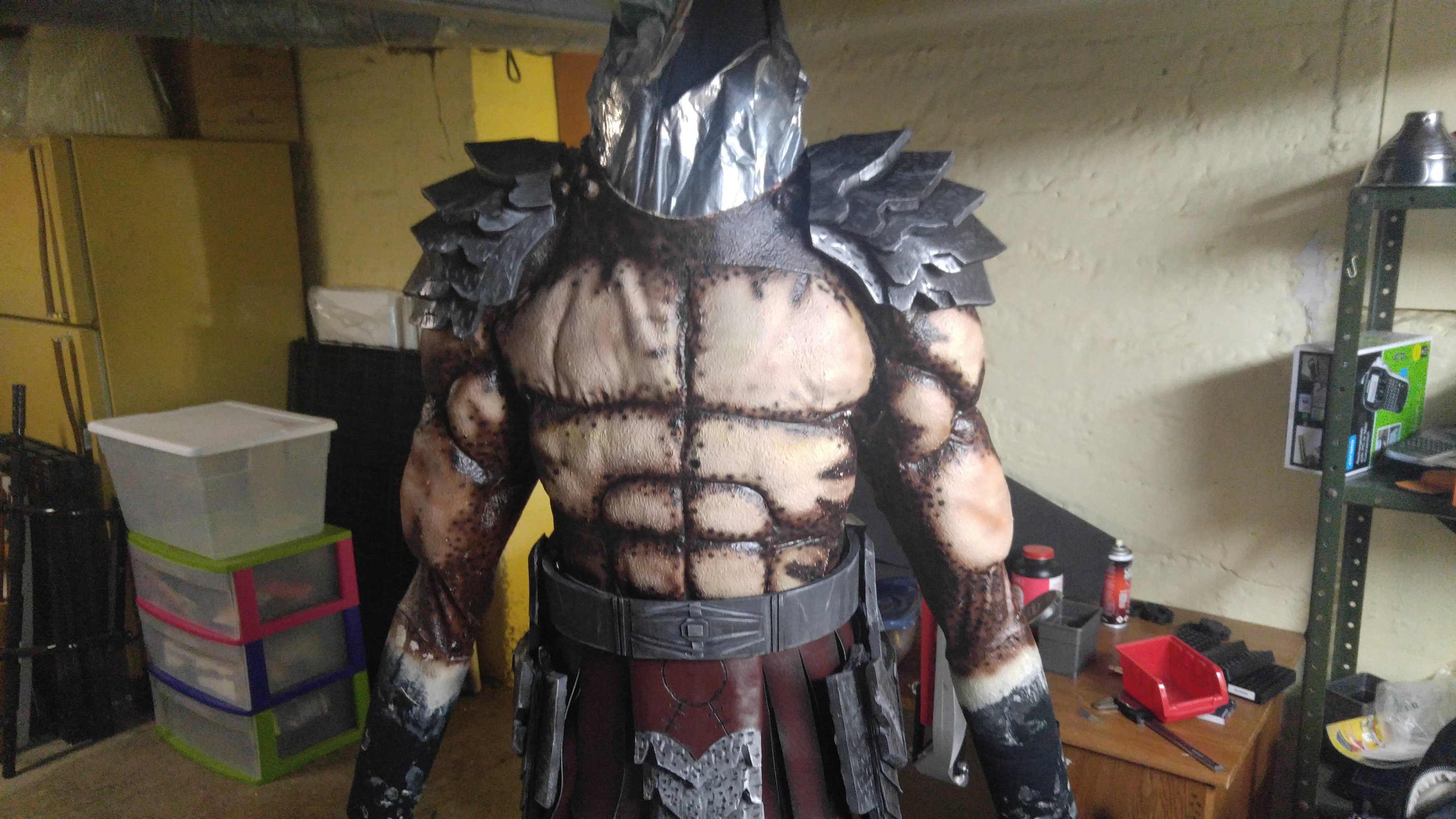

And finally here are a few pictures of where I current am with the suit. Everything is completed except for adding the back strap and zipper to the latex under-suit, mounting the cannon and wiring it to the gauntlet, everything on the head and feet.
Also I did use a fishnet body suit for the netting.....whatever works!
