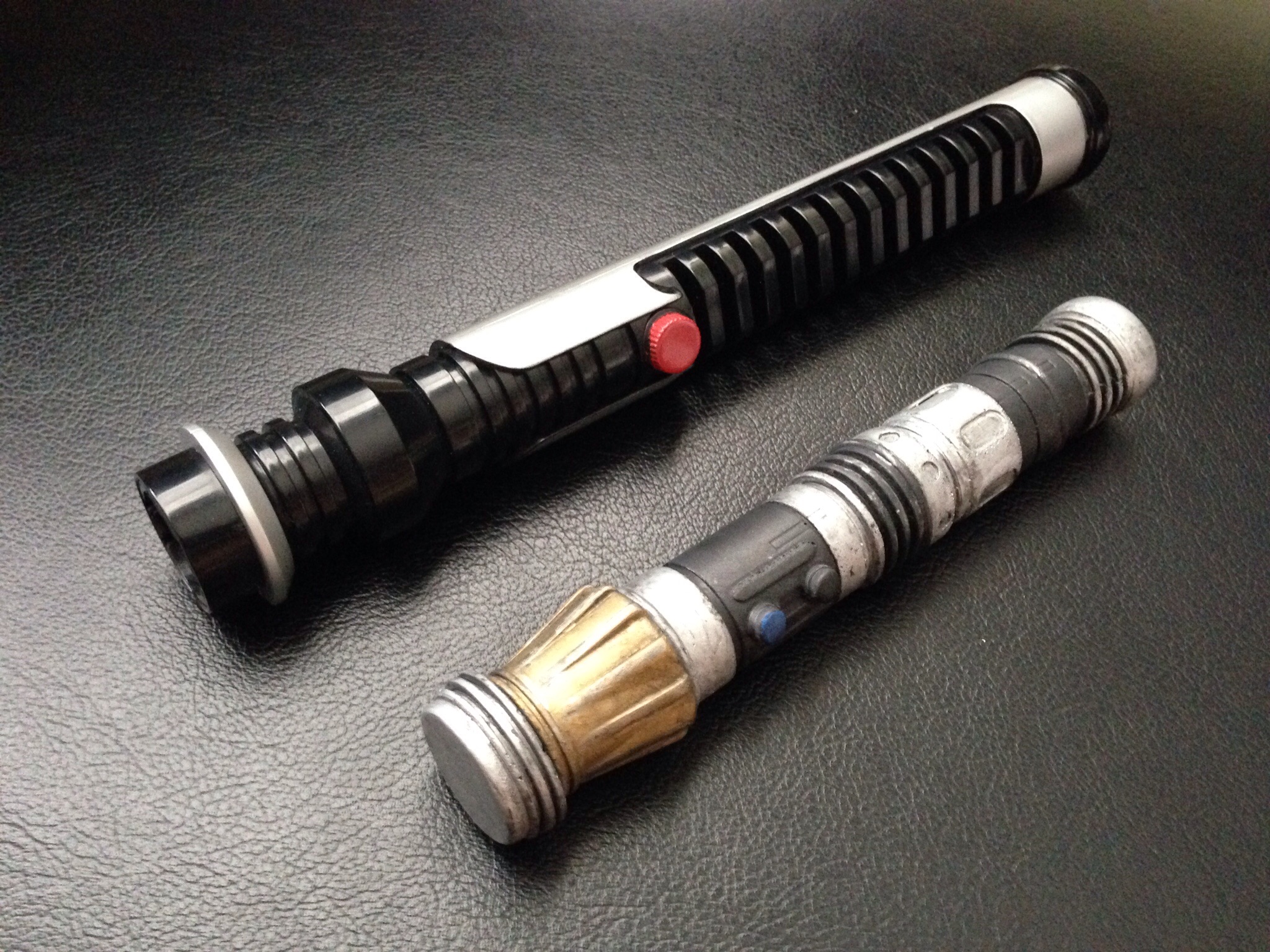

Ultimately I want my youngling hilt to look like this:
Prior to surface clean up and prep, I want to run a metal rod almost full length to give it a bit more weight. I still have a good amount of the threaded rod I used for the Leia A New Hope blaster. I started using the threaded rods and cut off long bolts on recent projects because I found it to be much cheaper than buying a piece of metal rod stock.

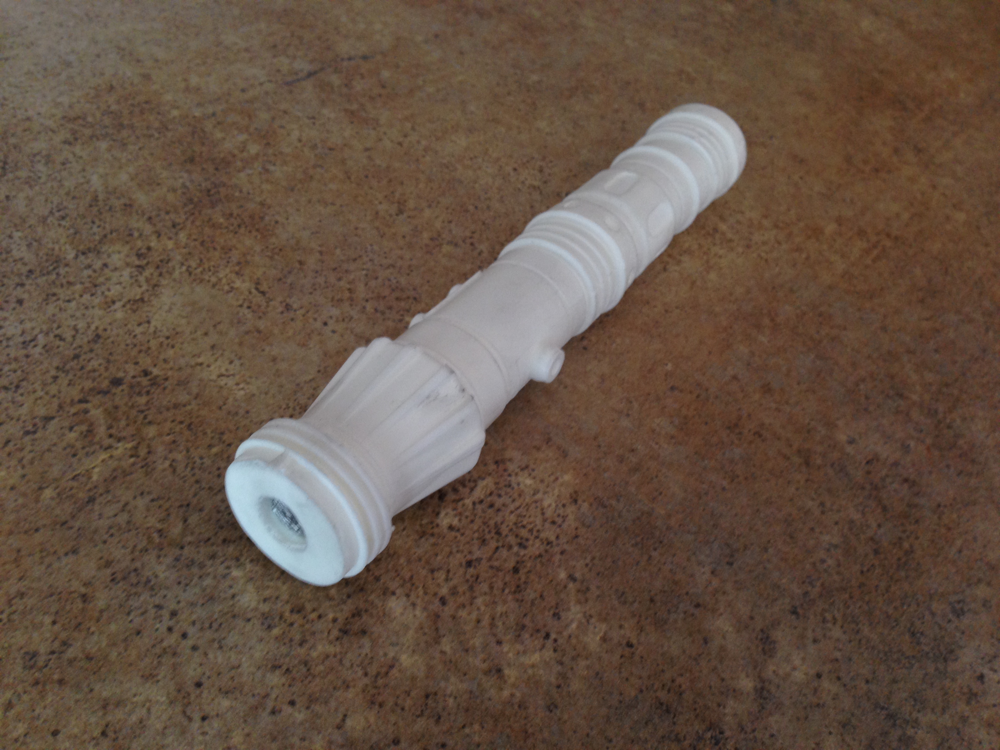

Have not gotten too far on this due to time and some minor problems with the paint and bondo.
The primer went on well but the silver I sprayed stayed tacky. It's Florida and humid but the paint was applied in a cool air conditioned area. Not the first time with this paint so I think I will throw it away and get another can.
I also had issues with the Bondo. It mixed, applied, and dried very well. However even with primer, you could see the material difference. And something strange is going on with the Bondo in the emitter. No matter how much I sand and it feels smooth, within no time, the Bondo area rises sometimes sinks. The Bondo is not loose, it is securely packed and hardened in the hole (heh... I said "hardened in the hole"). To attempt to fix this issue, I affixed a thin sheet of plastic on each end and sanded. Even with this, today I noticed that you can see the Bondo underneath pushing on the plastic on the emitter end.

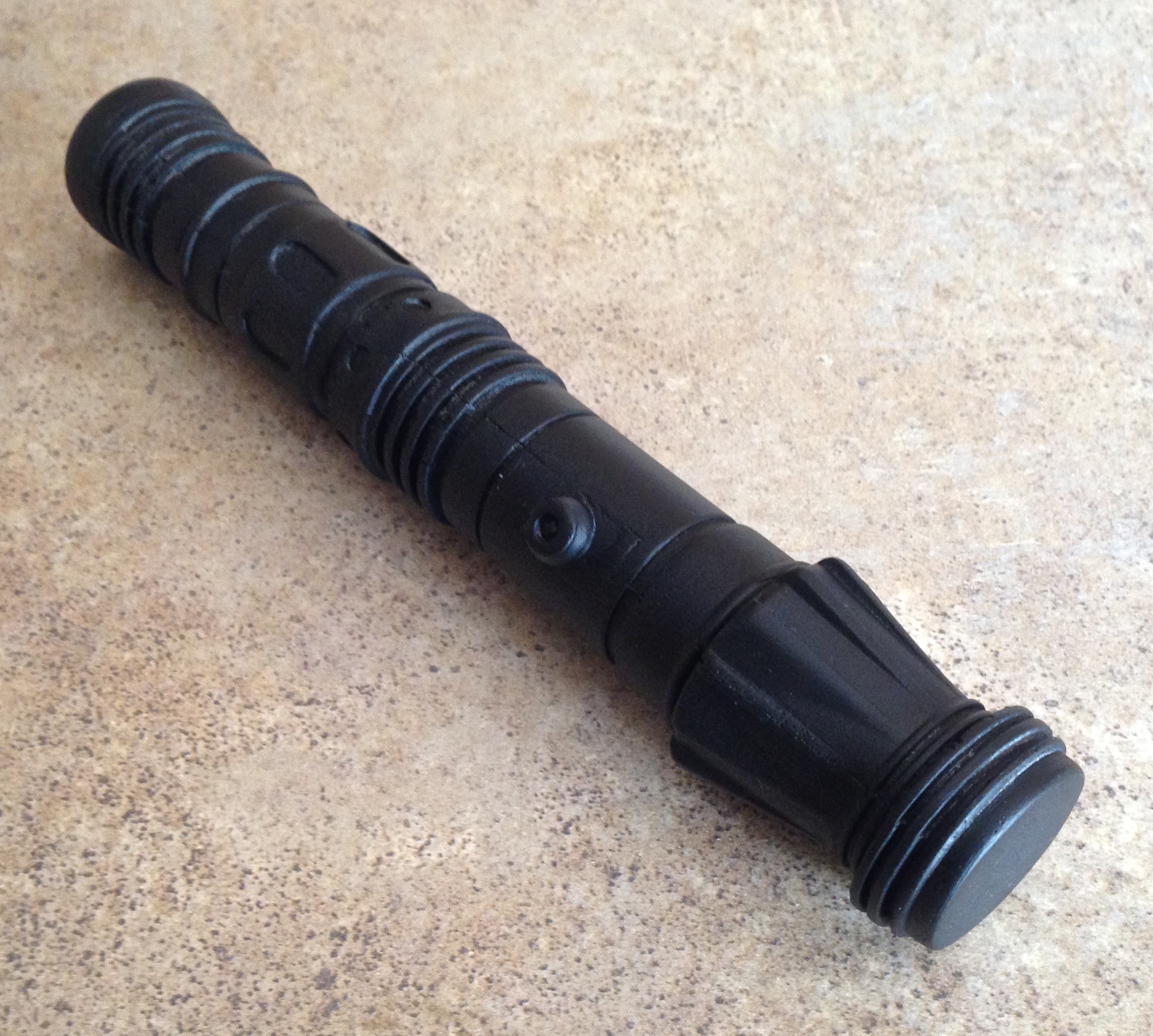

Here is where i am right now:
The original plan was to prime, spray silver, then spray the black sections, then hand paint the detail. However as I mentioned earlier, the silver spray was problematic and I used up all my primer. So i just sprayed flat black because this spray paint is suppose to be both primer and paint. Next, when I have time, do the rest with acrylics by hand.

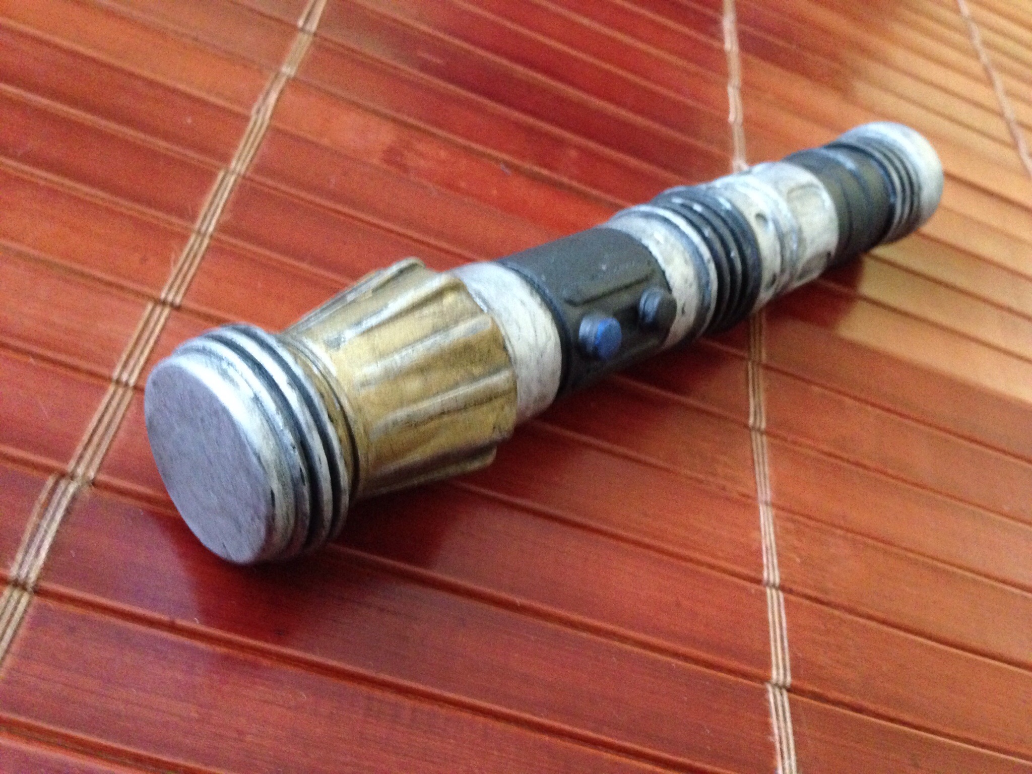

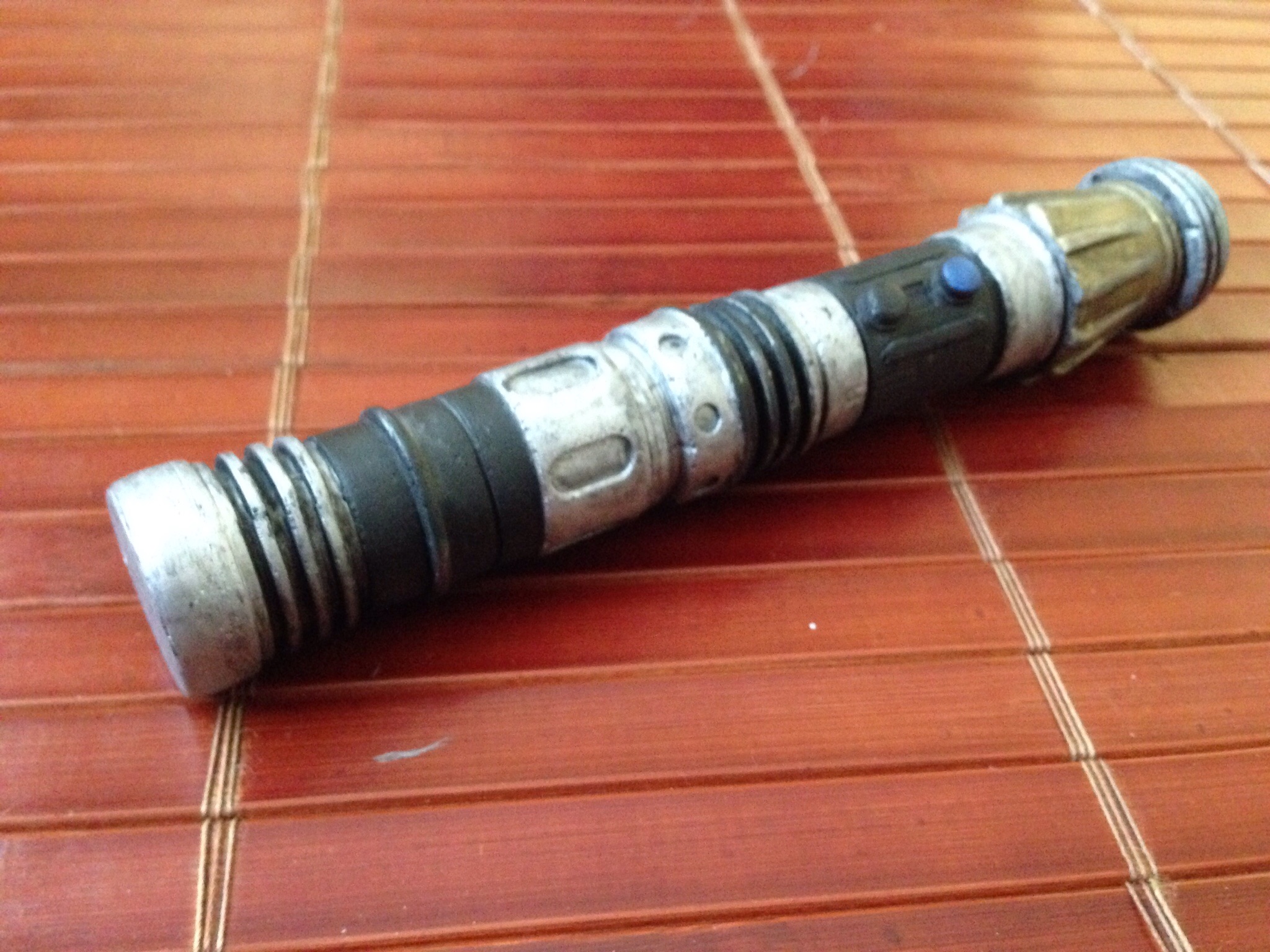

I'm calling this project done.
As I said in a previous post, I added a steel rod which doubled the weight (now 6oz) so it has a nice heft to it. Happy with the paint job as I think it looks quite close to the original prop.

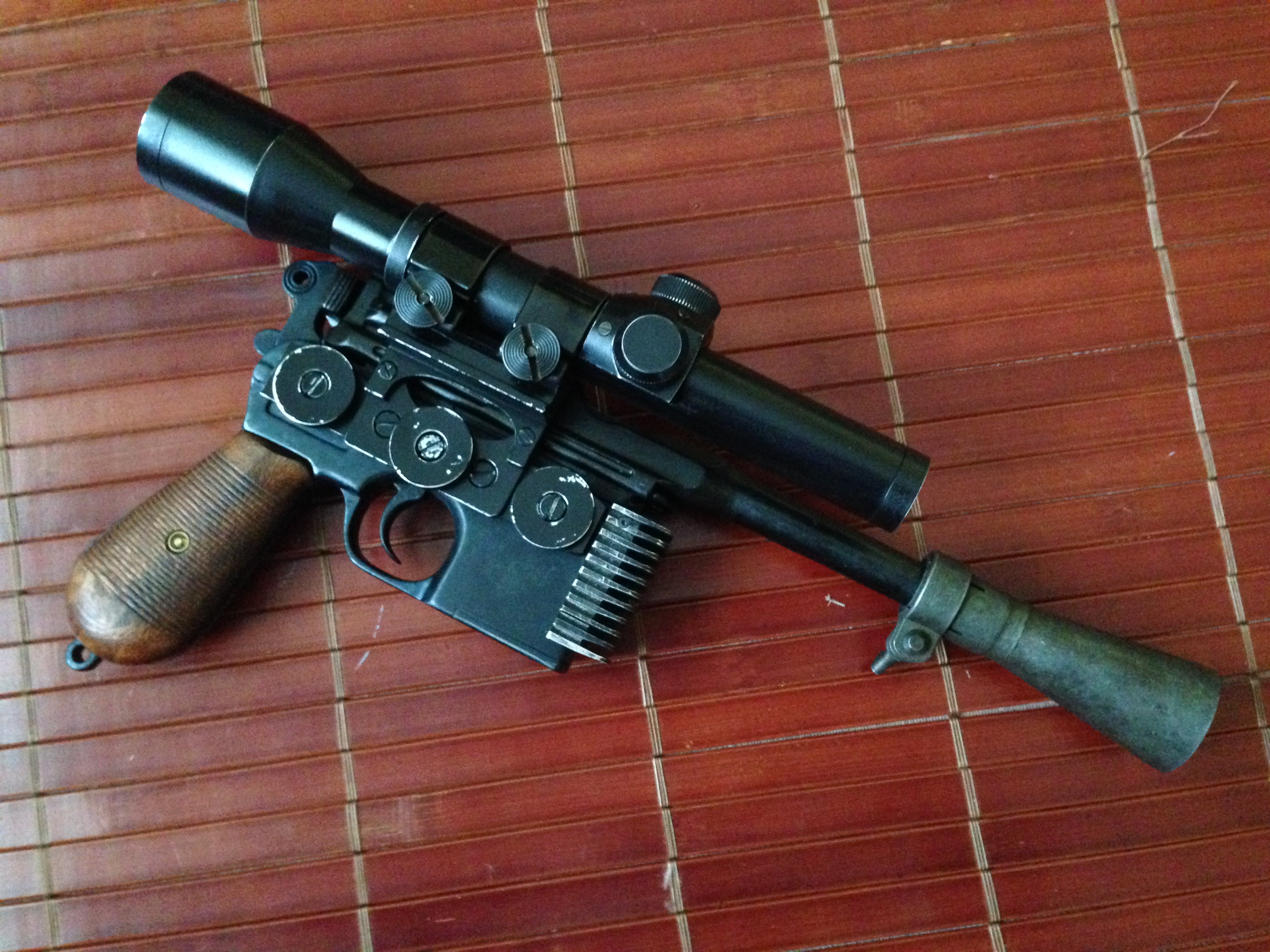

I upgraded my Greedo Killer with a new grill and scope machined by @SoloHold. Awesome parts.
View attachment 526385 View attachment 526386
that Blaster is looking really nice :)
I really wanted the Grill & Scope from this run to upgrade mine but I was already down for 2 ESB kits from Boba Debt & a V2
I've got to ask ... Have you got the scope knobs mounted the right way round on Compac Scope?
I thought the sloped/rounded part was behind the knobs?
Re: UPGRADED GK - Builds: Leia, Greedo, DL-18, GK, Droid, E-11, DH-17, Youngling, mor
Right, the slope is to the rear.
