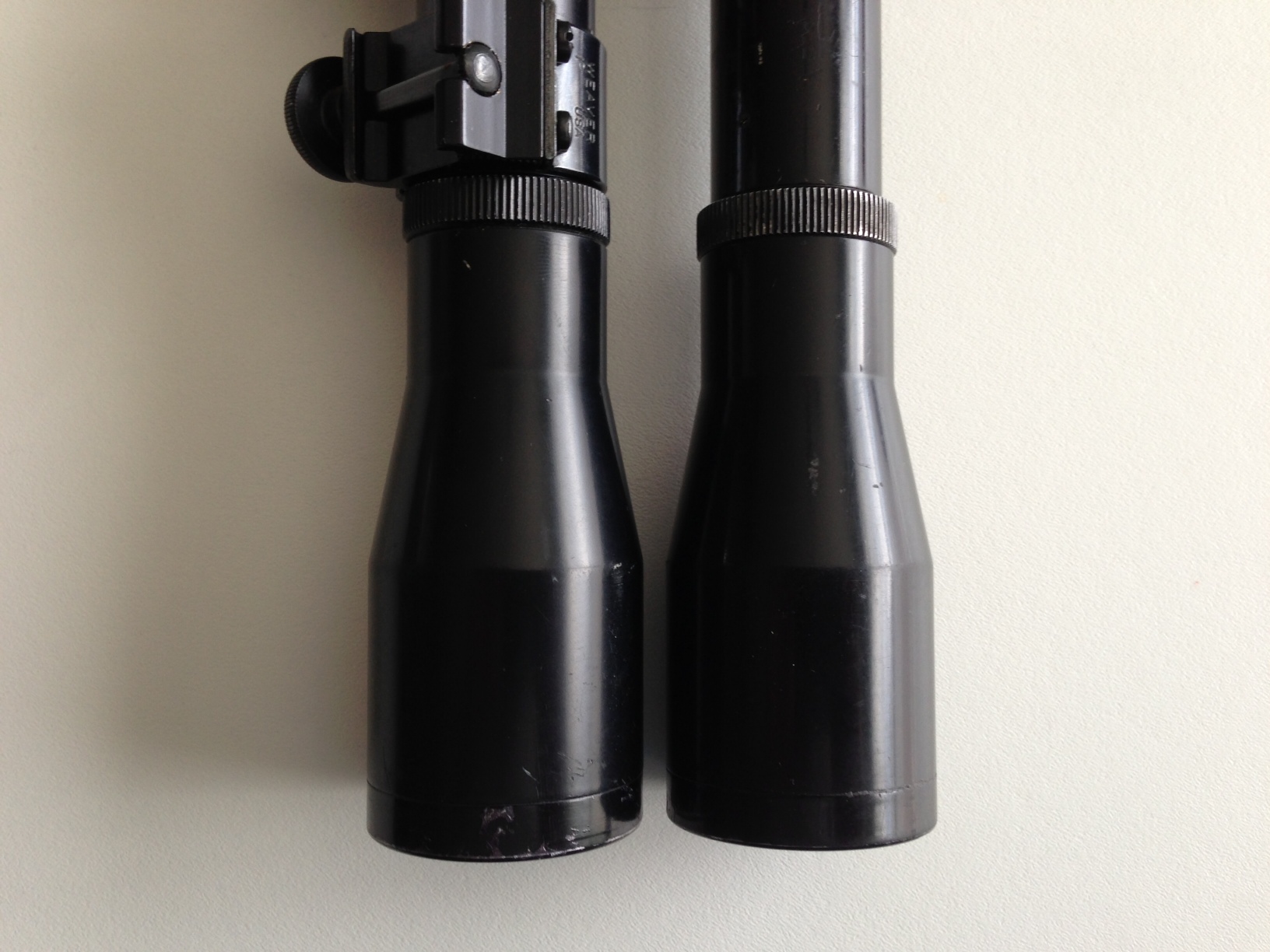

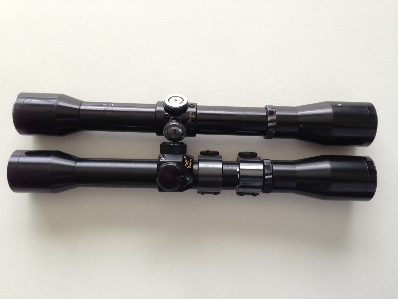

I just picked up a second Compac Super 4x31 on ebay, and it appears there are at least THREE variations to it.

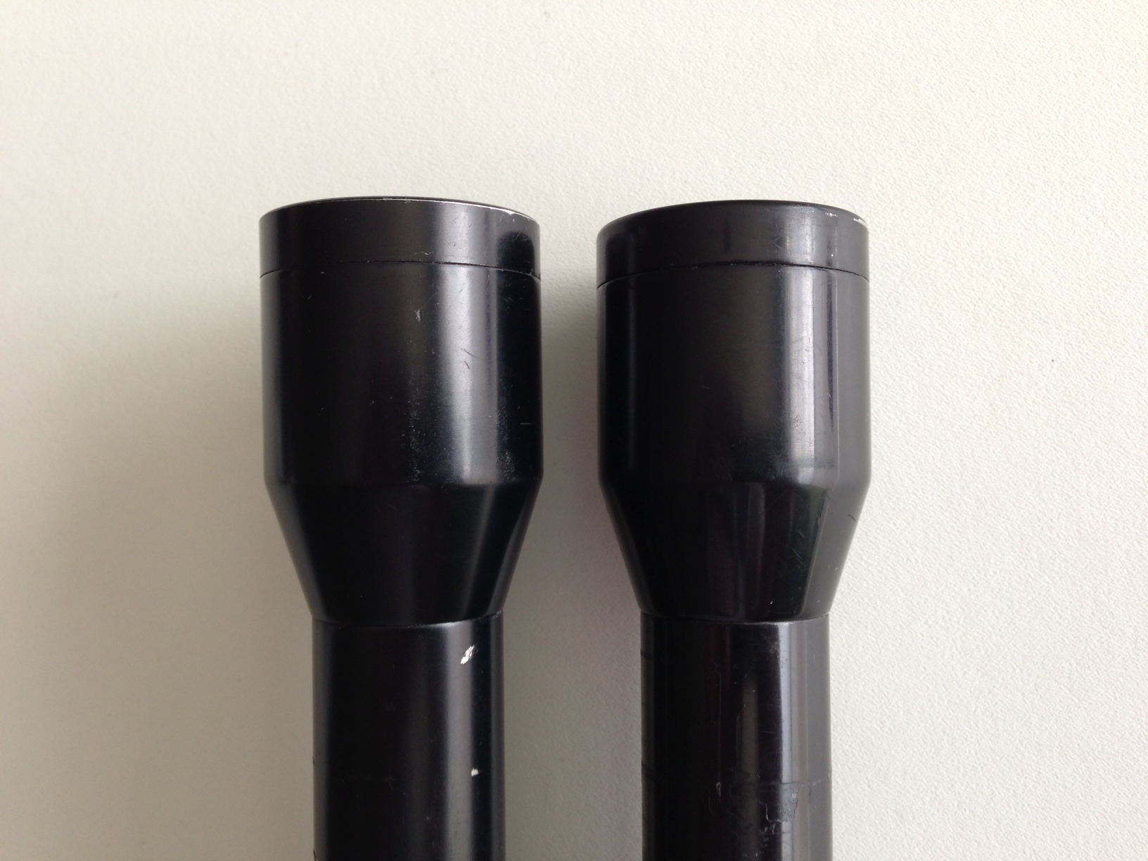

So the one I have and will use seems to be more common. It has the larger front lens bell that can be taken off.

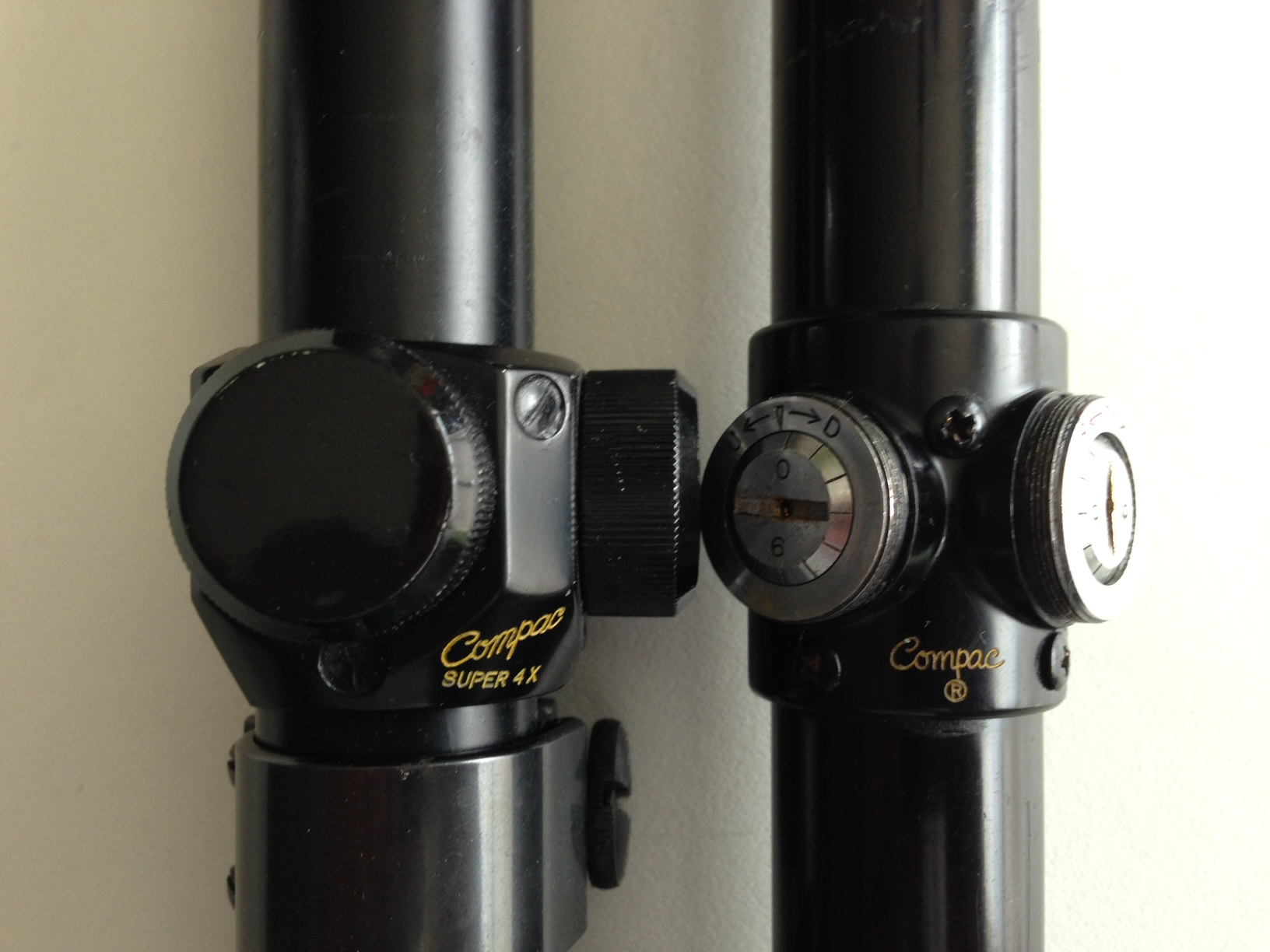

Then there's the one Adamata does his resin cast from, which is prop accurate with a SMALL front lens element. This one is almost identical to mine where the windage adjustments are, except the screws/screw holes are slightly different.
Then there's this new one I just got and have never seen before.

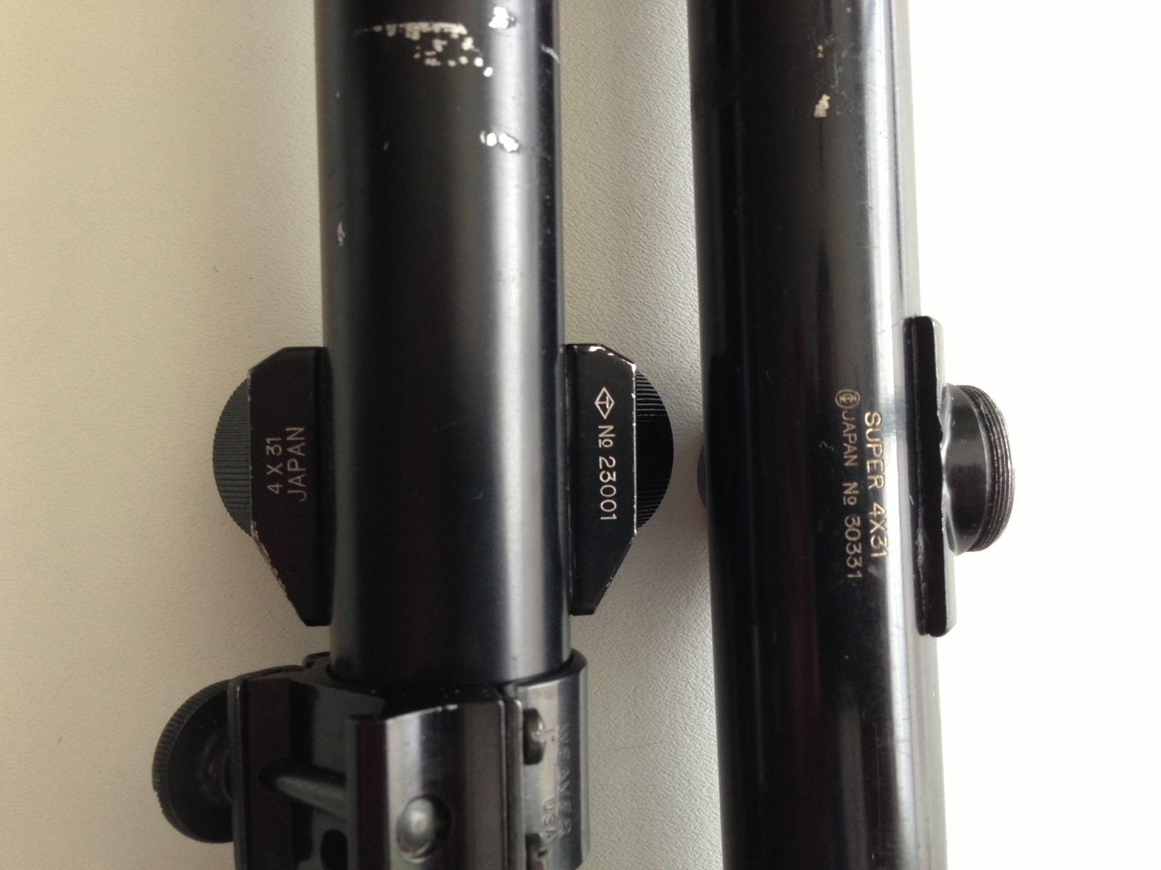

Its 4x31 with large front bell, but different windage knob mount design and setup. This one is missing the caps, but the caps from the other do not even fit. They thread on differently.
Otherwise dimensions are identical.
