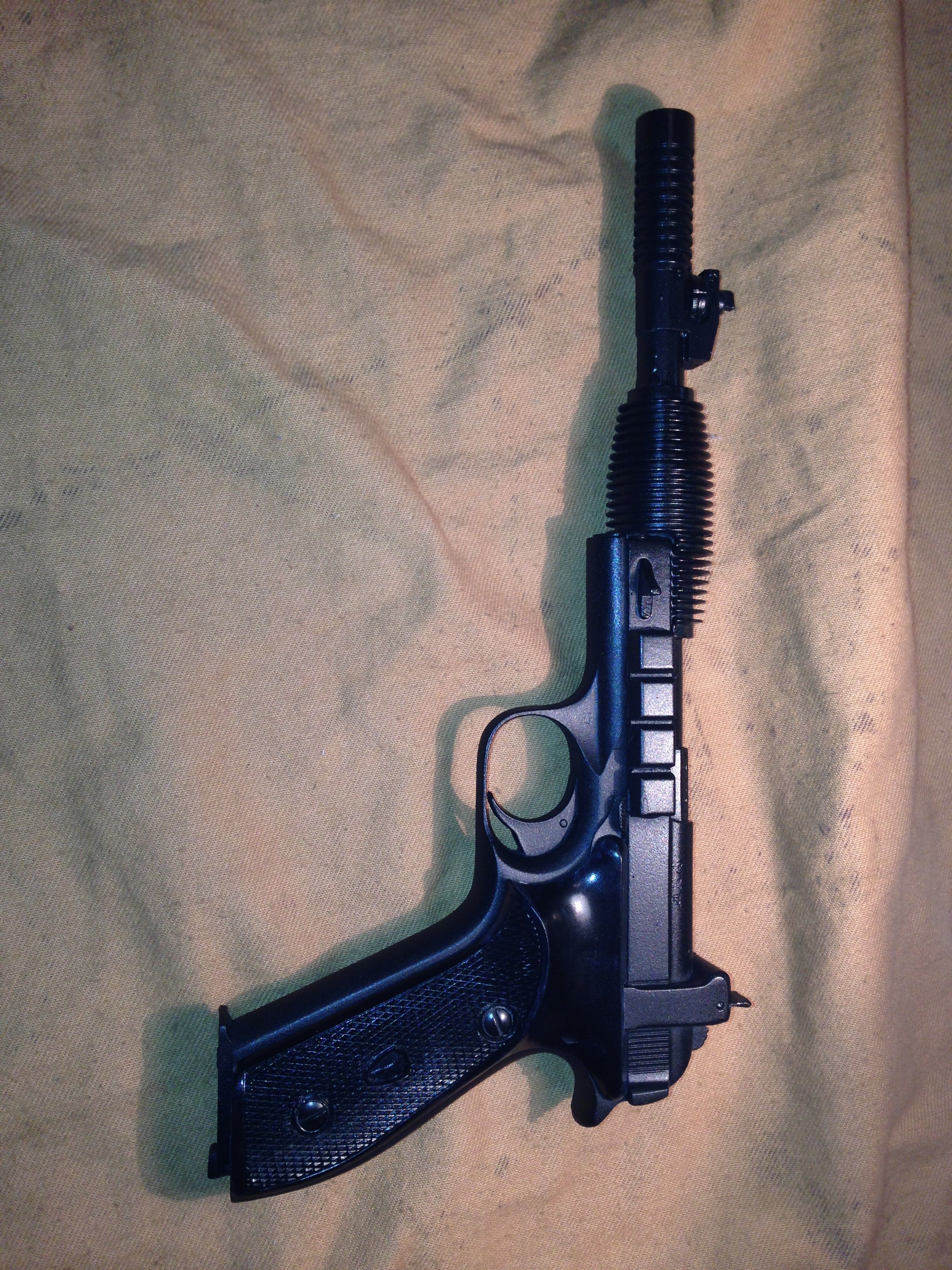

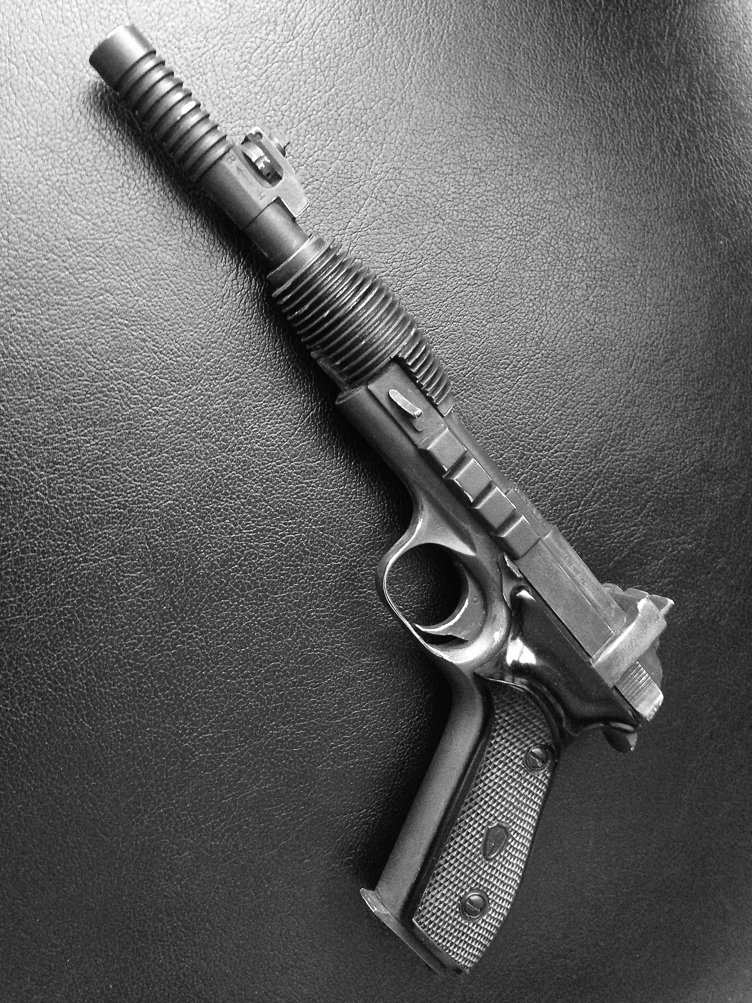

Here is my updated Leia - took off the old parts that I had cut and cut the barrel and inserted a rod before adding the new uncut part. Got her painted up today. I am much happier with this outcome than having a visible seam down the middle of the radial part! Not sure if I am gonna rough it up or leave it in pristine condition. Seems like Leia would have taken pretty good care of her blaster. :)
Looks good. I am ruffing mine up. My thinking it is not a princess blaster, it's a rebel blaster. I feel that it was a blaster she got from the armory unlike her A New Hope blaster which was a personally own blaster. I could see it being a gift from her father.
I have been reconsidering the weathering. after I apply the graphite and seal it, I am going to wipe on and wipe off black acrylic paint. I did this on the A New Hope version, to help the recessed areas pop a little more. After that, I will look at it and determine if weathering is needed to sell the affect that this looks like a realistic weapon or just a painted piece of plastic.

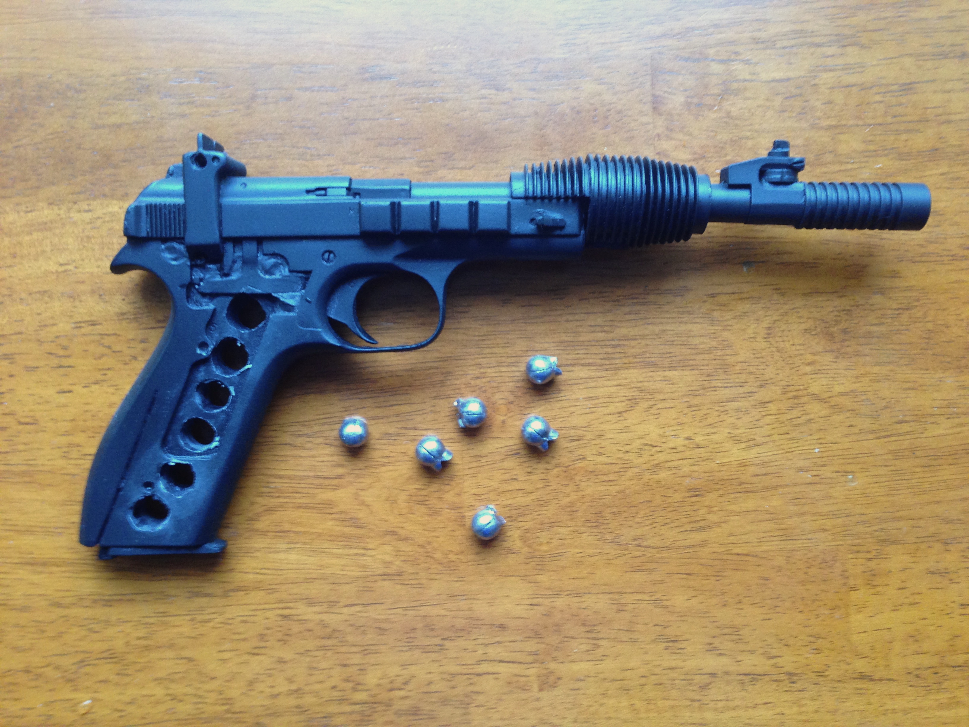

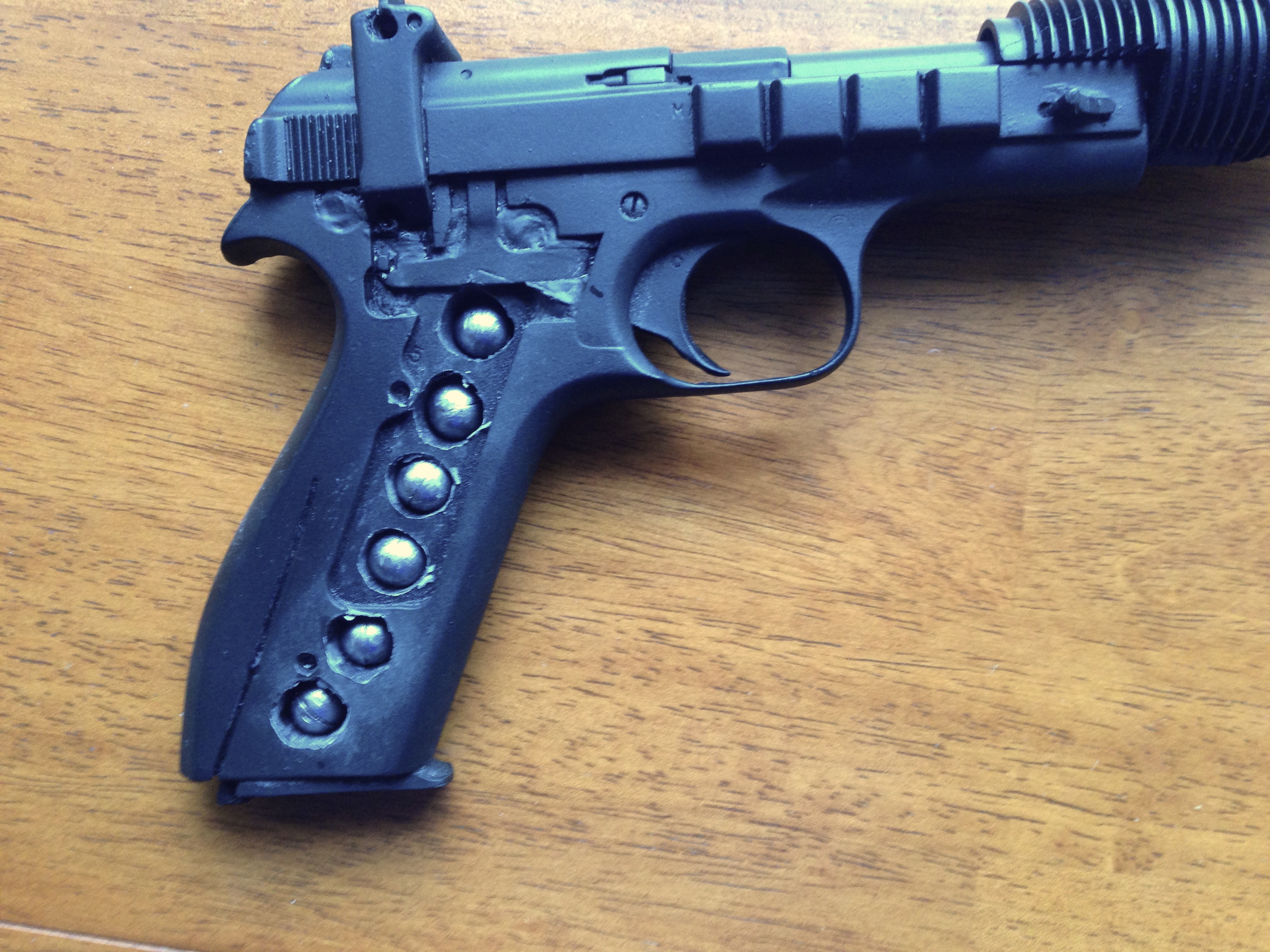

Wasn't sure if I was going to do this but I figured I might regret it if I did not... used fishing weights to the grip area. It added an additional 2oz. Sure help the overall balance with the added metal threaded rod inserted in the barrel.
They will be glued in place using silicon cement to keep from wiggling.
Re: LEIA ADDED! Blasters on the bench: Greedo, DL-18, GK, Droid, E-11, DH-17 more

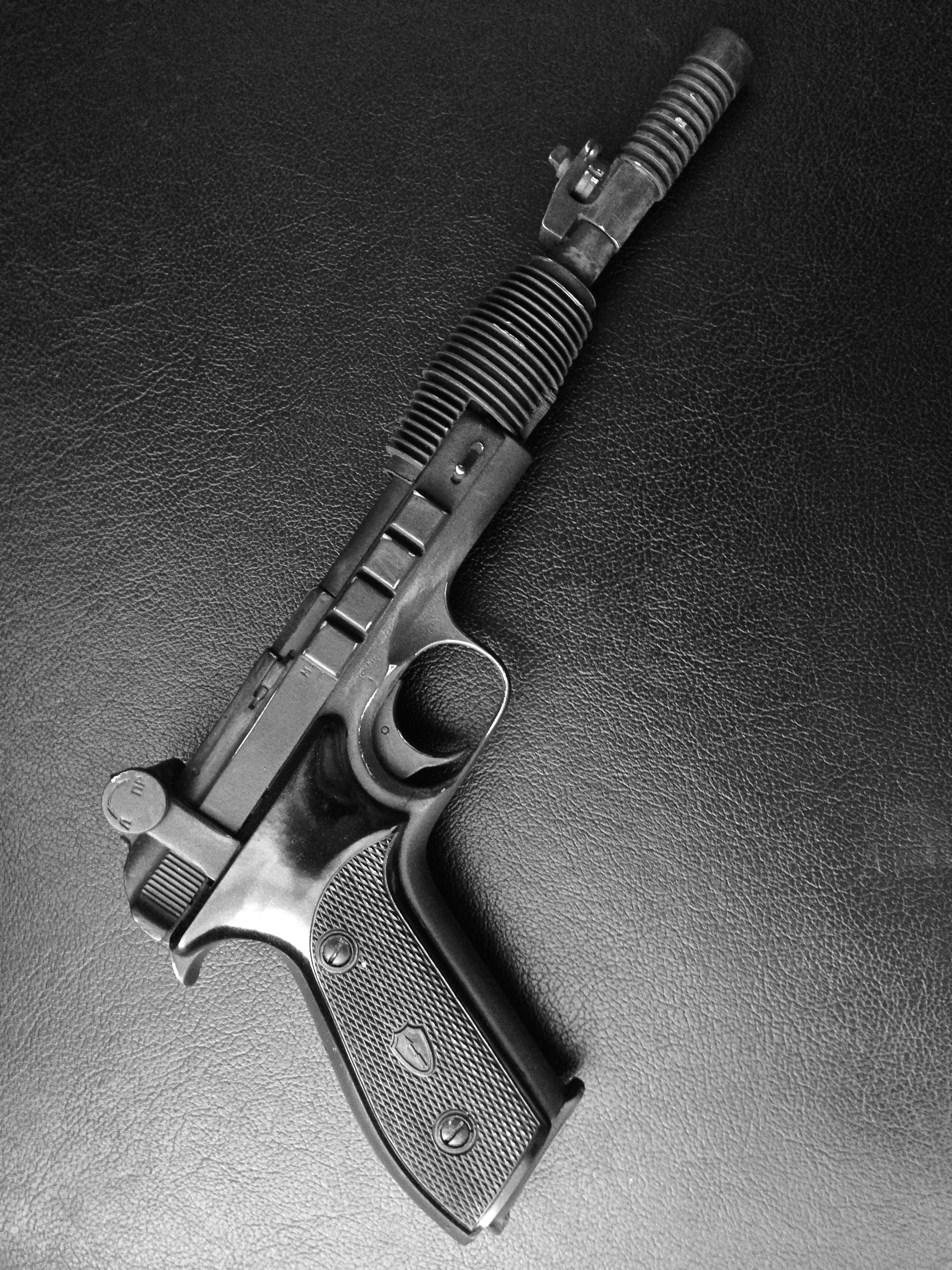

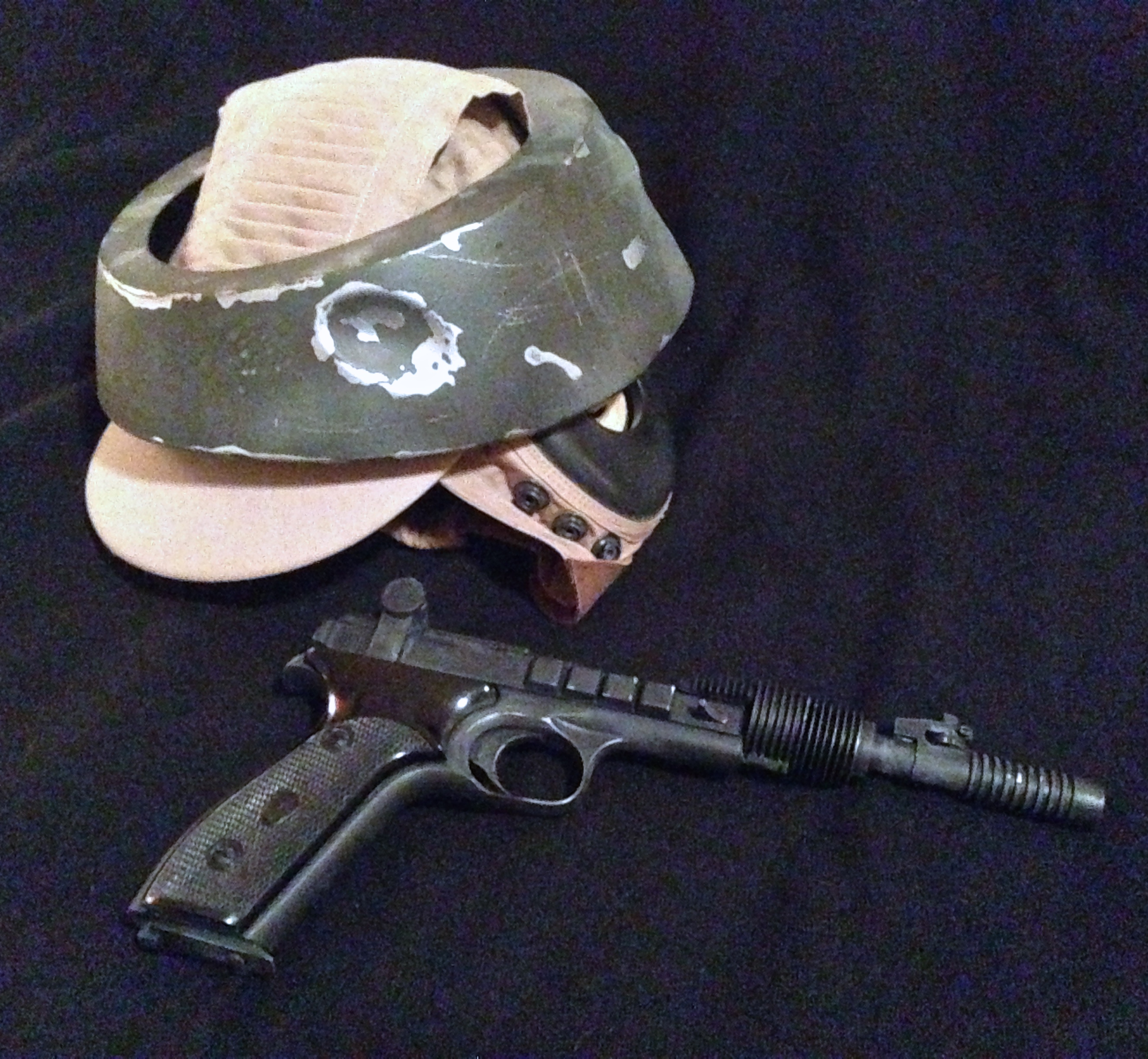

Ok, I'm calling it complete. I was not happy with the sterile look of a pristine blaster so I went weathered.
These pictures are crappy because it's nighttime and the house lighting does not do it justice... and the flash is even worse.
The kit was provided by @OdiWan72. He also provided a metal muzzle that was from an old @Boba Debt run.
Total weight: 13 ounces

Well done...love the paintjob!

Really happy with using graphite powder. Not only does it help sell a gunmetal look but since it is not straight black you can also apply a black wash over after it has been sealed. IMPO, the black wash is important on items that have been cast like this one or the Rubies. It helps add depth to areas that should be naturally deeper causing shadows. However due to casting limitations, those areas are shallow. By doing a black wash, the black settles into those tiny areas and creates faux shadowing. The added benefit is that you break up that monochromatic finish and accentuate the finer details. It's very subtle but I feel it does make a difference.
