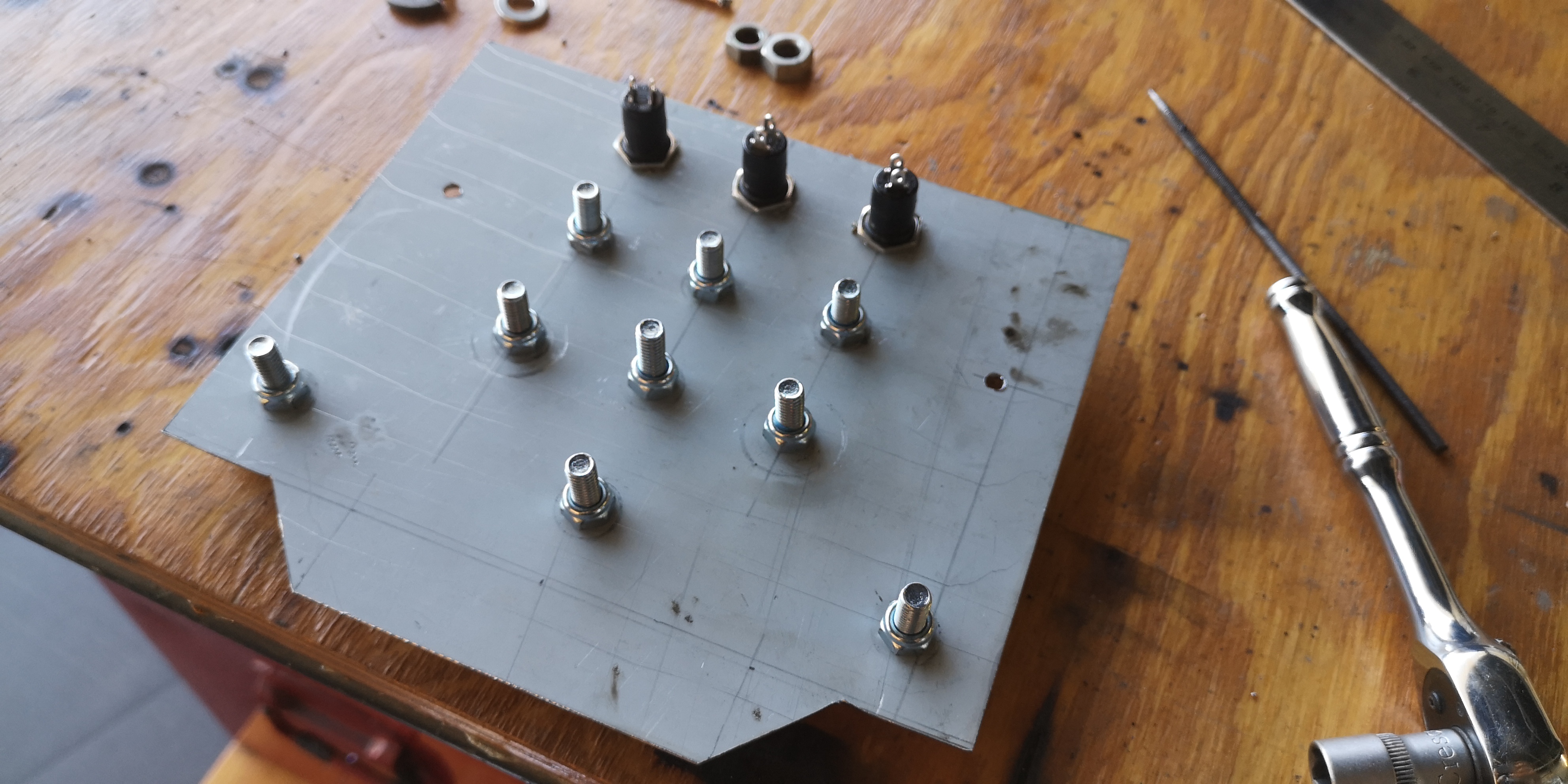

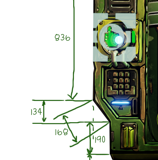

Also started on the front panel with the keypad, only just realised the scale of the keypad, standard size keypads / keyboard keys definitely won't be enough. Need to find something larger. To scale, width of 3 keys needs to be 110mm which is exactly double of the standard keys.

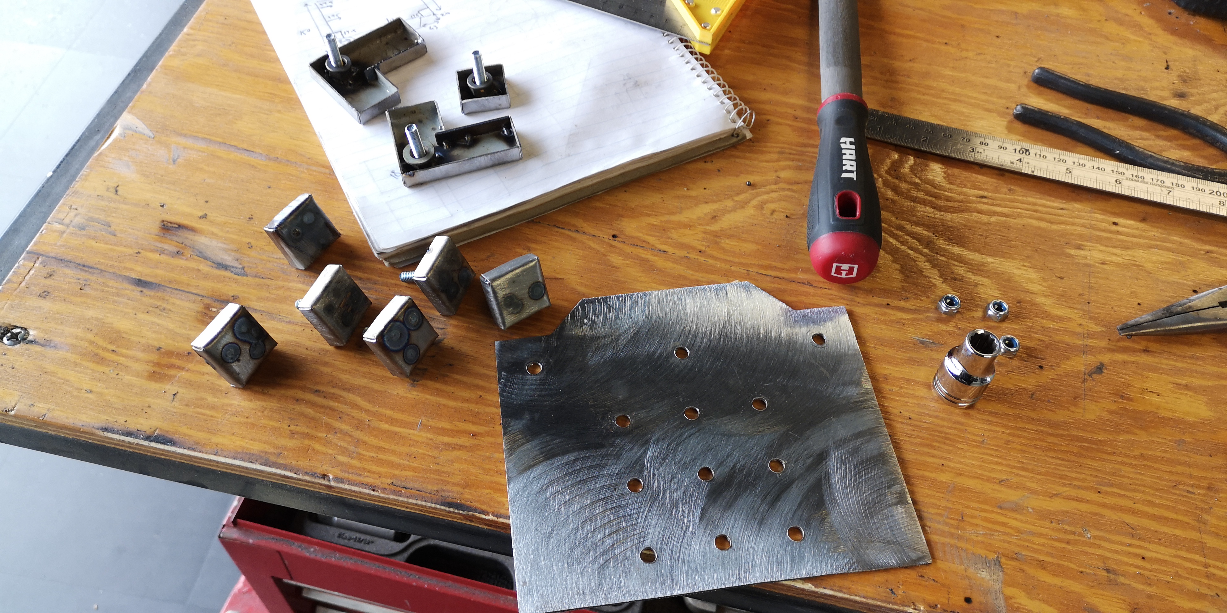

Have been looking all around trying to find a keypad with larger keys and figured I might as well just make them. it's only 10 plus two "enter" looking keys.
Using 1.2mm sheet, making them to scale so 25x25mm each with a 10mm gap. They look ridiculously oversized but that is all to scale anyway.
Thinking at this point I'll have 2 or 3 of them mounted on a switch of some sort so they can be used for whatever (so far I only need 1 to reverse the direction of the chain), but i'm sure a couple more on/off switches will be handy to have.

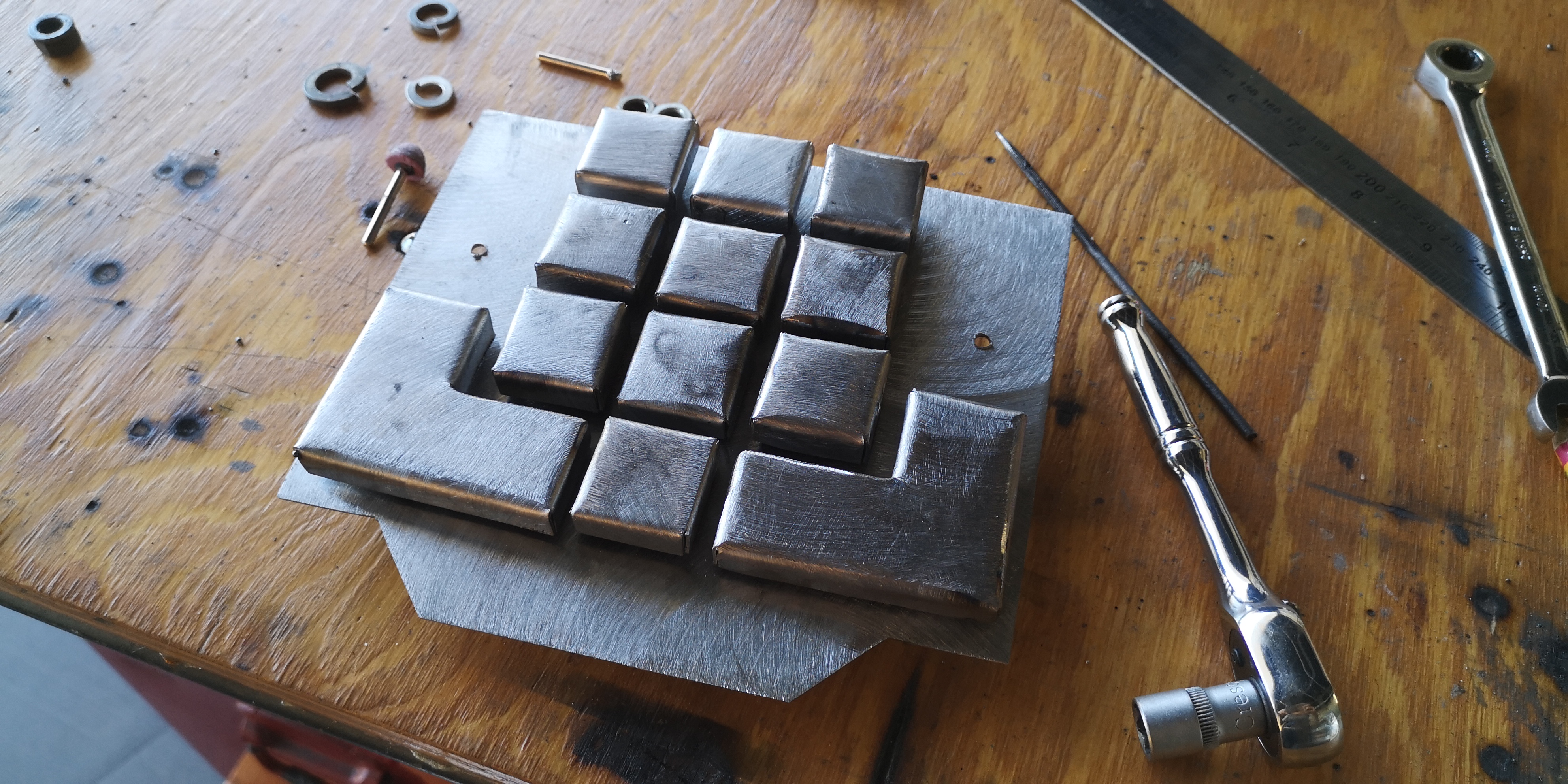

Made up 10 of the standard squard keys today:

Here is one of them against a standard keyboard key:
I love how chunky the switches are, they look hand-drawn already.

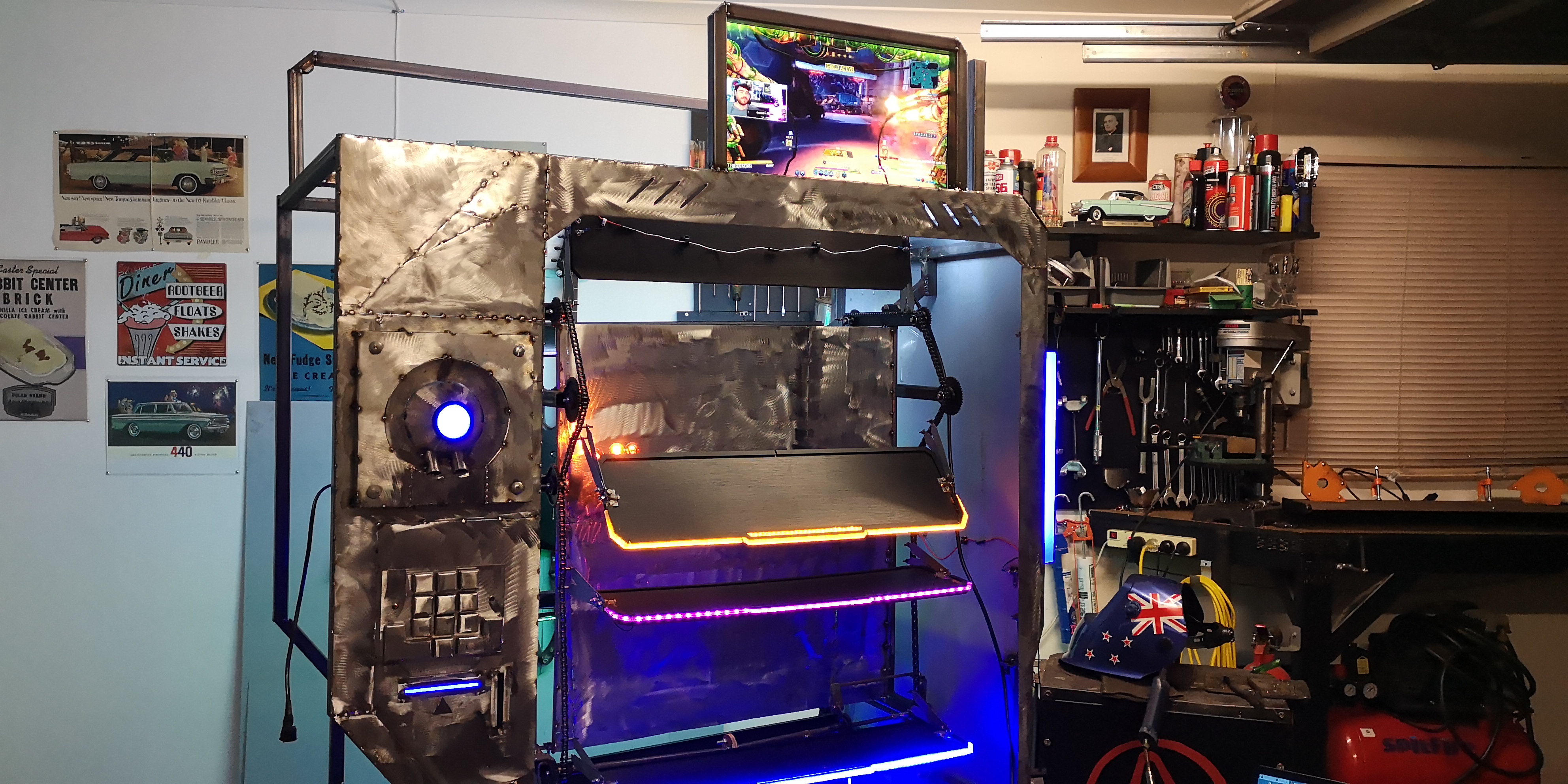

I got the feature shelf to work today. Pretty stoked. Such a small thing but man it definitely makes it look a lot more complete, in my eyes anyway.
The 3 lights in the corner are powered using an aftermarket brakelight module where you get 3 lights to light up in a sequence, and a Honda Civic flasher relay - although I did have to add a few extra caps to the relay so slow it down a bit. Still, pretty happy with how it turned out!
