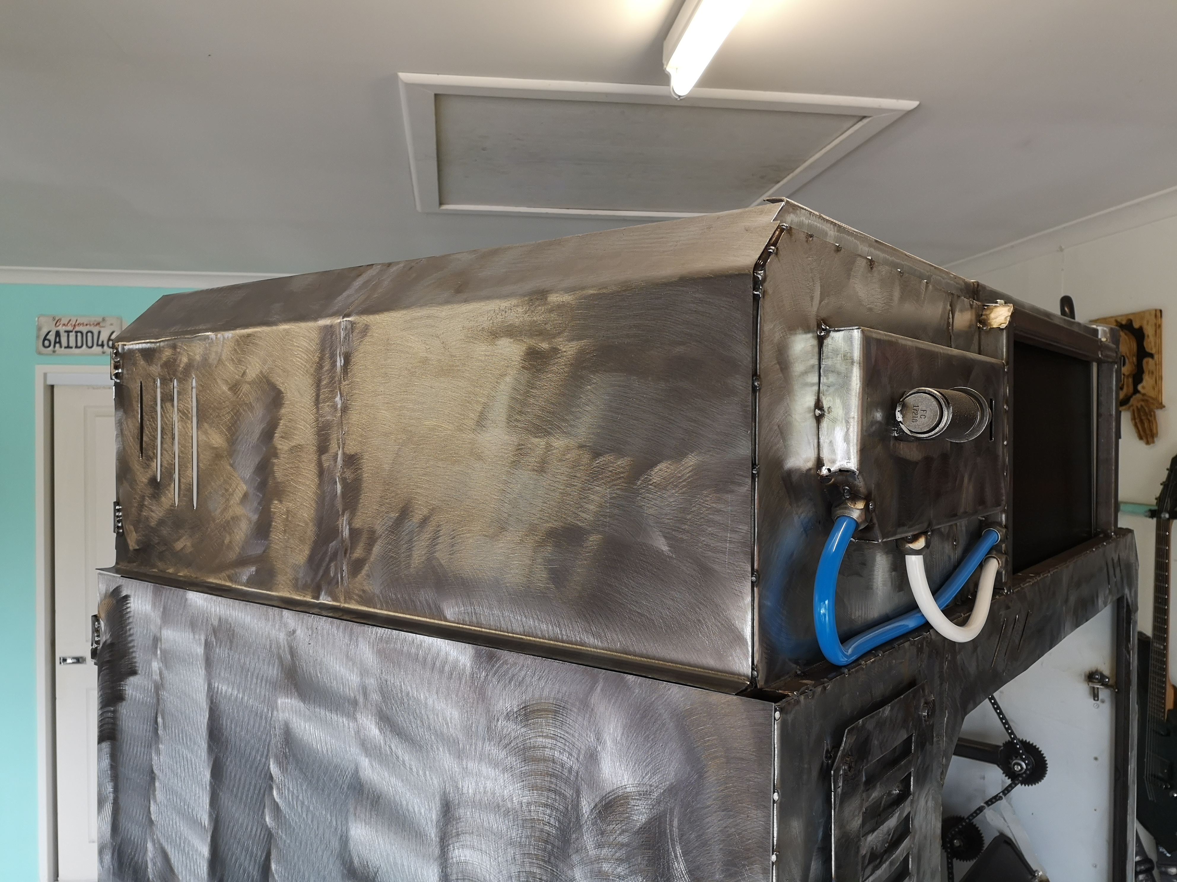

Have put some more work into the top panel today, keeping in mind that the panel has to be wider than the original since the screen on the right is narrower than the original.

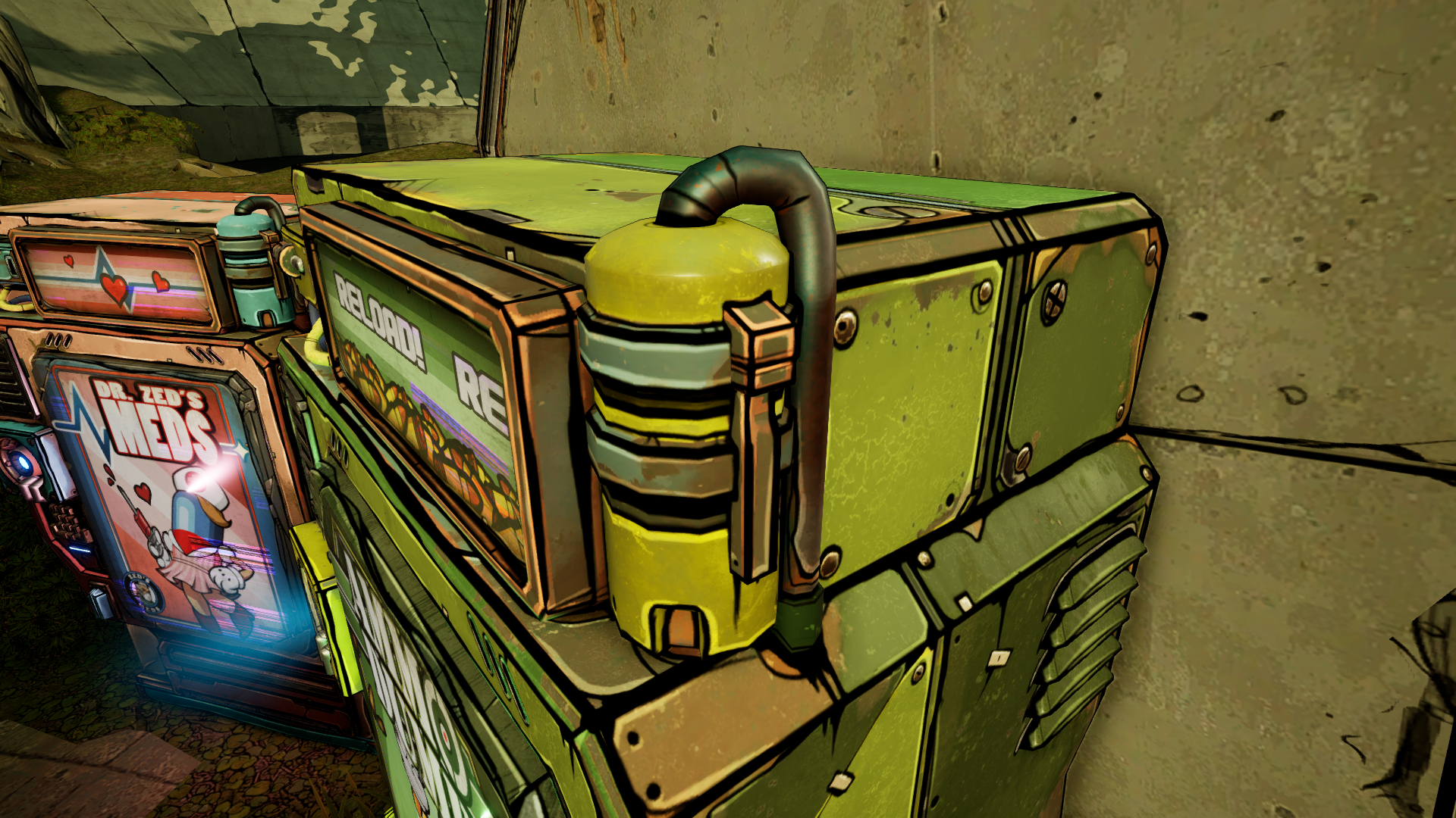

The "oil catch can" looking device is now done. The top part is getting very close to completion now.
The top part is definitely not as concave as I wanted but with the limited tools to do double curvature this is probably the best I can do at this point. Still I think it's ok for a small side piece.
It is amazing how much you are fabricating from scratch. I would have imagined using a small fire-extinguisher or propane container. But then it probably wouldn't fit in with the overall look.
Haha thanks dude, I actually had exactly the same idea about the fireextinguisher - I have 3 of them in the garage, and one is sized very close to what I needed - but that one my wife gave me for our wedding anniversary as a joke, I didnt have the heart to empty it out and chop it up so decided to make it from scratch.

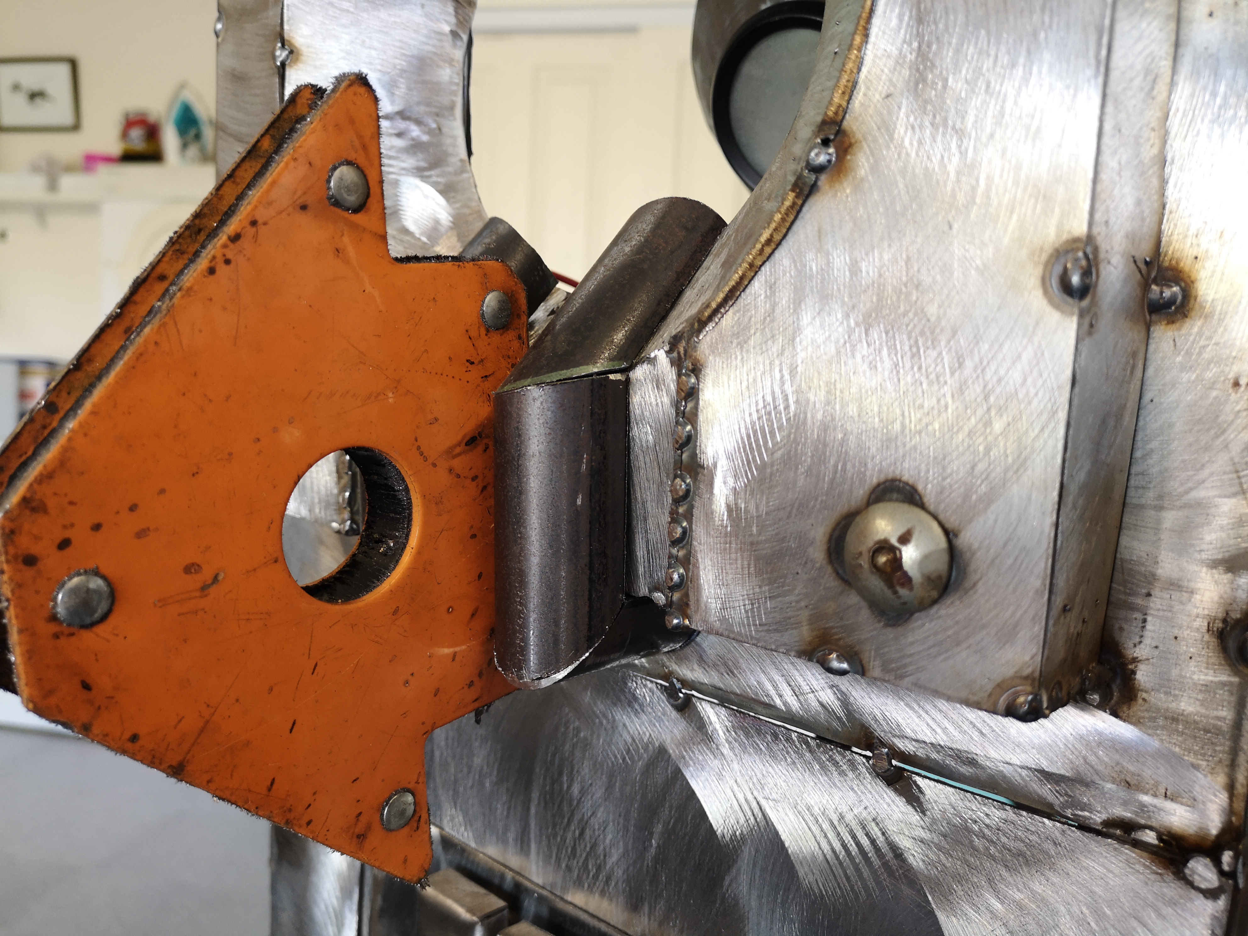

Today I've made up a panel and hinges on the left of the machine, also wired up an ignition switch on the panel to mimic what it looks like in game. Also welded up a small grate / vent that sits on the front panel.
The panel lined up pretty well, only had to take off a few mils off the back edge.

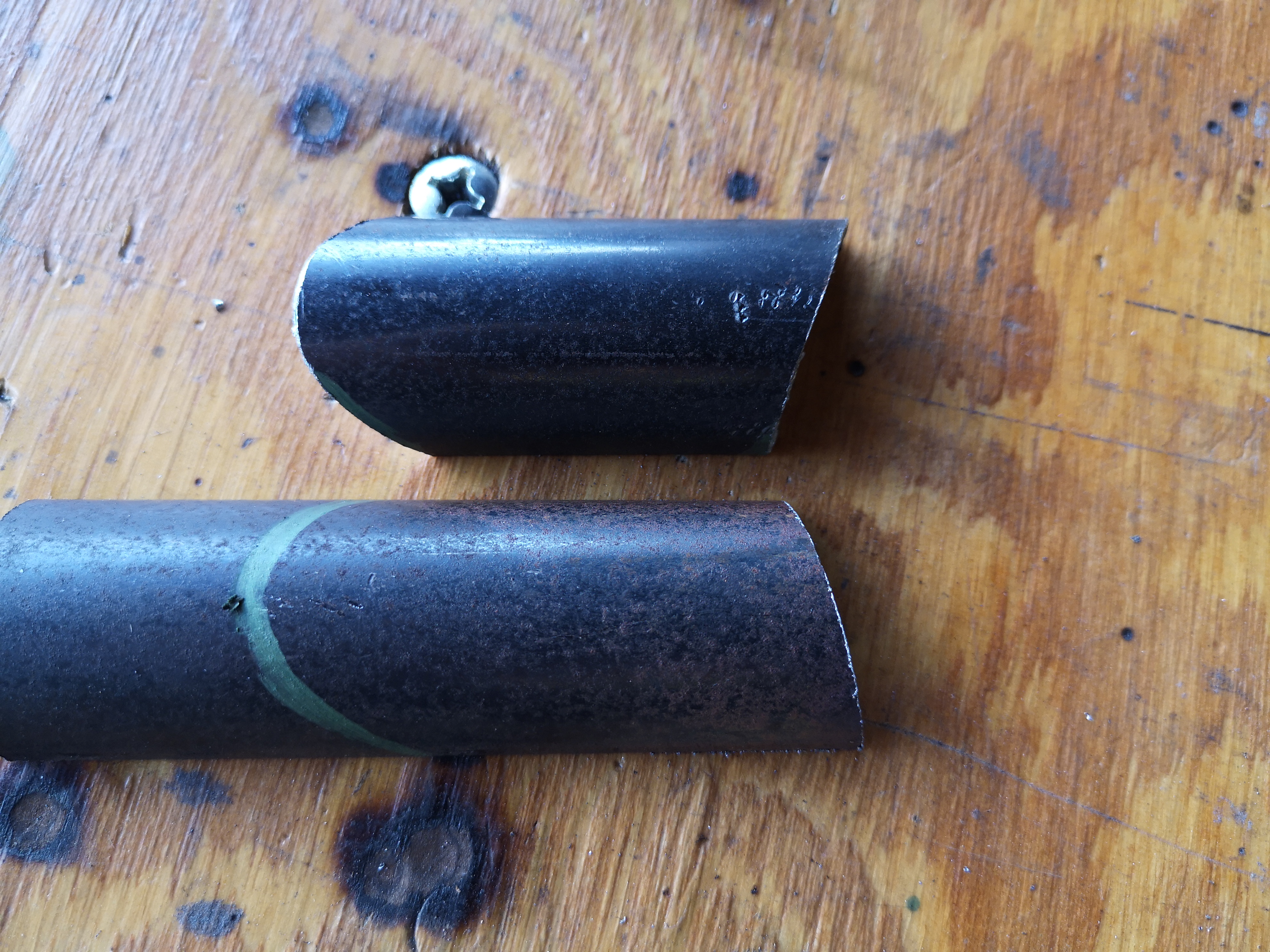

The hinges are done the same way as all the other ones on here - 3mm plate wrapped around cut down bolts. Seems to work great and is pretty quick to make.

Good job on the hinges, that is actually a pretty common technique for making basic hinges.
Oh really haha awesome. I had no idea. I really should start searching things before attempting them, would probably save a ton of time. Although something about just going for it and seeing what happens. Definitely not the most effective way but this is more just for fun anyway.

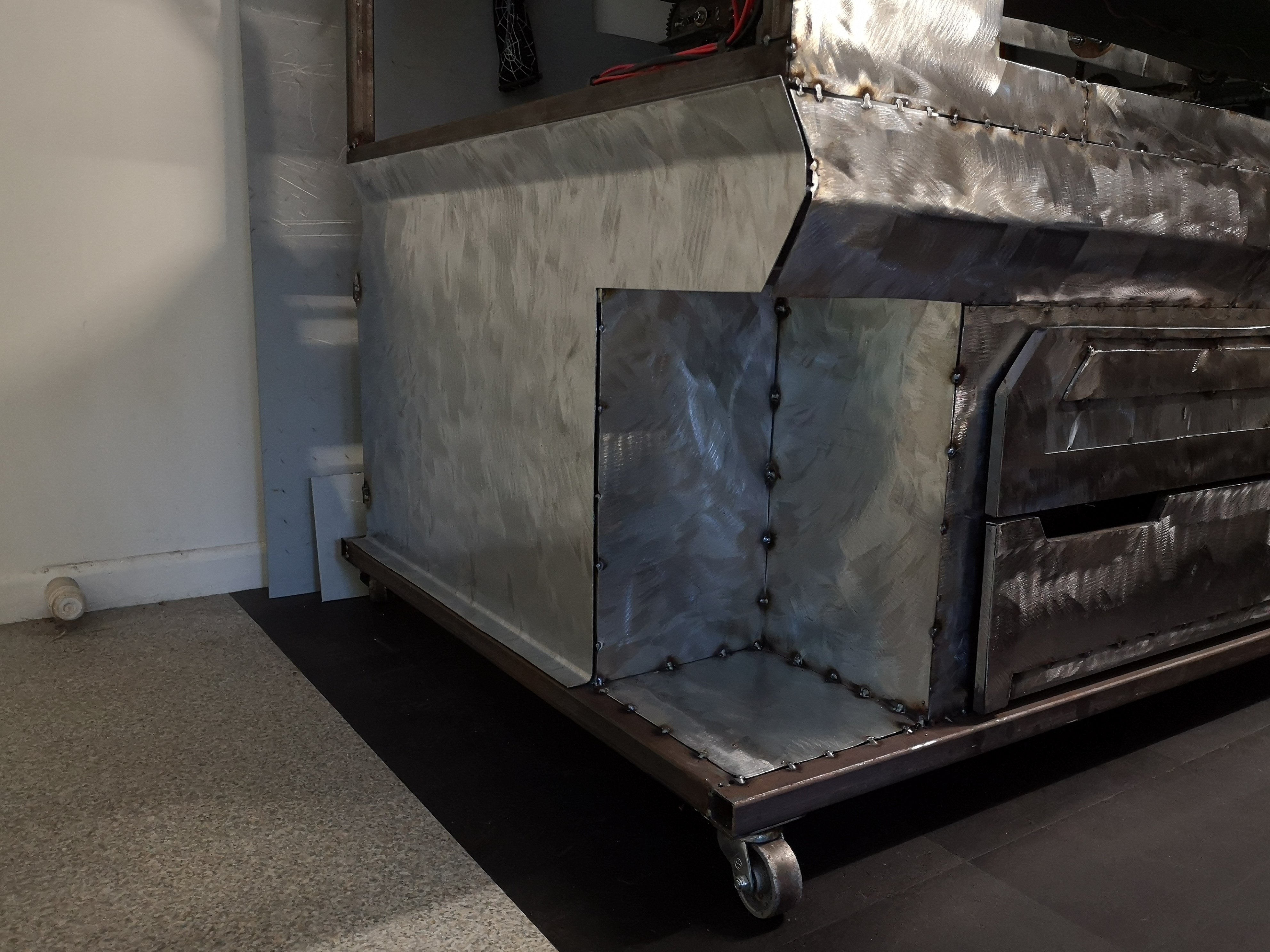

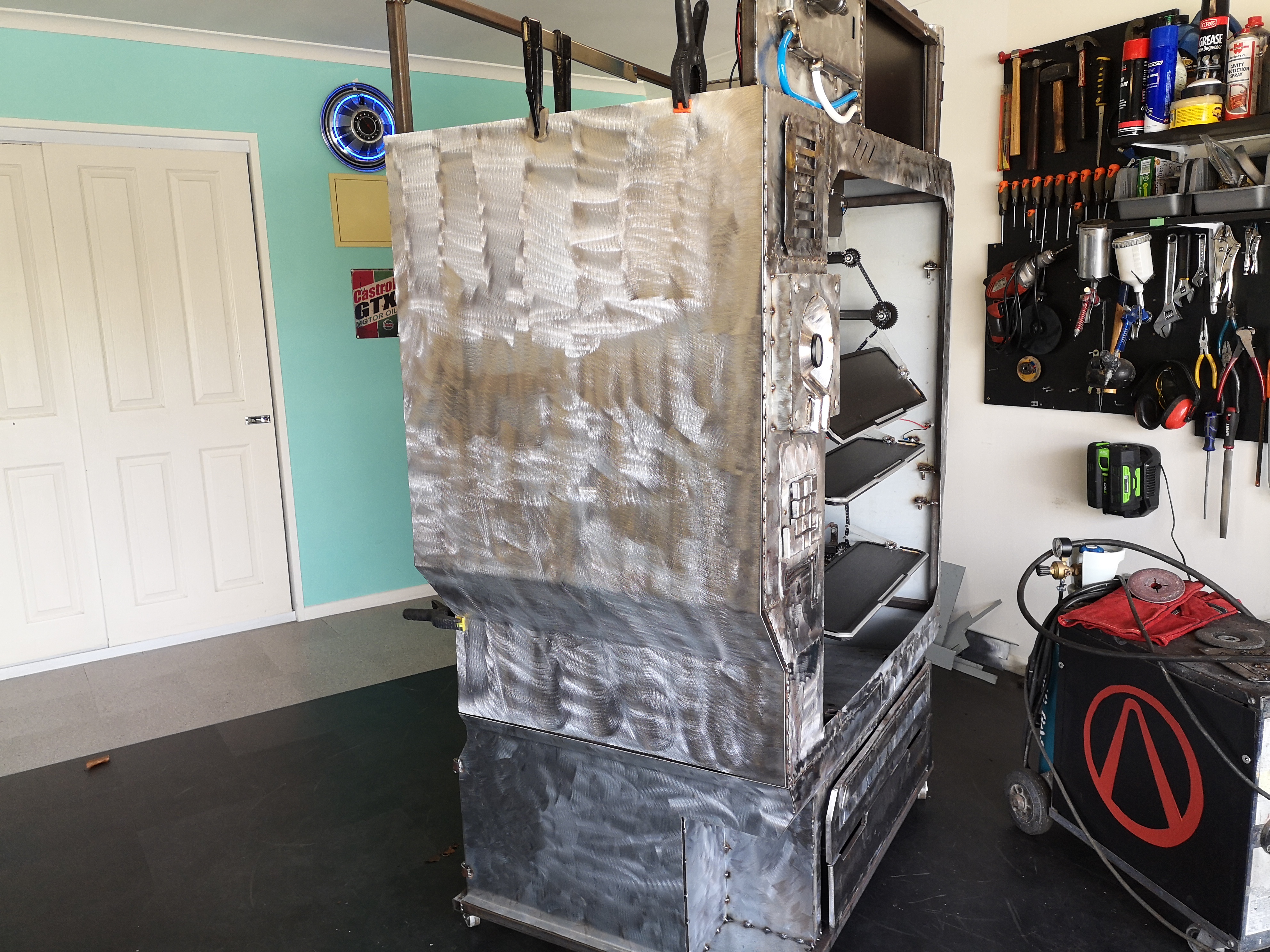

Finished off the left panel today, looks much better with the left hand side completely covered now.
Also the cardreader - I was initially going to buy one but none are anywhere the right dimentions or shape so since I've been making everything, figured might as well make a cardreader too. It's got a pushbutton switch at the base so if you slide a card down across the back wall the switch engages and it'll all feed into the mp3 player that I've got coming that will be loaded up with Marcus's sound bytes.
Only the "roof" and the back panels are left - Ive pretty much run out of sheet steel, so as soon as this current lockdown ends I'll be off to my steel guy's place to get another full sized sheet. And then only one decorative item in the bottom left corner and another small bit that I have to complete. Very close to completion now.
And I have decided against painting it. The finish I have here will look absolutely horrendous painted, so I think just raw steel - some early panels haven't rusted in 2 years like this, so I am relatively confident it can sit here for another 10 years as a prop without major issues. And if I need to strip it and sandblast it every decade to keep it fresh - thats not too bad.
