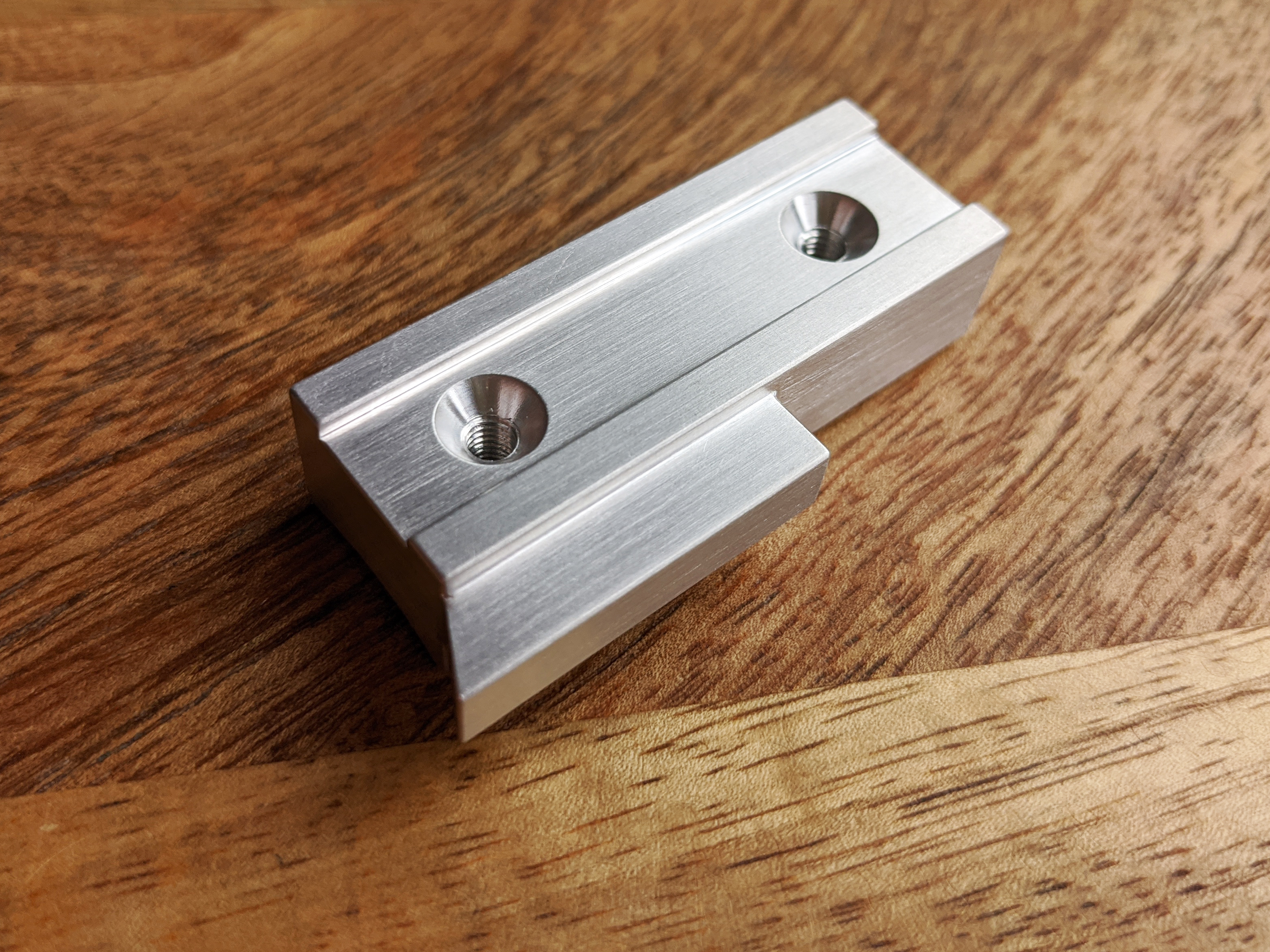

If anyone ends up with an extra hero box, just the box part, and wants to sell it let me know. Broke a drill bit off in the tiny hole trying to drill it deeper...having terrible luck with my build, lol.
Oh crap! that sucks! Is there any of it protruding that you could grab with a pair of snips/scissors? If not, maybe you could grind the screw down, and glue the head in place? Sorry you're having bad luck with it. Hope the rest of the build goes more smoothly for you!
Afraid not, it was already super low in the hosing so no room to really drill it out. I debated cutting the screw down but I dont trust myself since there isnt a lot to grab on to...afraid itll go flying. If I can find another I might just try and hand file them down vs drill the box. WORST case I just go ISYHCALS instead of hero if I have to.
Its all me though, this is by far the best run ive ever been on in terms of your communication, attention to accuracy, and quality of parts. Too much pressure on myself to do it perfect which usually means mistakes, lol.
Just an idea, but could you maybe screw in to the plate and then file down the screw from the other side? They're so small, maybe a pair of snips could sheer the head off? I've sent you a spare set of screws in the mail anyway, so they should be with you soon hopefully. Good luck! (y)
Hey Dave, is it that the body of the screw is too wide? So the hole needs to be made wider? or the screws are too long?
I thought they just screw into the void space of the box?
Am i missing something?
I don't know if it's that the holes aren't deep enough, or that they just weren't tapped deep enough? I couldn't get the screws to go in as far as I'd like personally. I found that drilling the hole a little deeper fixed it. It was a fraction of a mm, but I just found that they were a little too proud of the plate when screwed in as far as they'd go. The holes are bellow the bottom of the inside of the box, so go in to solid aluminium.

Hi everyone. Just a little heads up. The small emitter grub screw is proving a little tight for some people. Mine went in ok, but it was certainly a tight fit. The hole is 2.3mm and the grub screw is an M2.5, so it *should* self tap. A couple of people have reported having difficulty though, so you may want to loosen the hole up slightly with a 2.3mm (or maybe even a 2.4mm) drill bit before screwing it in.
Just something to bare in mind. Sorry if this is an inconvenience to anyone. It's something I'll take in to consideration for the next run.
Cheers,
Dave
No issues for me with the grub screw, and I just tapped the 8-32 one. Im having a bit of trouble getting my triangle ring completely closed though. Ive tried hammering it against wood but I dont want to go heavy and deform it.
