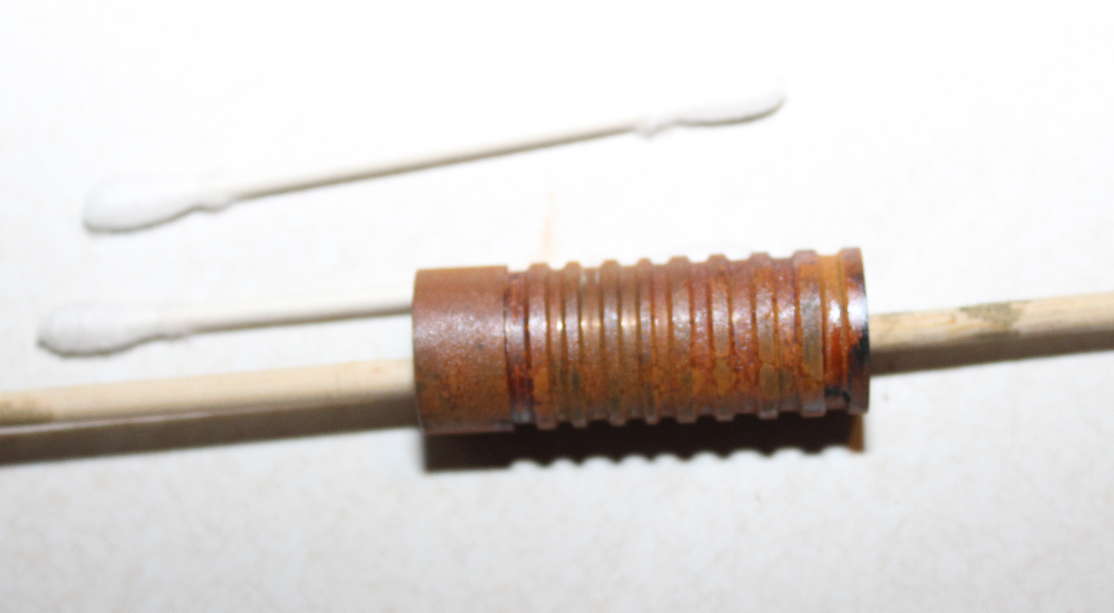

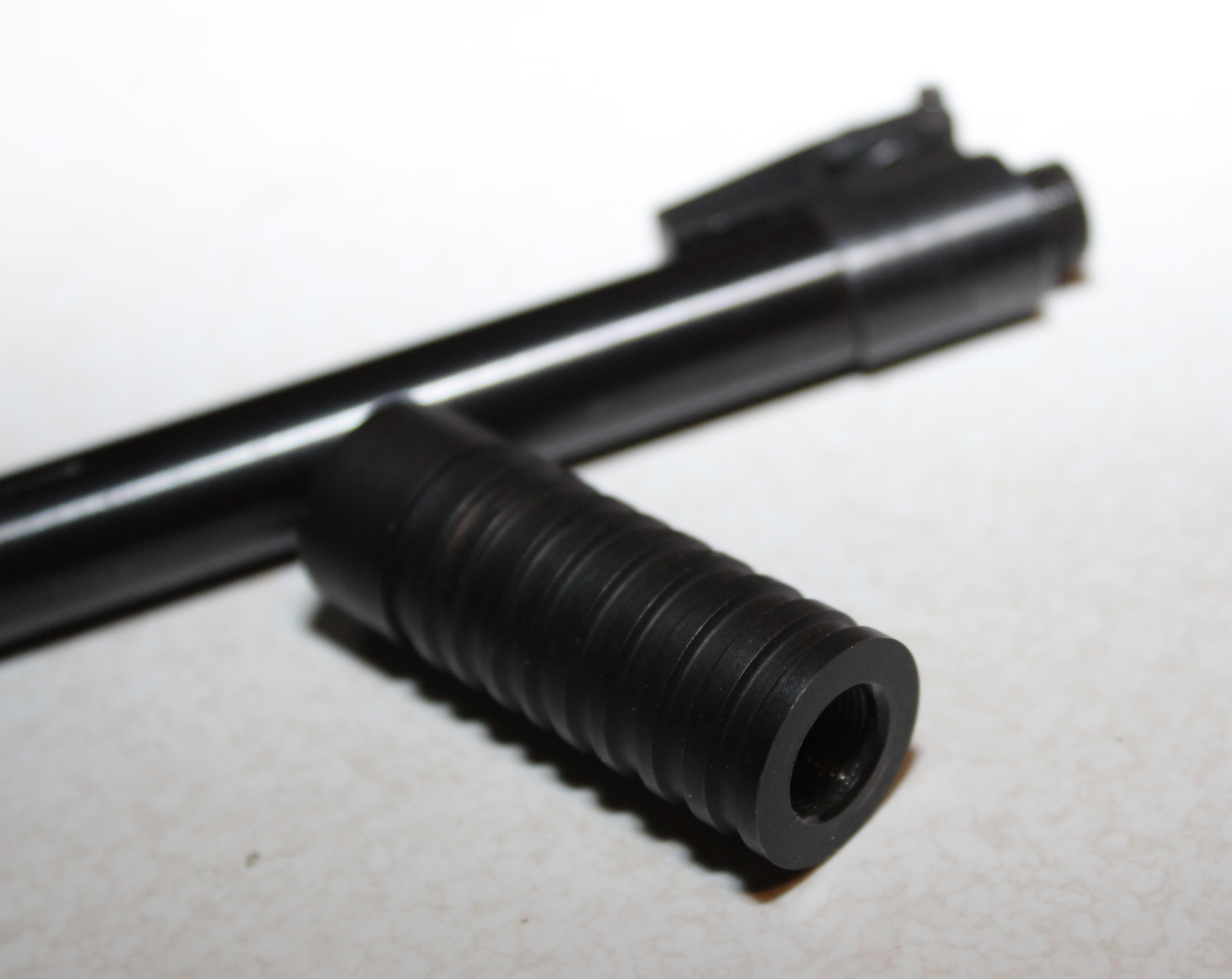

Sure! First I soaked the flash hider in acetone to remove any oils (and also soaked some 00 steel wool for the same reason). It's important to use clean nitrile gloves during each step to avoid contaminating the metal with any oils or dirt.
I used Brownells rust blue solution and applied the first thin coat with cotton swabs. For the first rust cycle only, wait one hour and then reapply.
After a reddish orange rust develops, place the piece into boiling water for 20-30 minutes. Remove from boiling water and flash dry with heat gun or hair dryer in order to prevent water spots.
There will be a thin coat of black oxide "velvet" that will need to be lightly carded off using the de-greased 00 steel wool.
Keep repeating the whole process (minus the 1 hour reapplication) until you achieve the desired finish. When final coat was done, I sprayed it with WD-40 to remove all water and chemically bond the oxide coating. Then I wrapped the flash hider in tin foil to soak with WD-40 overnight. The next day, I wiped it down and applied gun oil to seal the finish.
This was my first time using rust blue. I wanted a durable finish that resists gun solvents, oils, etc. in case I decide to use this flash hider on a live-fire Margolin. A side note: I also rust blued a Margolin barrel afterwards and achieved a deeper finish by preparing the metal beforehand with 00 steel wool before applying the first coat of rust blue.

That's awesome, thank you for the great step by step!

Wow super impressive and great workflow!
