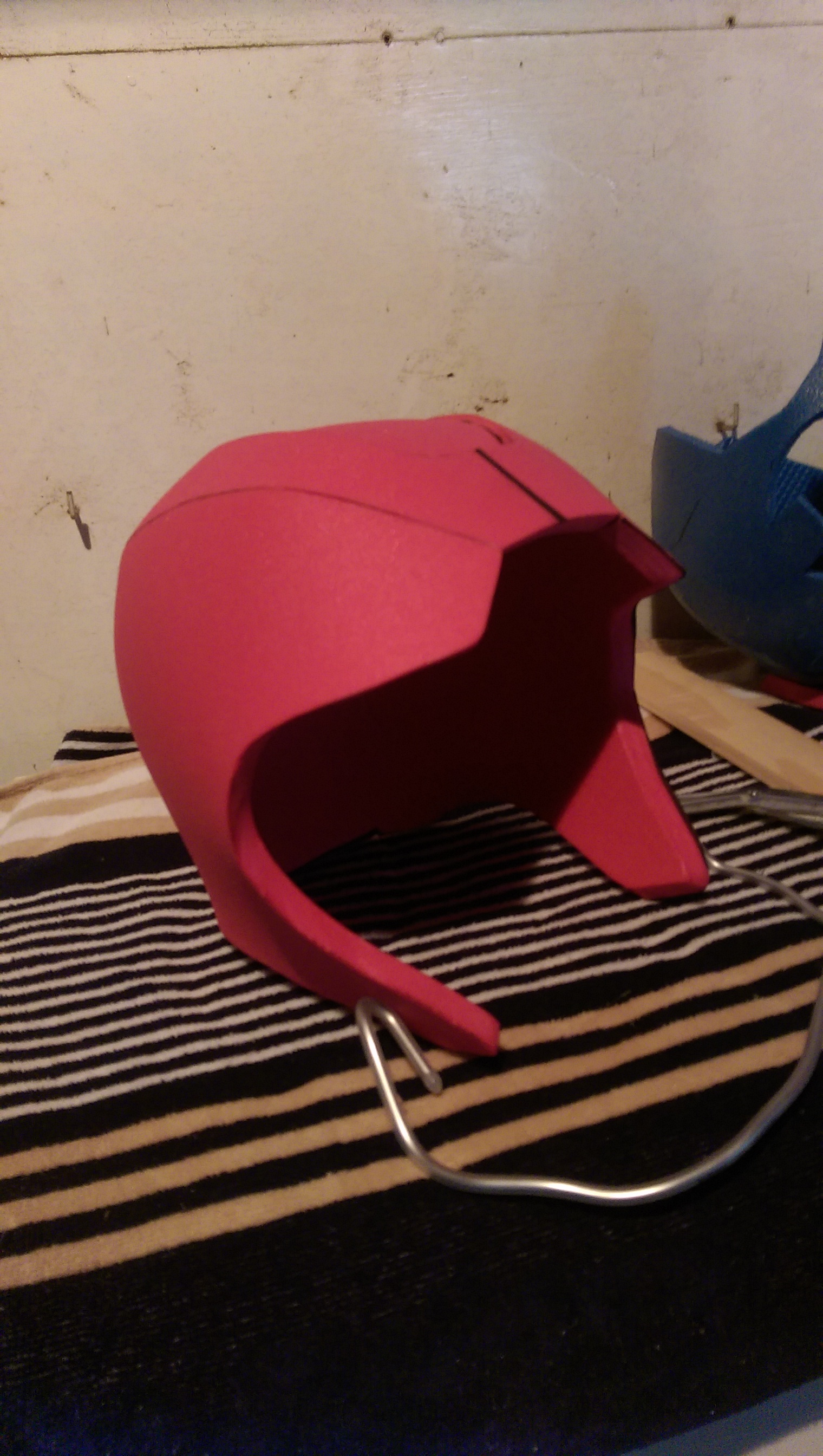

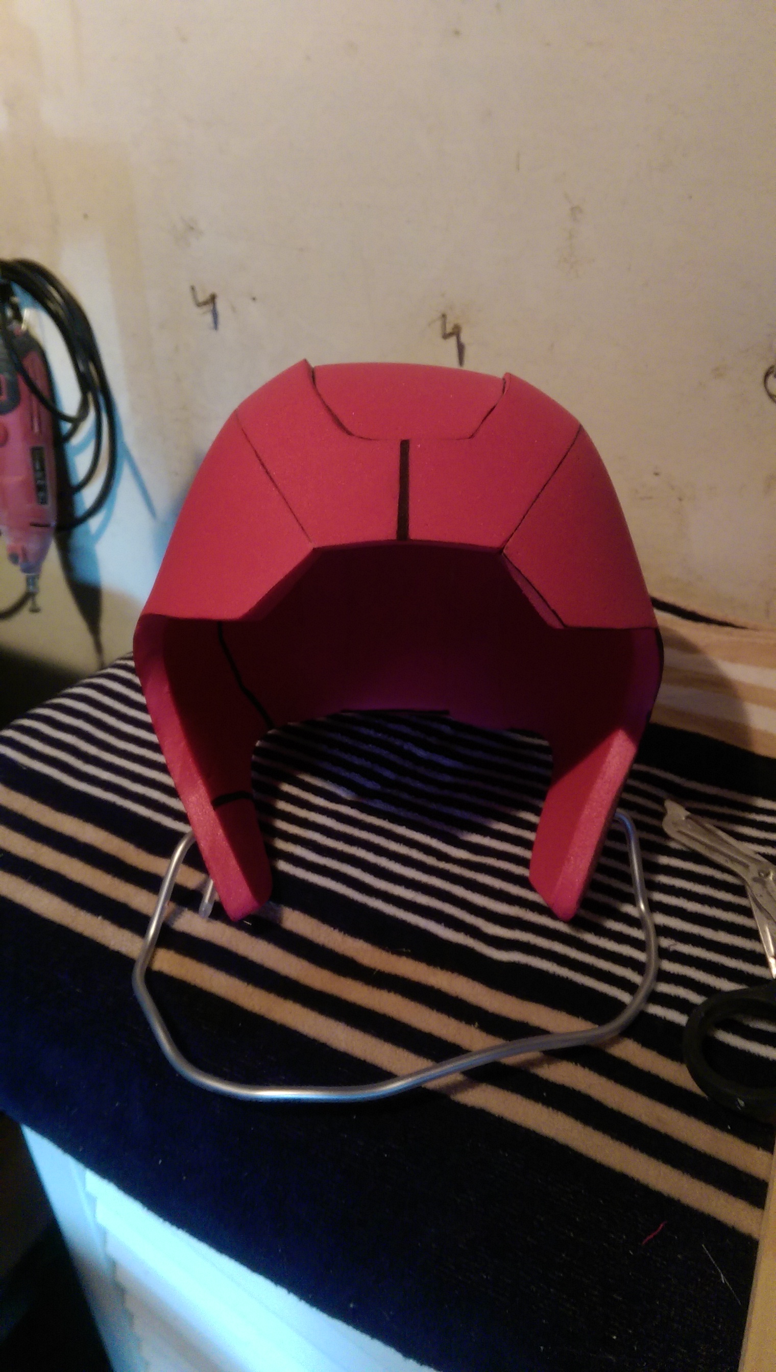

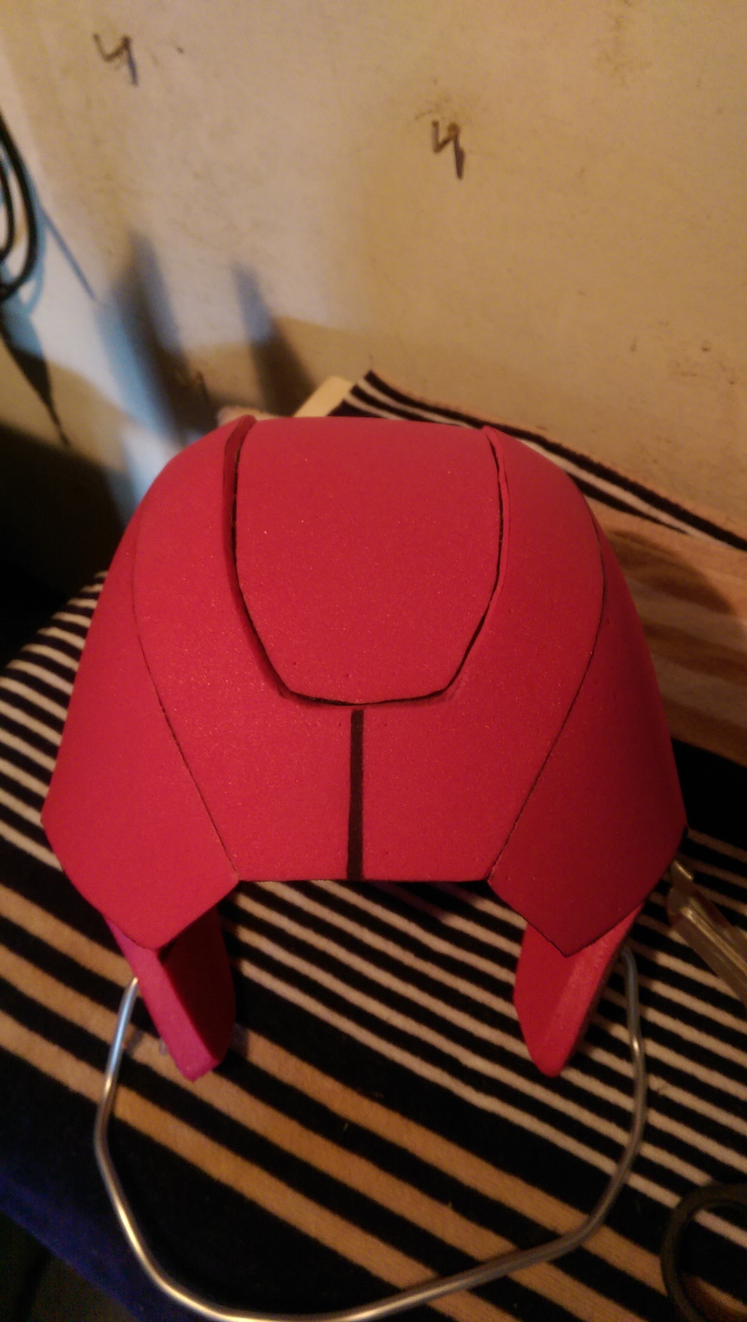

For my first build I have managed to build all the costume parts and the foam structure for the helmet from my avatar,but since the foam came from a roll,the foam was pre-curved.
The two flaps you see sticking out at the top of the helmet have a slight outward angle.I intend to use the airgun to correct the flaps to make them symmetrical (and in doing so,undoing the 'roll-curve').
From what I've understood the 6mm thick foam needs to be heated quite some time (?) in orde to become flexible and the same goes for cooling off.How do I fixate the foam flaps under a slight angle so that it can cool off without me having to hold these flaps for 30 minutes or more? Like I said, the helmet is already assembled (beginner's mistake?),so I need to be careful not to affect the rest of the helmet.
Thank you so much for your comment(s).
Awesome to hear some progress on your Beetle. I like using clothes or blankets to prop my foam up on. That way, I don't have my warm foam getting dented on hard angles while it cools. Especially on helmets that need to be narrower than the foam would naturally curve it, I stack up some blankets on each side and trap it in between them while it cools.
I don't know the specific foam you have access to over there, but you shouldn't have to heat it up for very long, and shouldn't need to wait very long for it to cool. Both heating and cooling time shouldn't be more than a few minutes altogether. In all but a few instances, you can quickly do it while holding it and don't need to leave it sit.
As far as not letting the heat affect the rest of the foam around it, I like to use a piece of cardboard in one hand to block the hot air from hitting part of the foam, or you could just cut a hole in the cardboard to let the flap stick up through and blast it with hot air. Hope that fits for what you're describing.

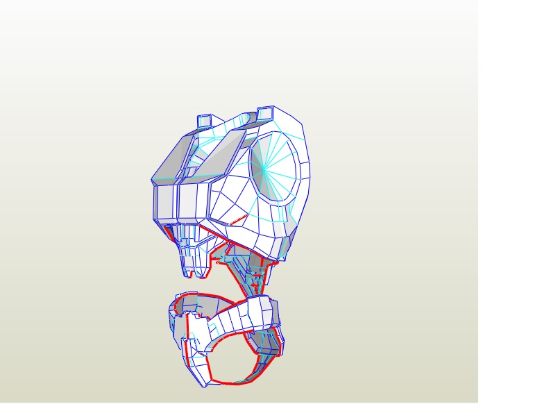

Im working on the mk6 codpiece but there is some lines that stop like this
what should i do should i change the line angles to make them join there or expand the line until they reach each other like this ?

what should i do should i change the line angles to make them join there or expand the line until they reach each other like this ? http://uploads.tapatalk-cdn.com/20160229/921488cc21c59da78c58c772d7d9a529.jpg thank for your help guys
If you change the angle to come together right there, you'll have a shorter seam, which is nice, but the foam won't curve gradually. It'll have a sharper curve right at the end of that piece of foam. If you extend the lines on the angle they're going, you'll have a more gradual curve in the foam, but you'll have a nice long seam, which is the bane of nice looking foam costumes.
Depends on what you like. I personally always go for a nice long seam :) and then spend unnecessary amounts of time smoothing it out.
