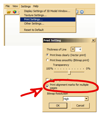

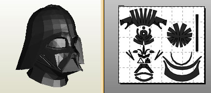

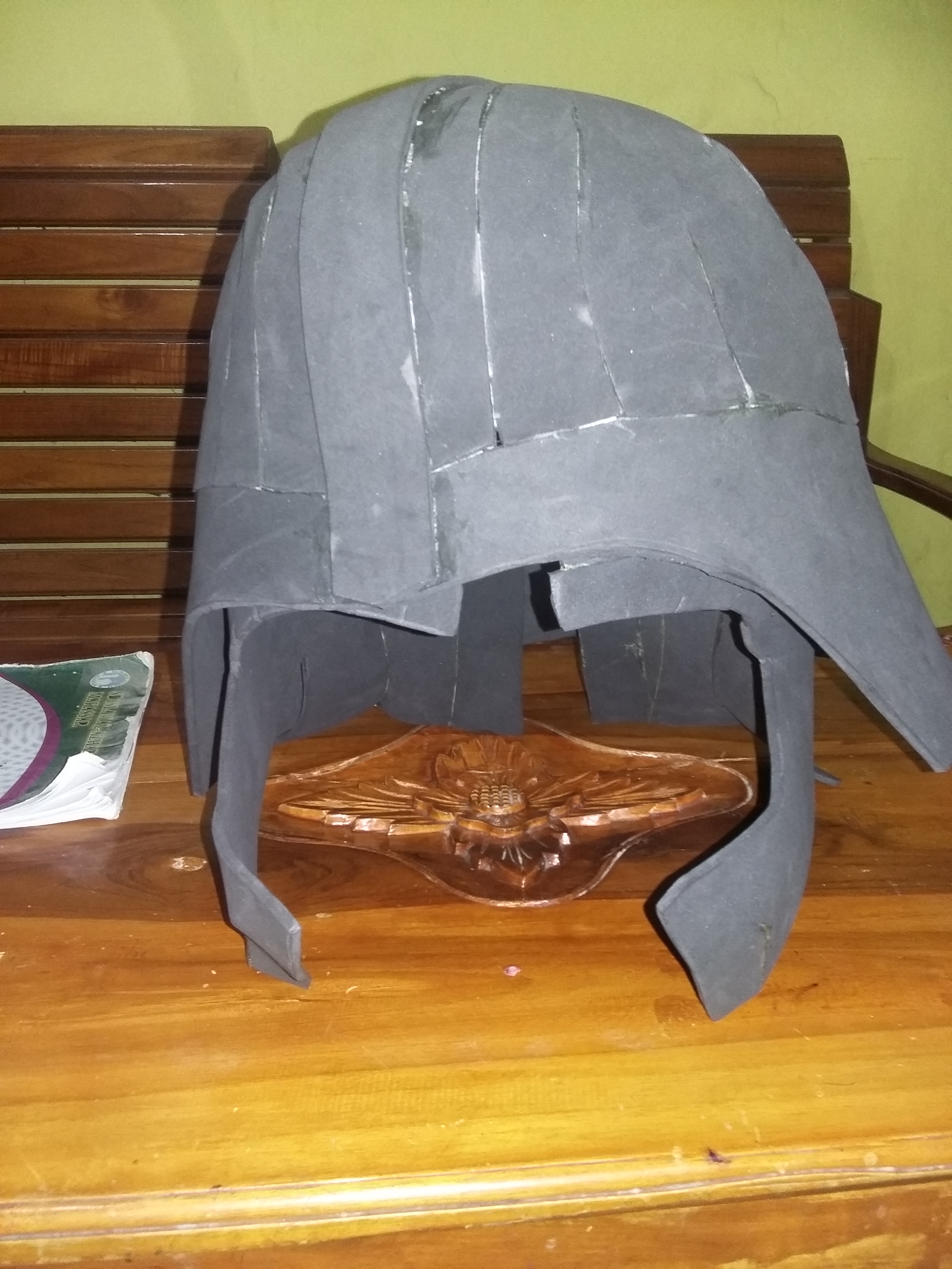

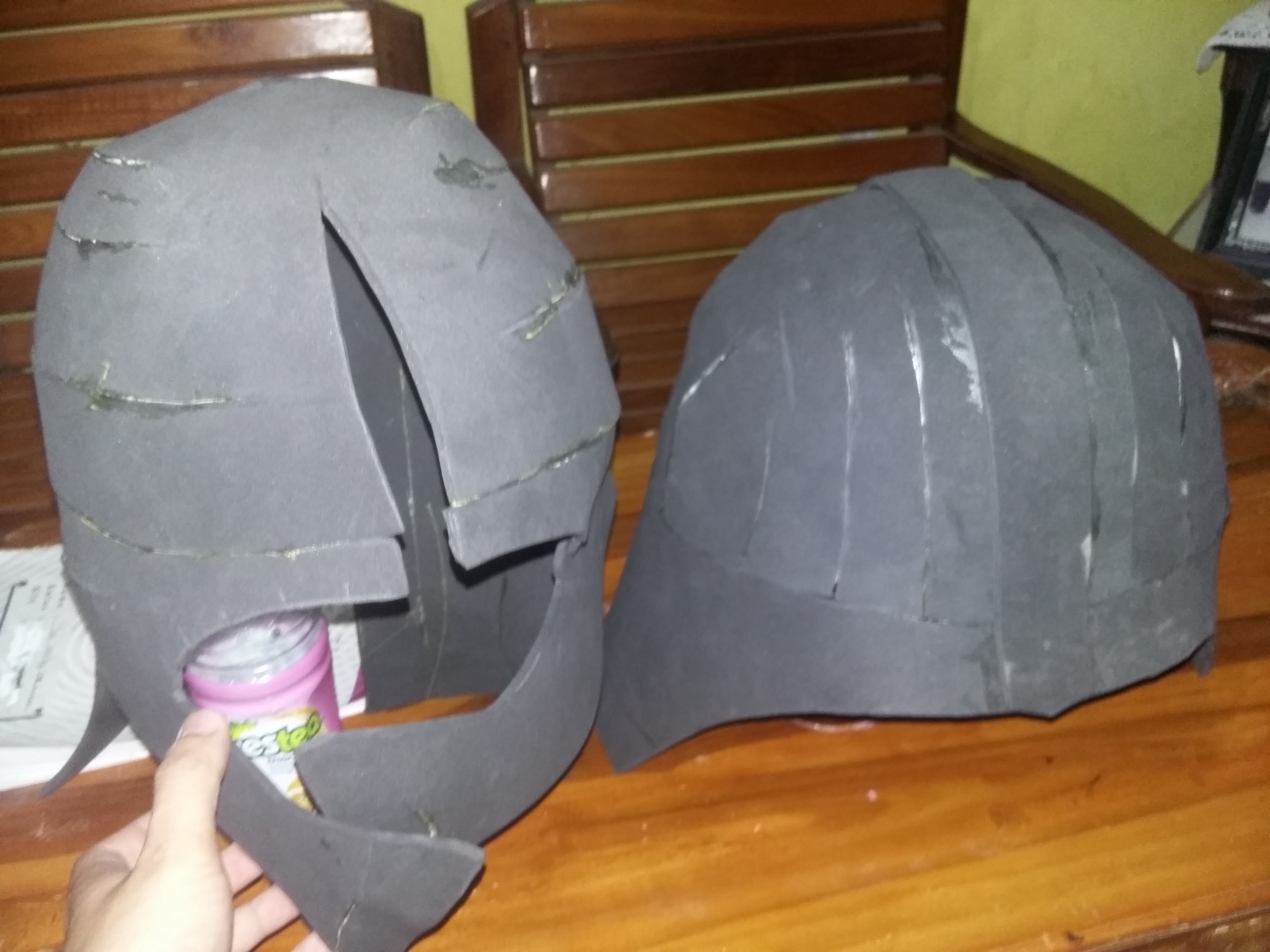

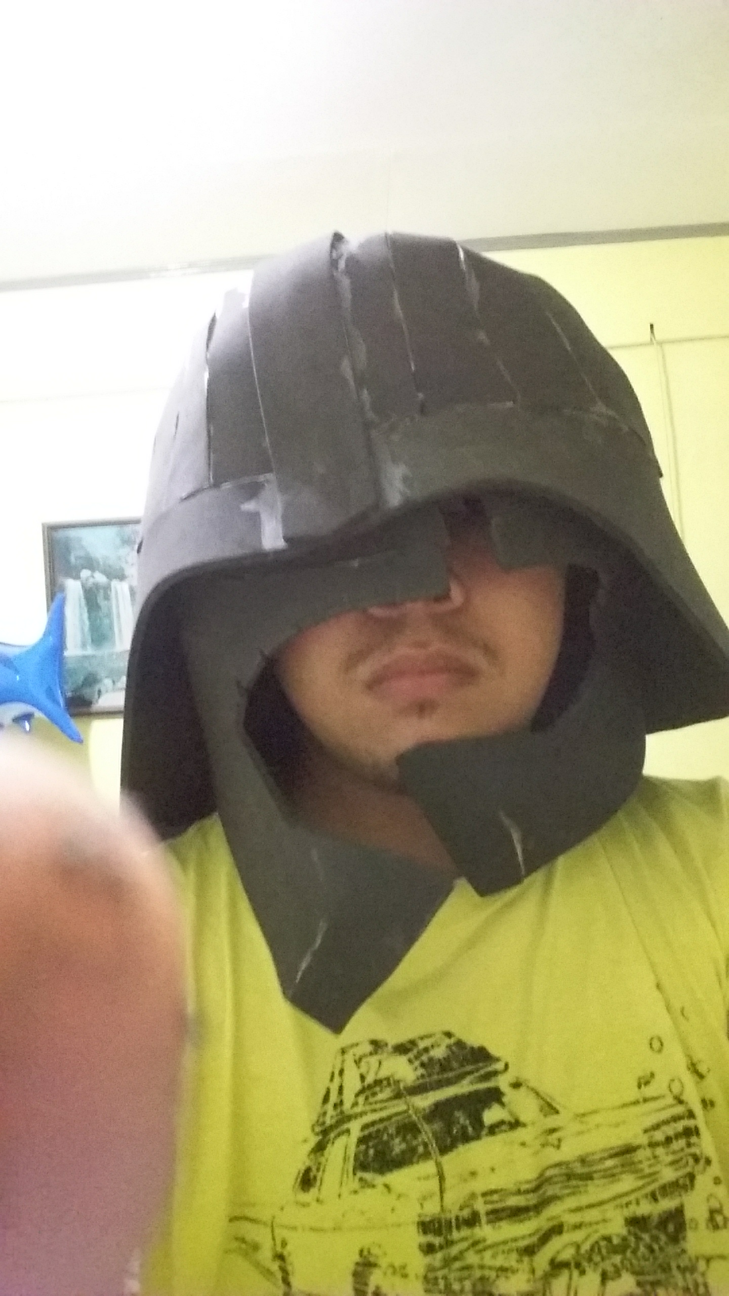

Hi, my name is Imran. I'm From Makassar (Indonesia). Now, I'm making Darth Vader helmet from your Pepakura pattern. But, when i make it, the helmet is bigger than my head. (I was print from your file pepakura) So, how to scale that helmet can accordance with the size of my head? Thank You :)
Howto :
http://www.wintershade.com/therpf/printalignmentmarks.gif
After having ticked "print alignment marks for multiple pages" in "setting / print setting", you can print your pages. Then, cut away the top and left margins of each of them, and then tape all of them together to obtain a laaarge single page.

http://www.wintershade.com/therpf/darkvader.jpg
Dark Vader helmet - foam unfold JFcustom.pdo

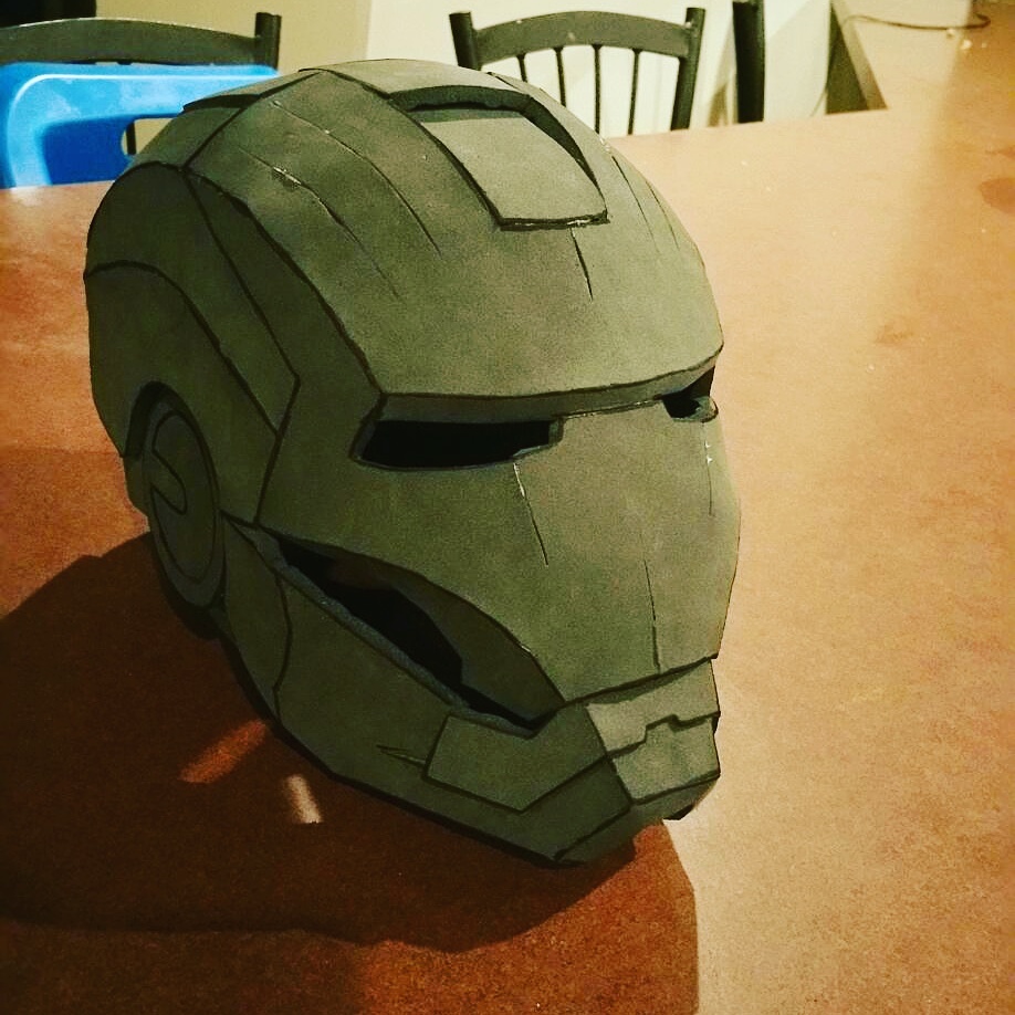

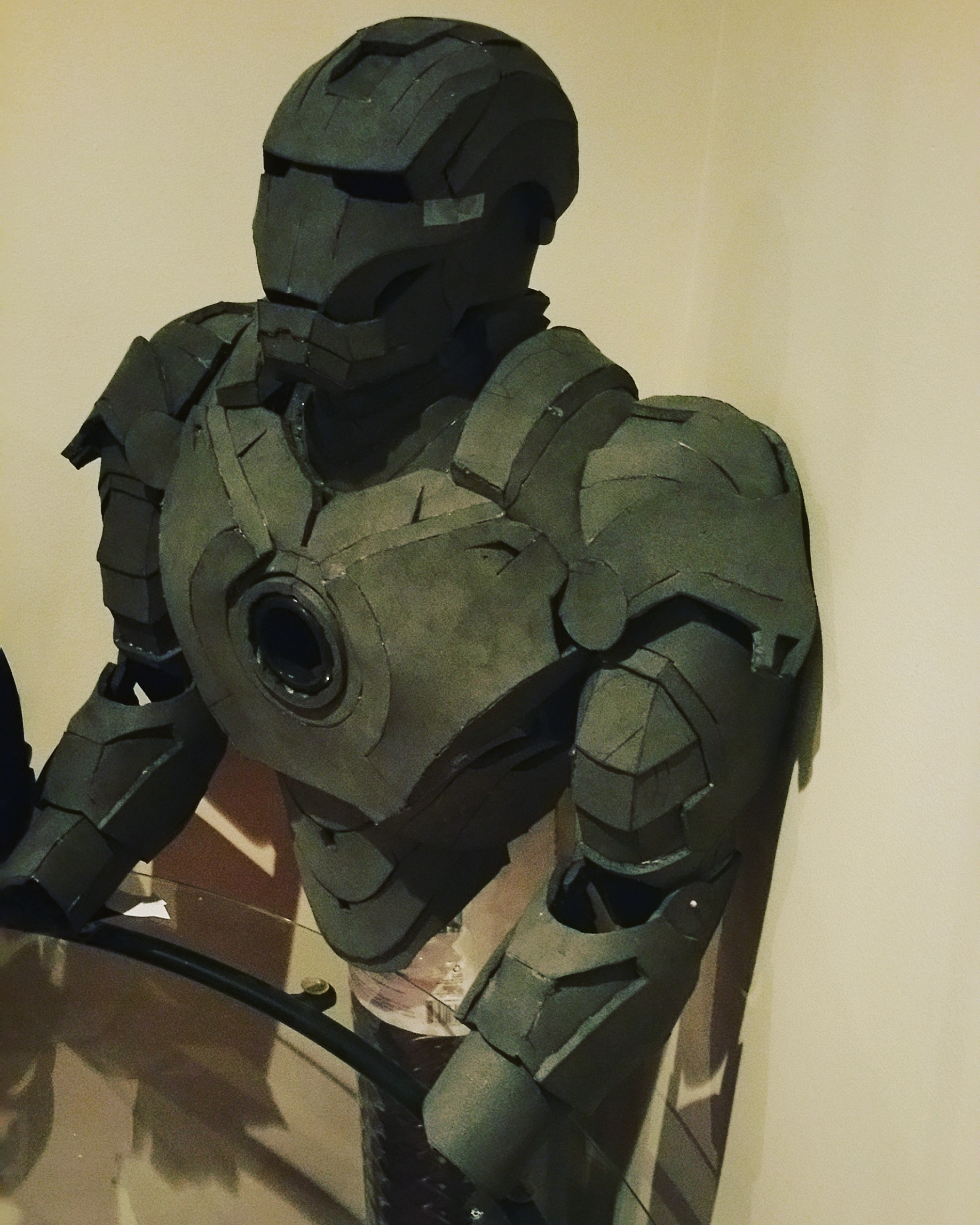

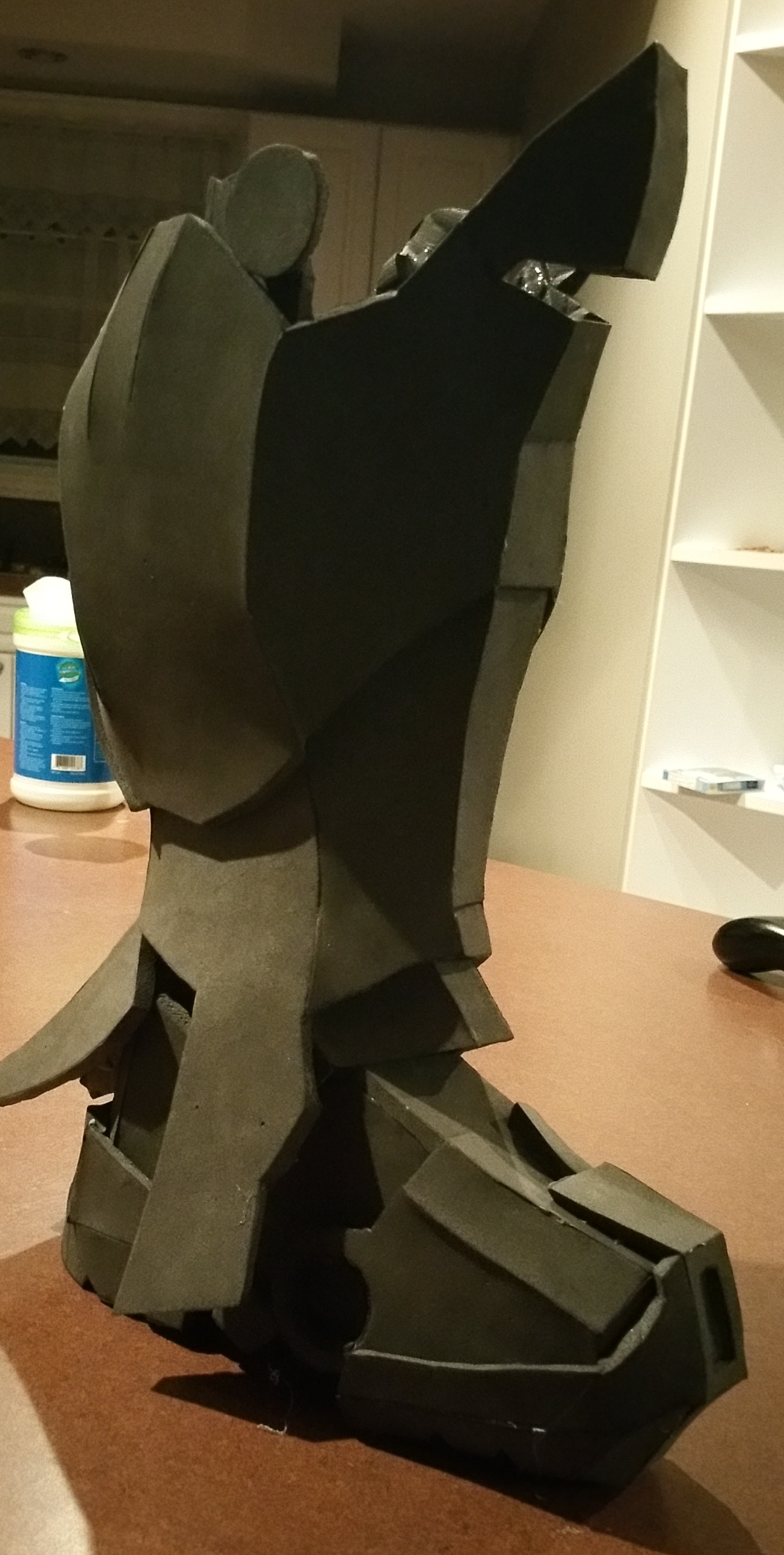

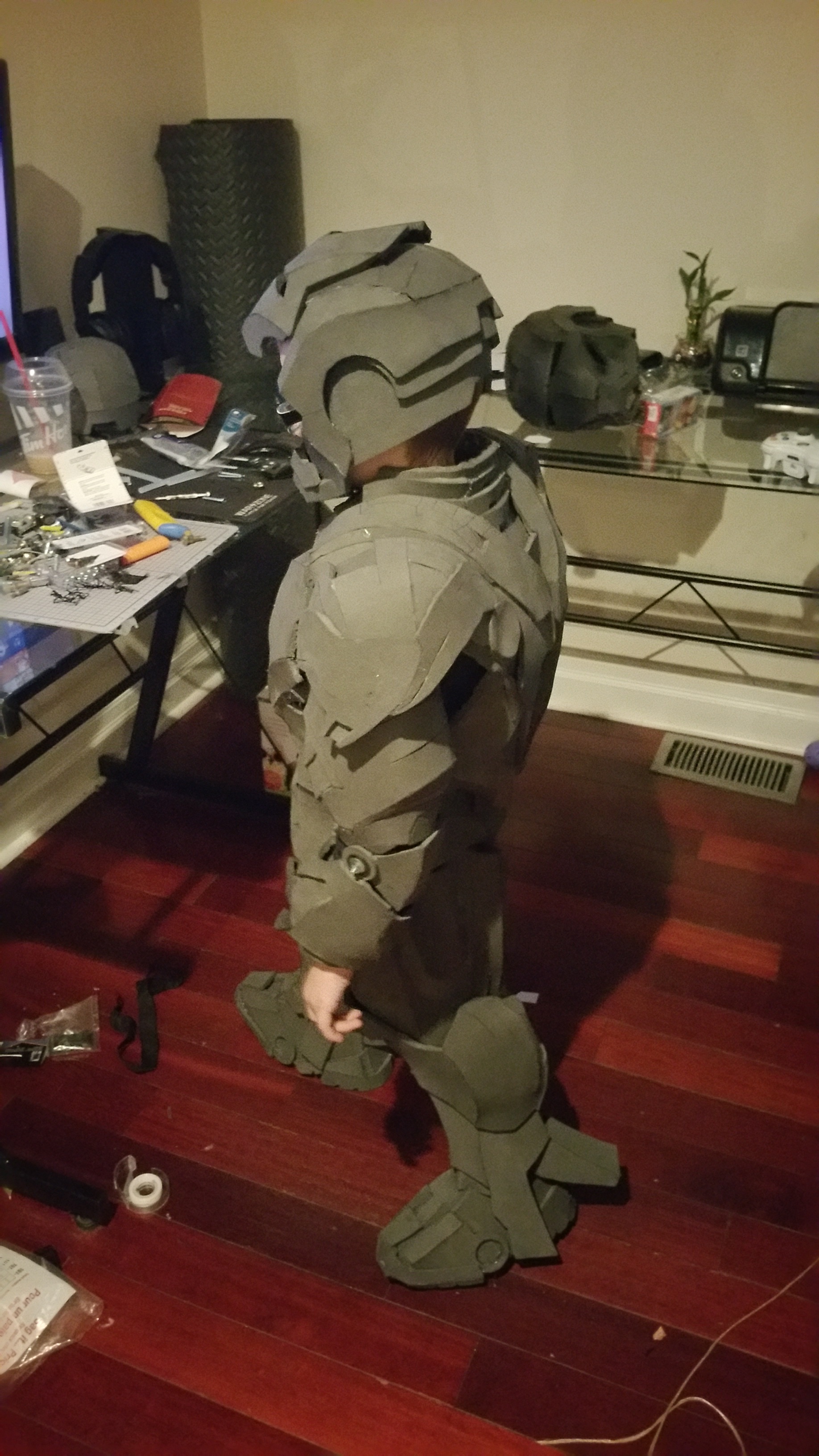

IMG_20151025_193020.jpgUntitled.jpgIMG_20160124_053147.jpg Just thought I'd share my 3rd attempt at my 6 year olds ironman mk4 suits helmet. Not sure how to get foam to keep shape without faceplate. suggestions?
I completed most of it moments before Halloween 2015 as you can see from the state of my work area. lol.
Hi Imran,and welcome to the RPF.
When you have opened your file in pepakura,go to "2D menue" and choose "change scale".
Measure all sides from your head between two objects,and fill in one of the numbers that you get.The rest will automatically be changed by pepakura.
Remember to add about 5-10mm because of the foam thickness.
