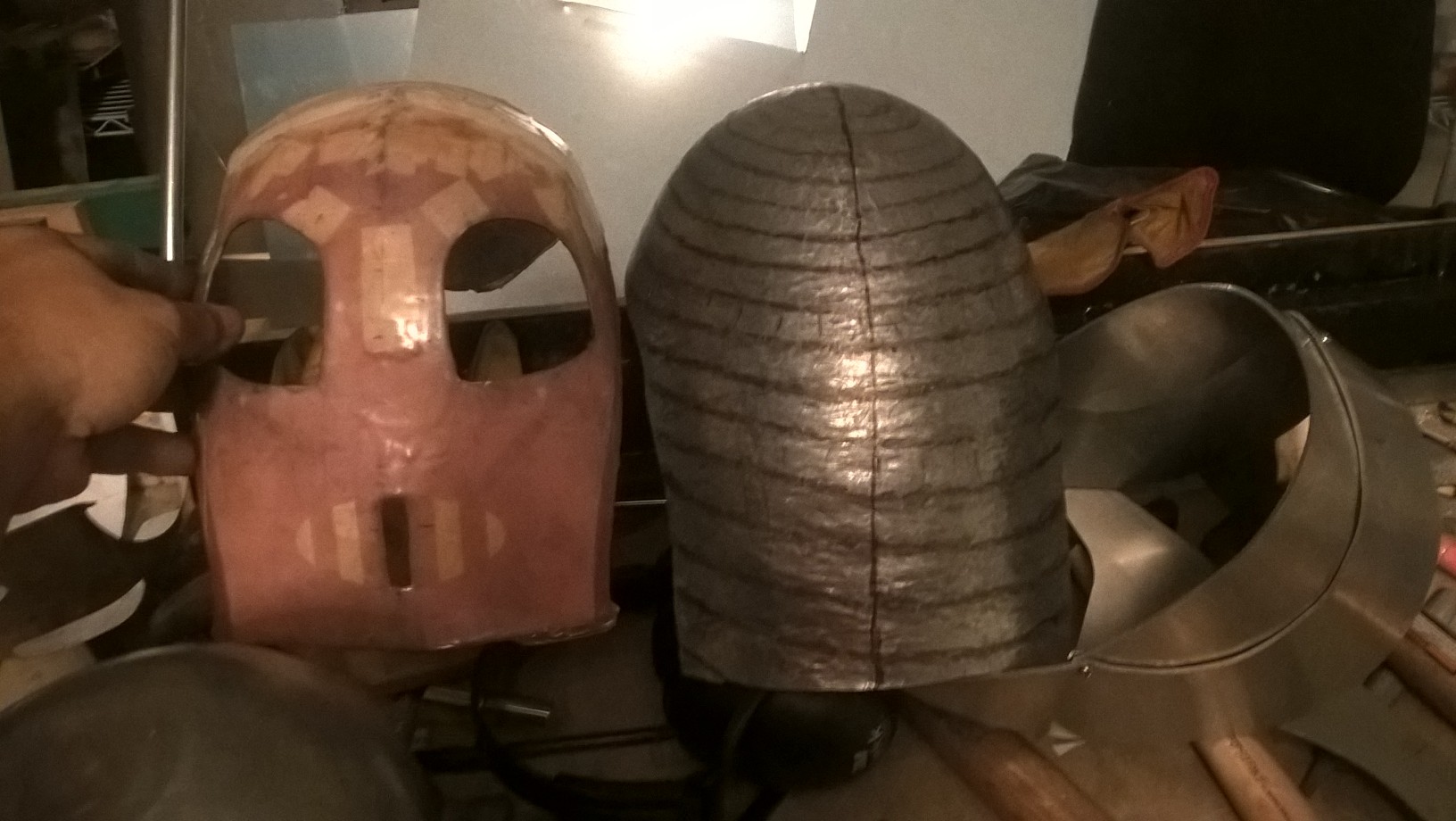

If you remember my ARS helmet, I think posted earlier in this thread, that was free hand and my first attempt at doing detail lines with a soldering iron. Pretty ugly. On the other hand, using a knife and heat gun will probably always look prettier. Take that Stargate Chirp build from a few months back for example. That had some really nice detail and that was done with a knife and heat gun.
