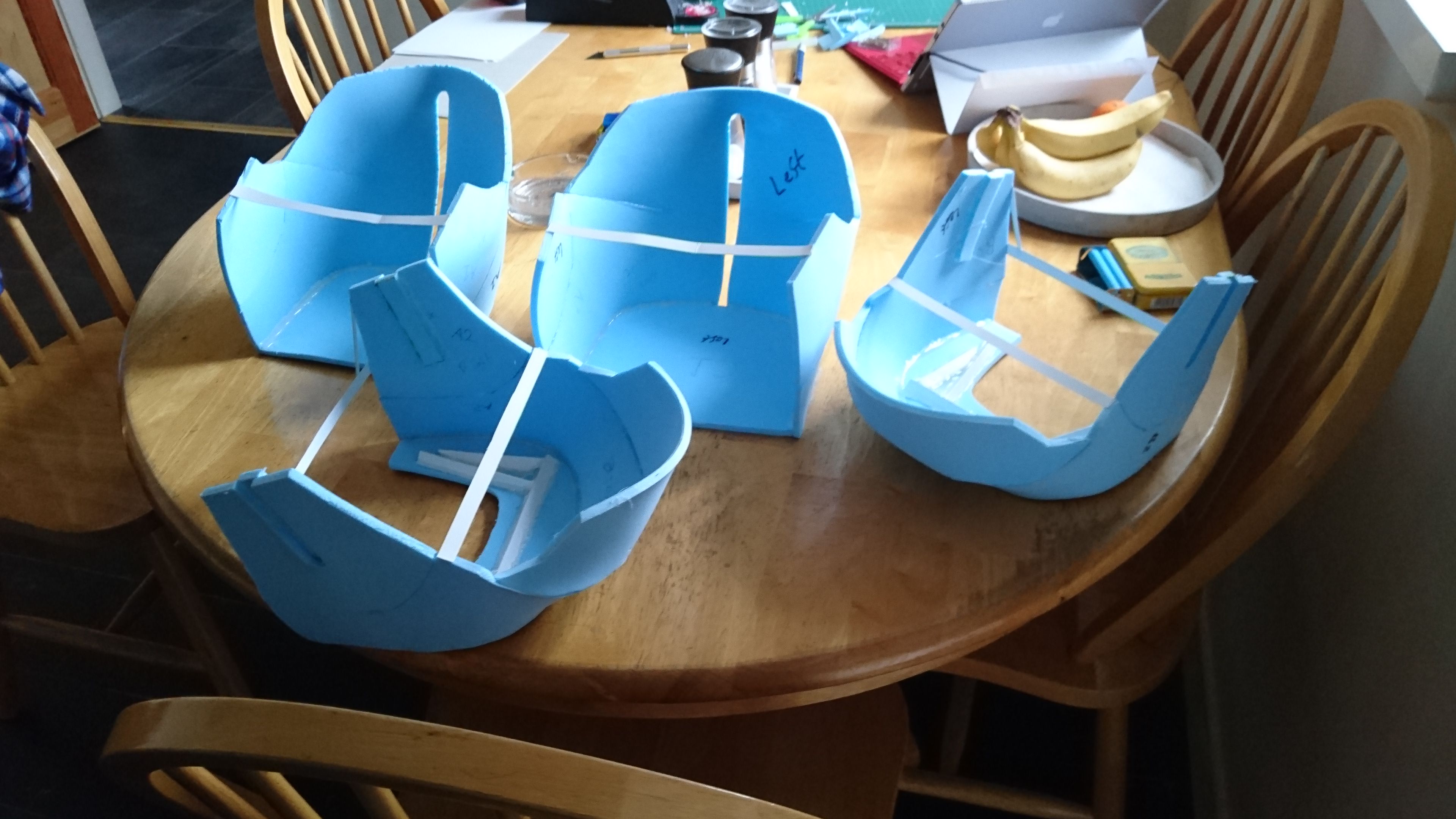

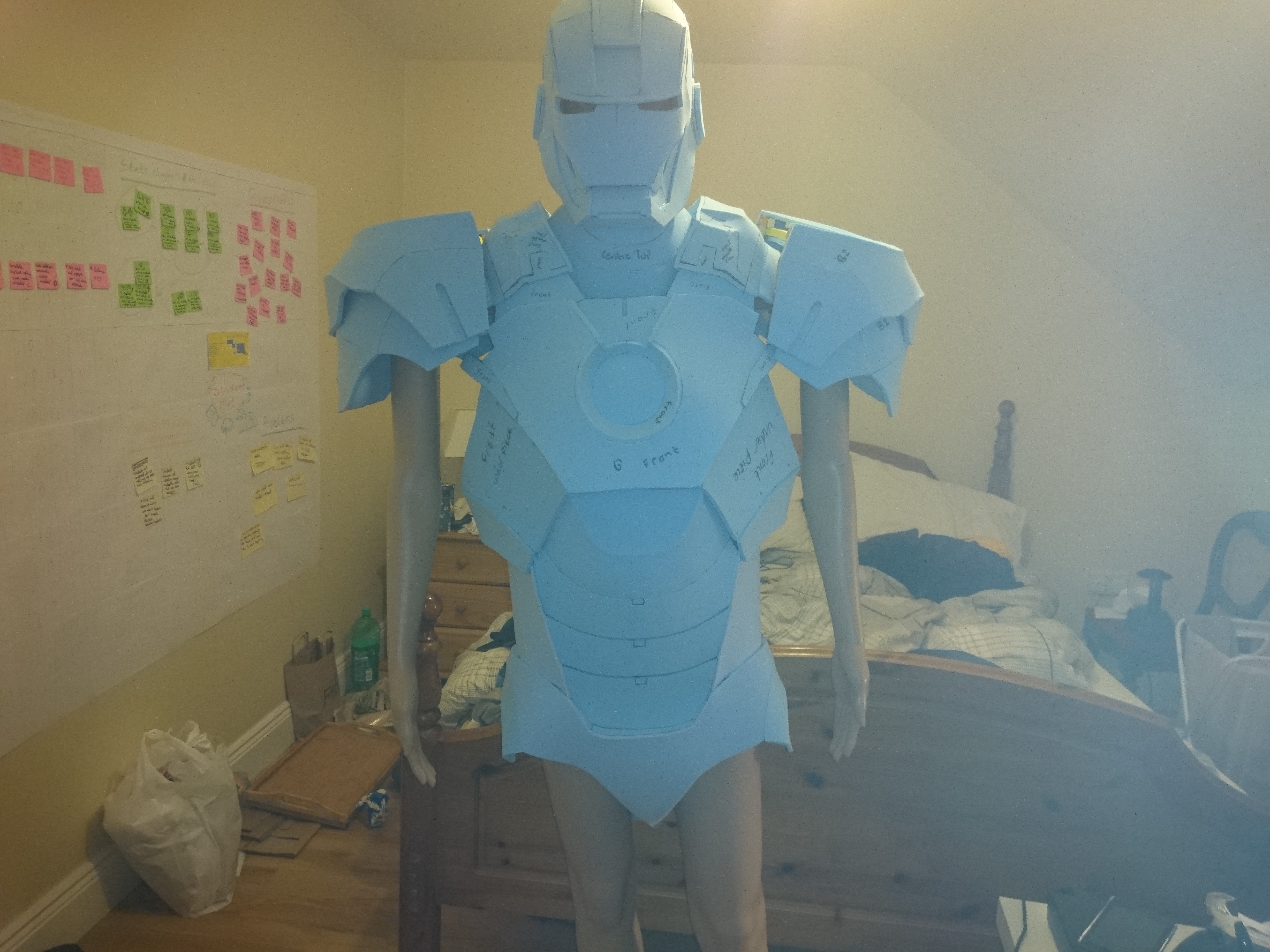

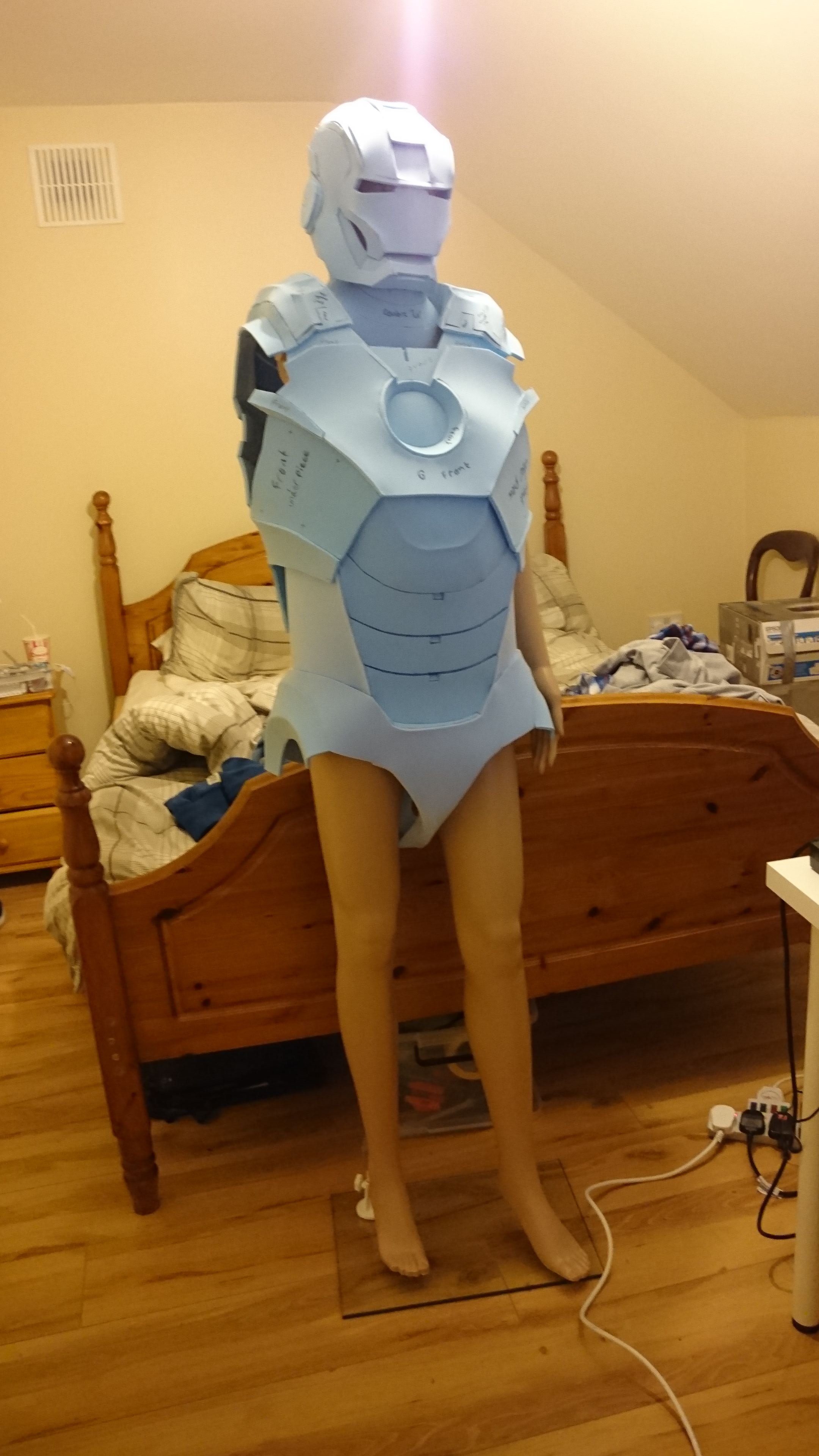

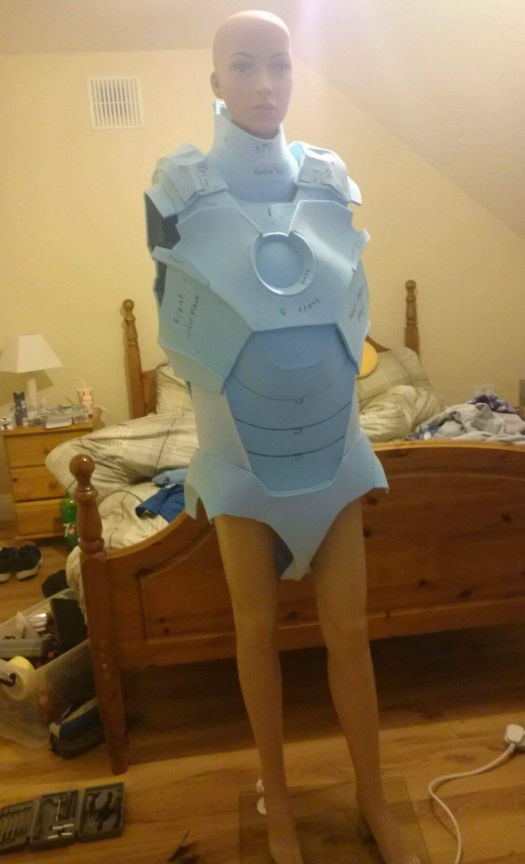

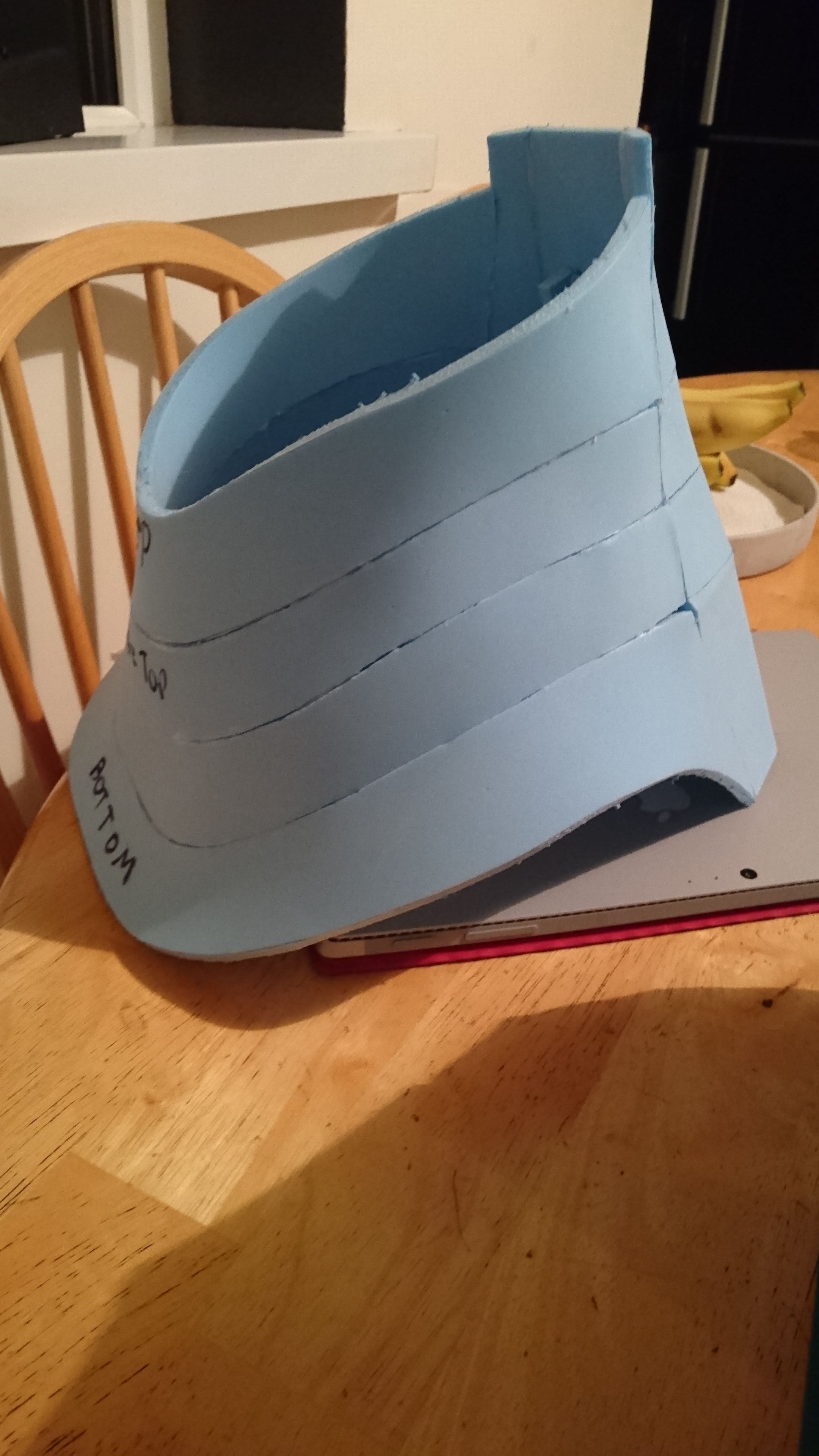

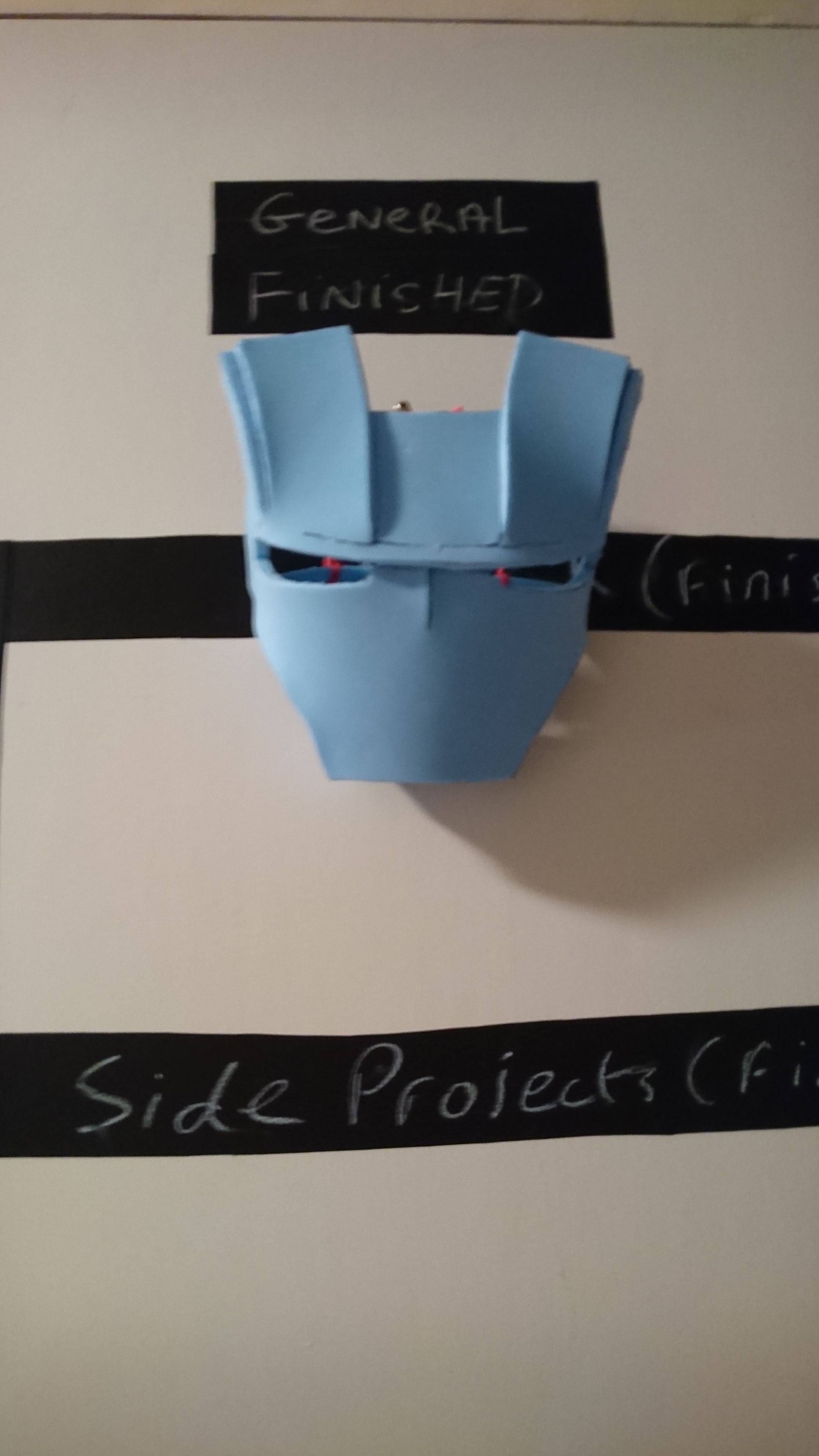

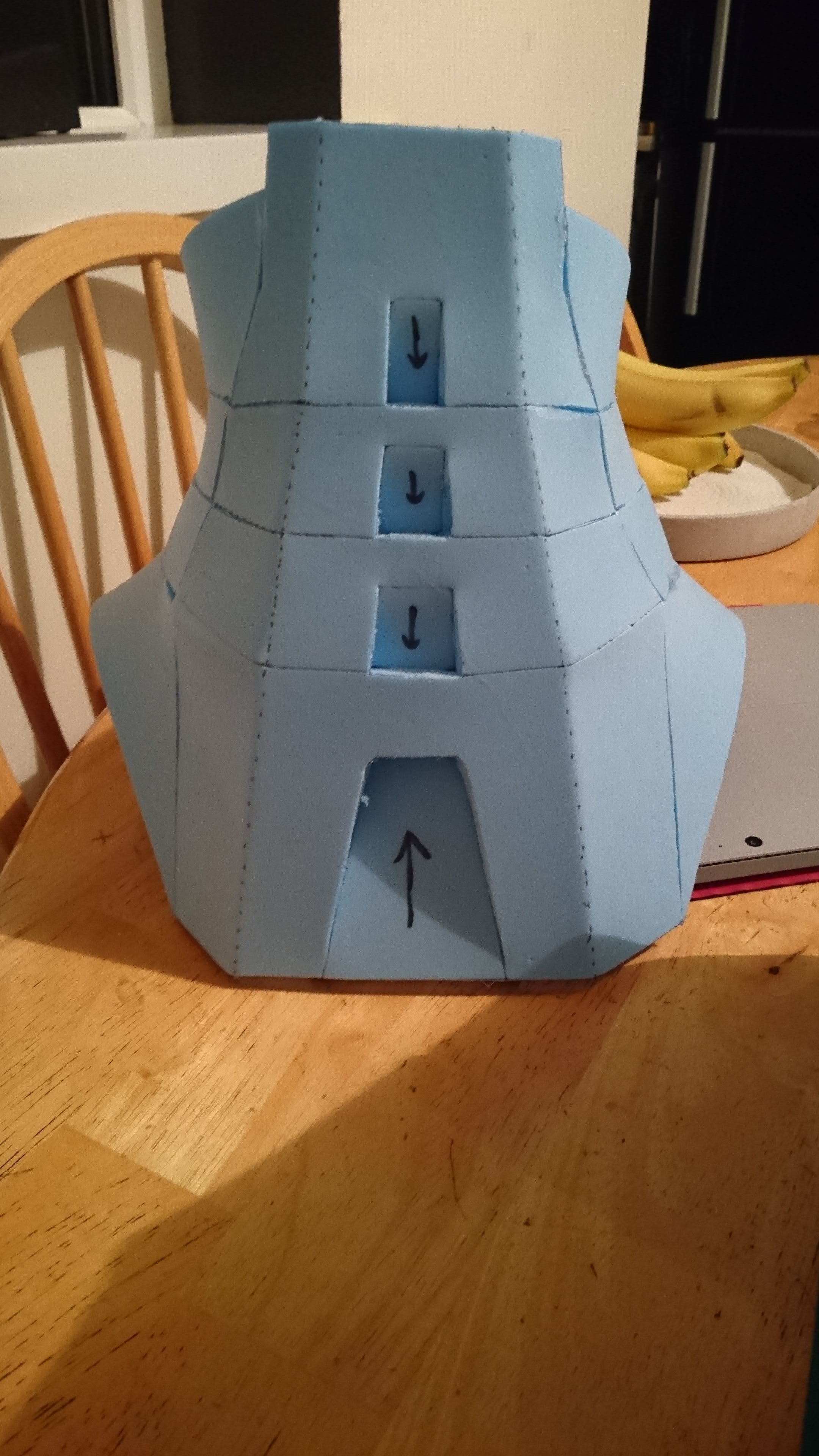

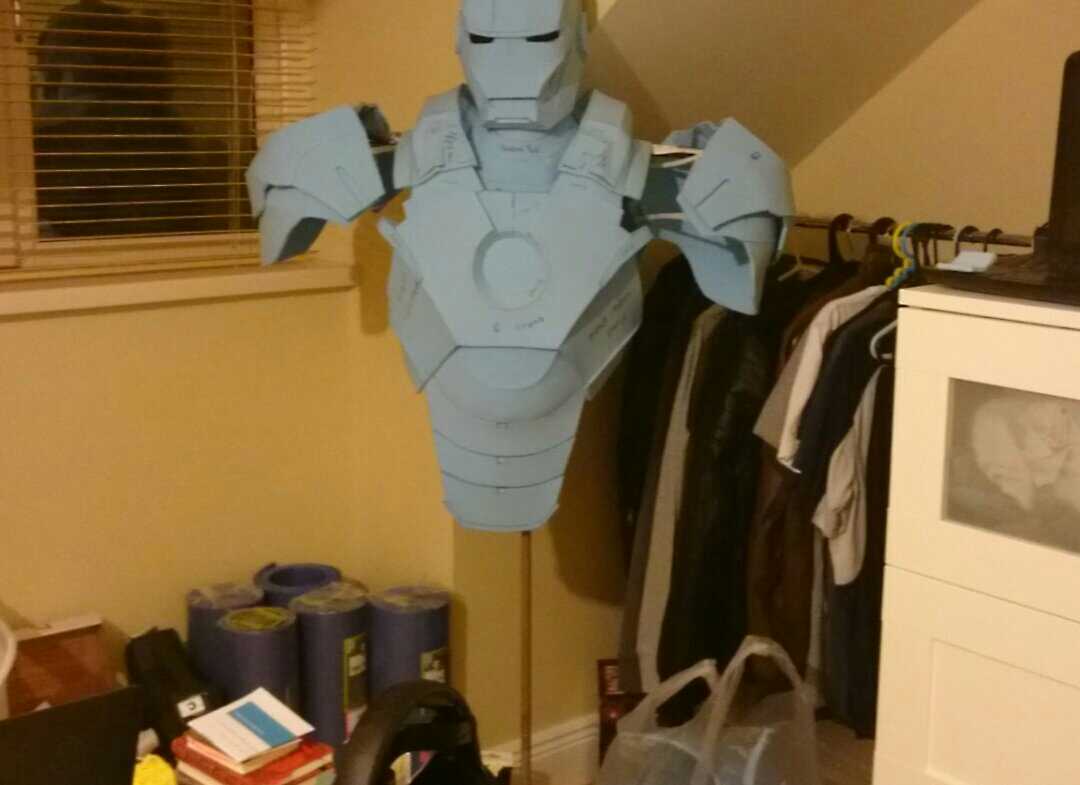

OK so this is my first ever endeavor into foam prop / costume building, I'm a final year Product/Industrial Design student with a little too much free time on his hands. I am building the suit using EVA (assuming eva) Camping mats and floor mats, the aim is to have this finished in time for my courses end of year show. I am starting this post to help keep track of my progress and maybe, hopefully get some good feedback and suggestions from the community.
Now without further ado, here are some pics of the suit as I progressed to where I am at now, please not some suit details are missing pending being engraved into the pieces and the shoulder pieces need to be rebuilt as I used default mark 7 shoulders when it looks like the mark 20 is using a different style.

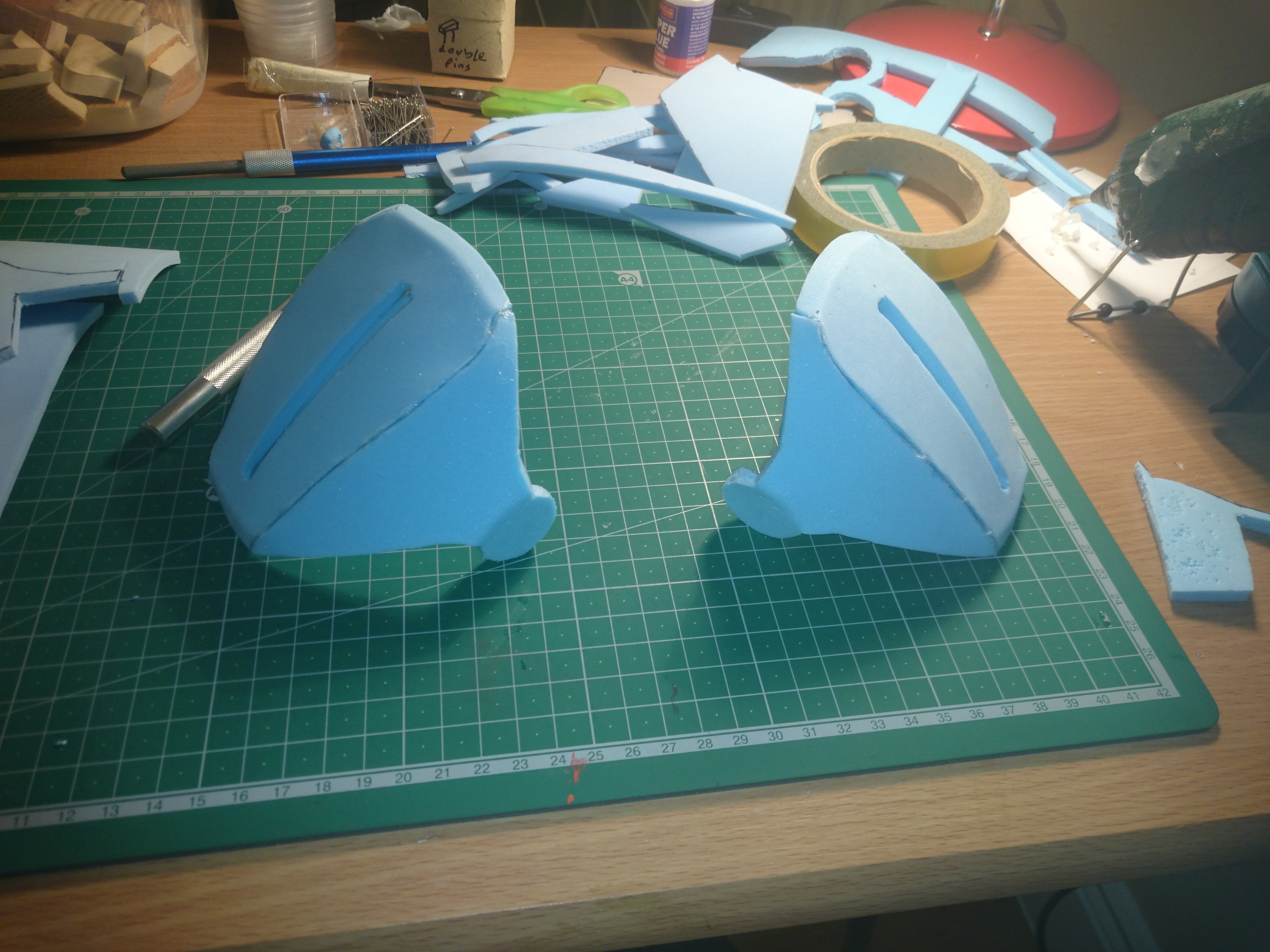

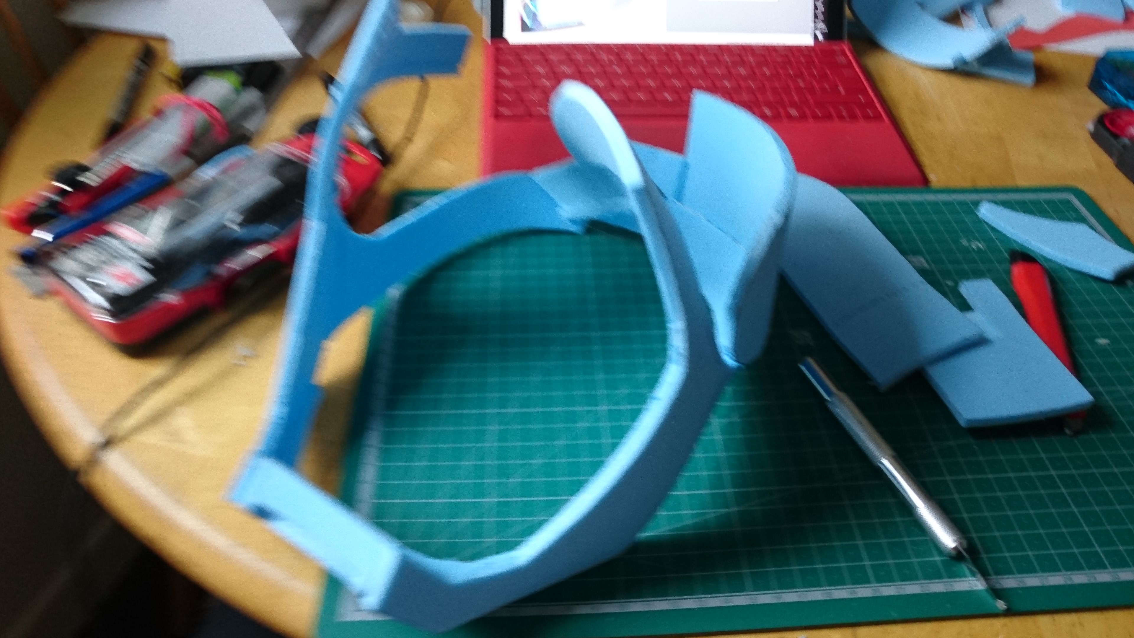

Thanks, I'm really hoping this will be the first suit of many, I'm looking into ways to produce suits faster after this one is done and try and get a collection done up for display. I'm currently working on the shoulders, just waiting for some 3d printed parts to expand the mannequins arms to be able to hold them, the female is quite slim inside the suit.
So a quick update on this for everyone, college has my production schedule held up but I'm back to making pieces, elbow pieces done and working on biceps at the moment, finally received 3d printed files I needed to space the mannequins arms out too to fit the suit better. Shoulders have been fixed up a little too but are not 100% accurate to pictures I've found, those I plan on fixing up one I have the arms built. Still working on sourcing resin to Ireland to be able to coat the foam,
