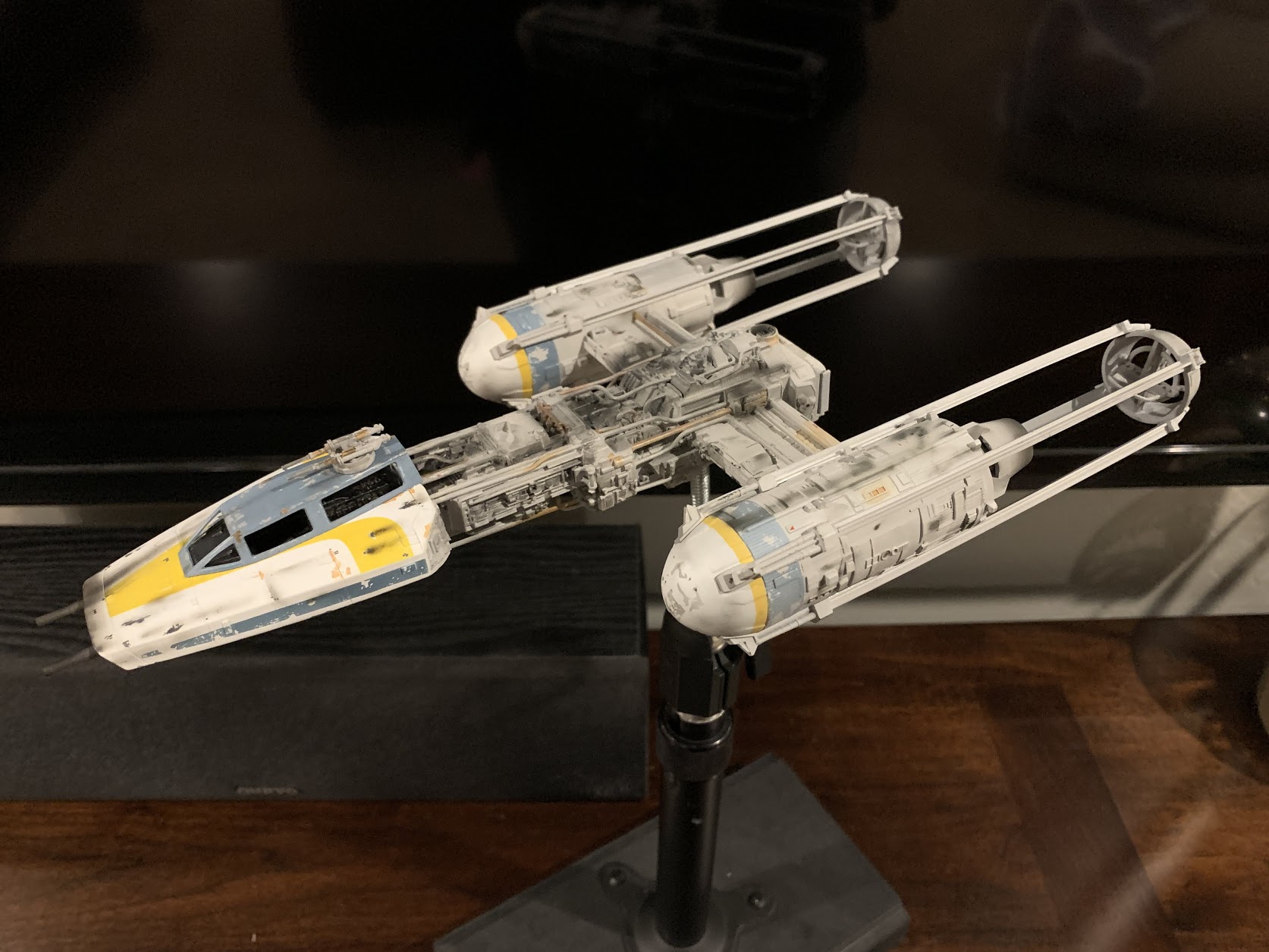

I can highly recommend the Elegoo Mars line of printers. I printed this model on the original Mars:
There are now newer versions of the Mars: the Mars 2 pro, etc... I also have the Elegoo Saturn, which has a larger build volume. Can't speak to any other brand, but my little Mars has been printing like a champ recently.
