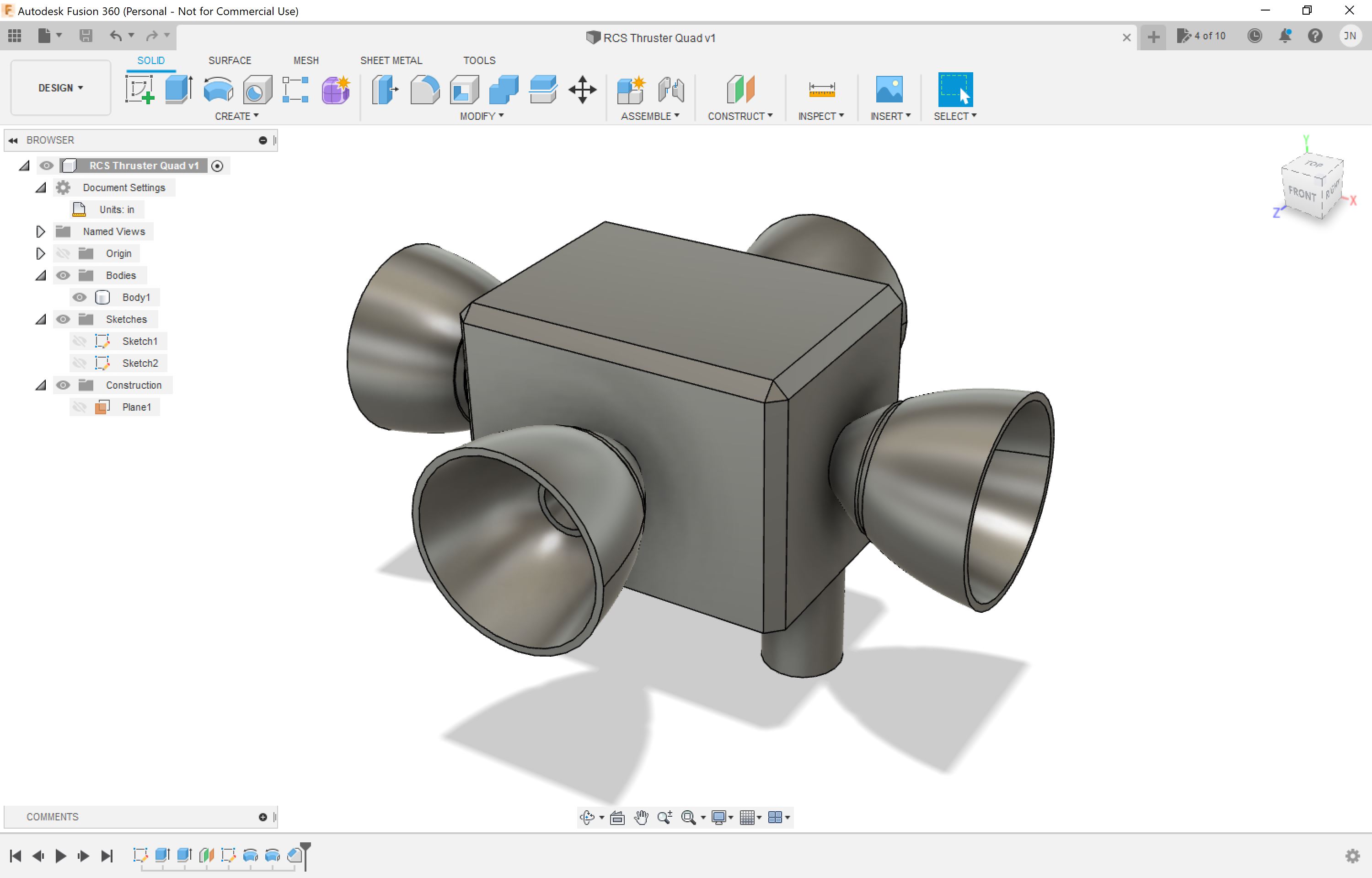

I'm in the same boat. I'm counting down the days till I can place my order and playing around with Fusion 3D, Lychee, and Chitubox in the meantime. I've worked up some more detailed replacement parts for my 1/72 Eagle in the last couple of days and even the modeling part is fun. I haven't done much 3D work in a long time. I'd definitely recommend downloading Fusion, it's free for personal use. There's a bit of a learning curve, but it's extremely powerful and does parametric modeling so you can go back and change things after the fact. Very useful if you need to experiment with fit and such for add on or detail pieces.

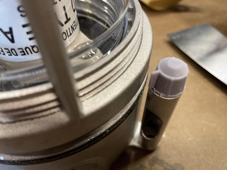

+1 here for the Elegoo Saturn. I've only done a tiny bit of modelling in the past but now I'm starting to get into it more. Purchased the Saturn on Amazon as well as the Elegoo wash/cure. So far the test print was a success, and I also designed/printed my very first model. No failures, no issues. Did a lot of research and studying before jumping in and I think it is paying off. You really need to pay attention to leveling, supports, support design and sizing, layer curing times and other misc. settings. I'm also using Elegoo's water wash resin and I'm running a Winix charcoal filter air purifier in my shop. Here is a photo of my test print (excuse the white residue, these needed to wash for 2-3 min longer than they did) :
Here is a photo of the tiny, 1/2" diameter knob that I modeled. This greeblie is going to be the red cap on top of the side tube on Shephard Book's lantern from Firefly.

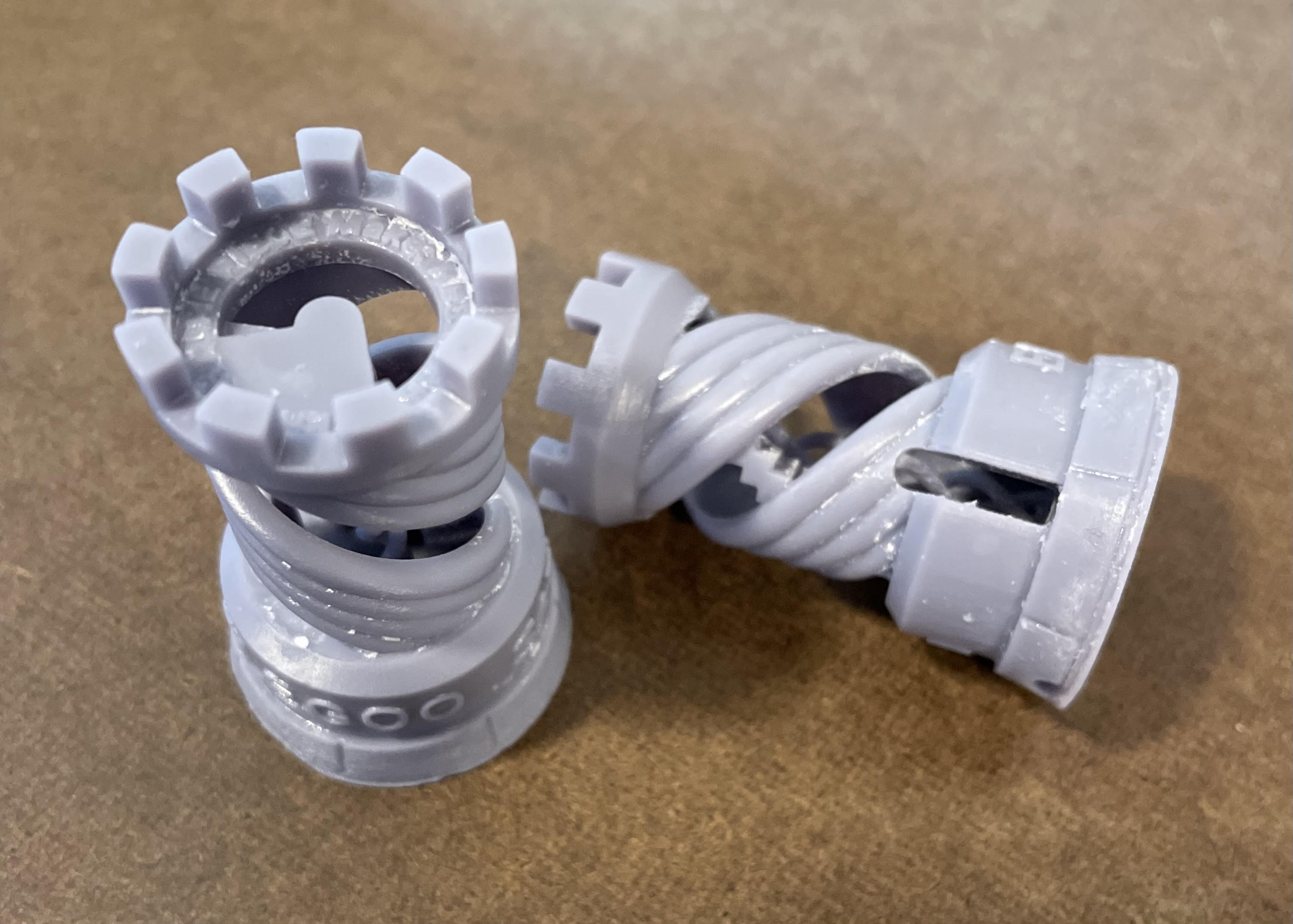

Elegoo standard resin is fine for low-detail, robust parts. This resin is a bit brittle and fine details will break off. Oh, and don't drop it! Internal stress of hollowed parts seems high; or perhaps it is simply because I didn't have drain holes in the particular part. But it broke, thereby relieving the stress and the pieces were so tweaked they could not be reassembled.
