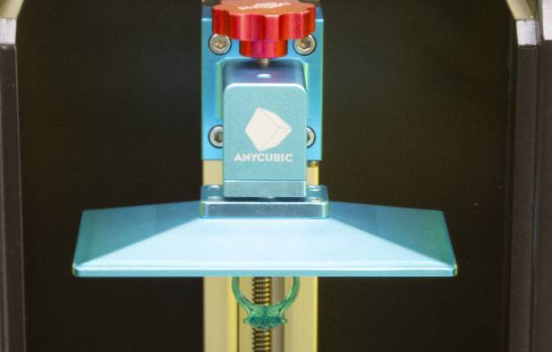

Try to stay away from the Ancycubic Photon style of mounting the buildplate,
not on ball mounting point, but rather a setup with brackets and 4 screws, that most newer printers use.
The ball mounting system is prone to moving while printing, and if resin get in there you will have to take it all apart to clean.
the brackets with screw work much better, and seldom have to be cleaned, and not prone to moving.
My new AnyCubic Photon Mono X has a bracket and 4-screw setup for the build plate.
Sean
I guess it’s a ball and socket.
The OEM upgrade replaces set screws with socket head cap screws apparently (and changes to a finely machined surface on the build plate). If a used one had the former, they can easily be changed. And I can lap off any coating on the plate and re-surface. I could also do a grit blasted surface if needed.
There shouldn’t be enough pressure to make it move, but I had a similar issue with drum mounting hardware a couple decades ago, and sorted that out. And that was under much more stress...
