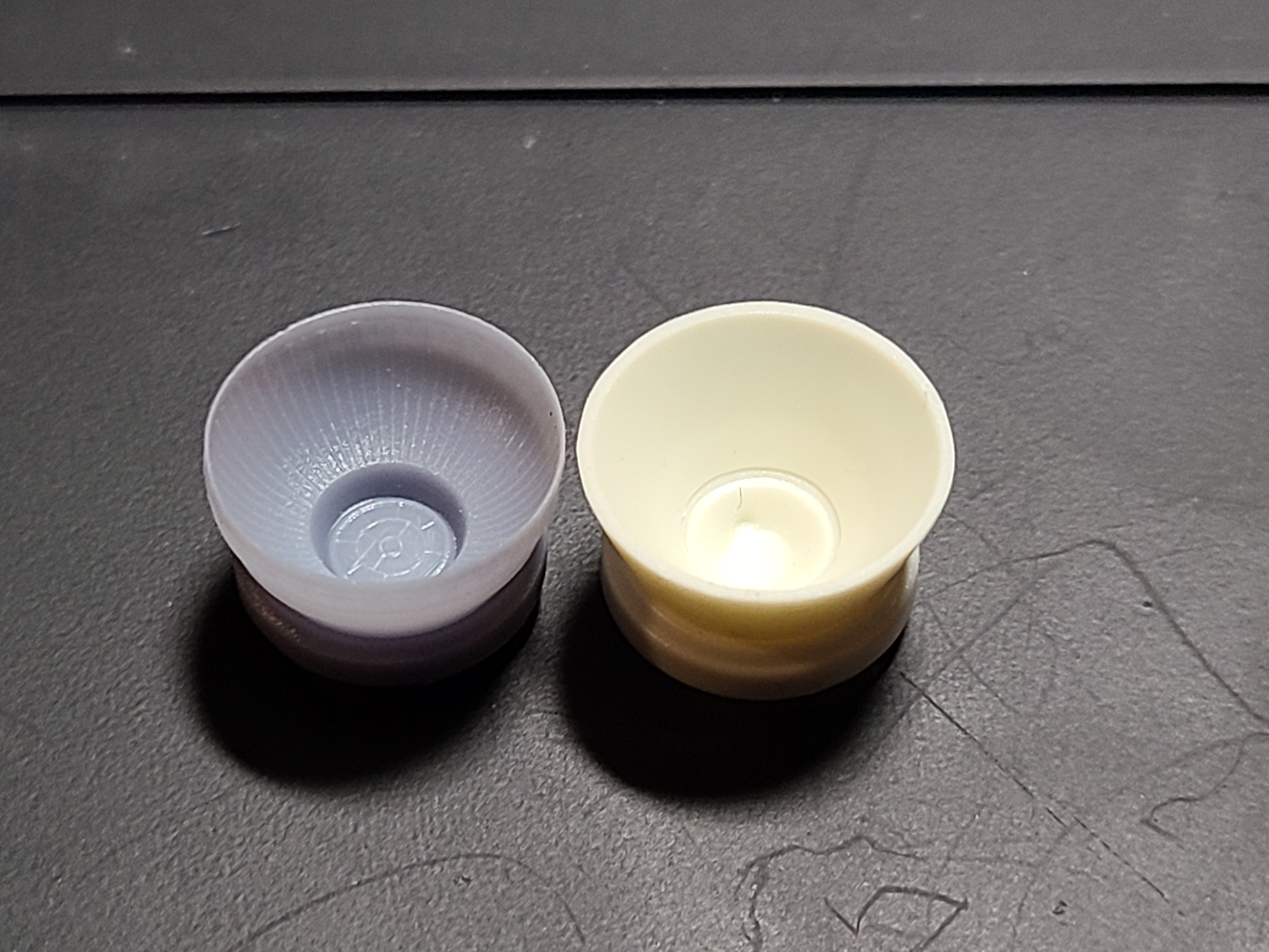

I've has a lot of micro-cracking using Anycubic grey. I think it's mostly in hollowed parts that are possibly too thin-walled, but i'm still not entirely convinced. I designed some test prints and none had cracks!
I now have some Elegoo ABS-Like to try.

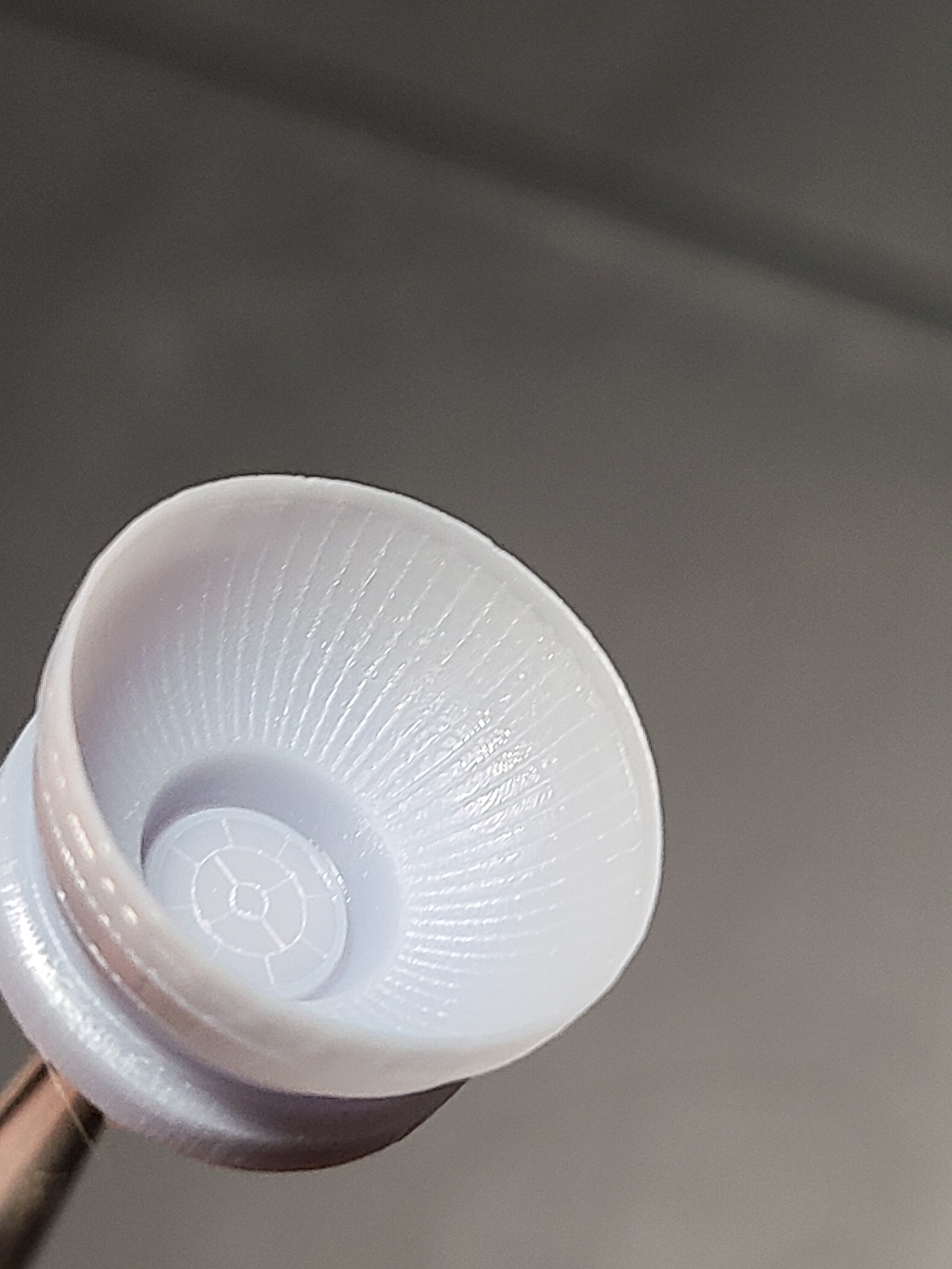

My Saturn came Friday and I spent Friday and Saturday playing around and working on dialing things in. I'm impressed with both the printer and the Siraya Tech Build. It's got just the right amount of flexibility, it will still break if you push it too far or on really delicate features, but it seems like pretty tough stuff and holds detail well. I've started experimenting on my Eagle parts and I definitely have some tweaking to do there. The hollow RCS quad bells are just too delicate as currently modeled. But I think they'll be great once I get them beefed up a little.
